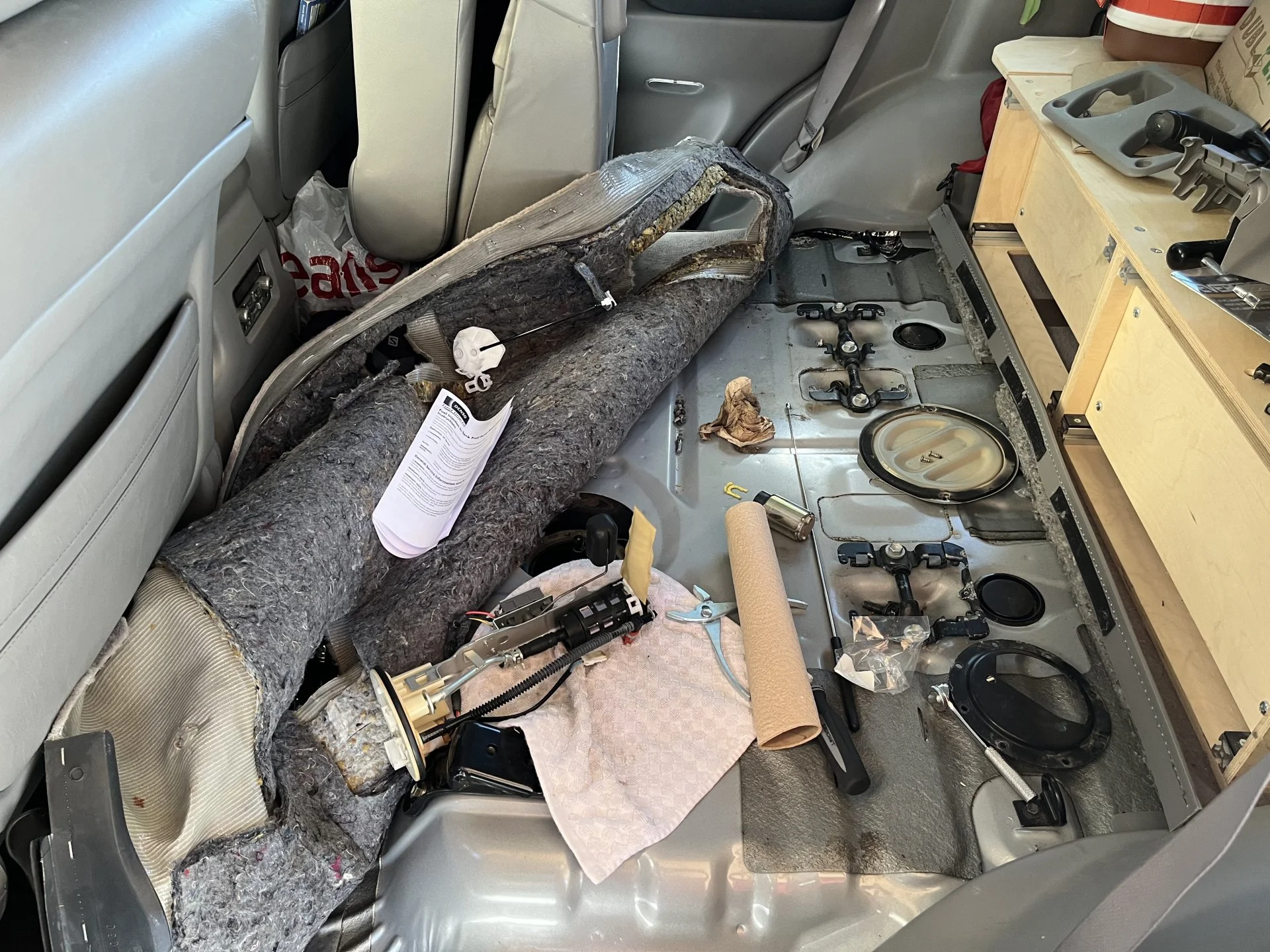

Looks like the truck isn’t letting me off that easy. Drove fine after the pump install yesterday evening but this morning the check engine light and VSC lights are on. I can feel some surging going on when I hold the throttle at a steady cruise. Not sure what to make of that.
