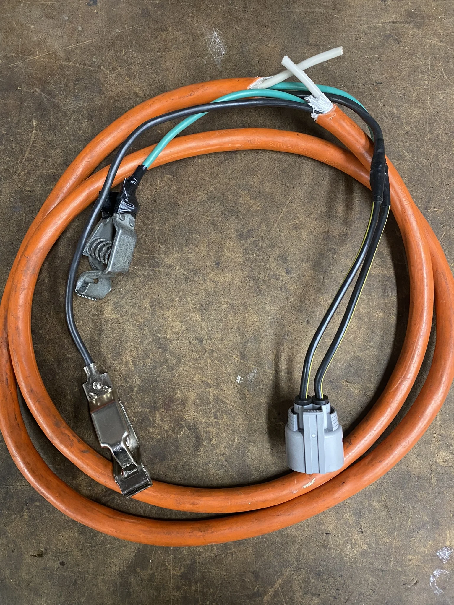

If they did actually jump, with 12 volt to pump motor, correctly. And pump motor did not run. Motor is bad and can be rebuild. I made a jumper cable for the purpose of testing motor.

I use a new wire housing block from Toyota & pigtails and old extension cord.
