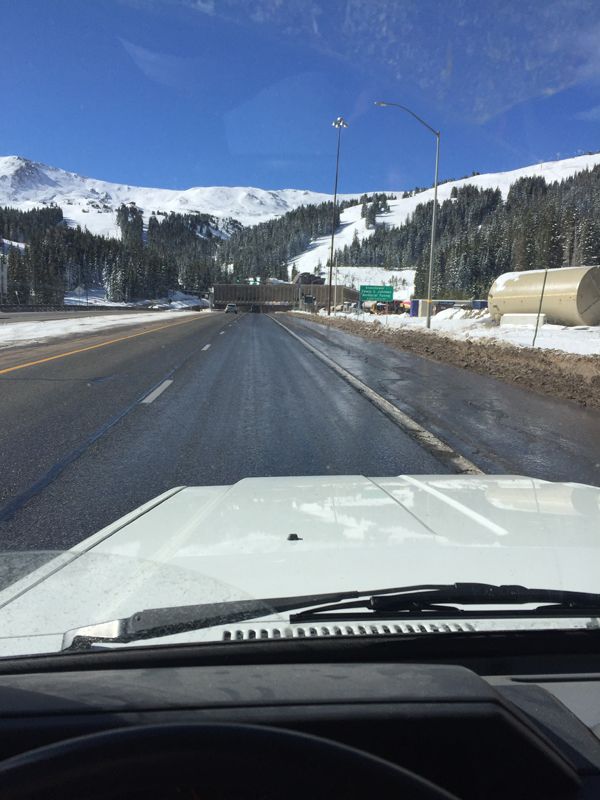

And here approaching the Eisenhower tunnel at 12,000' elevation:

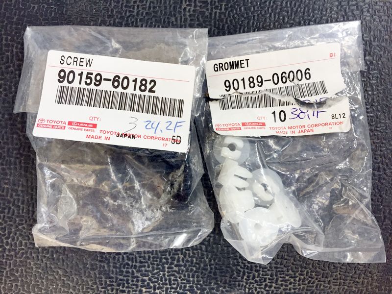

Those of you with sharp eyes might have noticed in the mud flap posts above that I didn't have the rubber inner fender skirts installed. The truck didn't have them when I bought it, so I bought them and installed:

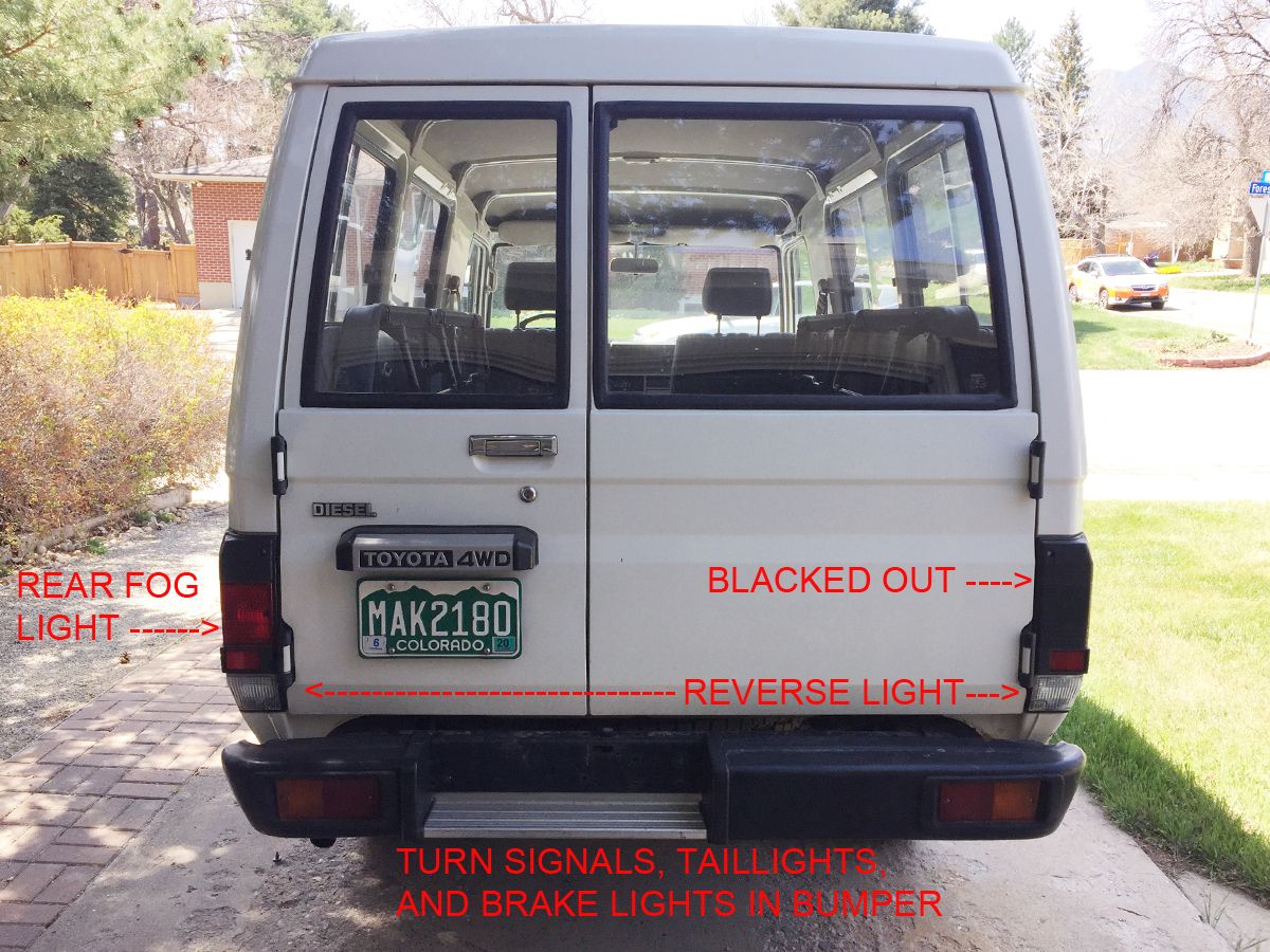

Taillights. The Euro spec Troopies I've seen of similar vintage all have taillights configured like this:
Which is all fine, I guess, but one day I was almost rear-ended in traffic by a guy in a giant lifted RAM truck because he was so close, and his truck was so high, and my lights were so low, that he didn't see me signal and brake. Now, sure, he shouldn't have been tailgating, but I figured that having the lights up a little higher on the body couldn't hurt safety-wise. In other markets, the 70-series comes with a more "normal" taillight configuration, so I did a little research, found the part numbers, and ordered these tri-color lights:

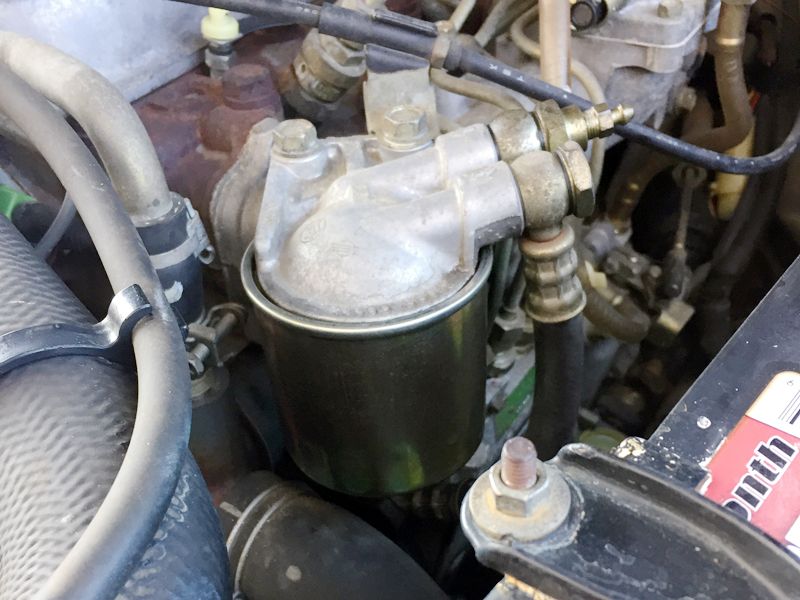

Since I've had it, I've been doing all the maintenance myself (so no more cool French receipts). Regular valve adjustments and oil changes are important, and I'm kind of a zealot about it. I've been using synthetic oil and OEM Toyota filters for the motor:
and OEM Toyota fuel filters:

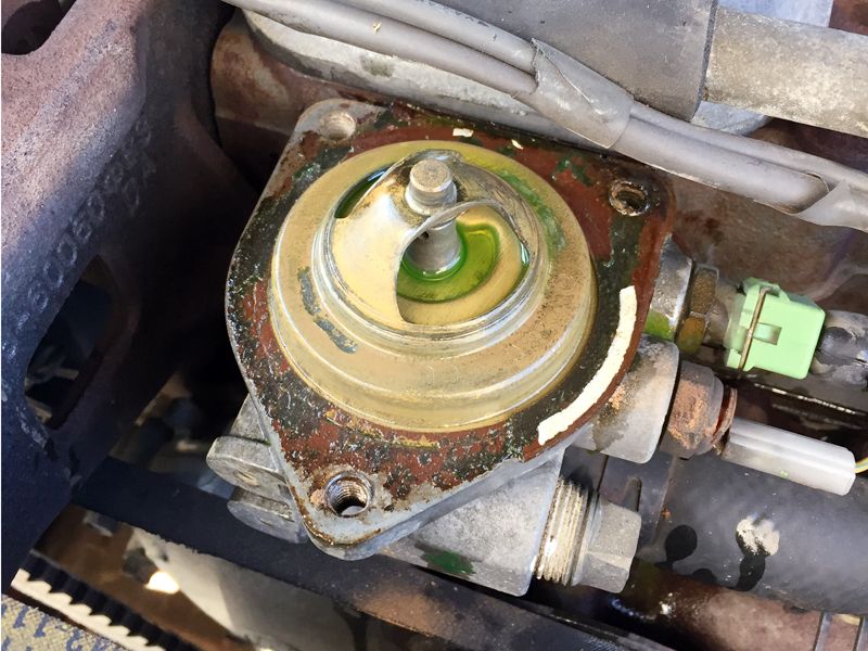

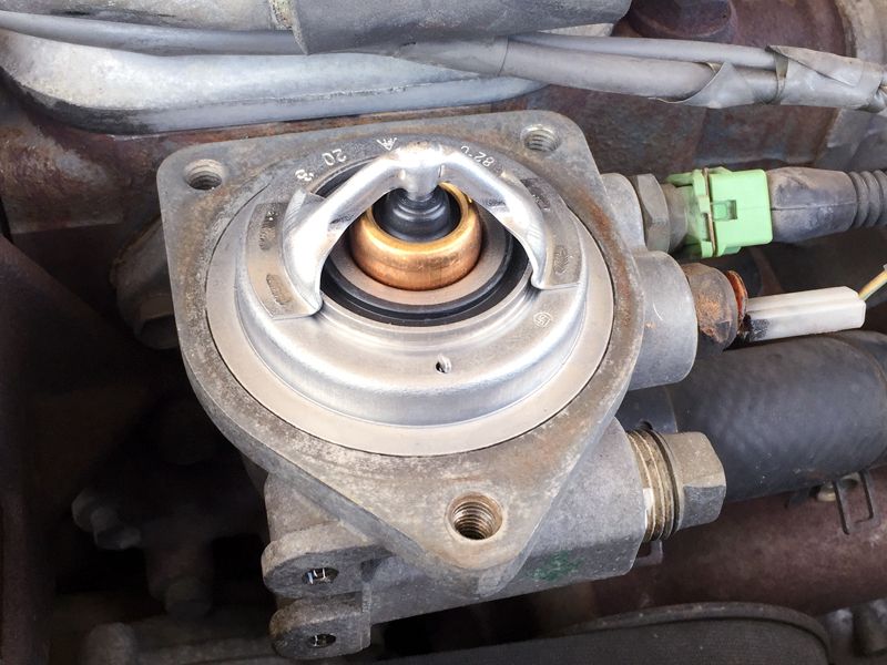

I also replaced the thermostat and completely flushed and refilled the cooling system a while back. Nothing wrong with any of it, and nothing unusual or crusty to be found in there, but I just like to know it's all new and good. Cooling is sooo important on diesel motors.
Here's the old thermostat:
I've definitely seen worse. And here's the new one:

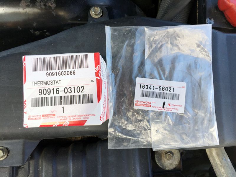

Part numbers, for those interested:
Those of you with sharp eyes might notice that I went with the 82C thermostat, rather than the 88C one originally specified for a Euro market truck. My thinking on this was that summer in the SW USA is far more like the outback of Australia or the Middle East deserts, where Toyota specified the 82C thermostat, than it is like northern Europe or Japan, where Toyota specified the 88C unit. So far it's been working out well. Temp gauge rides at just over 1/4-ish, whereas before it was usually just about 2/5ths or so. Not a huge difference, but noticeably cooler running. The heat still works great in the winter, so no worries about that.
