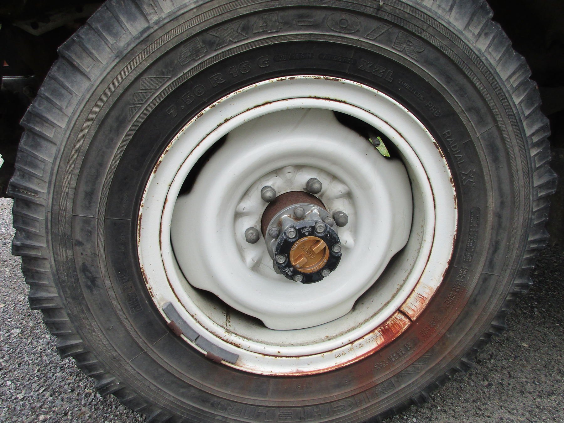

Haven't done much to the Troopy lately except drive it. I mentioned somewhere above that I had sent the wheels out to be powder coated, but I don't think I posted before/after photos of how that went. For the record, here's the original split-rim wheels that it came with (in their original white paint):

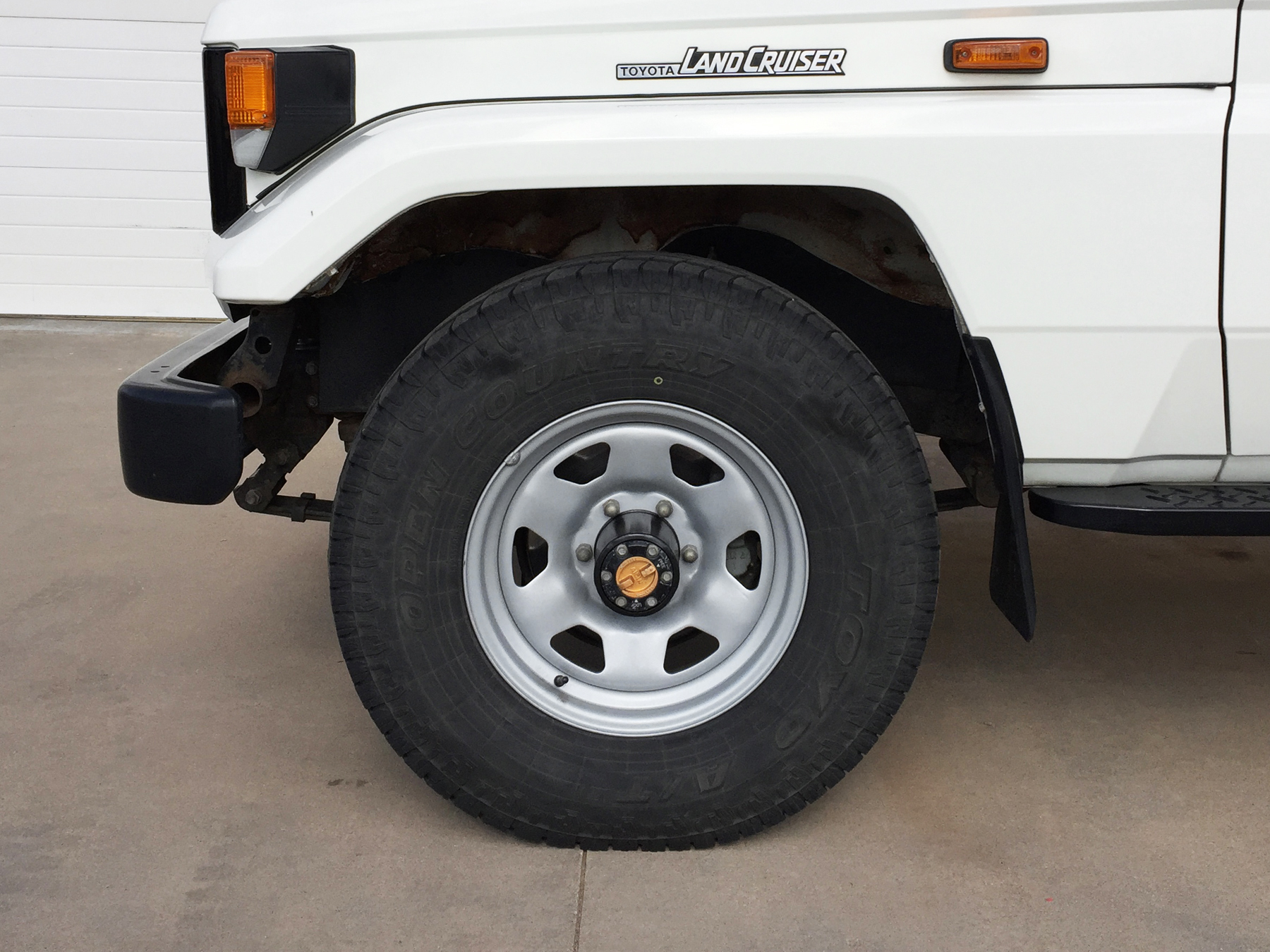

Obviously, room for improvement. Split rims are cool, I guess, in the sense that they're original equipment and all, but honestly, they're heavy, hard to balance, require innertubes, and not many tire shops will even touch them. So away they went. They were replaced with these OEM steel one-piece rims that were sourced from a 1988 Euro market BJ71 short wheelbase model. Same size, same vintage, and correct for a 70-series, just a lot easier to deal with since they're for use with modern, tubeless tires. I think they're better looking, too.

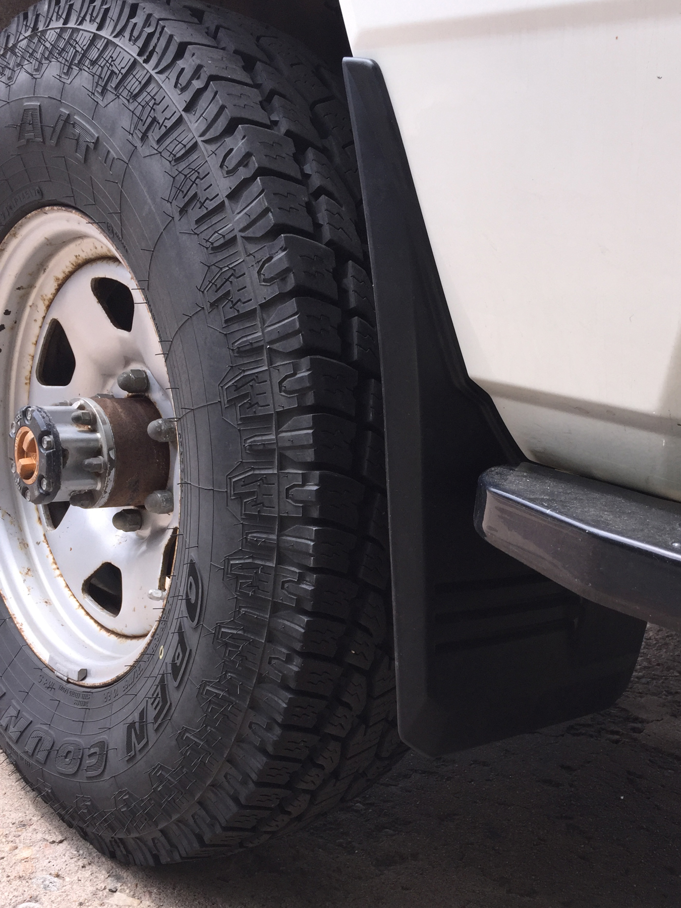

Due to their age, these wheels started showing some pitting in the paint and a little surface rust, which I thought too ugly for such a nice looking car. Here's the only photo I could find that shows the wheels in their "ugly" condition:

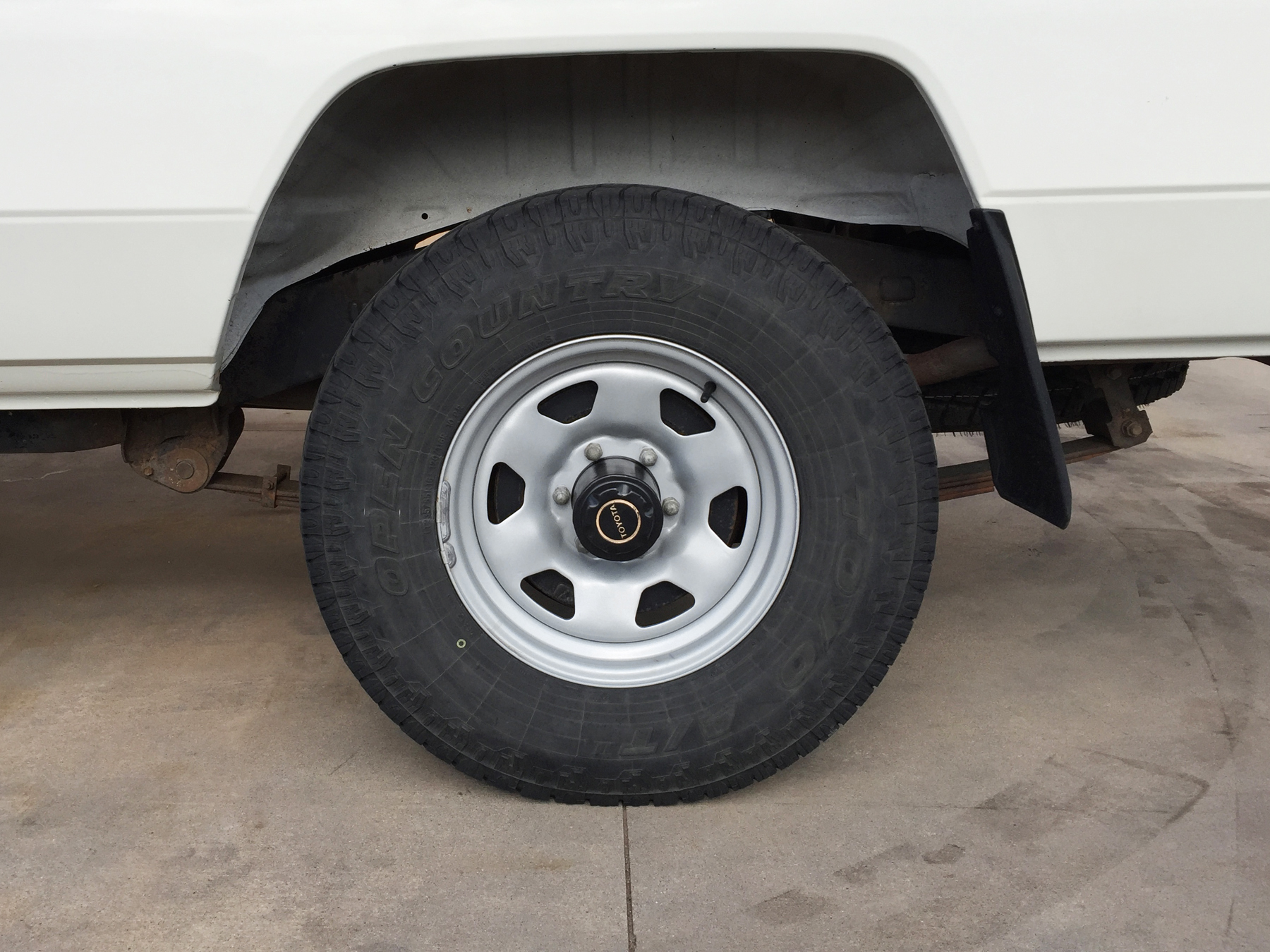

So I sent them off for powder coating. I think they turned out great. I even put the little hubcaps back on them:

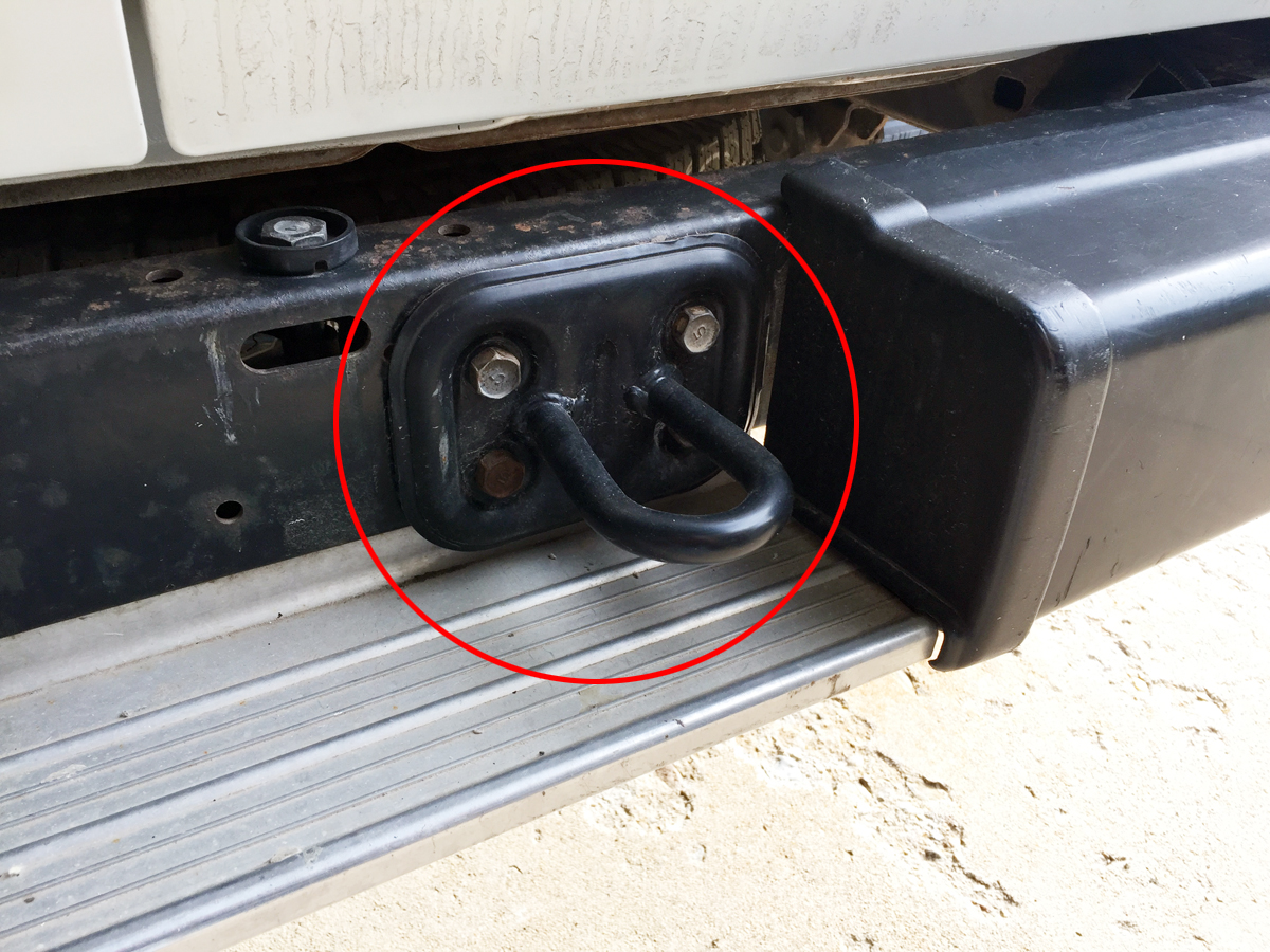

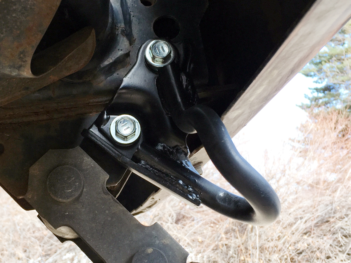

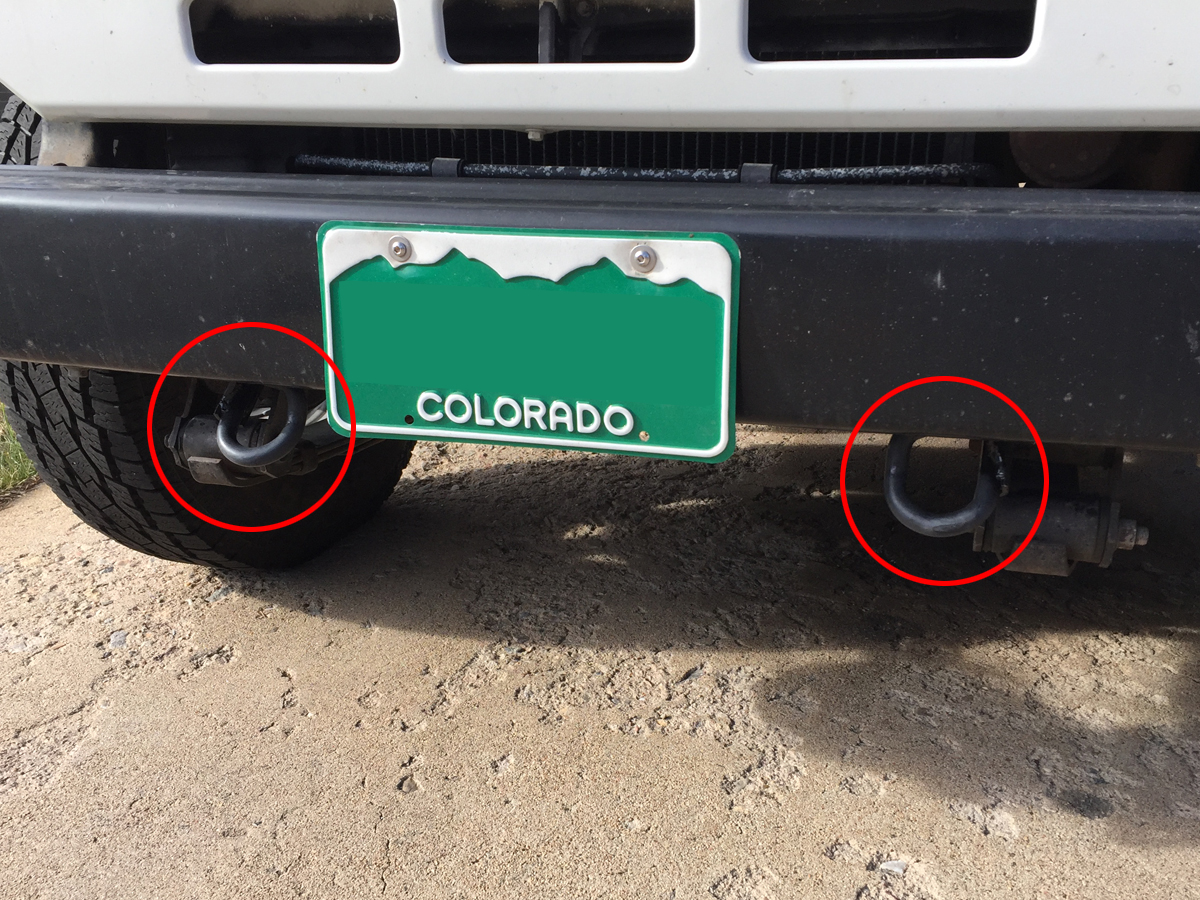

About the same time I was having the wheels refinished, I installed some OEM Toyota recovery points that I had laying around. Here's what those look like:
I couldn't find the original bolts, so I had to order some from my local Toyota dealer (which is why they look newer than anything else).
I have same white wheels and am looking into powder coating mine too. What colour (RAL code?) did you end up choosing? The powdercoat appears greyish instead of white like the first photo?
The first photo (in post #41, above) is of the split rim like the car had on it when I got it. Those wheels are just a generic white, not much different from the 045 code white on the car body. The second and third photos are of the BJ71 wheels that I switched to, and they are silver (maybe not easy to see in the photos). The part number for those wheels is 42601-60262-03, and I'm pretty sure you can still get them new from Toyota. The fourth and fifth photos are of the same wheels from photos 2 & 3, but after I had them powder coated. The powder coat color is GR1342, according to my receipt, and it's a little more gray-ish and a little less bright silver if compared to the original Toyota wheel paint color (i.e. not an exact match for original silver color).

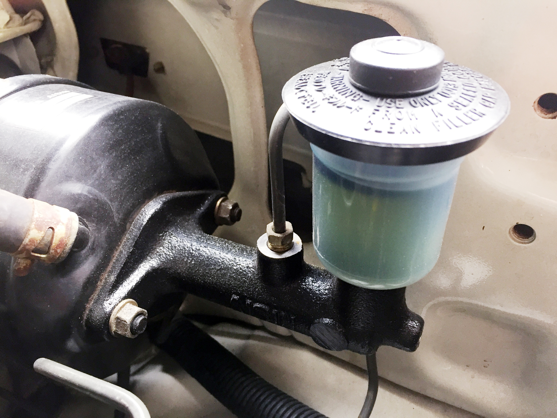

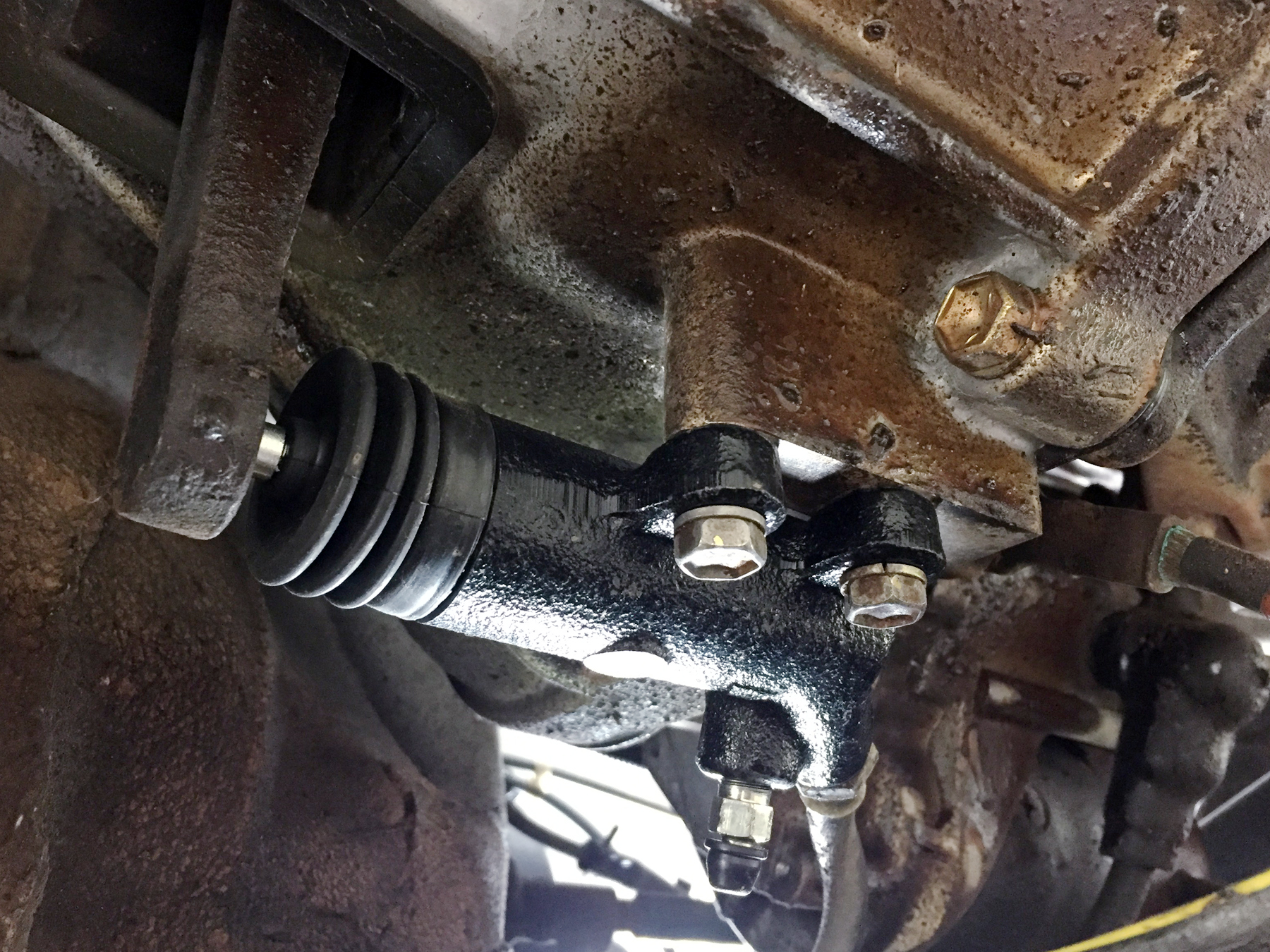

So...a couple of months ago I noticed that the clutch pedal seemed to be getting a little soft on the Troopy. I was assuming some air in the hydraulic line, so I flushed and refilled the fluid, and bled it. Well, of course, air doesn't just "get in" to a hydraulic line, and I discovered there was some minor leaking at the slave cylinder. I thought about rebuilding it, but the complete Aisin slave cylinder was available new from the nice people at Cruiser Outfitters (thanks, @cruiseroutfit ). While I was at it, I got a brand new Aisin master cylinder, too, since it was available and not terribly expensive. New master, new slave, new fluid. Should be good for another 34 years. :clap:
The new master in place:
New slave cylinder installed:

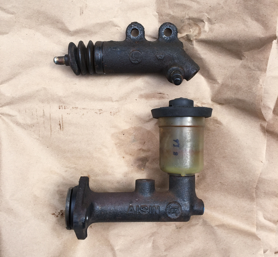

And the old ones removed:
Just so we're clear, those are *not* recovery points, they're tie-down points. I'd happily use them for a flat tow, but absolutely would not use them for any form of kinetic recovery.
