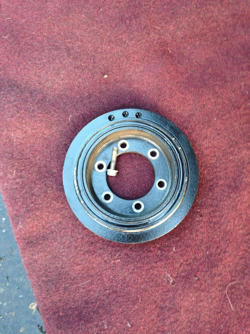

Now, here's the part that I didn't mention yet, much to my embarrassment. About 60 miles into break in, I had something happen while driving that could play into all of this. While driving down the road, I heard a "ping" (which turned out to be a bolt dropping) and then the truck started shaking violently. I dropped it into neutral and pulled off the side of the road thinking it was either something catastrophic or I had just blown a tire. I killed it once I was stopped, though the hammering didn't stop, so it was definitely engine related. What I found, hanging by a single bolt was the front half of the crankshaft pulley. WTF. No doubt user error, but this could have been SO much worse if it had come free! The hammering was actually the front half of the pulley hitting the vacuum pump, which might have been fortunate to one degree since that kept the rotating mass more or less centered. There wasn't any visible damage other than a little scuffing where the two had kissed. I pulled off the pulley, started it back up and all seemed fine, as smooth as ever. The question I have from this was whether the impact of the pulley on the vacuum pump would be enough of a lateral force to somehow mess up the main bearings.
What a terribly unfortunate error, right? I have one word for myself from this: Loctite.
I'd be surprised if that caused you problems. Everything is so massive in there. And your timing would not be affected, even if that pulley ripped off.
I am surprised it happened though, I don't think the manual calls for thread locker in there.

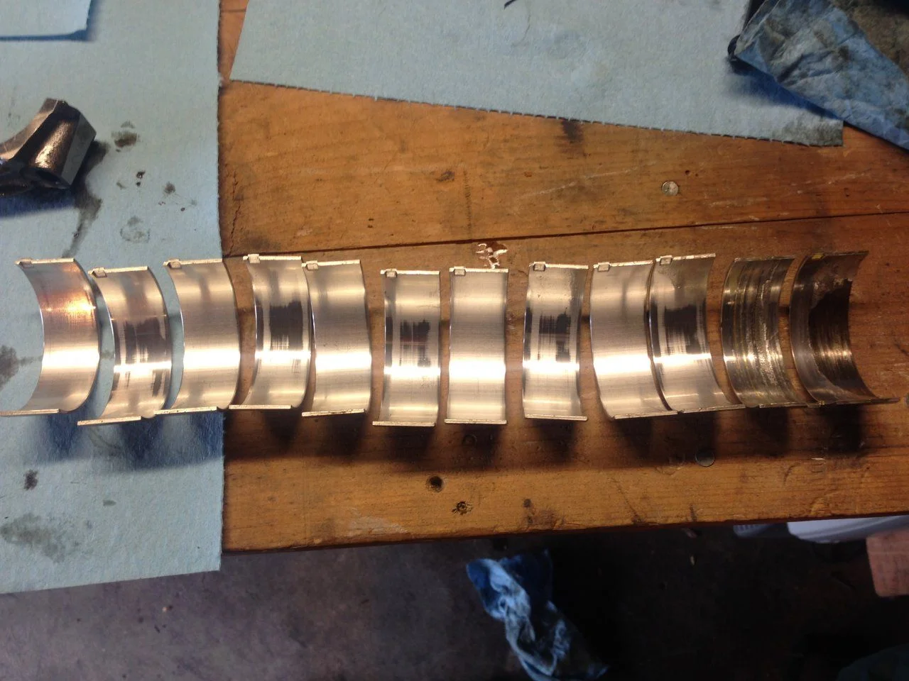

Any idea what happened yet? Are the wiped out rod bearings together 1-2 or a like? Looks like those rod ends/crank got really hot. How are the crank journals?

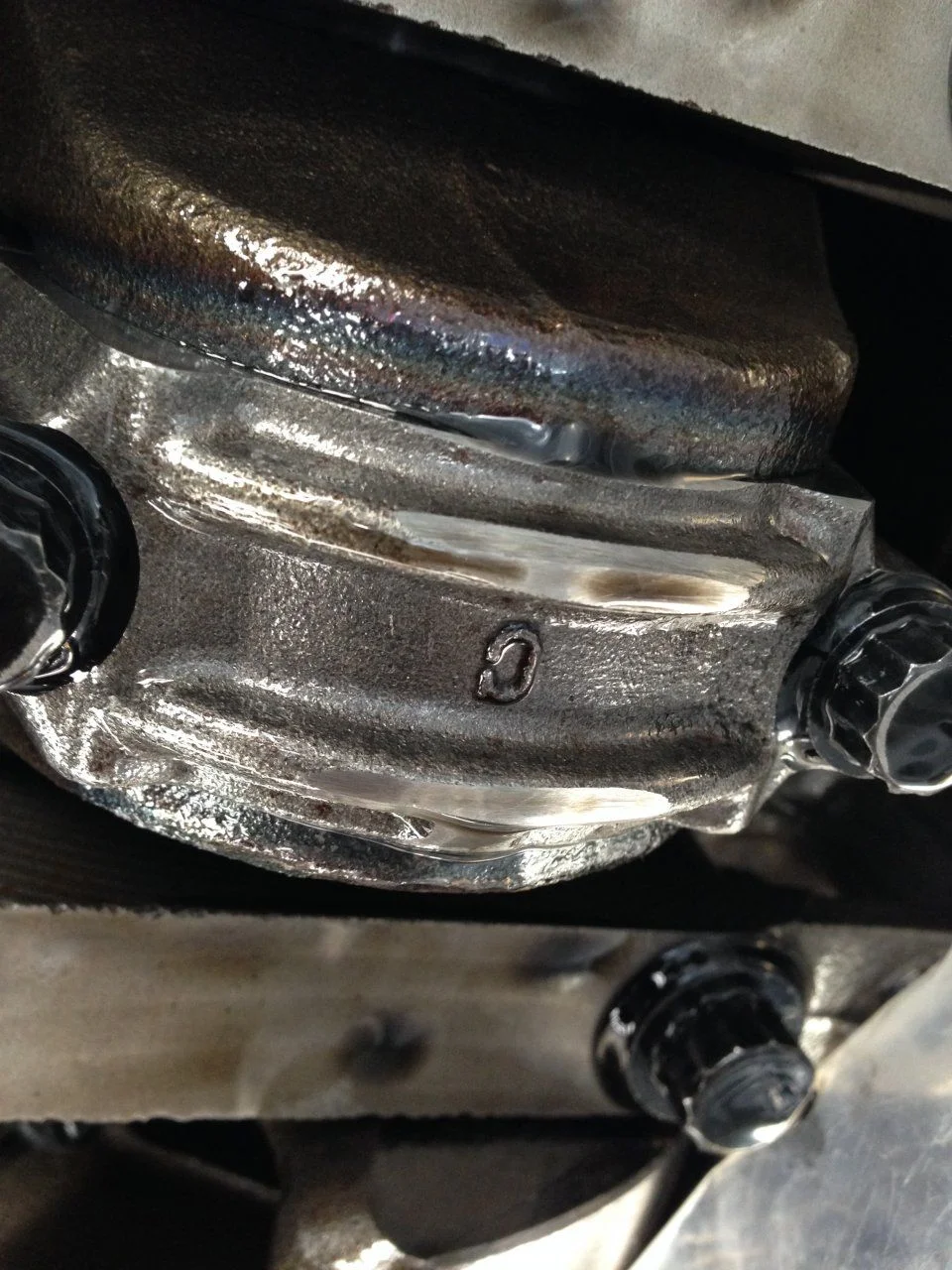

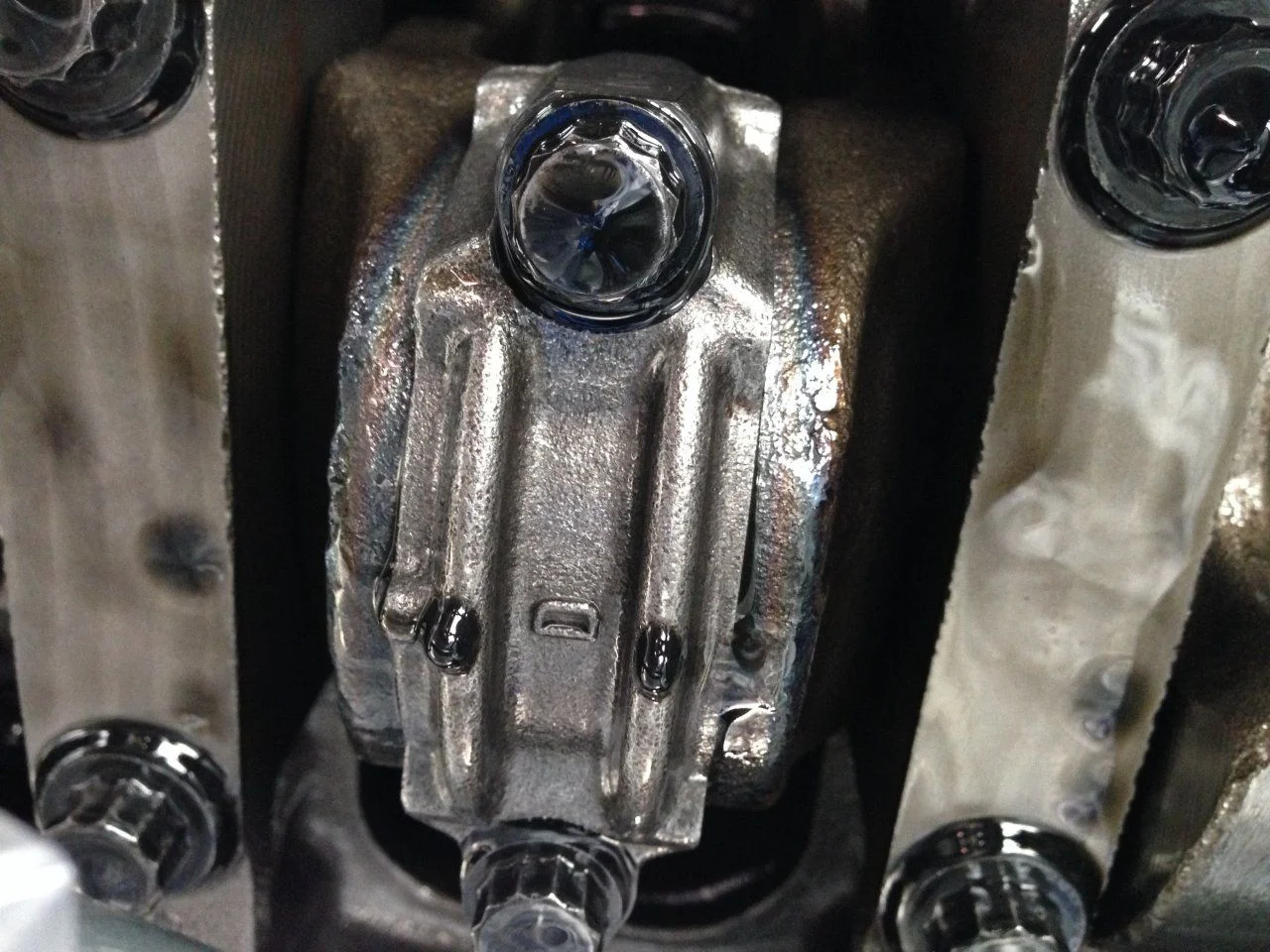

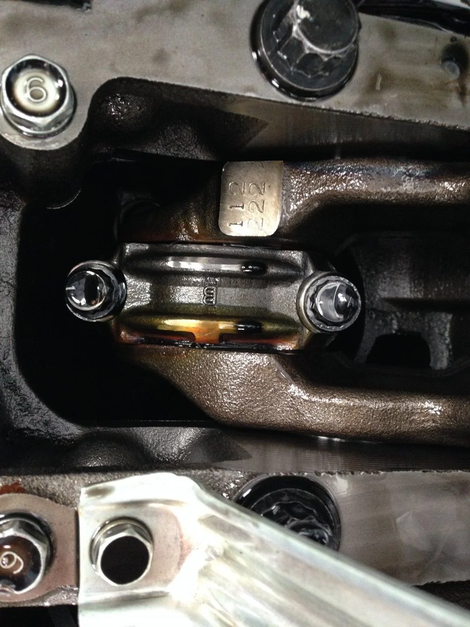

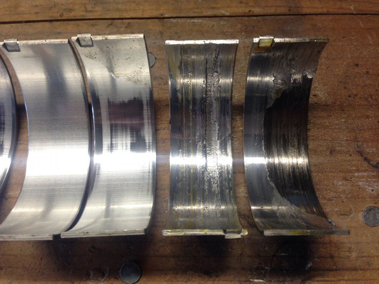

No idea what happened yet, except that the #6 rod bearing definitely wasn't getting oil, or didn't long enough to do some major damage. Horrific photos below:

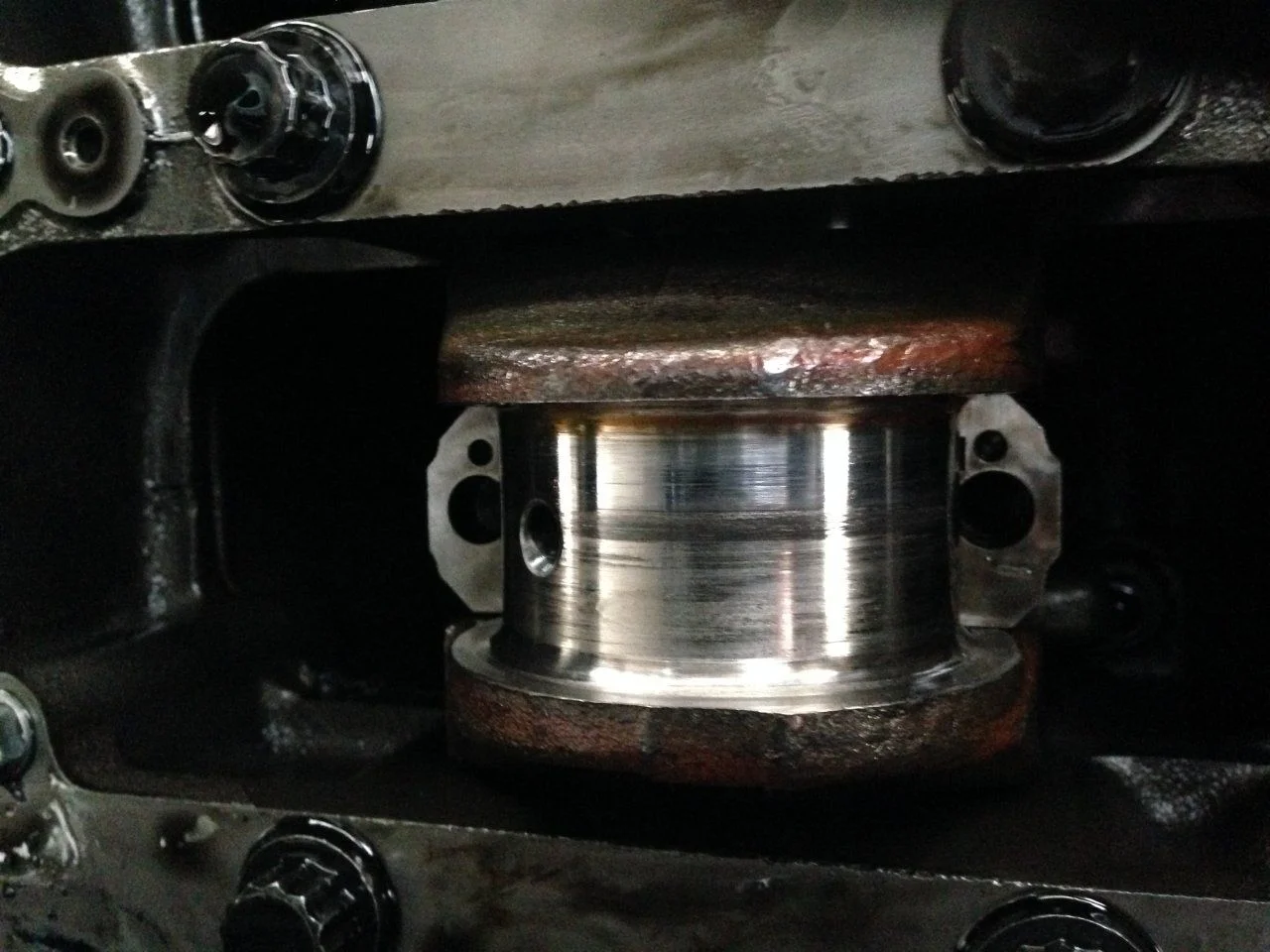

I was hoping maybe it was just limited to the bearing which would be easy to swap out, but it's not the case unfortunately. Scoring on the crankshaft journal as you can see in the 2nd photo below. And not only did the bearing get burned up, but the conrod was rubbing against the crankshaft so they were wearing away at each other so it has play front to back. What are the chances that this had an effect to the block as well?
Can you see the groove? Probably hard not to.
Open to ideas and suggestions about how to proceed from here, I'm at a total loss for what to do and why this even happened.
New bearings ,new crank(if needed) and check oil pressure as soon as it starts. Cant see how the block would be affected.
Ive never used Loctite on the crank pulleys Ive done(maybe 4-5 that I remember). They are not under a big load and they have 6 bolts.
Interesting, those bearings tell a story. Looks like low oil pressure but there is a huge difference in bearing condition from 5 to 6 suggesting possibly a plugged oil galley as well.
