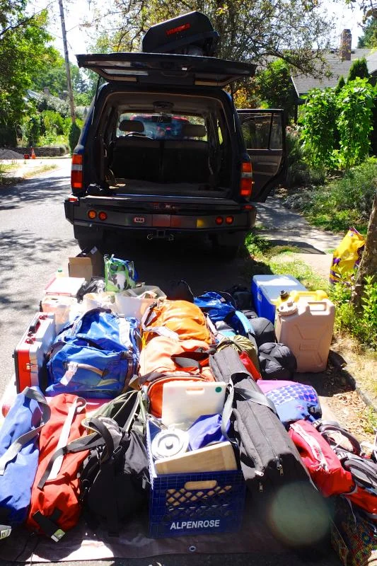

Just for my own amusement and reference, this is the load I'm carrying. Mostly camping and climbing gear, nothing extreme. The cooler was replaced with a fridge (BEST INVESTMENT EVER, imho that is) thanks to Tor picking one up for us so we could just collect it on the way to Canada.
