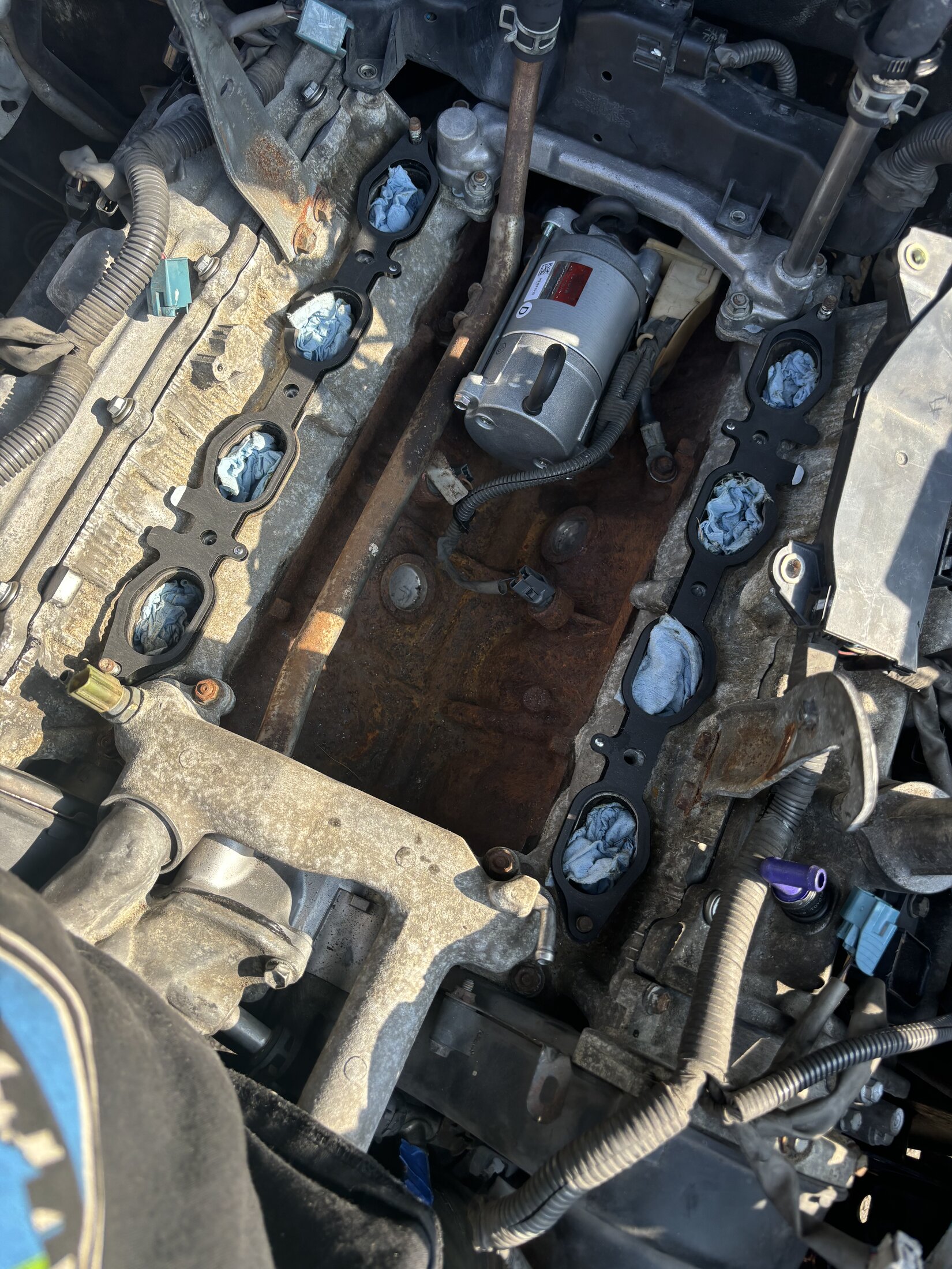

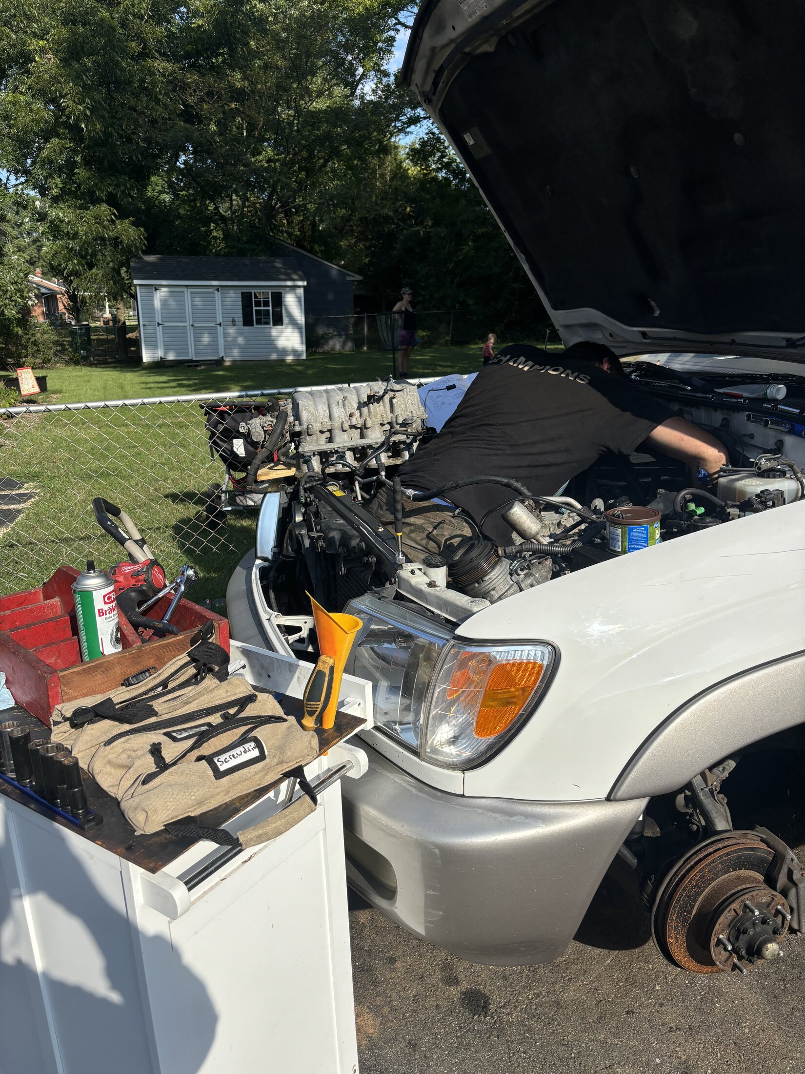

Been a good week. Got AC compressor installed, starter and intake manifold back together. All wiring is connected, power steering back together. Took me forever to get to transmission cooler lines routed correctly but finally got them attached and snug. did a lot of hose and wire connecting last night and the last thing to install is the radiator and related parts
Next steps...
Install Radiator, Fan clutch, Fan, and Shroud
Flush Coolant
Flush Power steering
Start Engine!!
Flush Transmission
@LJE I refilled transmission with at least a quart less than came out (6 vs 7 quarts) but the diptick is reading really high. This is just because the fluid has not yet cycled anywhere right?
