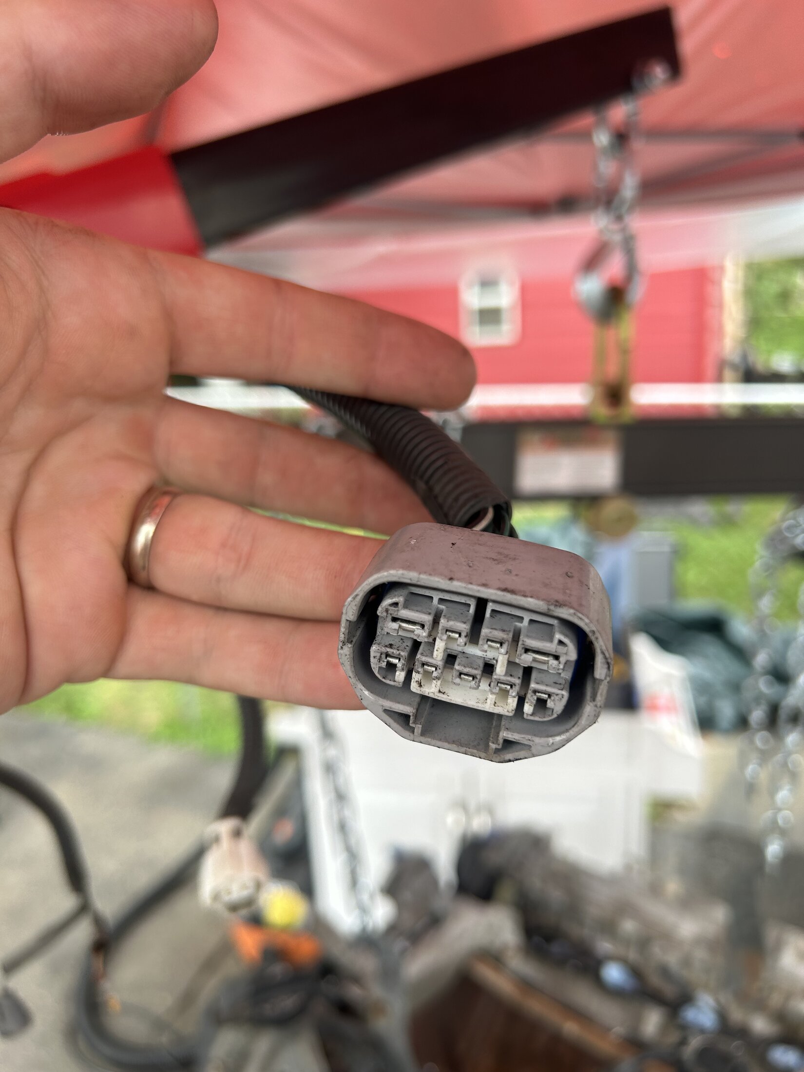

Ok so I love gotten to a weird part of the wiring harness. Differing connectors for the largest transmission connection. Here is the old vs the new and where it connects. There are the same amount of wires but I'm not exactly sure which wire goes to what. This is a 99 LC engine to a 2000 LC. Transmissions are the same so I'm confused about the different harness. There's a chance this harness came off a different vehicle even thought the engine is the same so I may have to reuse the full old harness.
Your pictures didn’t attach. That said, I would just reuse your old harness.
New harness connector completely jacked up somehow....
Old harness connector
Where it attaches to the transmission
I think my only option without getting too into the weeds is to reuse my old harness. A little sad because I messed up a lot of the injector connectors not caring when removing them so I have a lot of repinning in my future....

I *think* that's the neutral safety switch (though, could be totally off there). Odd that it's different for those years!
I suspect the harness came off a tundra or sequoia 2UZ seller had mentioned they cut the original one and had to fix their mistake and get another one so that's what I'm going with. Swapped over the harness phewww now need to go back through it more thoroughly another day and repin any broken connectors. Thankfully I have a decent stack of unbroken spare connectors.

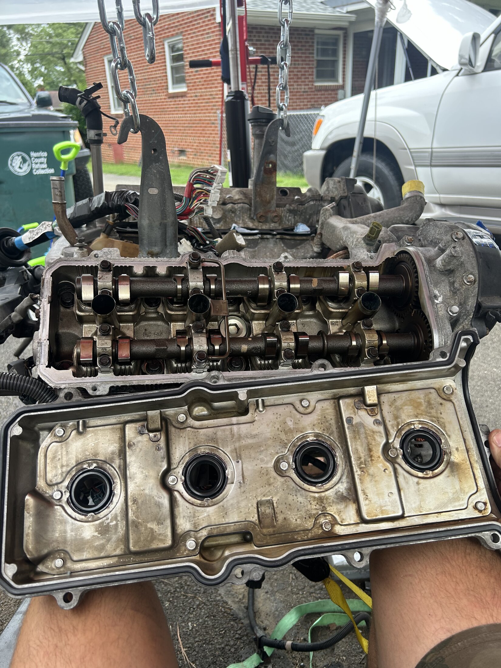

been a busy week and just got back from TX but I was able to get some good time on the engine last week. Transferred over the old harness and replaced all broken connectors. Cleaned all connectors along the way and made sure all was routed properly. Valve cover gaskets, spark plug oil seals, new tensioner pulley, header heat shields, new oil pump hoses, all spark plugs and coils final install. I cleaned up the throttle body with a new gasket and cleaned all injectors. New rubber all around injectors and cleaned the fuel rails.
After adding some oil and cranking several times over I scoped the previously questionable cylinders and they looked pretty great so I'm not worried anymore.
