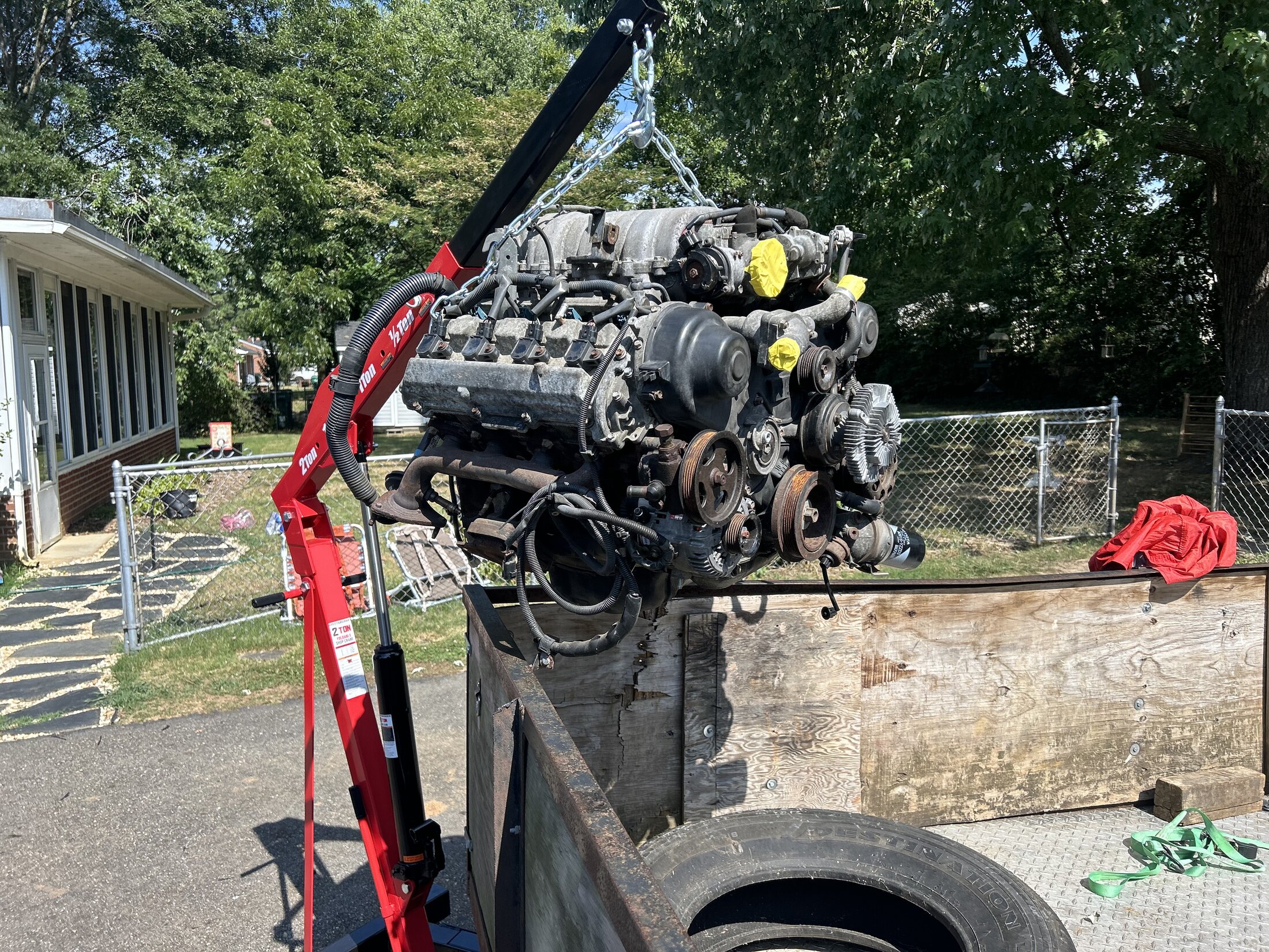

I will try and update this thread with progress and findings as I go along. Pic of the donor motor attached.

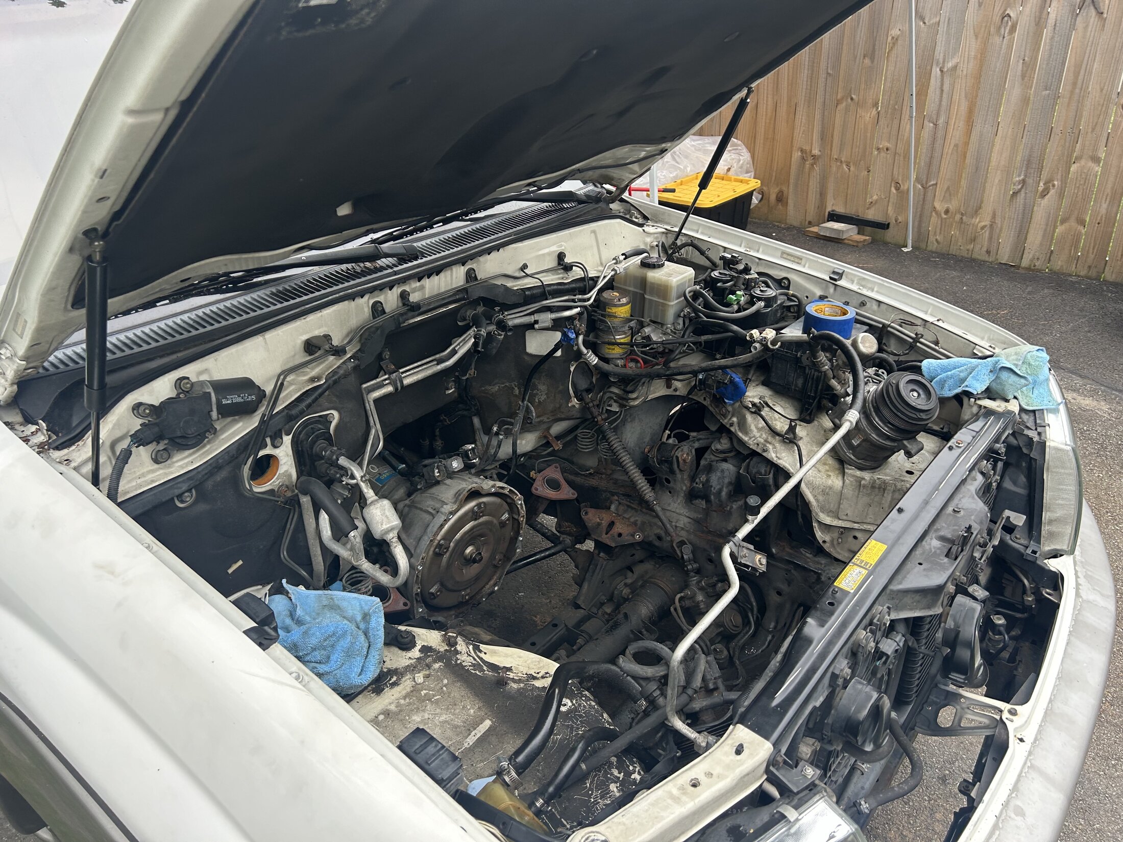

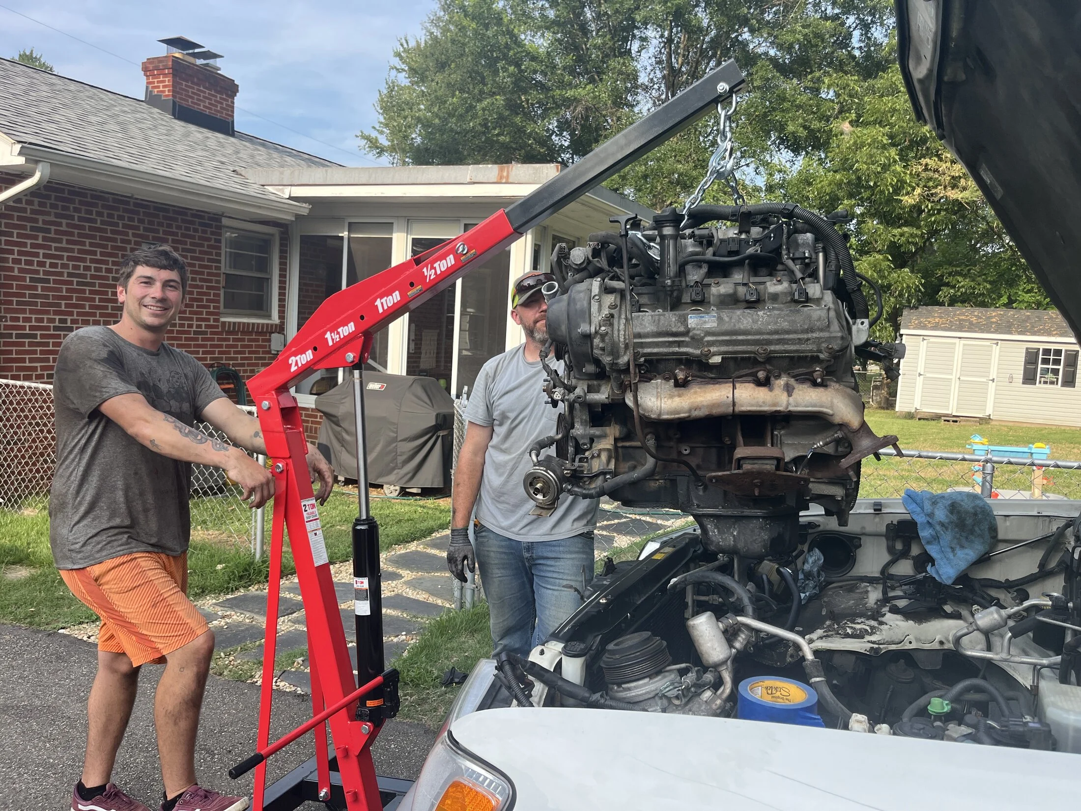

motor is out!! This pic is the motor fully free just not lifted out. Not too much trouble, the torque converter did try and hold onto the motor but with some pry bars was able to keep it w the tranny. Some weirdness with the trans cooler lines but we took them out altogether and it worked out. It the future we know to leave them in and disconnect the o2 wire that wraps around them. Thanks a ton to @Land Shark and @Toyodajunkie who lent a hand.
Hey that looks familiar! Those dang trans cooler lines threw me for a loop when I went to pull my engine out. Pro tip - when you go to put the engine back in, don't connect the passenger side O2 sensor to it's wiring prior to putting the engine in - you'll need to route that wire around the trans cooler lines. That's fresh in your mind now, but if you're like me, you'll forget that by the time you go to put the other engine in... haha.
Good call thank you!
