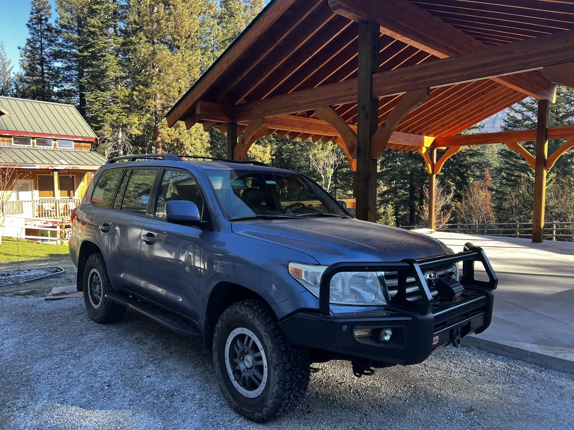

Few weeks ago my truck developed a pretty bad knock that was coming from near the passenger side valve cover. Did a lot of research here and was convinced I was in for a broken valve spring and maybe a new motor. Turns out the belt tensioner had failed and was the source of the knock. Glad this 215k motor will live to see a few more days.
