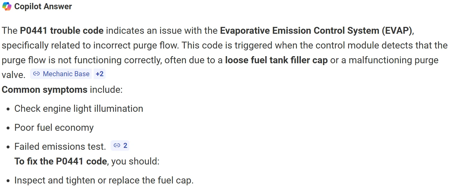

Code is P0441. Is this consistent with a loose gas cap instance?
Thanks guys.
Yup:
HTH
