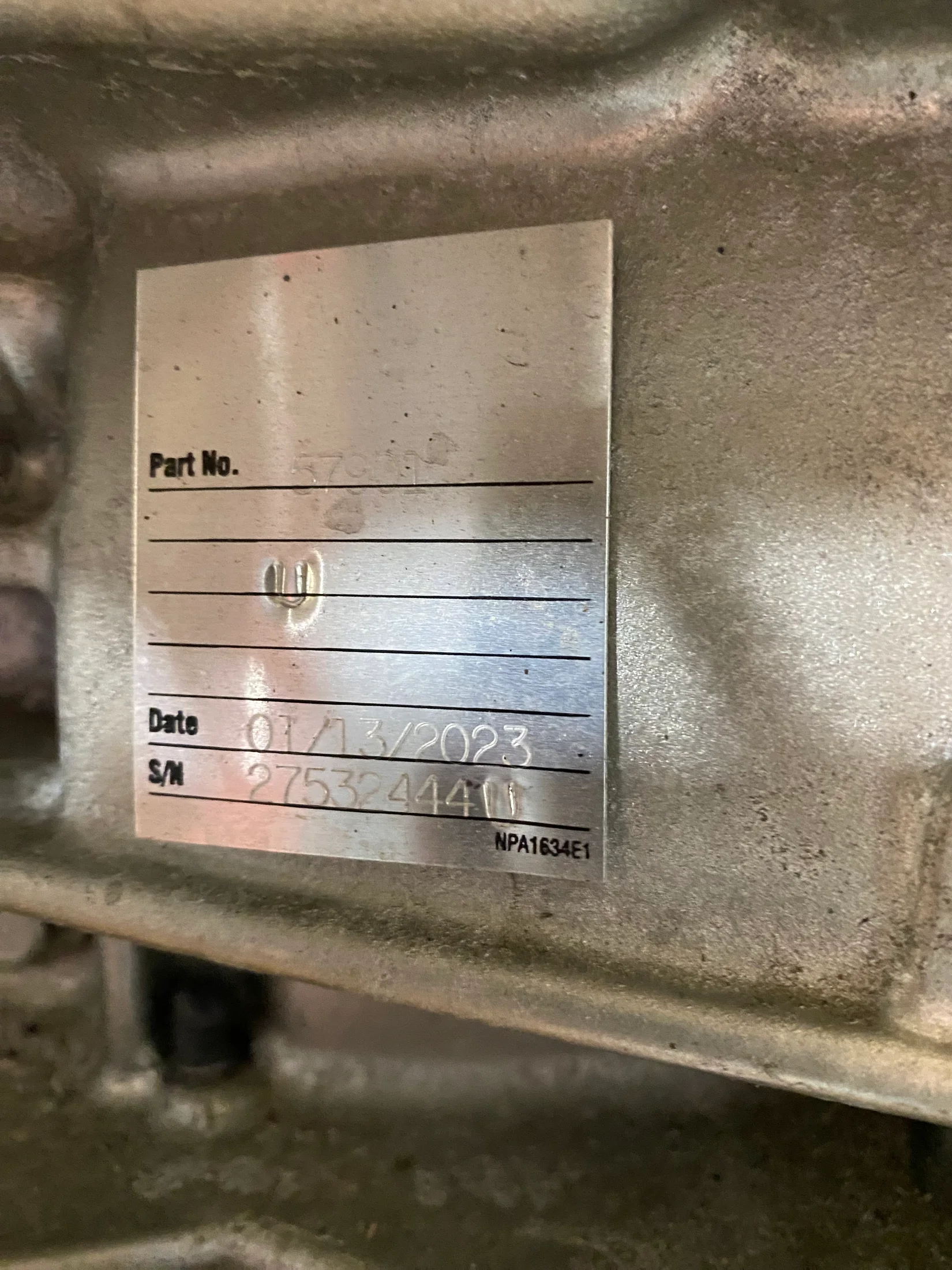

This tag was found on the failed engine today.
Is it a Toyota tag?
Is it a salvage yard engine tag?
Opinions?
Where on the engine? Any heat tabs? If it came from a yard 99% it would have heat tabs on it. A remain from Toyota, I have zero clue about.
Yes there are heat tabs and it is confirmed as a salvage engine. I think the tag was placed by the salvage yard that the engine came from. But we don't know.
If no one else has a similar tag on a OEM engine then that narrows it down....
