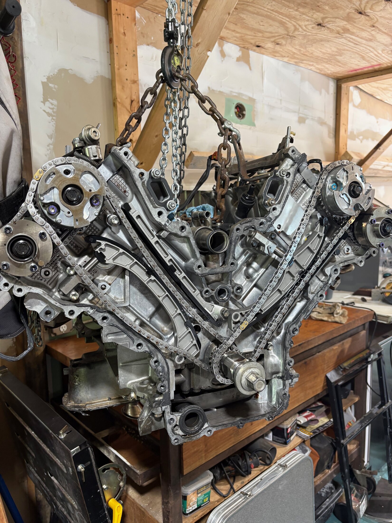

The JDM engine is in hand.
The fubar engine has been extracted.
More photos pending.......
Now we got some meat....

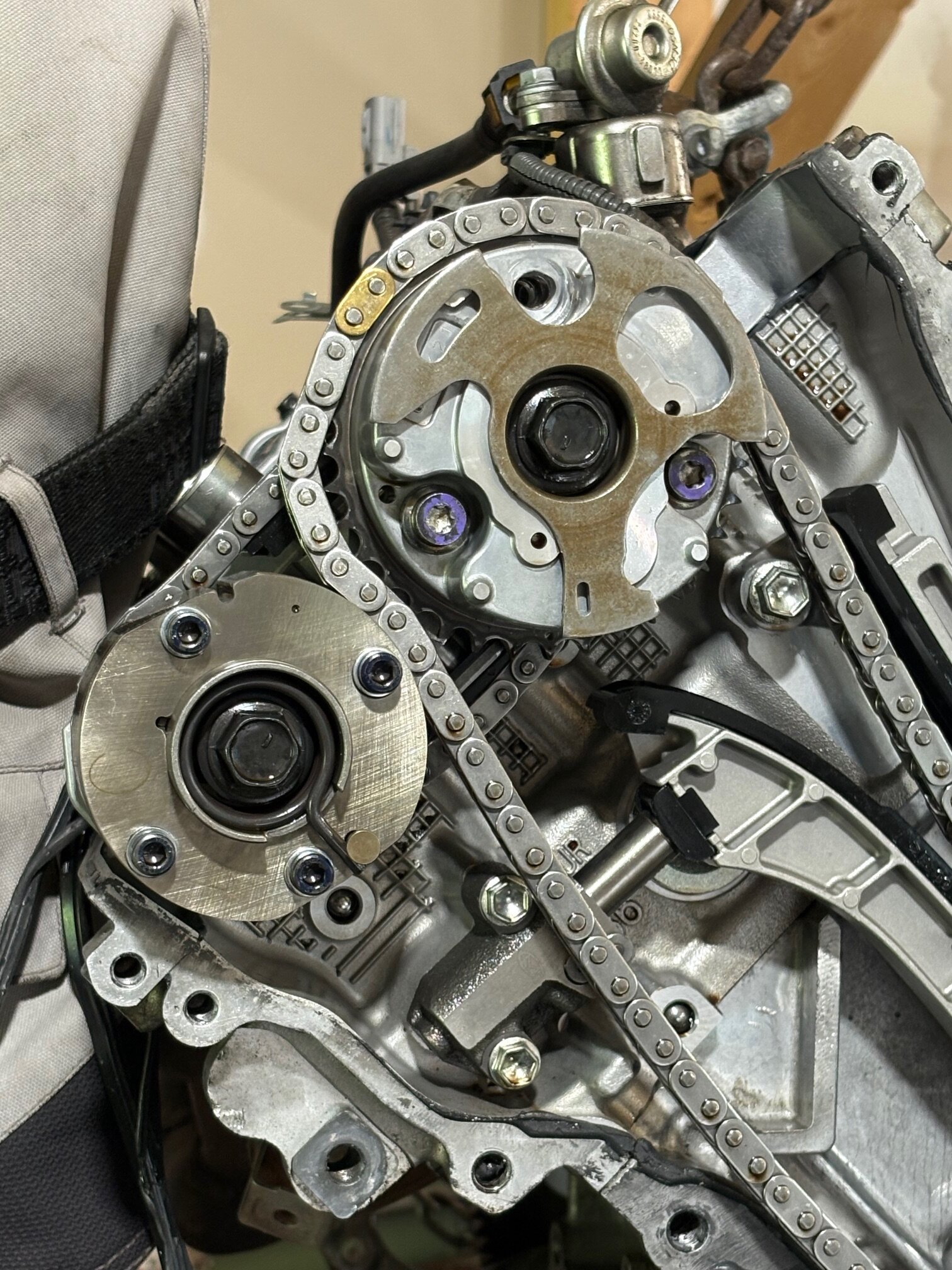

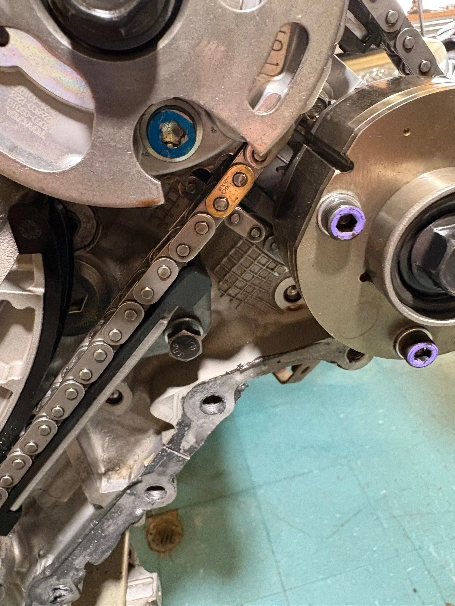

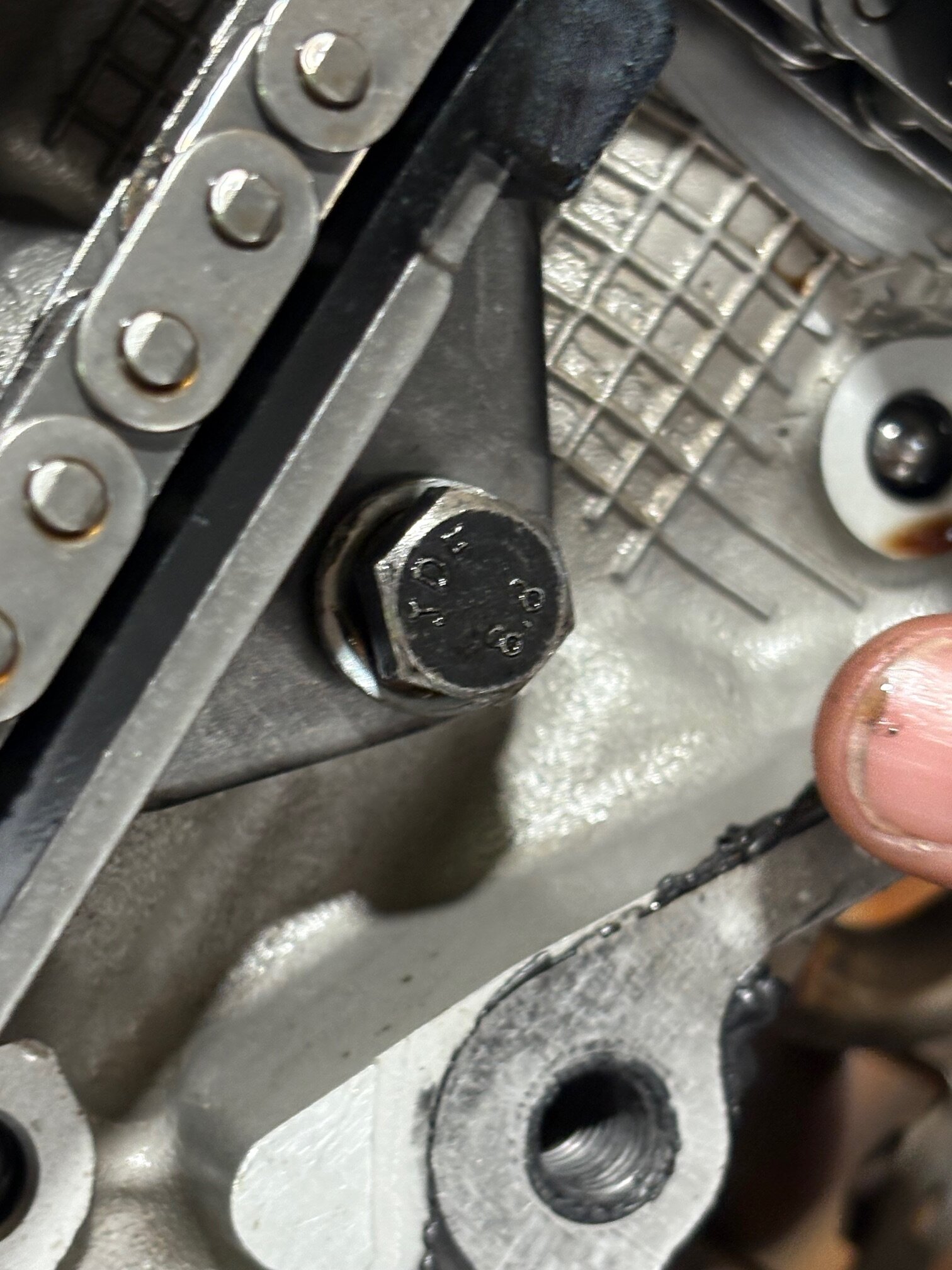

It looks like this was human error on the part of independent "mechanics" as best we can surmise on my end. Someone got in to this engine and perhaps did not torque 3 bolts to specs. One sheared and 2 backed out. Also note one bolt as non - Toyo. Looks like a hardware store substitute.......More info forthcoming...
Is that bolt even making contact with the washer? At least they didn’t skimp on a zinc coated mild steel option.. I guess.
I’m sure we’ve all had to do some questionable repairs just to hold you over until you can get to a parts store or home or whatever, but a hardware store fastener inside the timing cover is wild.

This is the old fubar engine. I will try to mark up the 2 bolts that evidently just backed out and one sheared.....
