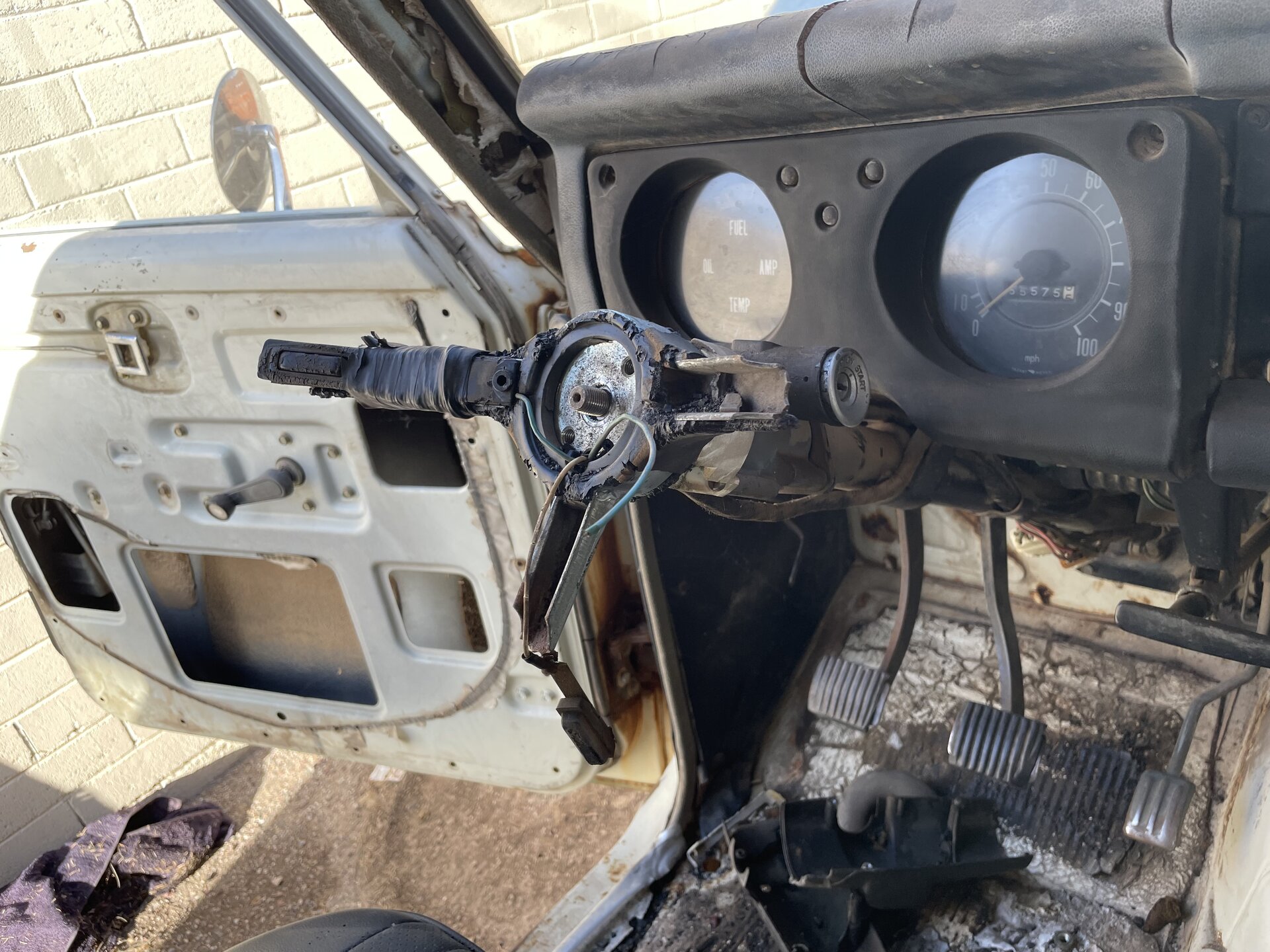

The pig has been posted for 2 years without moving an inch, so we went down to Vato Zone to pick up the materials needed: steering wheel puller and extra fluid for the brake job. Will and I share a mutual appreciation for road soda indulgence, which is of particular importance when trying to figure out the mental gymnastics of where I left off on this project some time ago. Now I cannot stress enough how novice I am when it comes to working on rigs. Don’t get me wrong, i am down to put in the work, but it has become apparent that my writing skills far exceed my capacity to make determinations on vehicle repair. This is where Will comes in and crushes the game on the Ranchero Build.
We started with the steering wheel, small victories for the momentum. It was easy peasy, and a quick road soda victory celebration was in order.

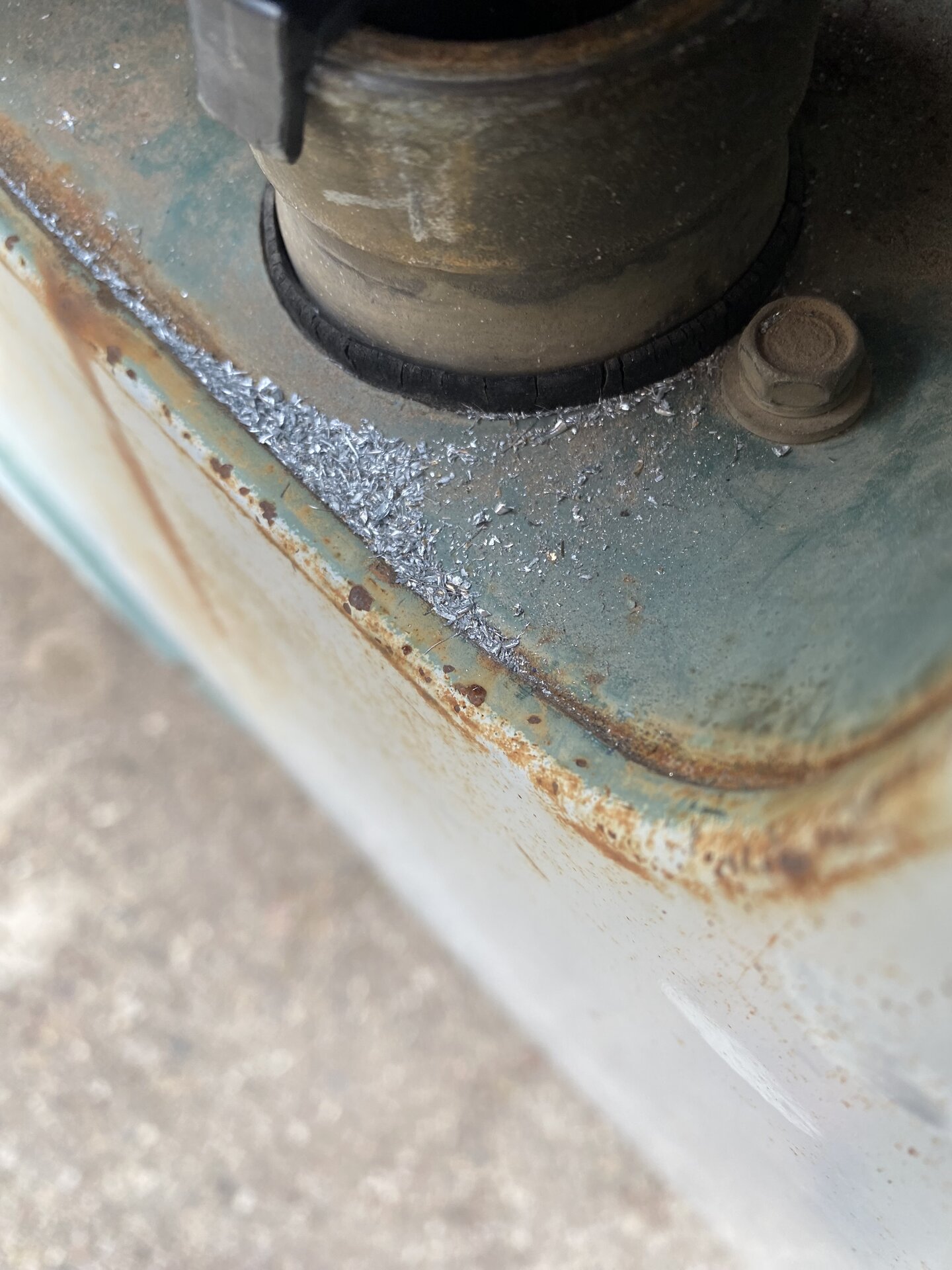

Brake bleeding is not a glamorous job, so therefore, there is no documentation of this process. Long story short, the job was a success and the pedal is nice and firm. Rookie Mistake on my part to fill up the radiator with Tucson's finest aquafina, which according to Will is a close second to the water up in Flint. Who am I to argue when the t-stat looked like this when we took off the cap:
Did I mention I know ****all about mechanics? Our saving grace was that the calcium was isolated to the housing and did not (fingers crossed) travel throughout the rest of the power plant. A trip down to O Really's to get some proper radiator Gatorade, as well as Circle K for the Dino Juice, and our spirits were flying...

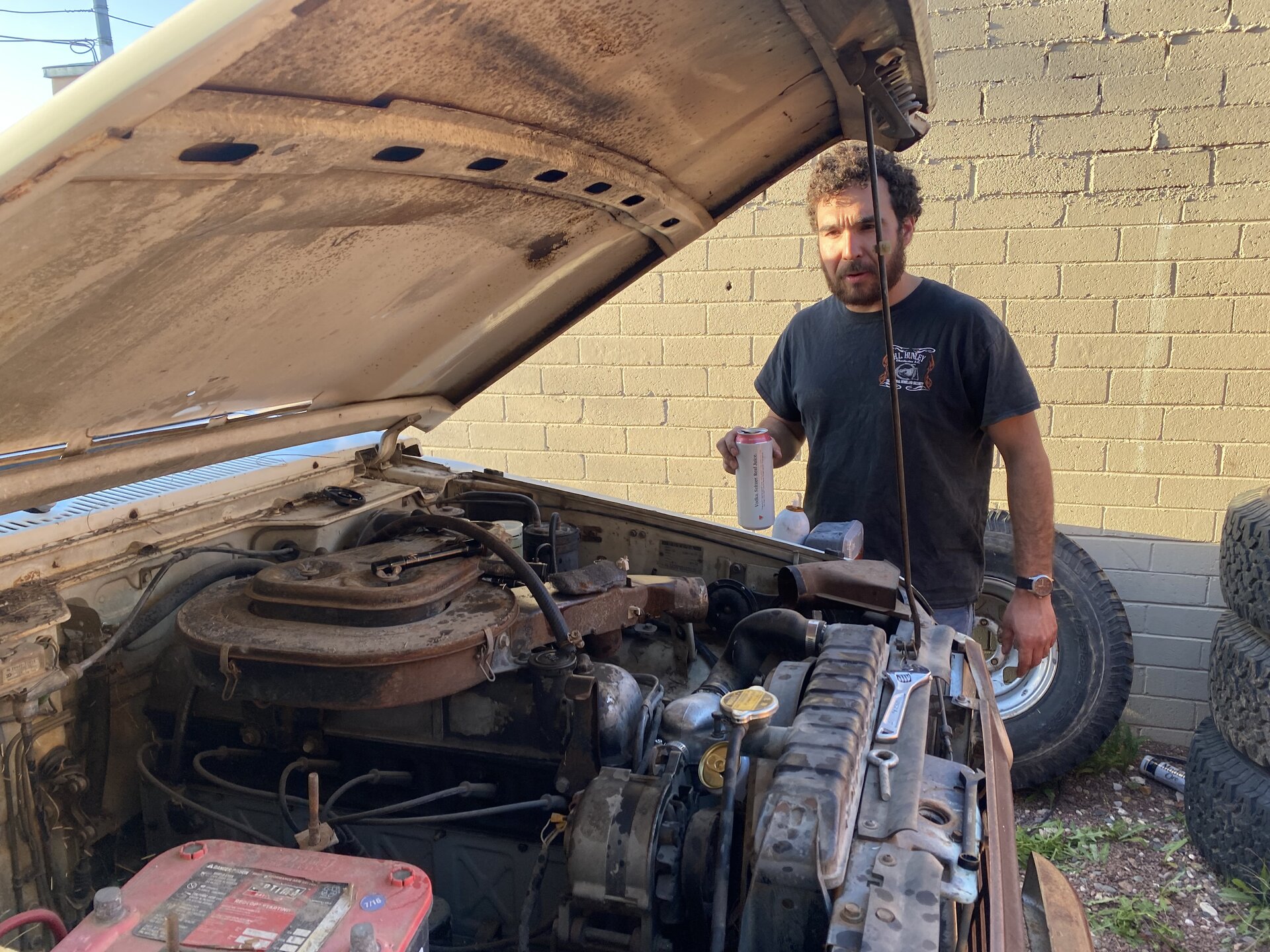

.... But Edgar's Wonderful Horrible Life is never cut and dry, so when we were buttoning everything up, Will checked the clutch, weak sauce. We bled it and got a little firm, so we weren't going to test our luck with driving the rig, particularly since we were burning the midlight oil and the Arizona Sun was no longer offering us her warmth.

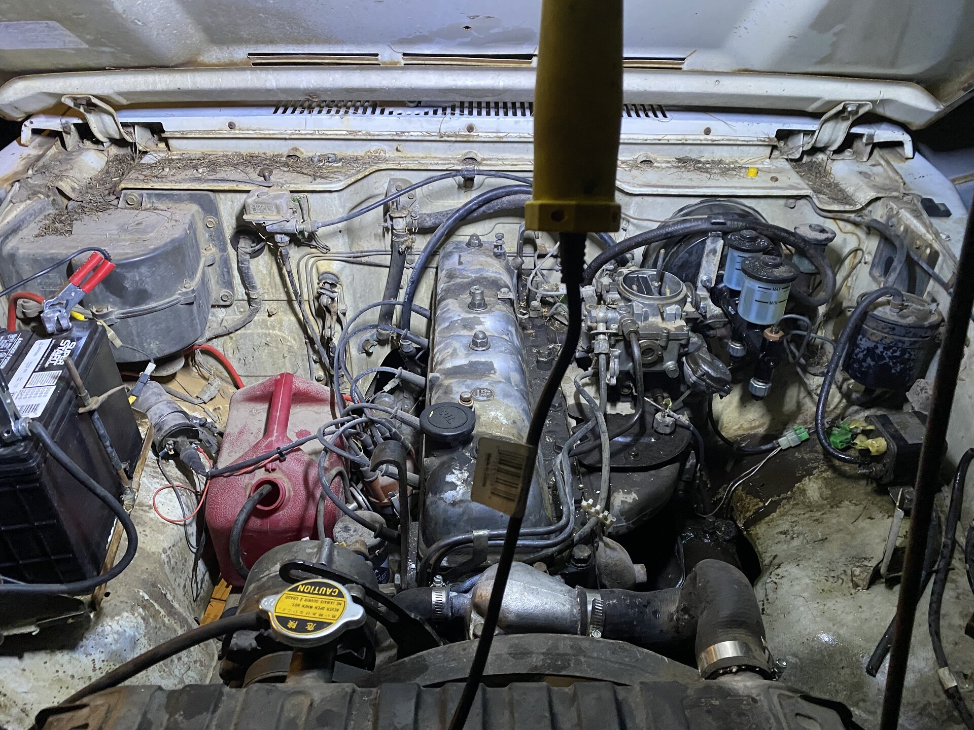

We were Suited and Booted, and everything was a go, No Thermostat? No problem. We just wanted to hear this little piggy hum. Fuel, Spark, Air.

Obligatory Rancher Build engine bay money shot.
Had a blast getting this piggy back to squealing and shouting!
I'd say 12 more Mexican brown waters would get this thing going, but knowing how we work we're going to need a 24 rack. We'll be cruising down to the Shelter in this thing come Saturday evening!

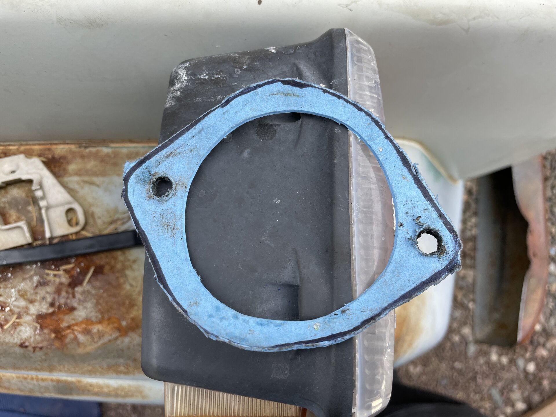

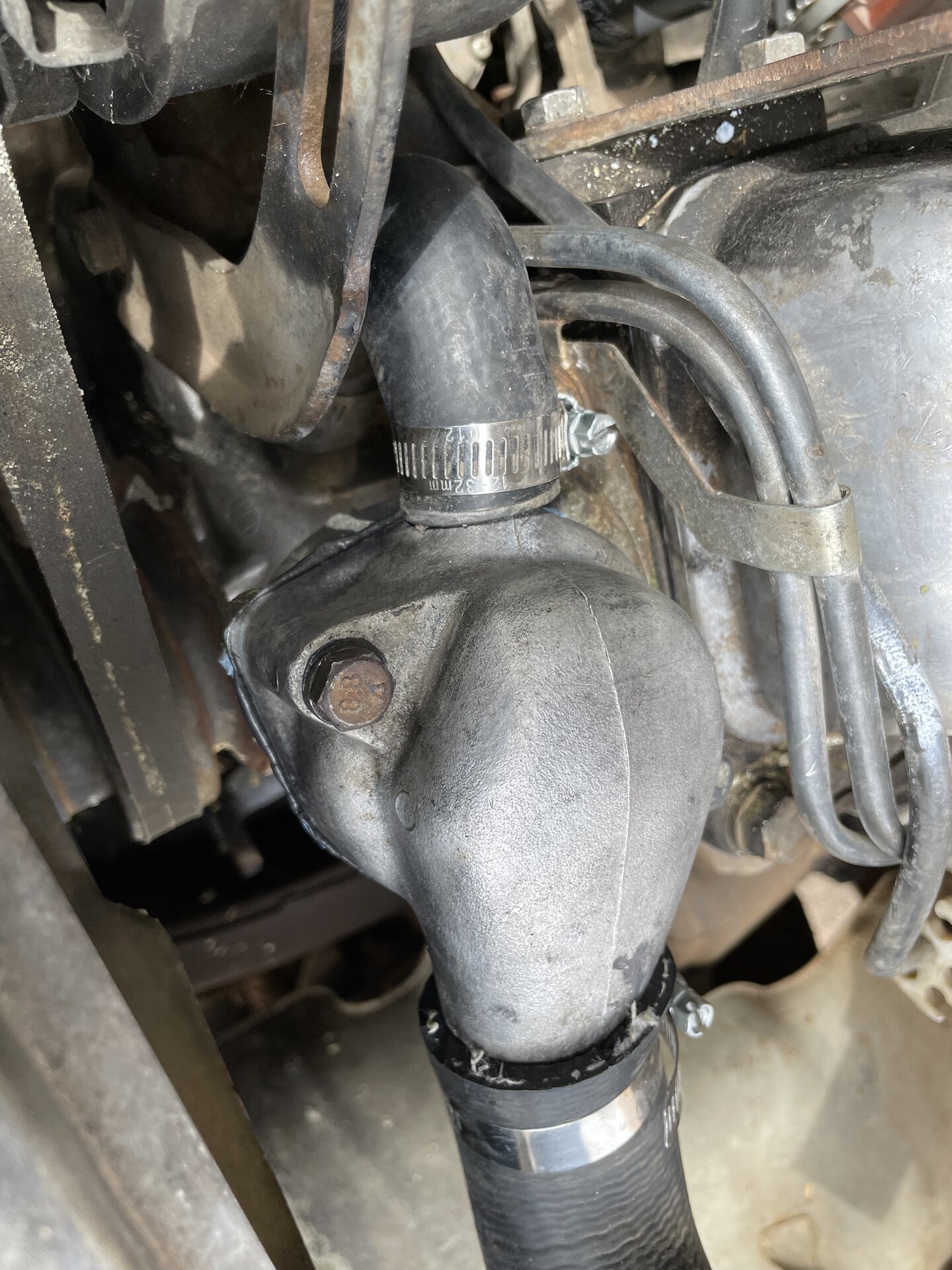

We were riding high on the momentum of the replacement, but lo and behold, the gosh darn Tstat gasket did not fit, this is something that you should all be mindful of when ordering the part, specifically for this year (76), we were 0/2 on this gasket, and so we strolled on down to Earl's for a gasket. Hell, while we're here, let's get some hose clamps for the fuel lines too! (apologies to the Great Grogan for not buying OEM clamps, I live in shame.
Earl's did not have the gasket either for the Tstat, so we bought some gasket maker and some road sodas for inspiration so I could professionally to fab one up.
I and really thinking about potentially starting a small business where I make replacement Tstat gaskets because this thing looks, and probably is, better than OEM.
Here I am reviewing the fitment with laser precision. I used an Eggs Acto Blade for accuracy, she fit like a slipper.

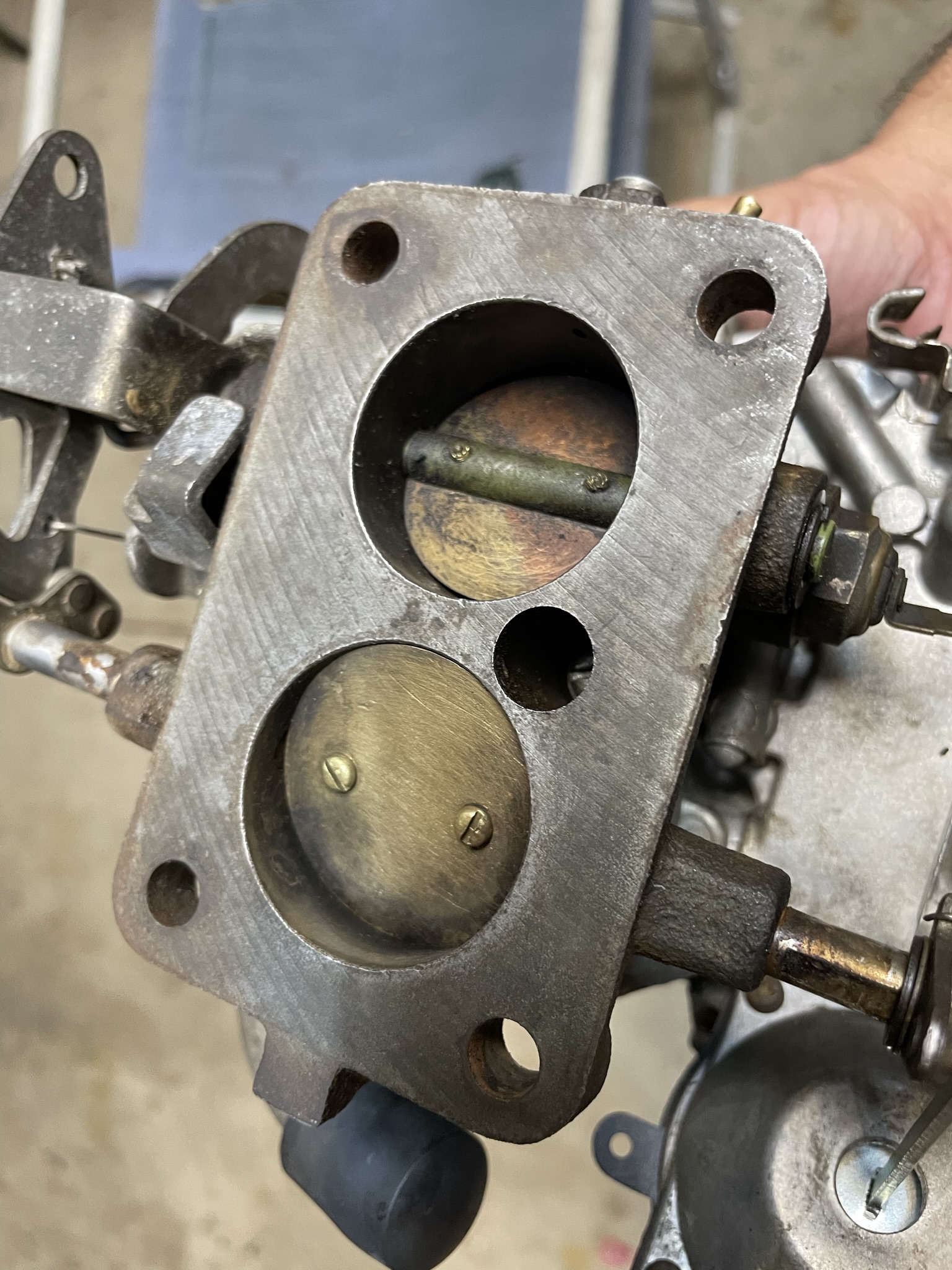

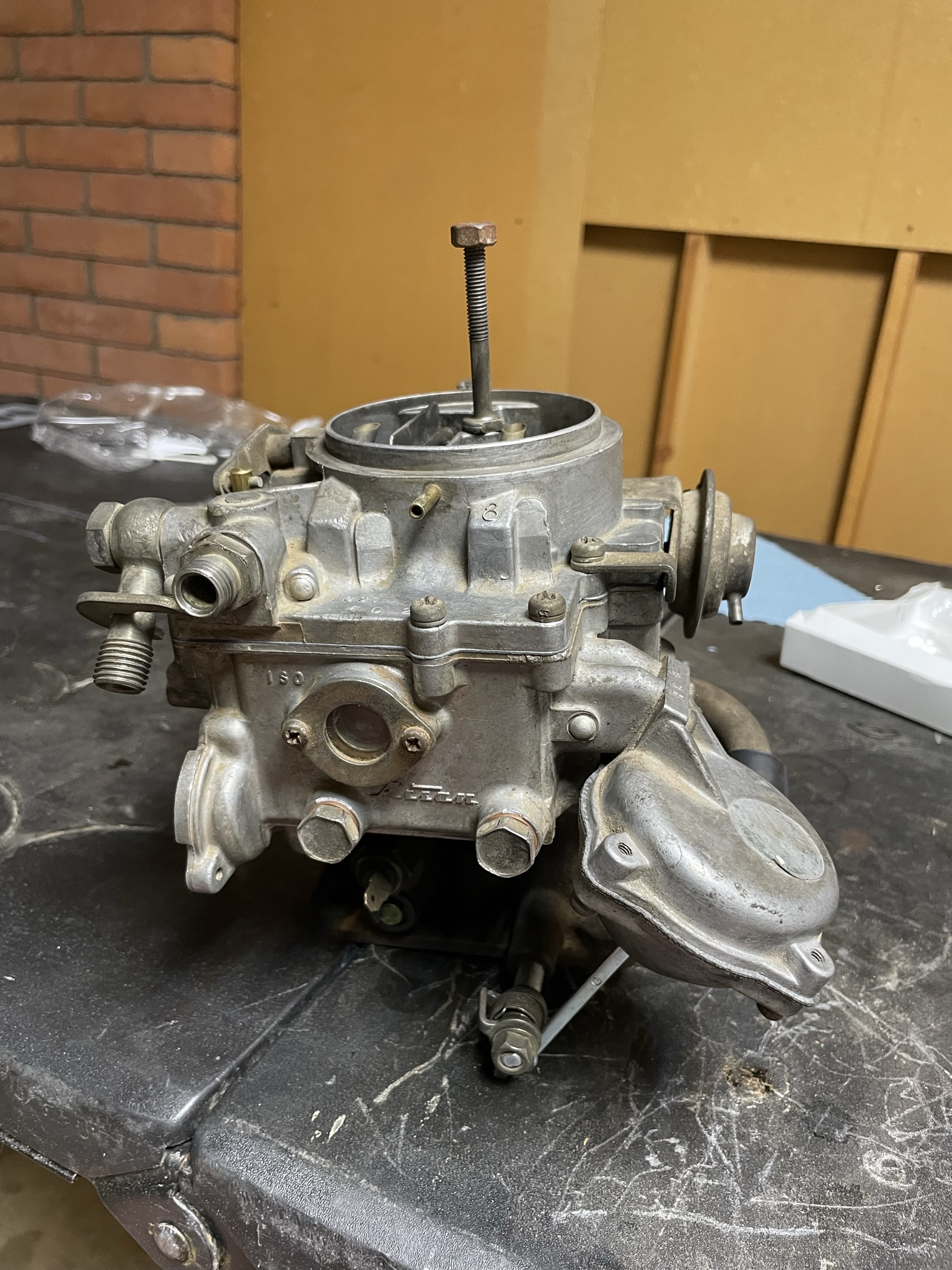

Finally got the old carbonator on the table and man she's gathered some dust sitting on my shelf for these past few months - she's been neglected as I've chased my own tail on my new 60 series.

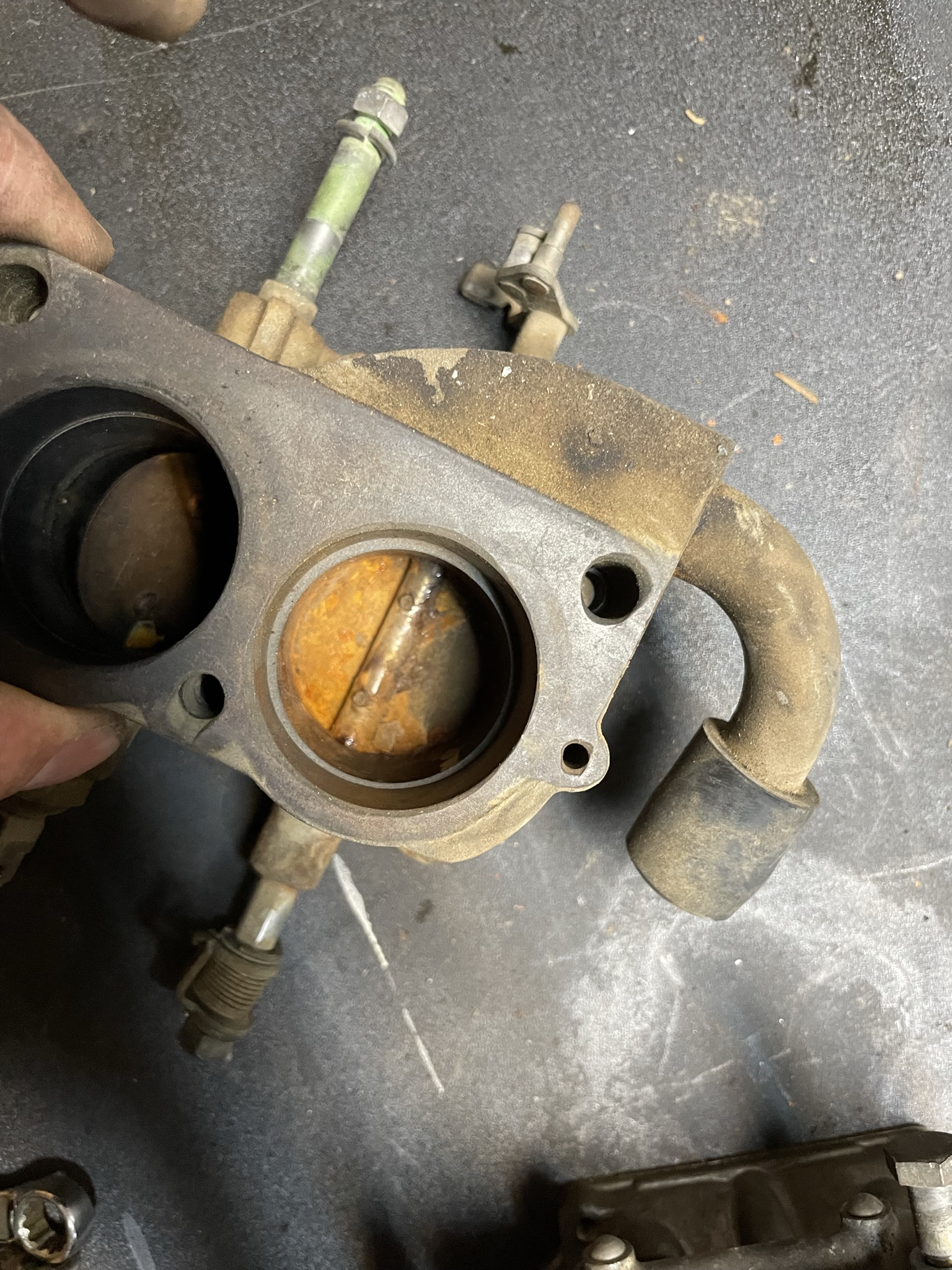

It's a damn good thing it started puking when it did, otherwise we would've been rear ended when the secondary didn't work and couldn't get out of our own way. It was completely rusted shut.
I let it soak in some PB, hit it free with a hammer and cleaned it up as much as I could. I am happy to report it's 100% functional now.
Here's the final product - don't think I'll be putting Jim C out of business with this rebuild but its good enough for our ranchero roadkill we're resurrecting,

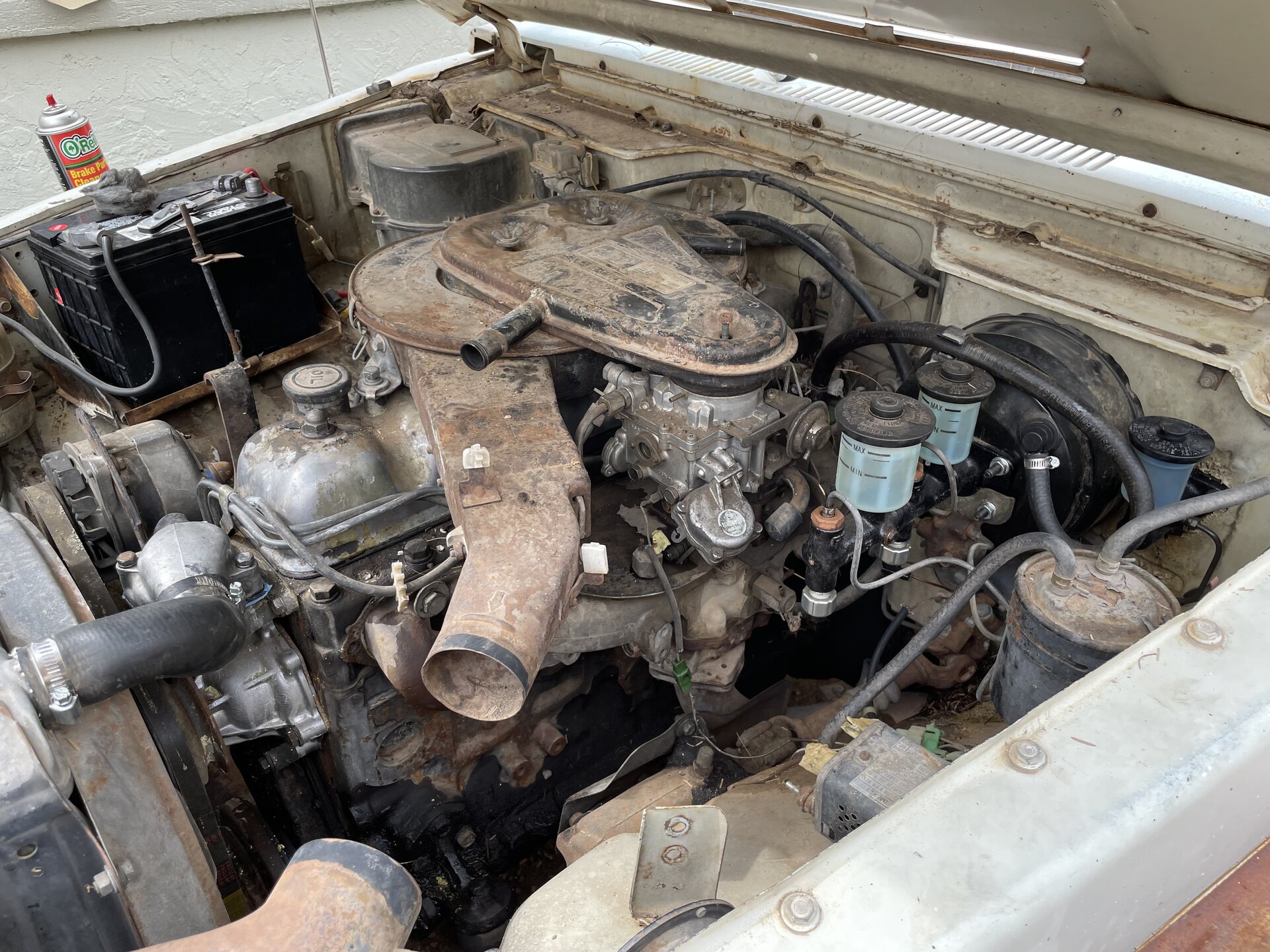

The carb needed some adjustments made, and I did try to hook up the vacuum lines via a vacuum diagram I had found on here. This piggy isn't CA legal anymore after Manny's handiwork so I definitely think I hooked them up wrong. With vacuum applied to the diaphragm on the right side of the carb it would die immediately and wouldn't idle.

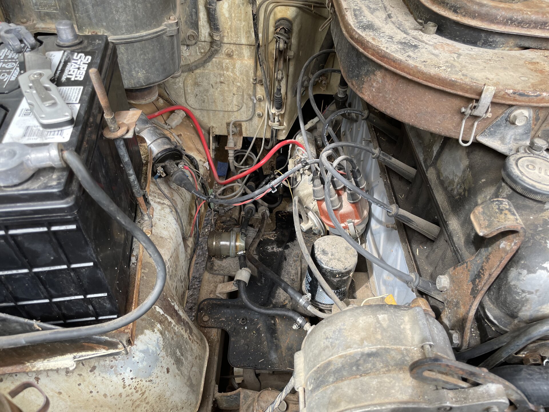

One matter that is extremely pressing is to fix whatever gypsy bull**** was done on the alternator harness. Just on our short test drive the wires got so hot that it burned the insulation right off. Any chance we could get an entirely new wiring harness? The PO had installed a HEI distributor and did some seriously sketchy stuff. It looks like he removed the voltage regulator as well as the OEM igniter harness.
I'm also thinking that our intermittent hard start issues are due to the fact we are not running a factory igniter, as well as having the vacuum hoses hooked up by a guy who knows diddly **** all about the vacuum system on these.
Anyone have a diagram or any recommendations on how to route these properly with a desmogged rig?

So have you set the points and timing?
Do that first and then proceed to carb adjustments.
For vacuum advance distributors, you need port vacuum. If you don’t know which one that is, just plug everything off for now, it isn’t necessary.
Didn't set the points since they were swapped out with a Pertronix ignition assembly when the HEI dizzy was removed.
Haven't screwed with the timing at all but definitely will look at it.
I was able to find a wiring diagram for the piggy and looks like we're missing all sorts of safety s*** on the alternator/ignition wiring. To get it safe again it looks like we'll need a ballast resistor, voltage regulator and the factory igniter setup. If we're going to run the stock distributor it's the only way we can go.
