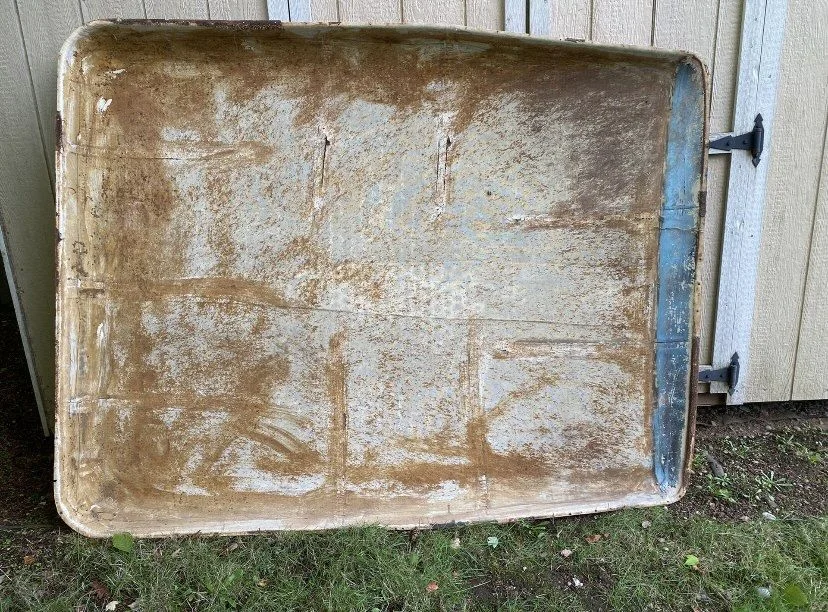

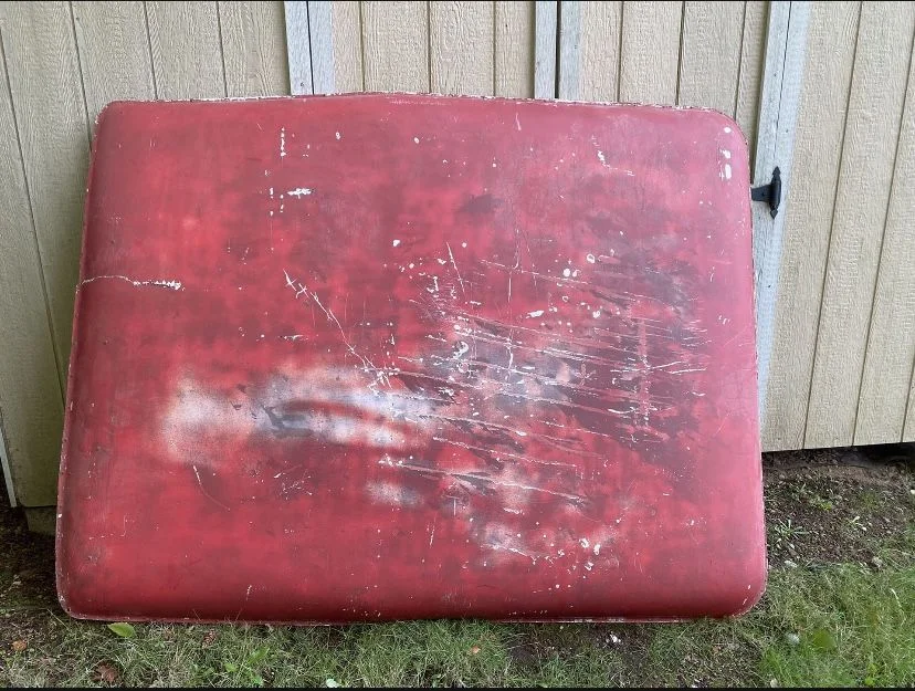

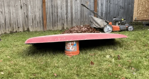

Can anyone tell from these pics if this fiberglass top is a pre-65 or the later variant? I asked for a better side profile pic.
how about just getting a measurement across the rear cargo area? side to side
the earlier ones are wider than the later ones
Thanks, I can ask for that.
I am personally not looking for this top cap for me. I just saw it and thought someone in the early cruiser community might want it if it was indeed a early top cap. So I am trying to confirm what year its from.
Ok, seller stated its 63.25" wide at the back. Anyone have the measurements from both style top caps?
looks to low for the early top. Guessing it's for the mid 65 and later.
Thanks for help all. Bummer it wasn’t a early top since those seem to be scarce but at least there is a answer. Cheers. :cheers:
Notice the last of the curve near the rear gutter. In this corrugated top the tangent would be nearly vertical. It's how I tell.
