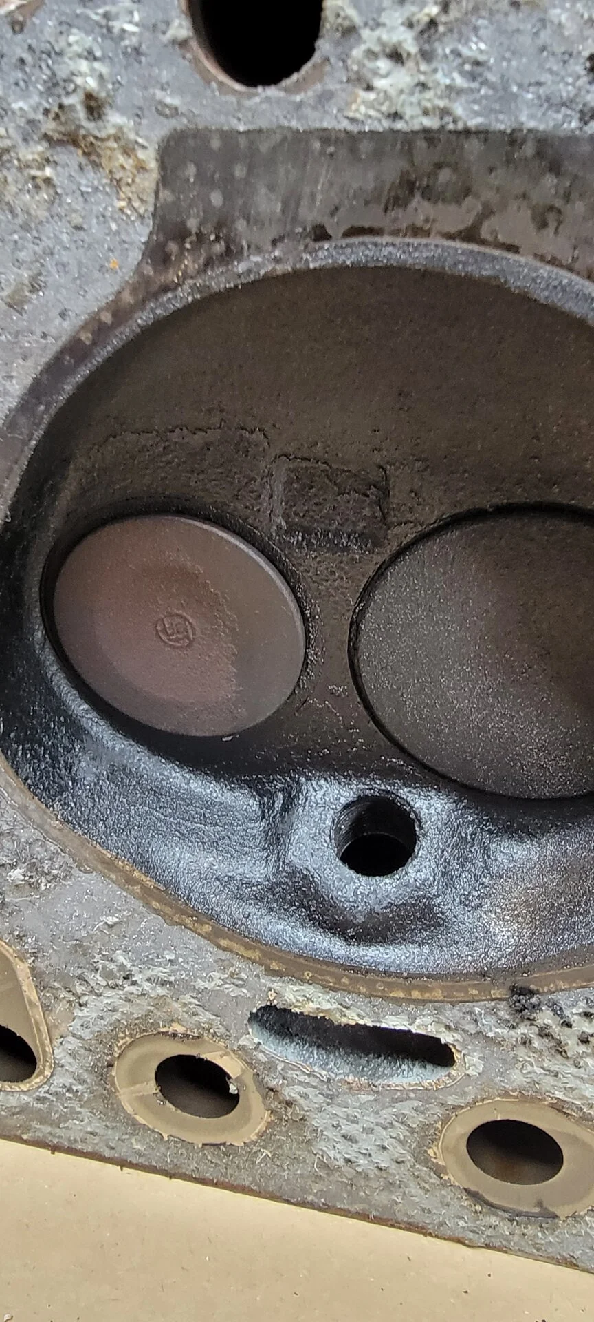

Pulled the head off.
All of the valves, from this side, look good.
Looks like when I had the head rebuild 23 years ago, the machine shop used Toyota valves.
I wonder if there is carbon build up on the top of the valves, causing the leak I am getting when I do a Leak Down check...
That would be my guess.
Considering the state of the head, I still see cross hatching in the cylinder bores and the engine spins smoothly by hand, I might keep this 2F a whiles longer. I'll likely have the head re-worked, with larger valves and do a port/polish job.

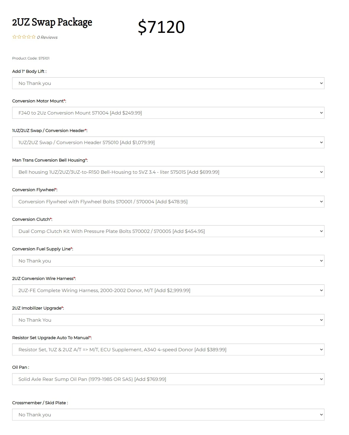

I have been gathering information for various swaps.
Really, rebuilding the 2F is going to be the most cost effective way to go, even with the machine shop doing the reassembly.
2UZ is a bit of work, especially if you're going to be using a H55F transmission behind it, as you need to modify the wiring harness and have the ECU reflashed for Manual usage, and to eliminate the immobilizer setup. You can pay to have that done, though.
I reached out to Dellow Conversions ot see about a bellhousing for a UZ → H55F and they haven't gotten back to me, but you do need to ship a ring gear to them to fit to a flywheel, then they ship it back. Thats going to take a LONG while.
You can get the H151/2/3/4 from a later model Land Cruiser Manual, but it's pretty long and its going to be hard to fit that all in a FJ40.
Honestly, I Think if I were going to do a 2UZ, I'd get a A750 automatic and have the ECU reflashed to eliminate the immobilizer set up. I have an A750 in my tacoma and love that transmission and I think a 2UZ→A750 would be a really great thing in a 40.
Looking at my spread sheet, nearly all of the options (used 1HD-FT, LS3, R2.8, 2UZ), except for the 2F rebuild +EFI are $20-$22k in parts (1HD-FT + parts to get it installed, new LS, new R2.8, low mileage 2UZ + modified wiring harness, and all with a new transmission).

I've not quite spent $20k, but $18019 is pretty close. Plus there's also radiator concerns, shipping the bellhousing from australia etc and other 'I didn't think of that' costs to contend with. And also why I am estimating on the high side of things too :)
I am sure I could find parts cheaper, and do it for a lot less, but budgeting high and coming in under budget is preferable to budgeting low and coming in over budget.
