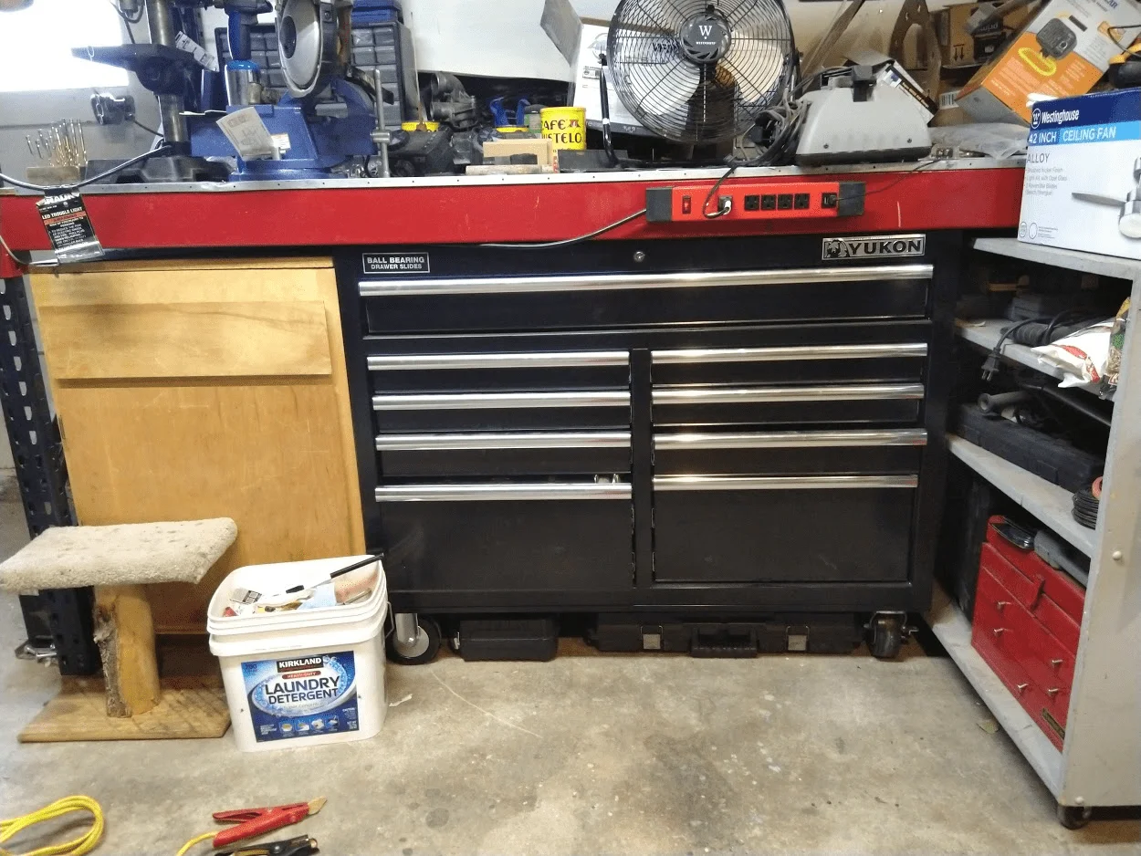

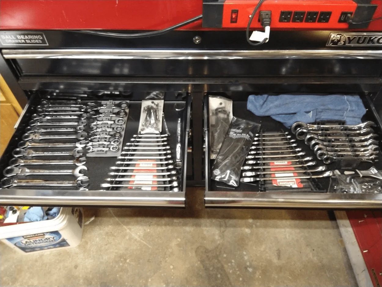

Quick question, is the top sturdy enough to mount a vise?
depending on what you intend to do in and how big of a vise, yeah. Holding stuff, yeah, pounding on stuff, nope.
The wood is fixed to the cabinet via nutserts (accessed by removing top drawer and reaching up in
About 4 years ago, I put in an X2 31M battery from BatteryPlus, ran my ARB 24/7 and I never had a problem with it. If I knew it would sit for more than three days, I would hook up the battery tender to it.
Nothing major, some gunsmithing and light projects. Had planned to get this inexpensive vice here below...

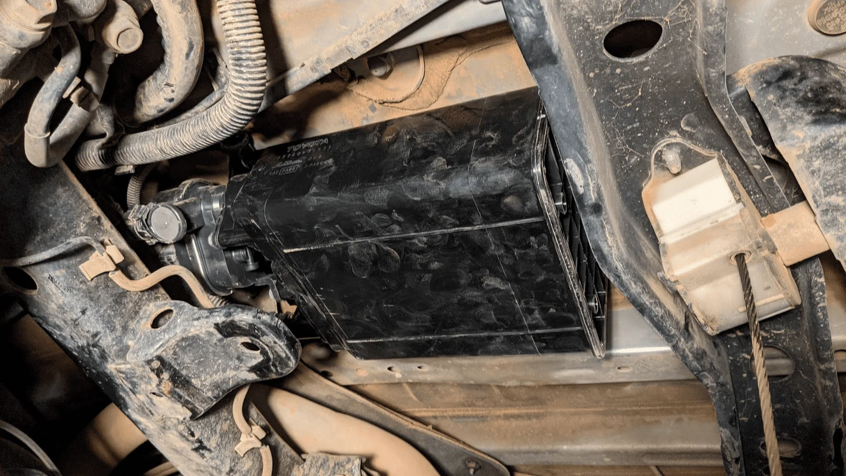

I think I looked into replacing the canister a while ago... Sort of a job, but comparably relatively easy.
Thanks @Vlad , this is a perfect"order of events" checklist.
So ...

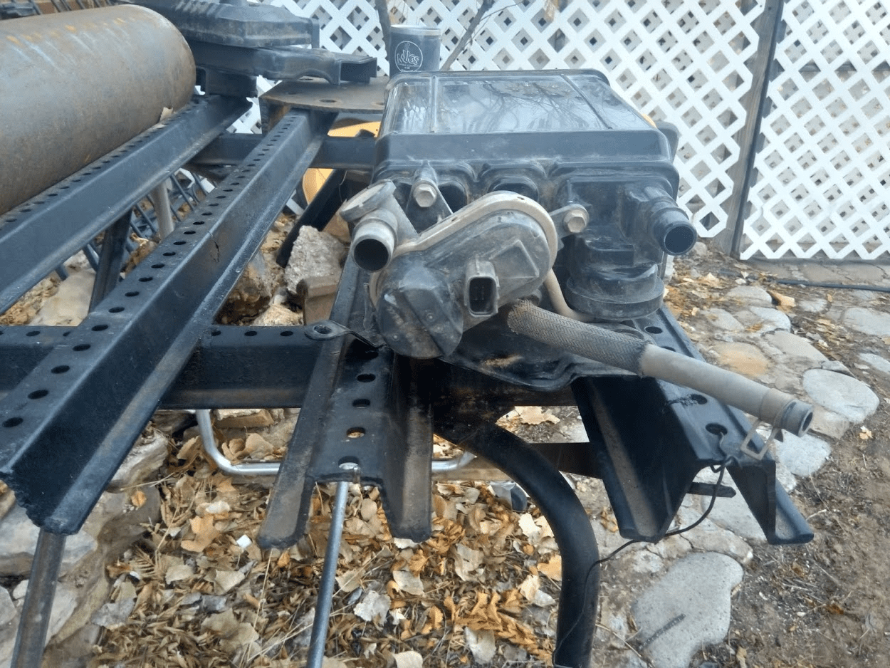

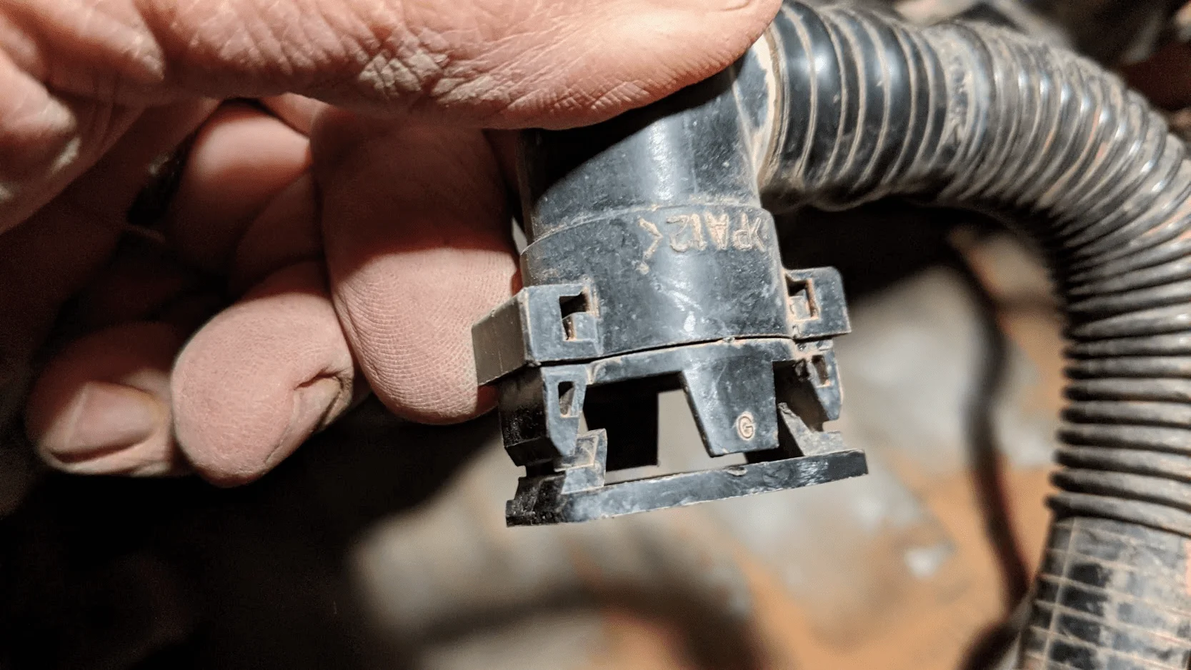

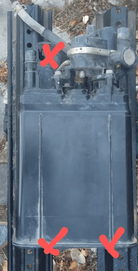

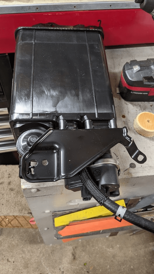

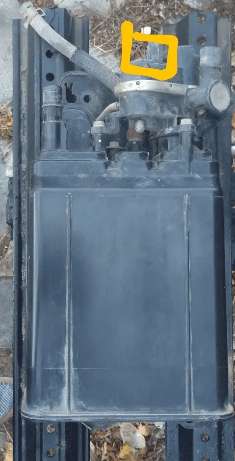

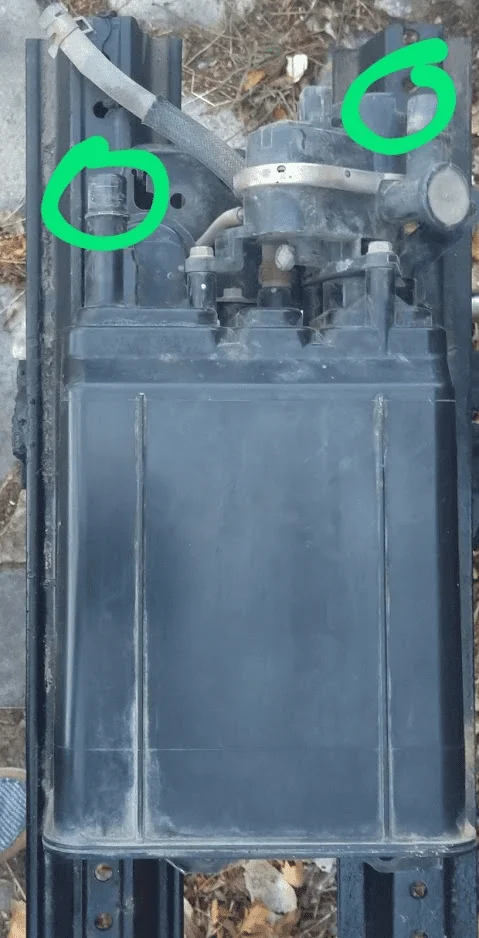

Nearly 2 years of clearing the CEL, a few months after a dealer confirmed, "yeah it's the charcoal canister" with a $1200 quote (@$800ish in parts), I purchased said canister from LexusPartsNow For around $620. Then this weekend I wrenched on it with a buddy.
Procedure: drop the spare to gain access (this pic is the new one... didn't snap a pic of the old one...)
3 bolts
2 [quite odd] hose clamps
a harness
a standard clamp.

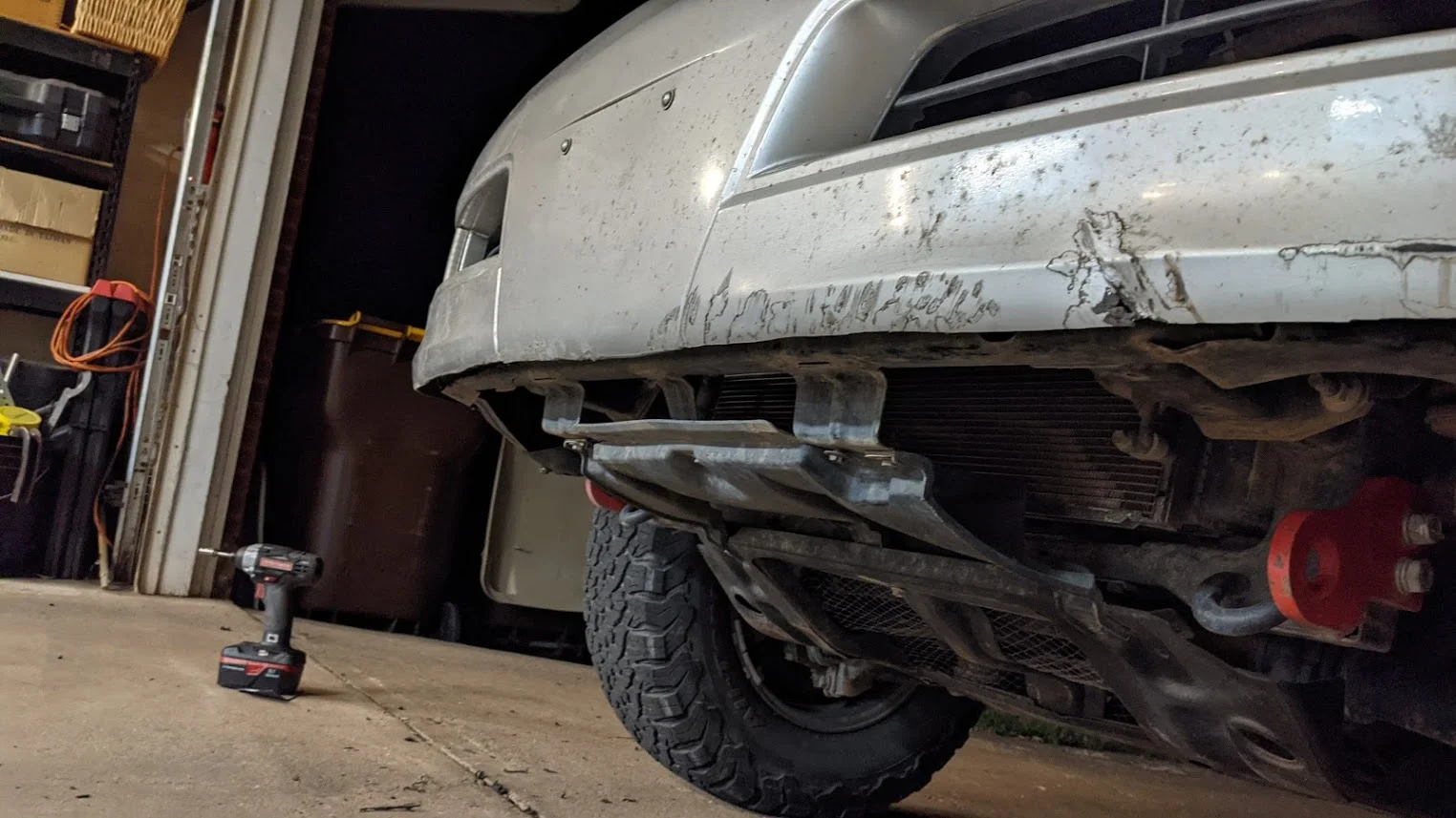

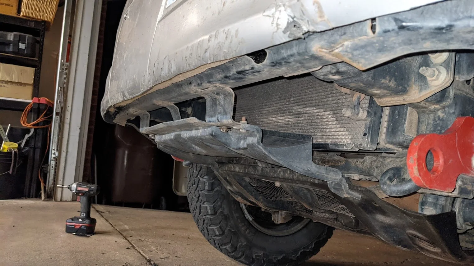

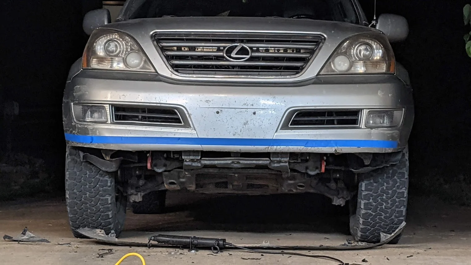

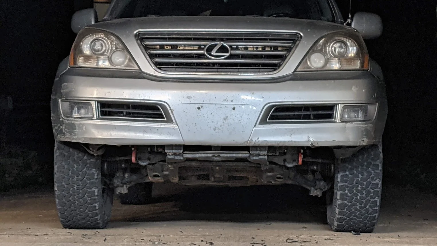

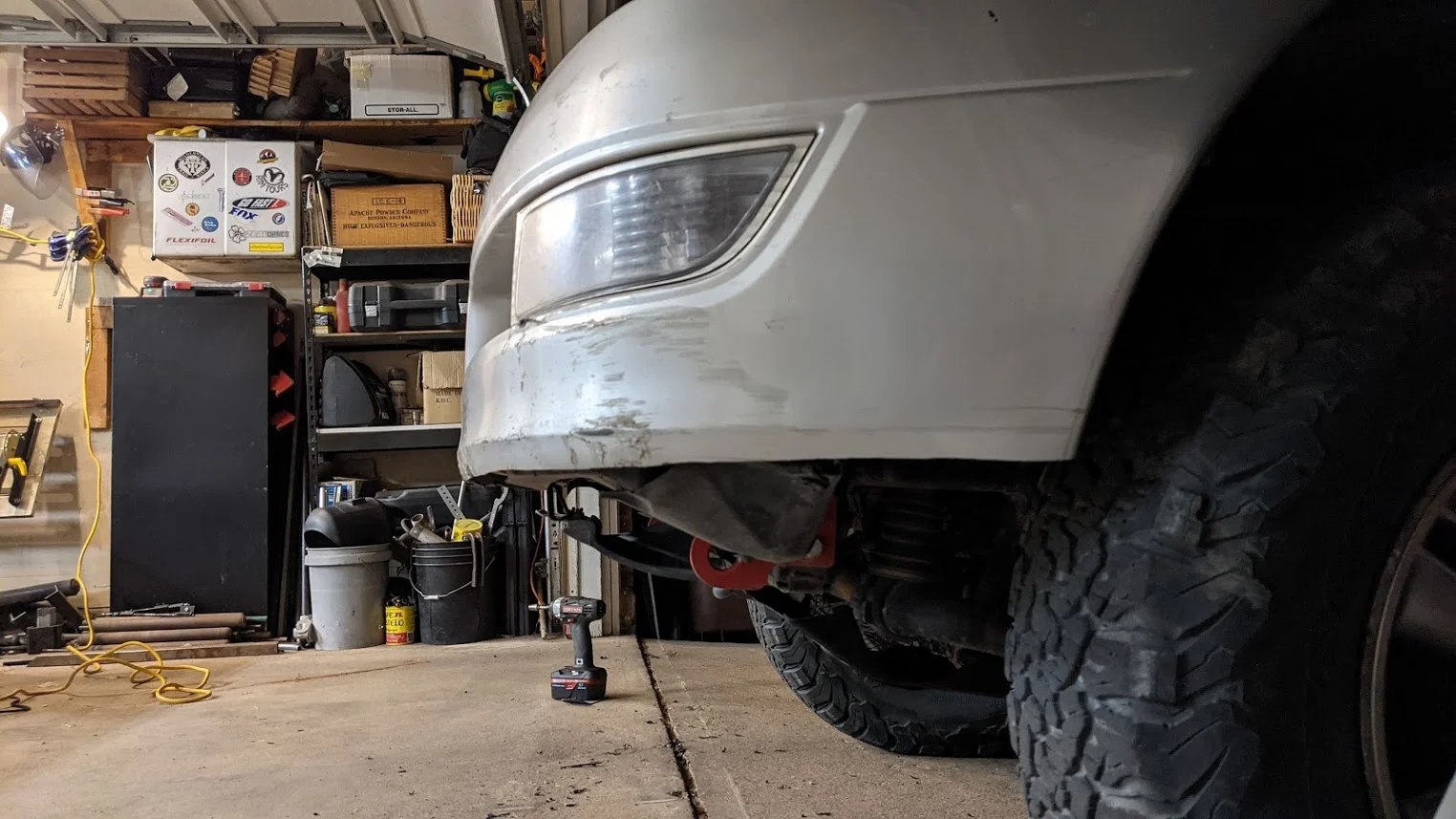

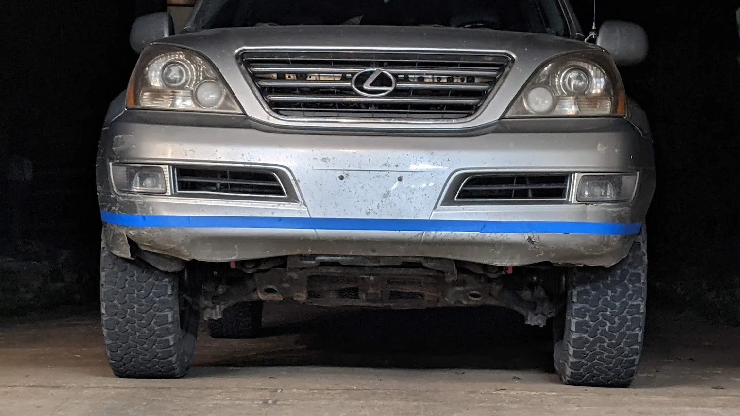

now to mod the mod and shore up this air dam. . . . 🤔
View attachment 2685897View attachment 2685898
Looks good. By the looks of that stock bumper, long overdue 🤣
BTW, cruised through your town 2 weeks ago moving family back down south. Was in the GX hauling a trailer, wish it was for a vacation there, be we drove straight through with no fun excursions....😔
Definitely looks overdue!
It looks good though.
Ever think about using kydex?
It's a heat moldable plastic (not exactly plastic, but very similar). You could get a sheet of it and make a mold then make your bends with a heat gun.
Typically it's heated with an oven or hot plate when people make holsters or magazine pouches with it, but it can definitely be formed with a heat gun if your piece was too big to fit in an oven.
thx, yeah overdue LOL...
Kydex.. Might've heard of it... 🤔 Is that the stuff they use as skid plates for sxs and motocross bikes, etc? A wrench budy in town mentioned it years ago , but I've never followed up on it..> That kysex stuff sounds rad, and molds would be ideal for sure, but yeah heat gun-pliable is good for larger sheets and fewer, less complicated bends.... That could be a good solution to that air skid post bumper, pre radiator..
for that I'm thinking of cutting off the tabs, then rewelding them back on, as straight back vs this step-down configuration.. then your stuff molded would be a good fit!

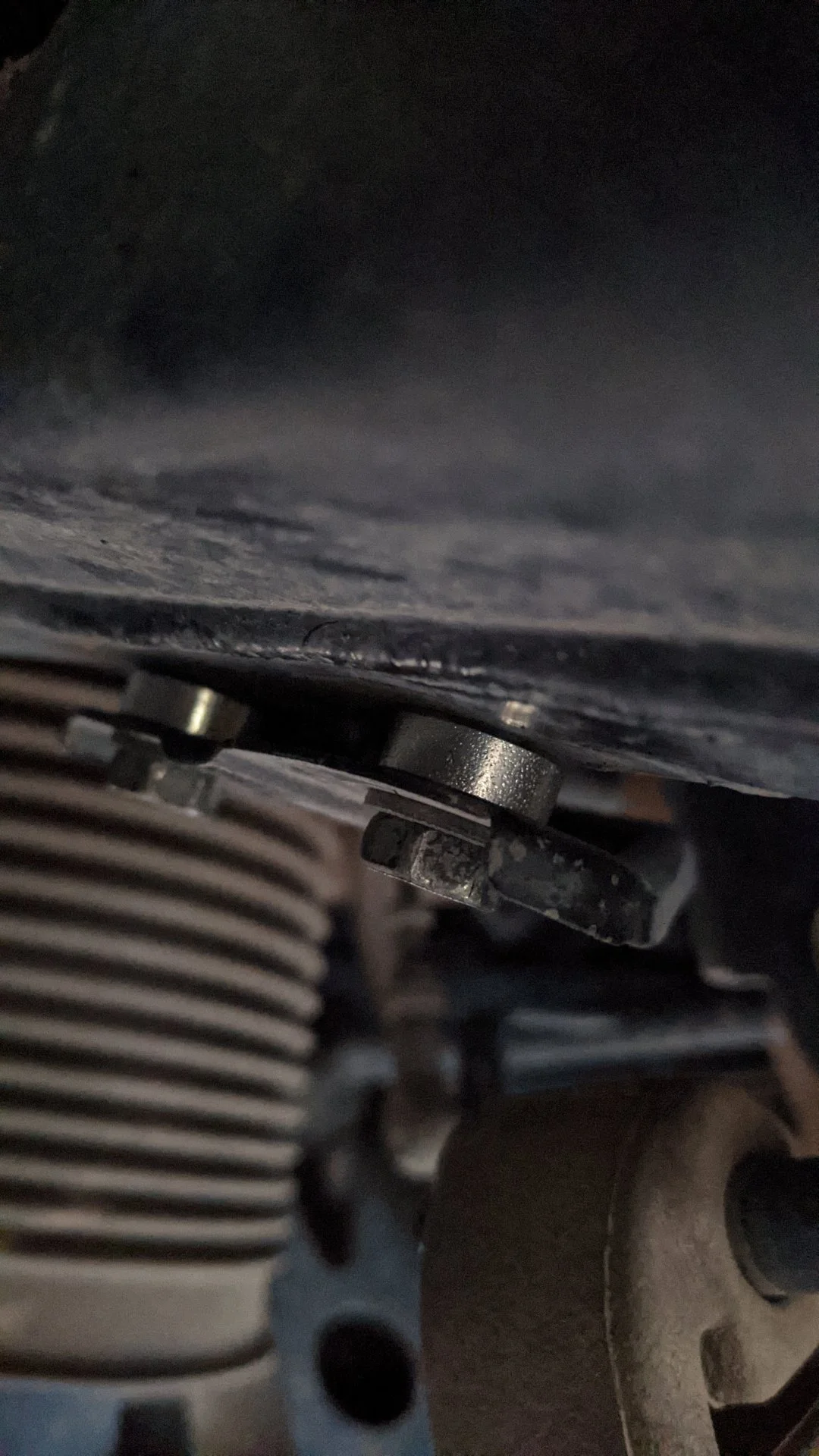

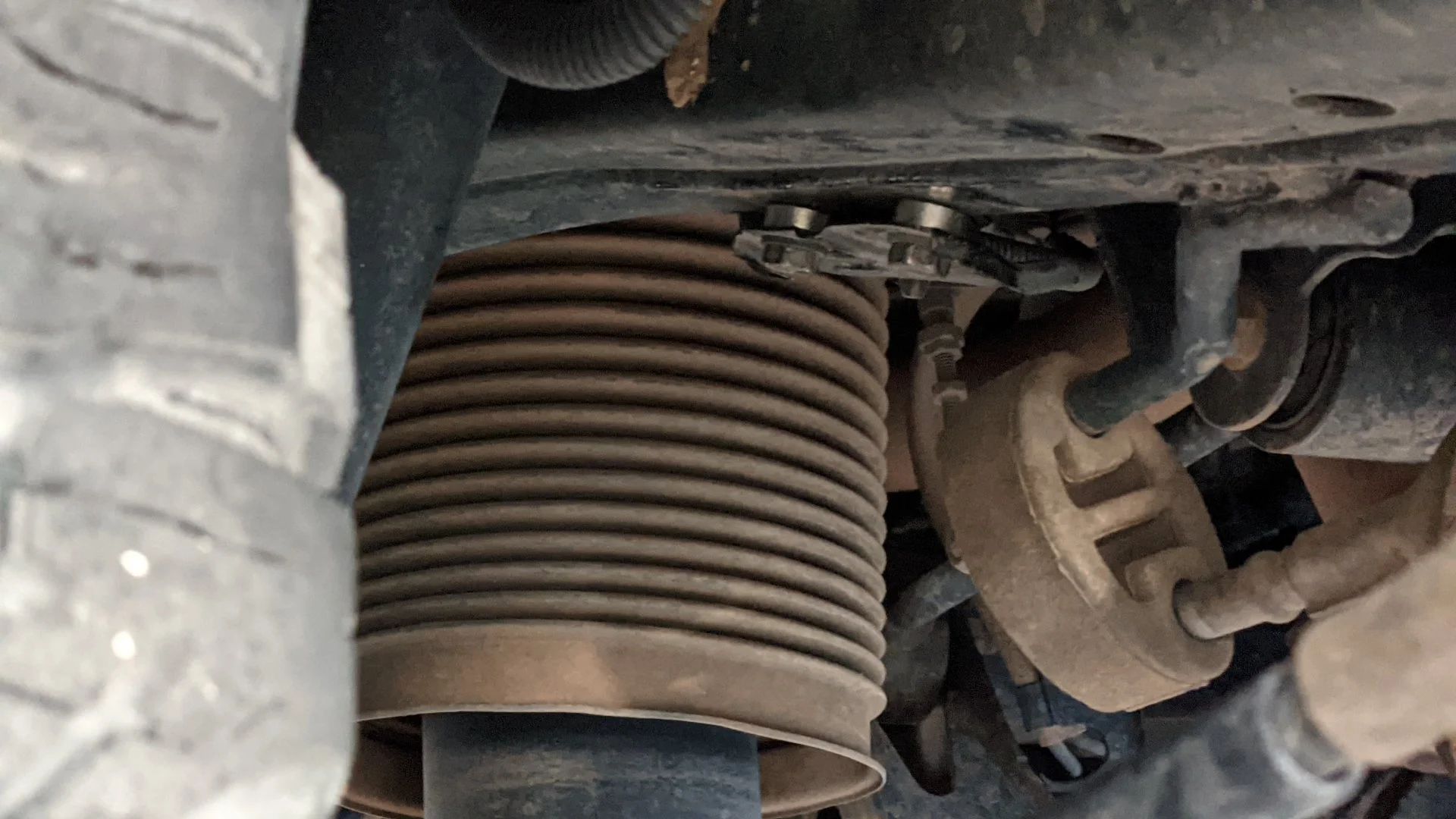

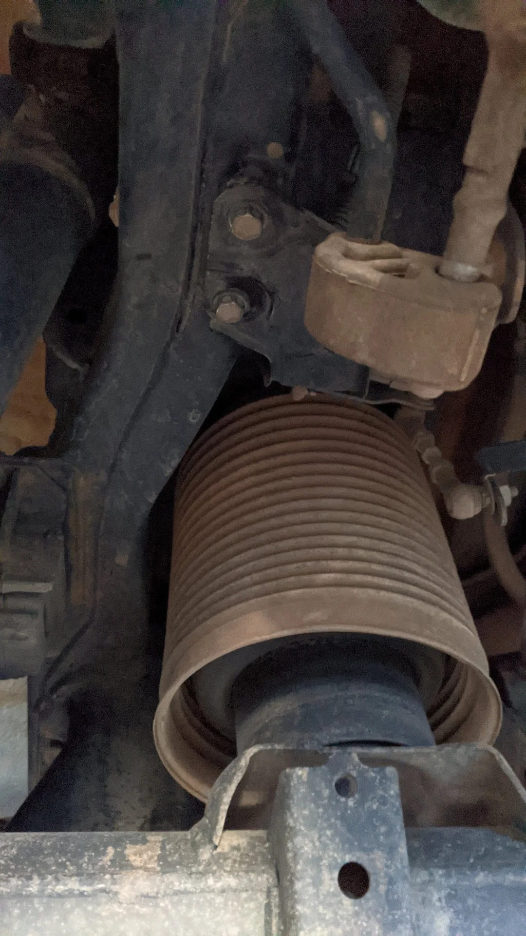

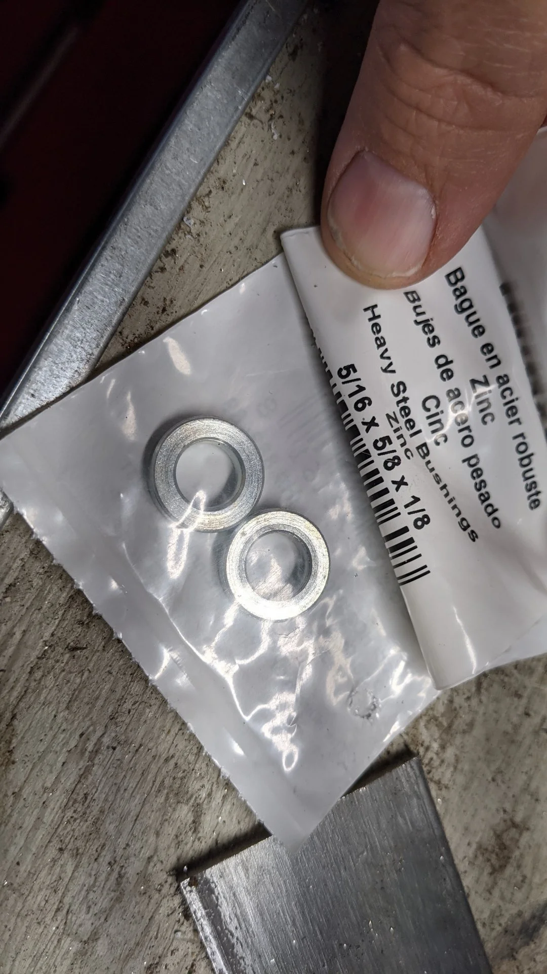

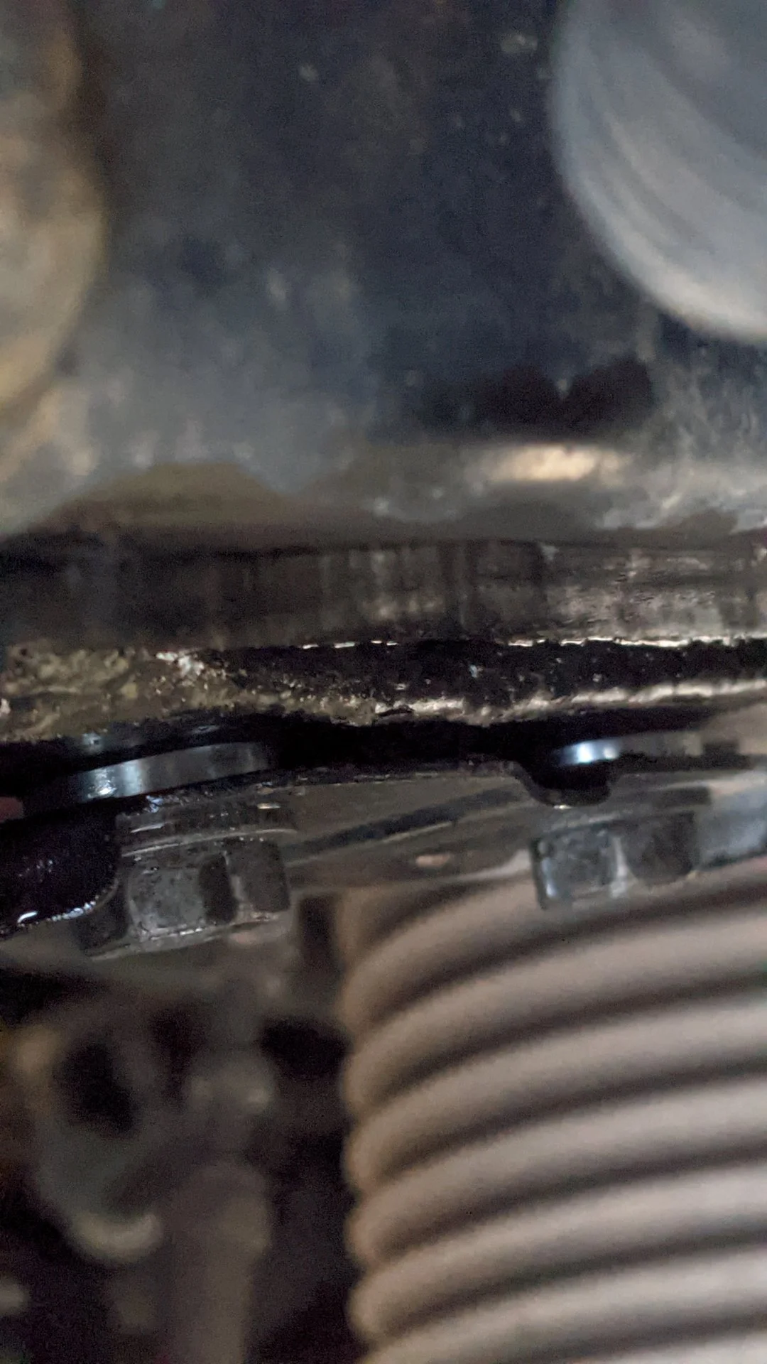

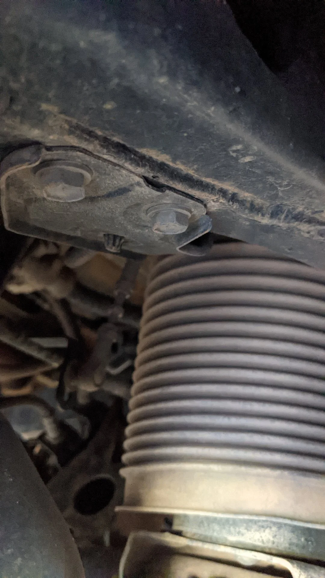

Finally looked up the airbag washer trick. 🙄
proof of concept (to me), I used 1/8" bushings, sub $5 rear lift 😂
Proof of concept 👌
(ergo sample size of n=1)
I gained 1/4"-1/2" ..
per the one YT video I saw
1/4" lift per 1/16" washer. He did 6 washers with his Bilstein 5100 lift.
I've since swapped for 1/4" bushing to yield 1/2" lift.
