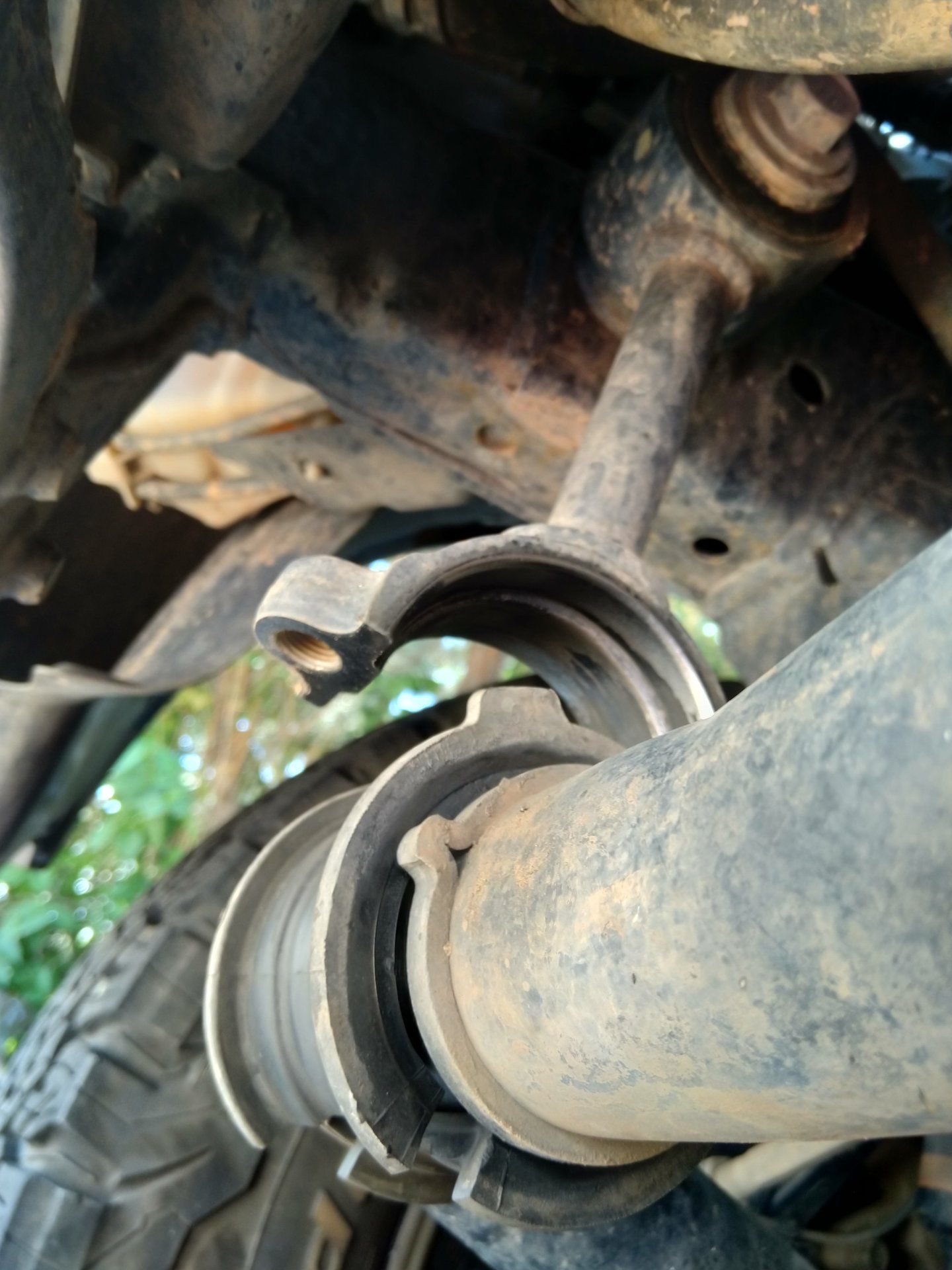

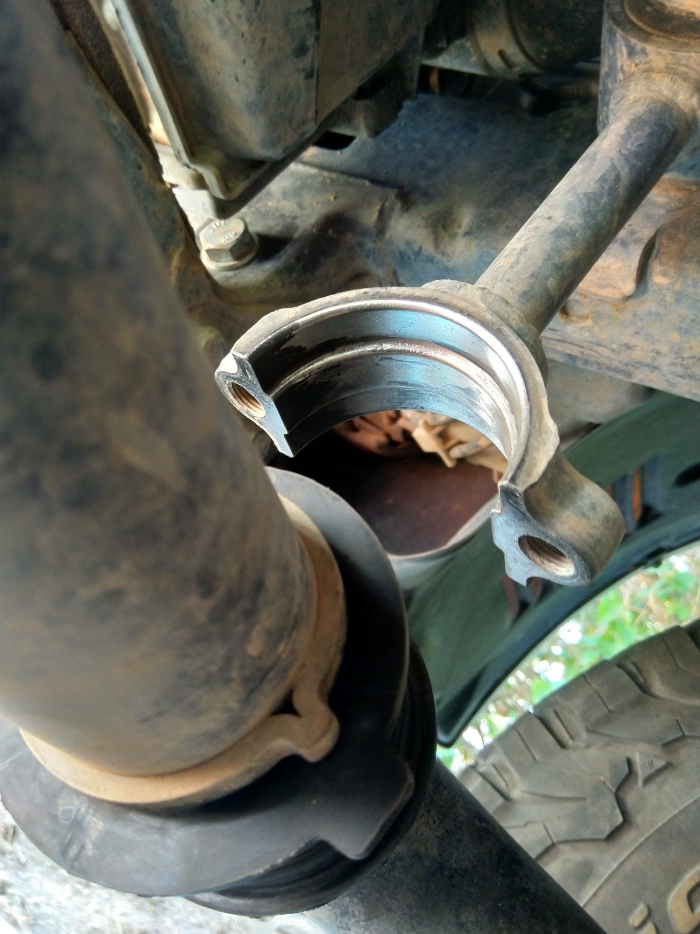

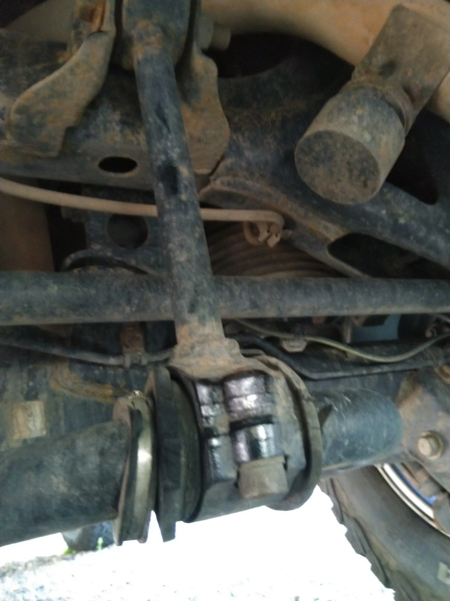

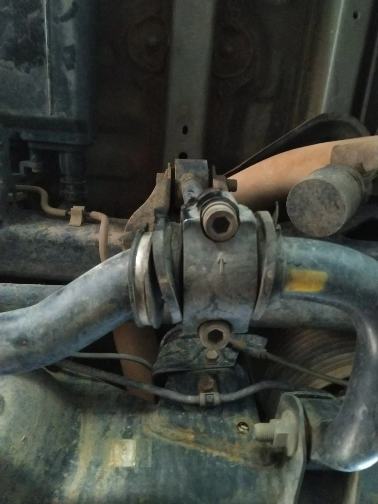

FWIW, with 265x70 series tires and using the articulation of KDSS, the brackets do contact and rub the tire a bit.
Here's the fixed RSB bracket without and with tire...
And here's the articulating KDSS arm RSB bracket without and with tire.
(Caveat: these are 265x70 17 LR E with 30,000 miles)
These findings have me interested in investigating the GX460 RSB swap more.

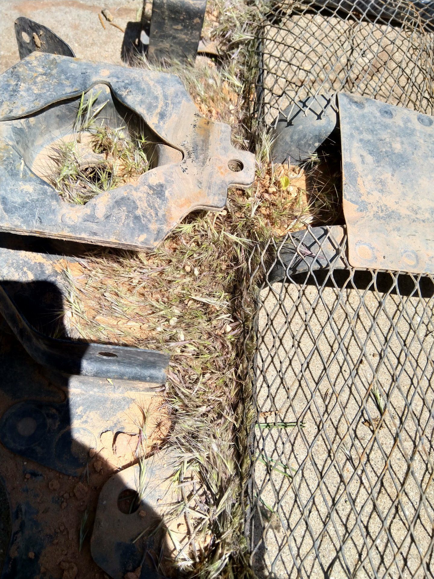

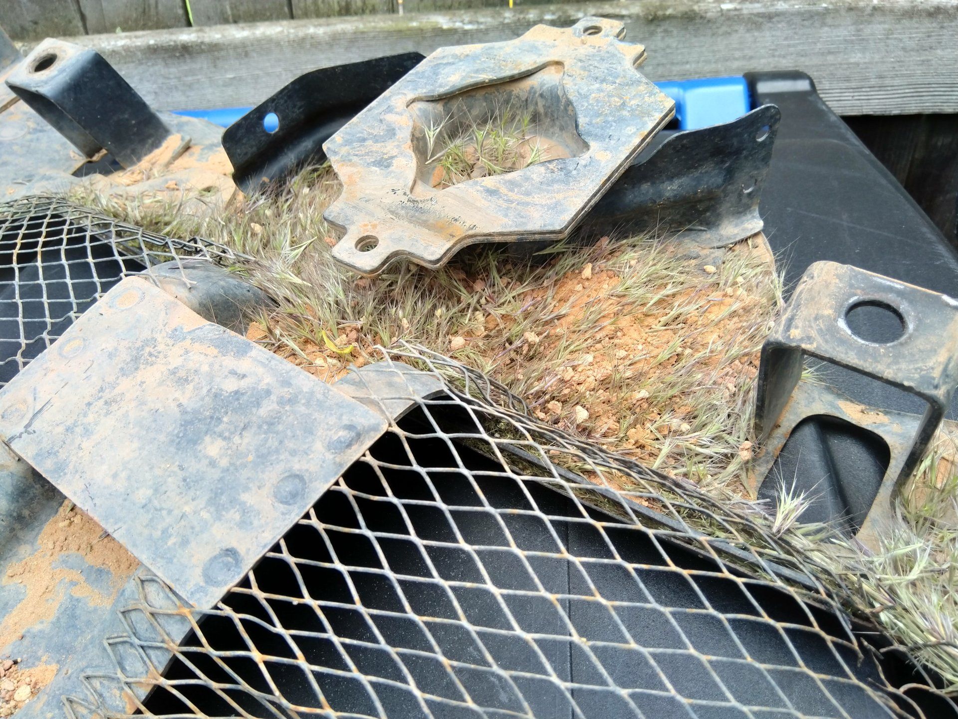

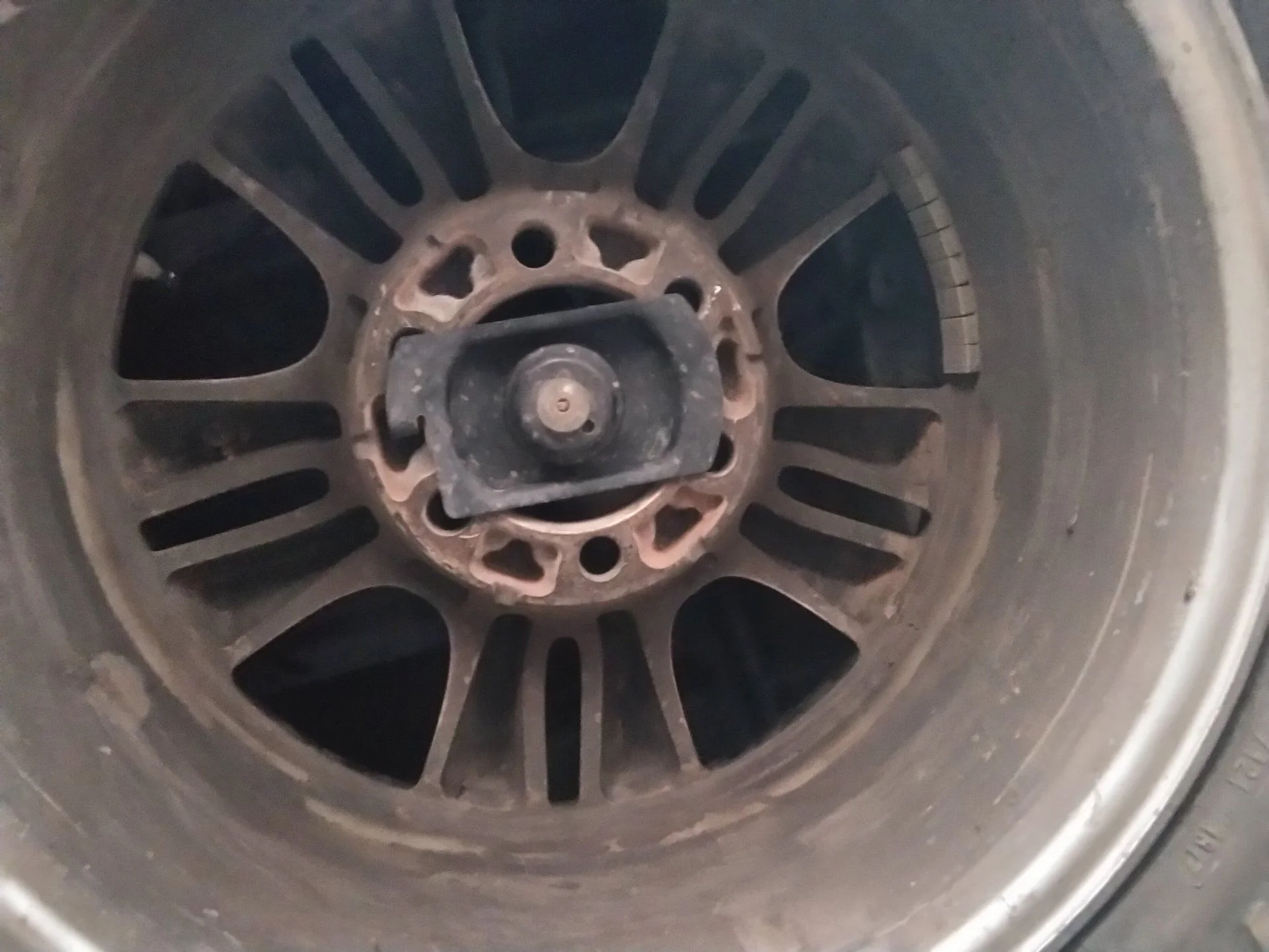

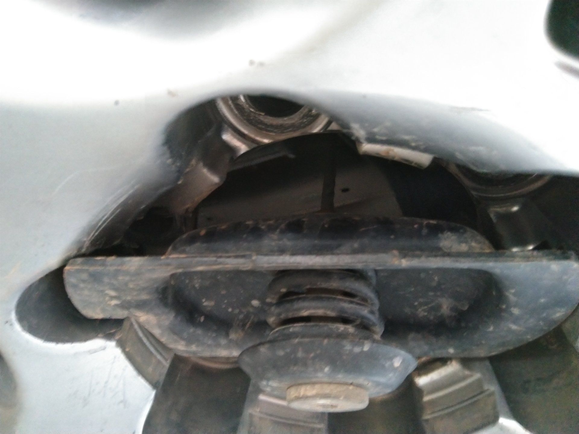

I gave them a picture of my preferred 5-tire rotation pattern and asked that everything be aired to 35 psi, the spare too.
I didn't check the pressure for a couple days until.i'd started my 1,000 mile return trip (they aired everything to 40.or40+; lame) and I didn't check the spare because i trusted a tire shop to know how to mount a spare (they'd said "it's a little tight getting the spare back up there." I'd said, "yeah, especially when those tires were new!")
Turns out (1,500+ miles later) they botched stowing the spare! The damn thing could probanly fall out (a friend's 4R spare fell out on a trail in Moab, he never saw it again)!!
What the eff, people! Does anyone care about the quality of their work, or following up on employees in the service sector? It's a sad and real trend in reduced quality.
It's probably confounded by my middling age and preferences in doing things right....and my curse of orientation to details.
Okay, I'm done...
Here the shoddy work I noticed this afternoon.
View attachment 2032149View attachment 2032150View attachment 2032151

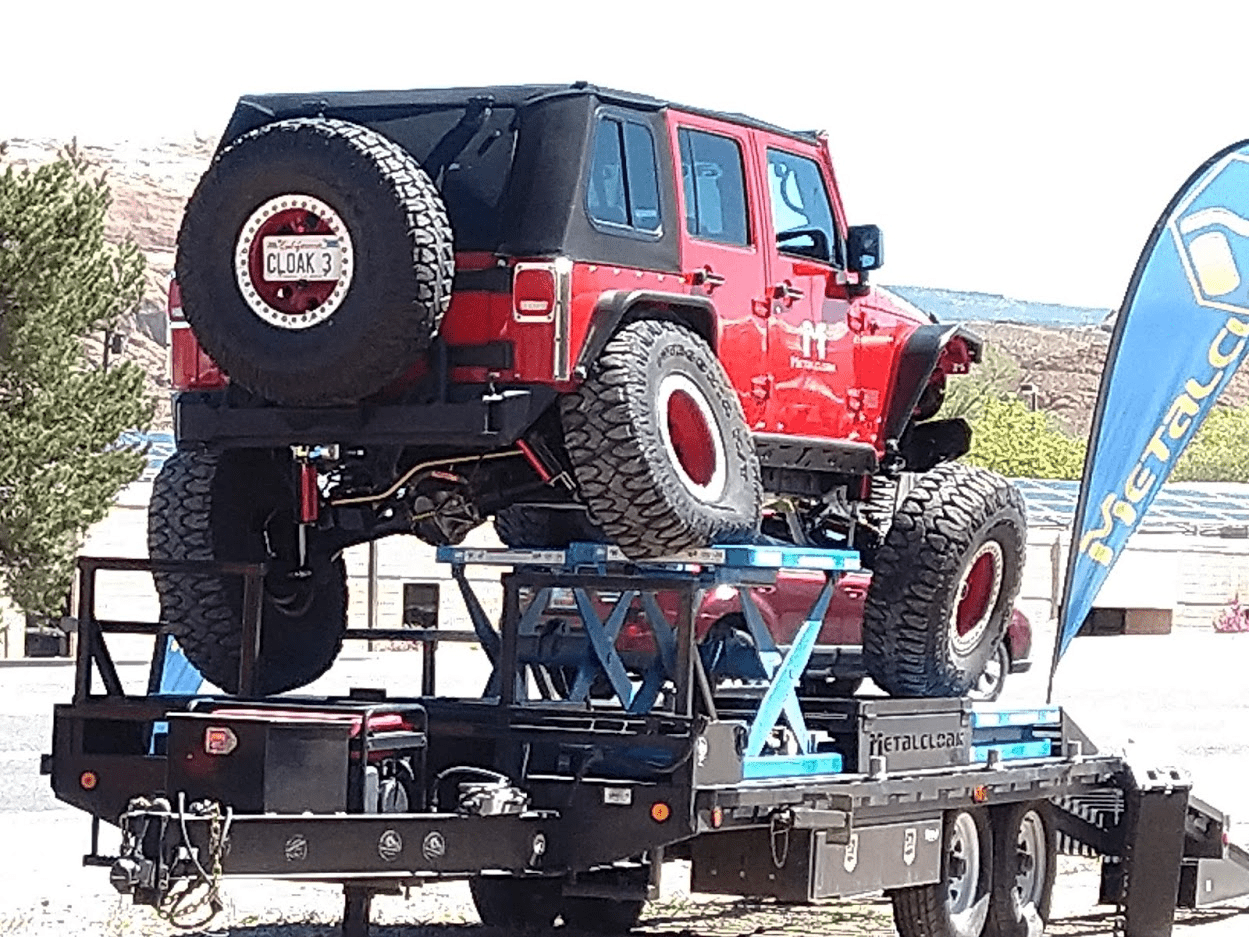

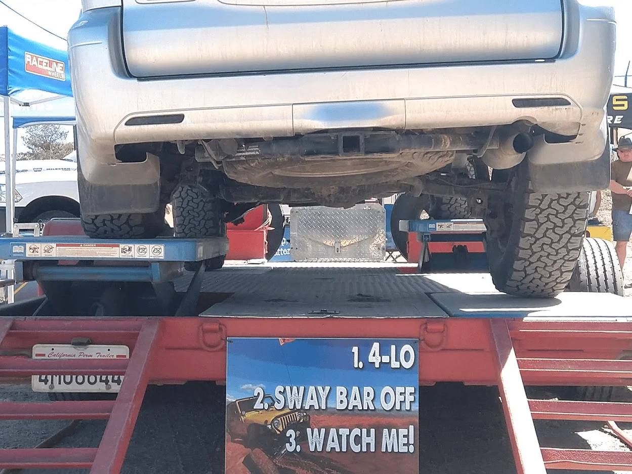

Back in April, 2019 during EJS, I did an impulse corner travel index test on the Metal Cloak CTI table. I aired down to 22 and forgot to lift the rear airbags to maximize score, so I ran @ 22 PSI in normal suspension mode. My score was 12 PF and 10 DR with cumulative CTI of 440. I had no idea what any of it meant and just wanted a baseline for my stock (plus front leveling spacer) GX. I REALLY wanted to have a fully stock articulation metric before doing the leveling puck and bump stop drop, but that just never happened.
After running the table I went home and Googled the CTI test and all the metal cloak info, comparing it to the more common RTI test. I think the CTI is an easier and more meaningful number vs. the older RTI, plus easier to replicate, perhaps. I also learned they try to standardize the CTI by having participants air down to 15 (I was @ 22), so next time I'll do it right: 15 PSI, lift rear airbags, AVS to soft and see if my score is any different.
It was fun for me and I'm sure the heepers were like, all " What The Lexus, -blahblahblah-. . . . . . "
😆:flipoff2:
Anyway, They gave me a calendar and data sheet, it was cool and the calendar has ALL SORTS of events and locations where they do the CTI table, so there might be an event near you where you can check your rig's articulation, controlled and safely!.
here were their display rigs. ;)
