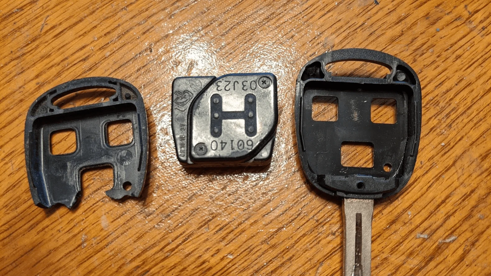

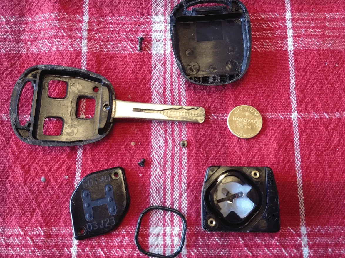

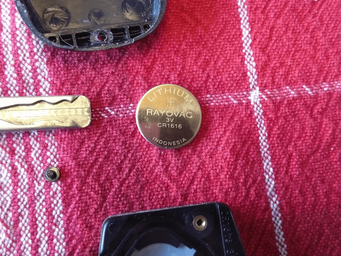

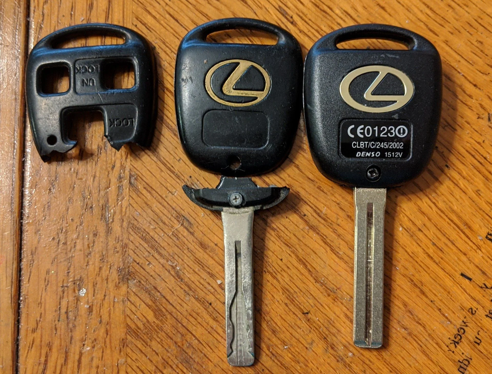

So, dead key case 8/21/20...

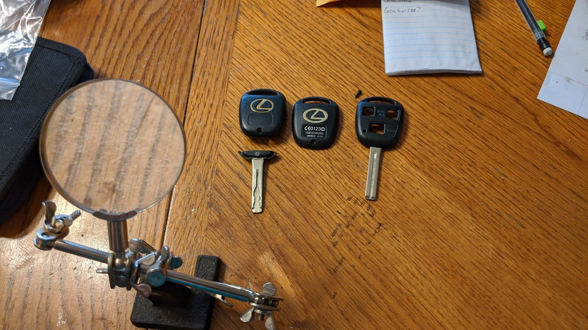

Ordered these blank fobs (2 for $14ish shipped): 2 New Replacement Key Case Shell Keyless Remote Fob Uncut Blade Lexus Gold Logo | eBay
Guts (transponder) swapped stright over. The stock key's blade is molded into the plastic, so I could'n swap the blade:
And with a neighbor's time... SUCCESS!!!
New key running the GX 8/29/20! 🤯
So a Lexus (probably aftermarket housing) transpondered key, cut and working again, for.... Not much!!!!

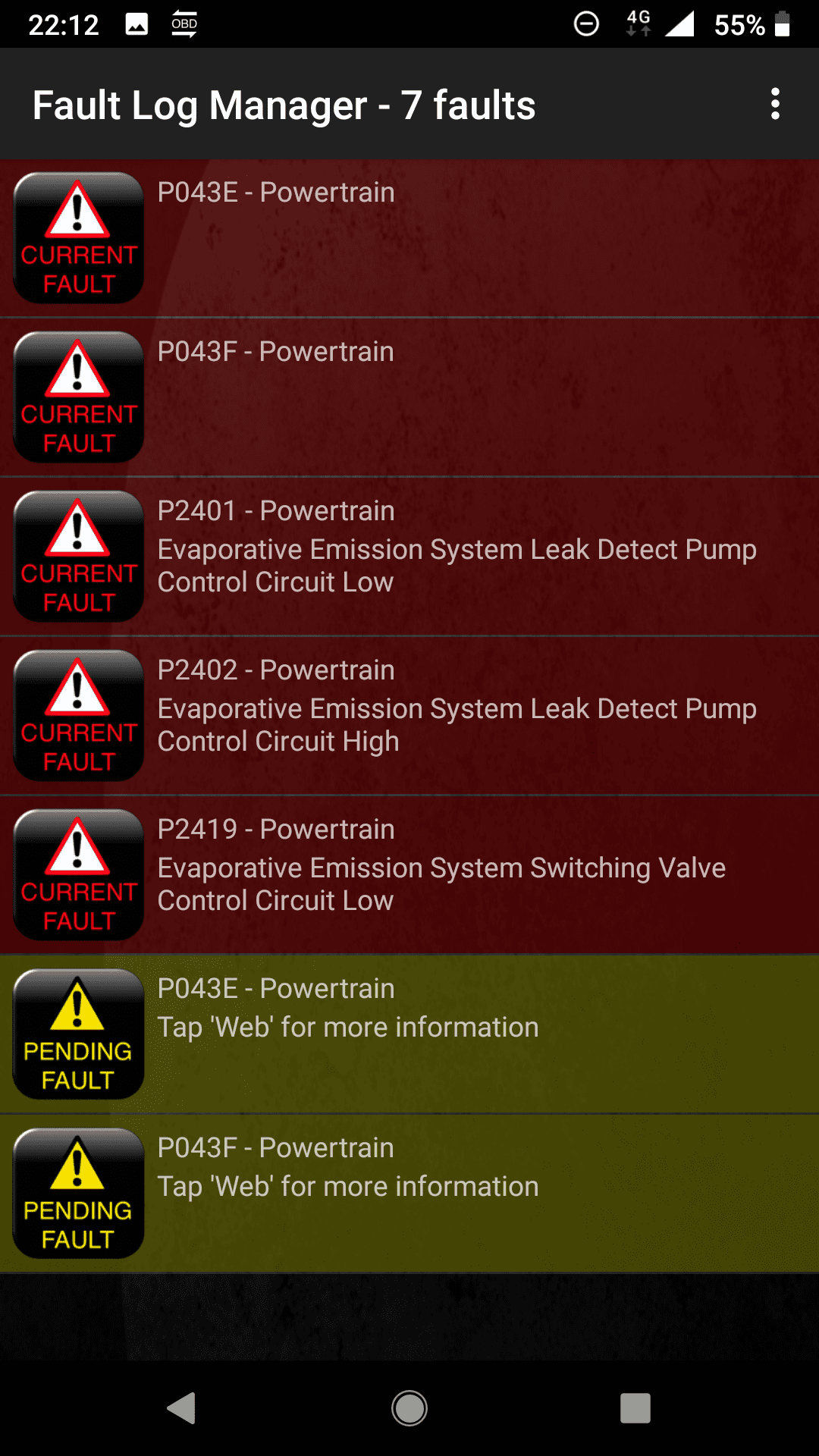

Having dealer diagnose per codes, while it's in for the cracked exhaust mani... They just called me back reminding me it'll probably take 8 studs (i expected this and suggested that be in the initial quote) and said they'd save me labor on the code and experience suggests its a charcoal canister (of coarse)...
watching that bill climb part-by-part. :confused:
B U T it's getting done. I've been clearing those codes for like a year and a half.... 🙄😒
Only four things that cause this (in order of ease): gas cap, vent plugged, charcoal canister, purge valve.
I think I looked into replacing the canister a while ago... Sort of a job, but comparably relatively easy.

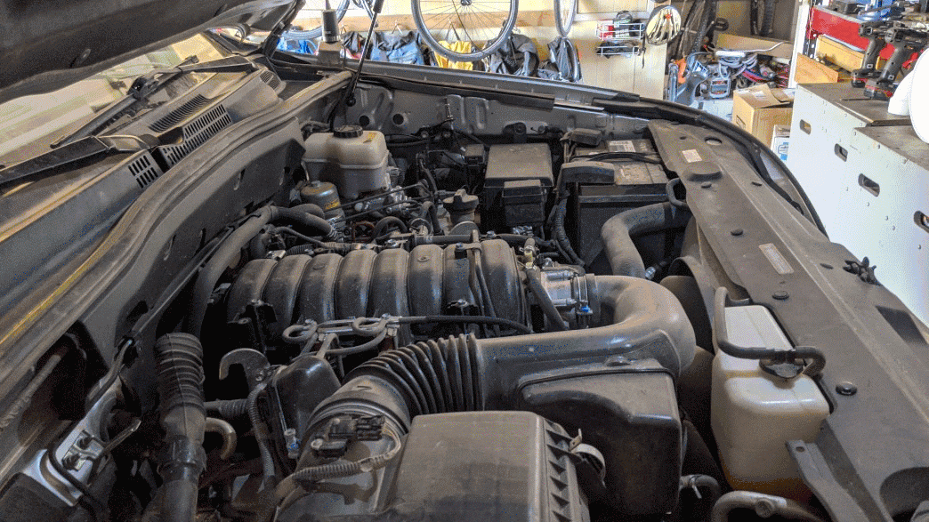

Exhaust mani repair completed!
SUPER quiet again! I hadn't realized the slow increase in tictictic, until it finally let loose!
Hindsight, always 20/20: I had noticed my 07 was a little tickier than @Lifted's 05 (similar mileage) when we fiddled with his bumper last summer.... I recall thinking, WTF, why it is making that noise? his older 2UZ is quieter than mine!... 😝
So my PAX exhaust manifold failed in the tube bend upstream of the cat, NOT at any weld. But the failure was a nearly circumferential crack. I was surprised to learn the manifold in this car is NOT cast but welded tube. interesting.
pix of gasket for kicks too... hmm.
I replaced the 8 studs too (as I expected), but sadly THOSE didn't get returned in the box with the other broken bits I asked for :(
At any rate, she purrrs again!!

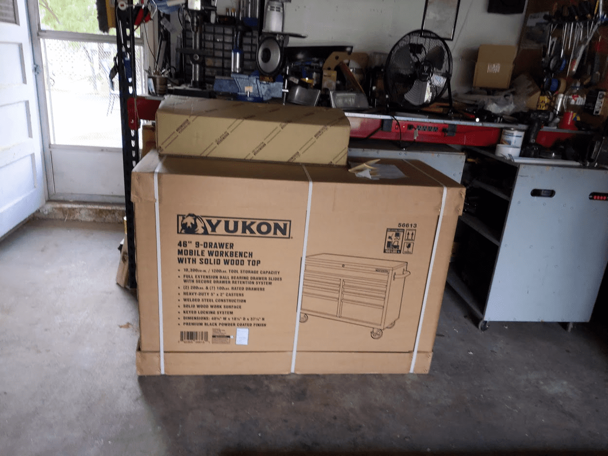

Oh, and I had them do my 5-tire rotation while it was there (46K miles on these KO2s, and they have 10/32 tread remaining), since I was due and was returning my 6 ton jack stands during this same drop-off trip (HF is 2+ hours away, as is the closest Yota dealer) and therefore lost the means for "safe" vehicle support at home ;)
So I turned those stands' in-store credit, plus a $40 off coupon into a tool cabinet (which gets surprisingly good reviews) for $250 :)
perfect fit (thankfully) for my wife to retrieve after the GX pick-up (Thanks honey!!) 😝👍

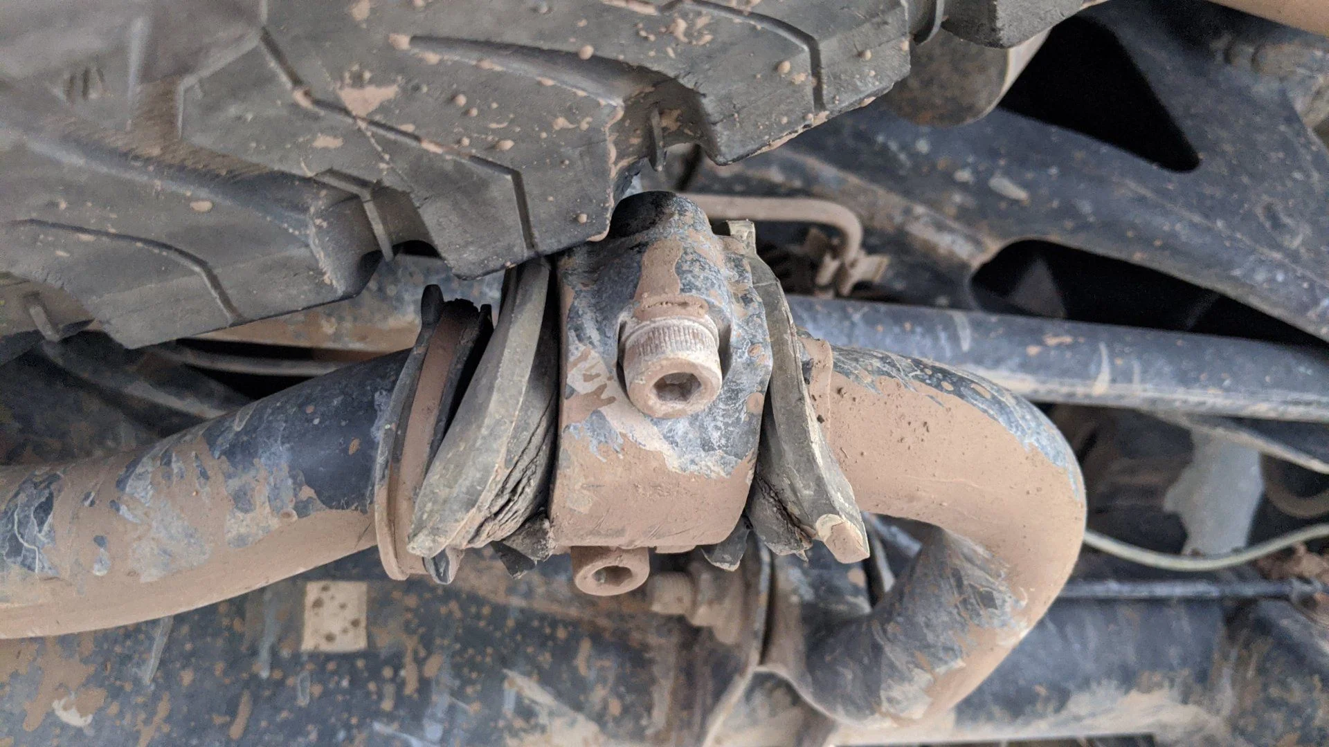

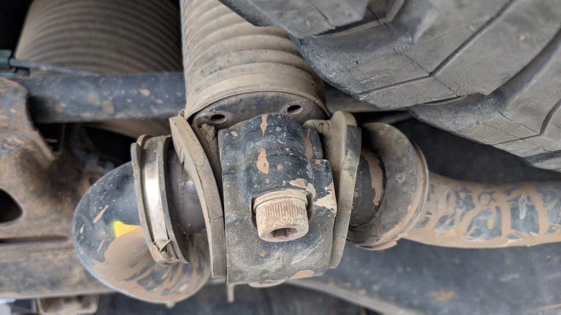

Jeez! This thing eats KDSS RSB bushings! 😲
Maybe I'm doing it wrong when I install them... 🤔
*EDIT* adding PN:

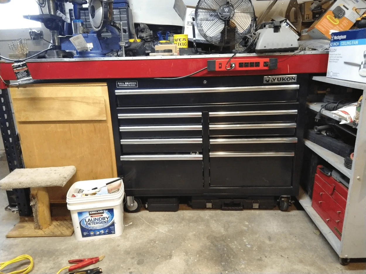

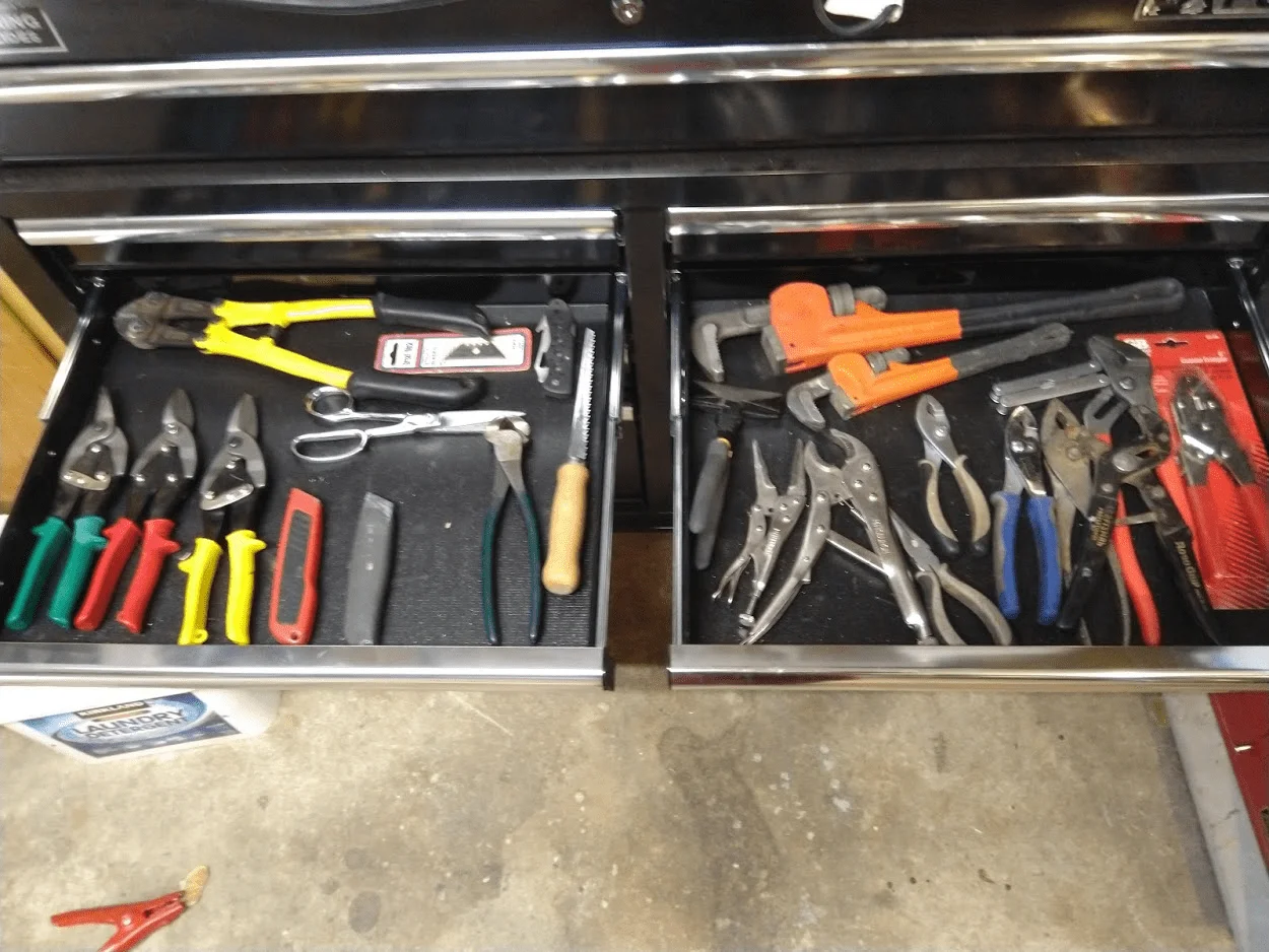

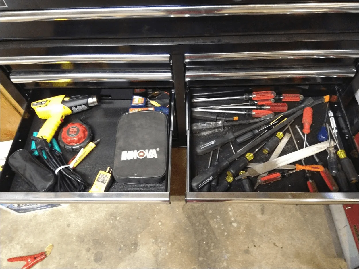

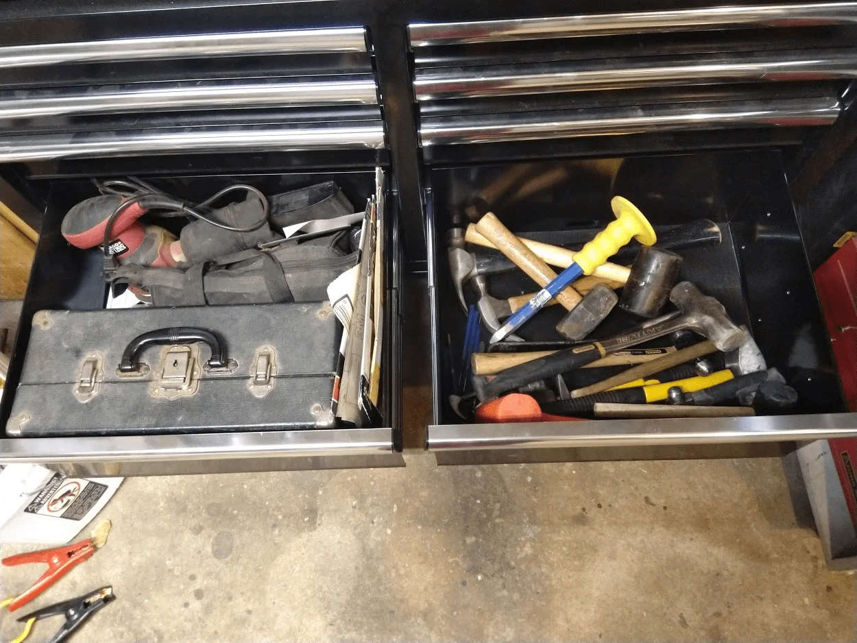

View attachment 2432168 View attachment 2432169
View attachment 2432170View attachment 2432172
I’m thinking about buying that exact workbench. LOL Glad to see the box fit!
