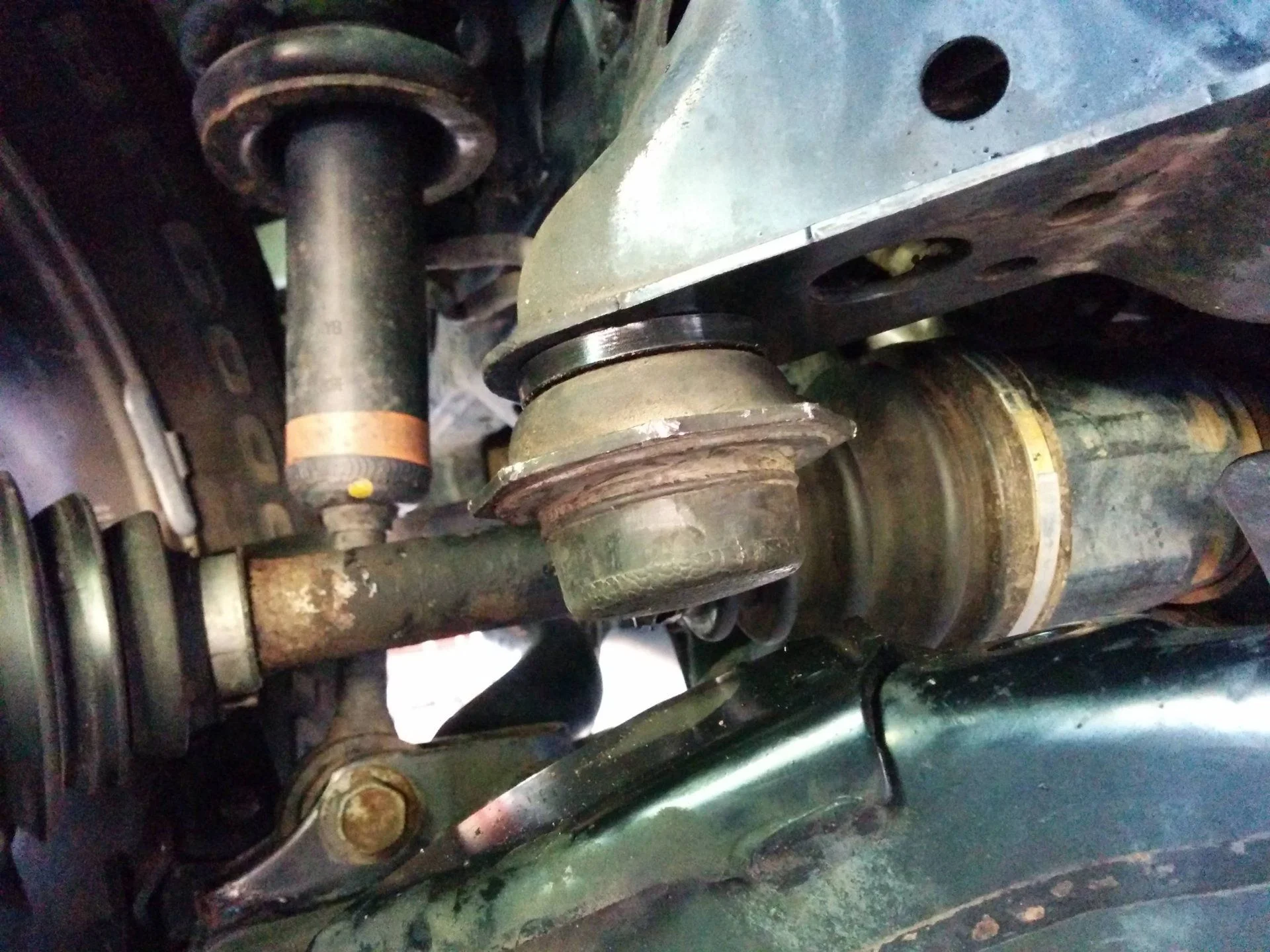

Also did a full droop check on brake lines and ball joints.
wdaPywV5Ni-IeeqyDUk-TJLHDpgWsx9BOXJ0oD0C2bc-Cm0CGF7TmOOy0iAVrt8KRMzXaxUxEQMcdaHsqvPtFaEKgA_R20uqPv-ruhCPWxj-J3YdCMHKvrXrbsrJ_EQTjENG6Nqzmglatq3E7HvskiGjyZNHmrkyo1zWohCrWMe1cLSGmD_iRKK3Fx71yBEq_DjEnA_gjYzXE6JCIF7FVT9iMc3wvrbb6N-DQFOQ-rSFhdUE0ZKC1hCXUpGlTACsyrwVJfzHy1j1Ohrgi930zKtu6ij4ywNo6cHtXi0WKyoWl4OHFo8mi0bQAcCYUY5uM8uz3OXII0NECCmR9Abshu38IUI6drGFhvjRT9l9j1WMNR33XOTUyasUZH6xzrPyW1ag28Wmsnzs6KyzVE1WyFLvYcVG3Yk3lrlKQUg2WLaQlBv8drdS5PWjpJ1lSj5MXkTiev6ePeUDI3sopOfXGpArCf3i3ID0KfBOP99iFzZugVRPywSN5r1lsiZlMEjAdPNZUWBJ_VpkMdRxd4NcT28LZWyaQMfh2PJ8AWh5TadTgT0wg-7gKALxW-GM6nDk4zucd4RWcDVymOJLgZNh3KyjrrVG_wU--TXBq5-OES0UofG_rQePIp9yZv3jFjF4=w1258-h943-no
Brake lines look good, I thought they might get taught but they look like there's plenty of play in them with this 0.75" leveling puck
0QURJIli7syGzqgUgGKKxwliettMI3gN9OQaqzr6zxBz74KWGhVMHdRApP7O0zDoc9zVWIXj1Aa6jJkf2LK879wnSi3Vv7gfi9wt0XuXSNznrVpZLZaIJligtOpnsJ9mXn_YQx6tq1kDPOI4xciezOFbwUynz3ODWBIiQAUR7m67-BciwzNfJtBfrYYvW_7nUmhcKvvXe0_eTlJzOZba4EWwwbwDayPrhU9J80083HnawqkiIiQRAxcCRPdT_QLuRZJXus_se7z-FMW8jCrag6RYTf-PHe8AmS6GiYLpeb9iha1cNEEPdvrLcpd3KK_d_fFdYb0_uq0mCSqlxxMRSgZjeZgXqAhwknopEfbvmCx3Z_Icx8X7HPXPWt5cgxuC8Sh39Cci0R5ksu0MFL_kq_nnNWJUTfnCVTxIlKdp1pHPEuycscXYTxLefz8D4PARpjMLSQT_GfPcOh9RV_gEu_AwtlRHvc-bVVaKsNhJROSTX29wYyaWnT6N1Bk6dbLAUxyNsig-ER4qwfCd-4nCXIRPRYI15_uZ5UpDzDgZ0zk92p1FBkYhWTdAZTqZaNLHGdSwCLix2UB27aesMbbSBDGIG23T1ugboJT34sjvQevdiOYrswcjDdLY-K2m2uGx=w708-h943-no
UCA looks like not close to binding on spring, and ball joint looks okay to mine inexperienced eye. It's at a good articulation but I don't think it's bound, maxed or overly stressed
cm-7NPv2WB0dXheziZoriPWUu_CNpBxGofz1zKD7M4v6V3jE3091IGN1CNNpybSMhPv9RHxl-RJmeYk9X380lSWeBFv2WhAKiDdScACaHEi-yHurAsRYauAJvCQ6_yKlBJy4ZA2OoVXaymWtYDP3Wx--c1Vd26N14VYnGB9erD1d6NDFGvEqdITU34ZJuOAeG4njMbJEx47uaa0Iwi8fB1dds7O4lcp5LwXuBMoDsWRJPbym5dLC16FslZqUpudFoaxlVgYgrEUBnmRjpwOVUFO74koUor_EJGuzylCpT9EB0kcQaKJNKdrh7nejqiytqB3wSkB1joYlM1EgfYRpOzogFA6bxV53Qjp00av11I-W756A7vTlErWXKjAtk_duPLnbi7GAIE-XdMywyoc6bIWLHYB9odmDpVVt-ufAFDj9cmmFaB87JI-AJhgtekkrEx6g_noLwTdSKFLCMTPsfqvobQgPYcCSIuhCBkLLLbKn0amWHJmDO3AWTMs552yyYk-84fSE-m8wYA3XNrvJpSZrCz6-mpdKrO_4L2jLxqcTJJR0q2CwXd79qzIPIxnoVkaK2IYbvbTv50IdSB5fVmTWewXXApehm2KfLEhIQ_VVvbMXuz39pSXQxovpsFVX=w1258-h943-no
u0Gm27jcchOp0-9uybAFA5jJTmstGrWZ3QAIR002pzOaKsrG2TJMC1uP1IMDw_gNkDzBOX8mpZMVX9CYcT5jtnHUsGn-rQDA5d-_P3K5owChPq0iXD_FJMbEC-O-wq21Dz08TwWQN9wzPUN3zoBaoBRkBd45wC7QUnyfXNWwDCynkkvTOWNNDM6HpP4jFXSUCmT_6ap6rj5sLRL6ViIG5tUFLiD7AXoGxHjKsklUfA04nXi7qVxaJd2JhMxI9c1ATcFqFNkCaHxWnTipskU0ehiGnV-XgIKdOGXYcZx_Rinh6f4DT1SG49v5LVVmL7cwvlR_BeFPPWeVdqC9UTrONAnSlUDoUK4rA2aLNhjZI6AKWNCIraGo7UzM9-Qrlkcp65SpH3Pd1MvOOq4kE1Y_Vn4MMEnuo8S8sXmwlCbwN8BxN7i1E1FafFz15nKaHu2WHkVZHyql9aLkeVhwOWksrEHmh3I76d1h1GECixQkOrB8E3Fre5O0vWIzC7drzVKLiES_PzEL4GqcOoqe3TUNlpfdqKjevhh-O19-gS6wAHh1v3yfkSDD33Yu4HNbP1kv8nwArHB08YrLhYGUwXxIDAAxx1c2HOjwJ4uJ430eoNJPVO2IBXpZt2T-bhzO1pZh=w708-h943-no
Lower ball joint looks fine. I guess this would be more articulated on compression though, right?

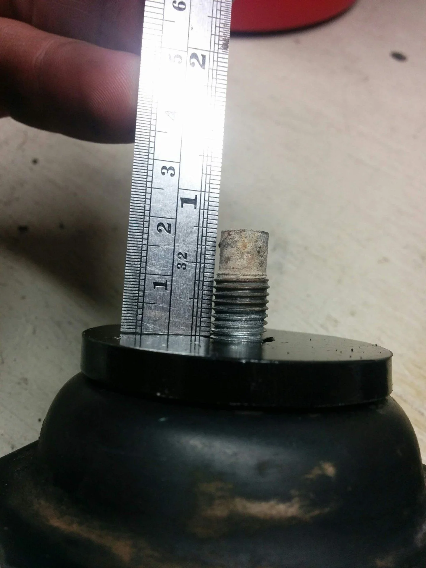

trying to cut 'spacers' for the bump stops.
tFiMs6wrLyFpzinZrtgnCnmRgeKmIHnJrUzYs9smXViLK0kPZOjR6ceRxQsIi2Y1T1Zh9DM1ZWf31vwiSHq_gQpV1pqXe6pCXmoLB_bdinHt4bE5xXLNv9PxBH9MPusTFrIDUJLdD1X9OUC5ffGDpLofNu2xkgb4cY13LWbWRD0CK0f2DQK8vVVJ6zP5fLkh8L4Z8IxsduExTXPj2dFQYyxEqgmFXuUtFUtTZzNmGkb13yLhTNdNAga-3LRyGzGa4UGri6mowPitxCDOGxbiy0fMMZh33wJR09EiJzzEZP0O3XGFVgPwJimdDLcsC98mcp4B3QeamYwLuFgQGopLAmgmu52zMvcEoCv1UxiZZAFPuM17yC7CSSU7lSRdrb4N7JT_hI8L_A9f9NeL7BFuB2mDZ5UEMOhRQiG4vmvv-avI8FHCi-ePgq3ju7cSISk8pfdn5LXish-FGZ41N1qB_KIQHu4zkDvqPid8iwx41KE6weEi_teAZ6prmPUBJo25TBDemKZOkXDbnSC-LSRgiFFYAo0uDwKb3DlML3naNkXrniG5Vx6pqrCHGIXNl-sBYbKqpwq-tMluh1BksuuMyqCf8cAOz0bgxtXxFlmI915f_pqMG11s9iEh1jX3Tzxp=w708-h943-no
TpkNDZlLOhYGueuoWr1cbd6s22K3h3M3uRivS9OySmtKZ6L5MxmWgpZUrKpGQxOhWPsuXF9_w8JfBNyRuiKi_s6QymlwOM9Wl79mpUCp4vr0h_k2ScnwWKR4zgUTOxODZHCjg0h2GhVNpb52f4Z736O0UZ1CaUP1ZkwR68hn8eDf72LRBs9lcL4G14VkDgsF2eZifTDY9DzTvGzyIil4u_6YU3cG9h_9mM6TtP-q6lhuxLpyYf9lSIC6Qx2evGlPQFe8PIgOqNCz2JBd97wyWMr1NUuL7MAwf5lXV5qklOS_3PBUixuUslODUx4C0DPvSS29BUTrCidl4VWEmvy2WtKP9l9jjNr7ho0LIZEBZAEO3Dk8m1BLYmF8ZziDNyJI3Jb1_NJ1vOs-weeVHiQF1eZbL04md-LzG6p7-q6iUXvx1PVp19TCUbLCx88Fni9_F5tFQAWXkwxXVkq-2r3vIO3kkextkFGBRxb5Qwcm-DN7DijJ409ufg5HmqhBP0L1ZAoM2puQZgv48hJQu63oyybPFkzqBPHrApilemHhXN6-k_g1xkSFQkc3WZcCZ9T1BxysdwvXY3O6v6pz0wk8SoOvJxiybzs75xRtsfNZWSbDFKqf0SVBqyT5DZPWJUhC=w698-h944-no
LEm1CkN1VG3E6doS-9x-nkofxg7JhskvxTh_5BClJgUrt1jn3XI3NlzyZQJus1aTcyMY2hh9i98mQr_4wod1UB6iWJl8ywn9d1L0dkxiu-PCwrzGqKStuMQMDOSbaTukBLFuMetIJ_tMJWVy_zX2tauGBikwwApqpzXb27S4y-8u17aCG7cz5iJ9D2KBfOkeW4DjaCodnyo4w6vpPyVOi0eSX4v9IavKGK9rqzmhnyjajBE3DNkklzCEoBXRrzob0h5cYa0TyJH2t1guVt_SM5xRl3i7_lgmv_d-AGXJBYg8MmuHknmVoFt4d0gJwE6lHTyXbELpNHQRUog5vtBeb4UDd0VbYkE63rEIgHxsDSXptGF3-uFElvcaTHKIWnhS-5Wemx5vrgsjIjvyN9ahXGiyrW64cWuxintB4mkStCWqHjKLArqHIVqIid17gcHQ2VZiFQcQhBbcku8DNHCDD0a9L7xDugd0-utpqqtvxJUI142tCv0wvmTJI27DxSEK7Tyd31Wa9DTxILClrDIBvqnqr06iCpolFvN0dnsX07l8bA-td_XCgFflA9imWWW18aFSnJSlNtrNL44rPSHBPMQ_gOmw8m_tUb4CoZ-gGeVOxH2HjN2c_av-FnlaL8YN=w1258-h943-no
Need better equipment, ergo a metal-cutting hole saw. ;)

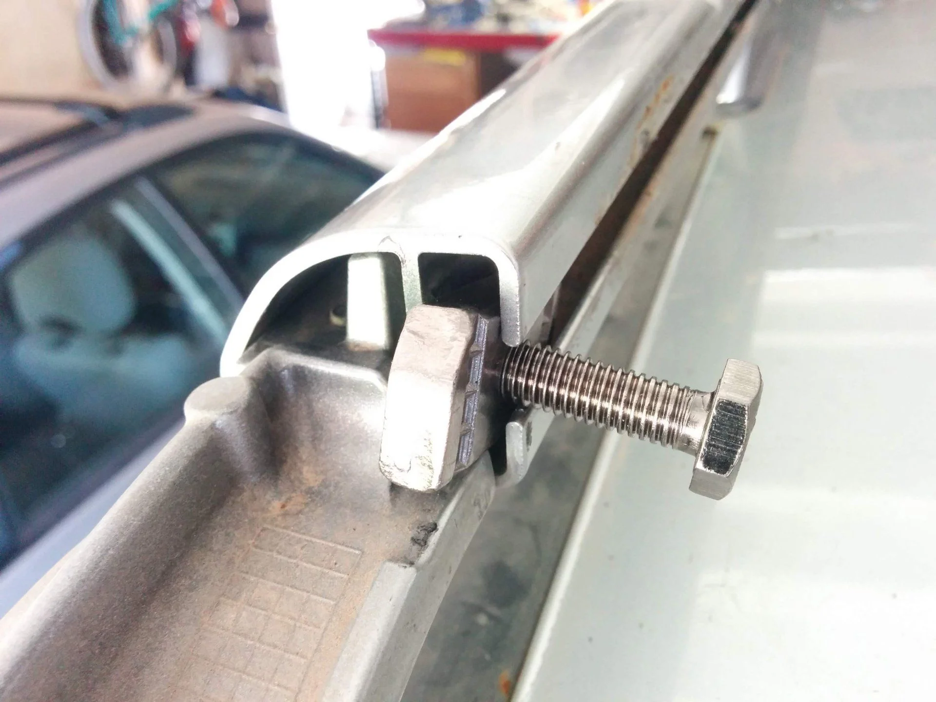

Rhino Rack Sunseeker awning mounted on factory side rails WITH (slight mod to) Rhino Rack's supplied mounting hardware.
(per @gahi )
I took the supplied 1/4" steel "L" Bracket
4u90rgIBqD_uS3pLG91dk7L76yFJD9kQnazPxmwBFCoI8Gmxsx7j3Qfq84p99h8imXw44Ktg92eZXgxN-0OsM11Zm6Wx0i54jl1gHAPK9Kyxm4LQ4LJHVmPjNLdT-ZMliOi2Xot3ULxM4_YAvRBTNnQcuEsmBTHpLO7vgCRTlBcbKUAKBg06WCMGZEUkcbgyiiKWpaTh1CEA8x4Pmq3WTRkV-CMEOrgKePrgMQ2H3GmSEMRk46qcpMWM3v1Kr4cFCZ9cY5ITG5Y5vaS1TDXHKpvqRbBFDiWpEhSO77iJJy5bSUgtph5z77hWRdUwCQ0gORdYI2KZf4A94mgqQll_tddlAsxYbBB3R2JVIh092SemczT2_uG4sZ6ykzvs4a1Nbc8KZ5yg_6vkyAU0cw8T2eDM9k0zTcBjc1dzoqd2jW8-4xnTnGfA_lA3KYahPfqDmKquYoe5hiZzzd_AK4VoKJ5ZoEZ4lMJWomNwZ9ywq1wSD811SYHEqh6P_V4WVNcUtyZUtku6qaXuEyOCROzRPZ-izSapU6ho2co5YeGdF37aafLSty4HBnuu_2r9v4DjBOBCL6bR3fQCYZ6CzgPNtiiLitarTZg18zd8oFDzg-q4Ap7ROfDxeXzXXQzpu33q=w1258-h943-no
nWnzYsaHq8PLq70BcxO7hEhnQEDFcAmzWLifZ0EhheFtFQ3S34BFlPa9pMIozrN8SXYMV-MbcvQ54SUSDpwKCC6P8eFmr1FNZwLrnp4ssO4GpVUGj58_KED8JwWvKmHOgMoe4I8NBXWULWPp87Aq6K3SGRgPxXnfZOPqxMFZYij4MsSvfAw2ejBzu_w5-hiw1AVNDKYWITO8EEiwWNd42GKtaPV6GD-OdRspn1JfqXw3lbGLZzr_8FgIgKb-jVqICnN-ACVbw8dkL7TUUSCxFWf_jahYB27Z231MRSYwTy6dYZDJAjL42cnSUR9cjHXkz2B5EN5kqmhCf88onFxp4hIEgahd_NXV6IzKqYLCyHWZDDZHcm-R7FvQoG7AoSfRLeSVJNbnRHRXk1aVZjuqb8dhBMHbdzwau7xE1kMFn2MnLimFPHhh6xGR9ne1A_xczcfTkCEmQA5HYNCZSF55dLb6jlJ-8FVuFUkZZEpm61WrYqtxXiap95crq3zRRAeTSl9mvXf3zYmBSN-LlWWoTfn3lHHU076bHadgjroR4EL2_v_05WH8T6Fe5XyDplLjV7j8EjiNfKRwQI5hZBnhH9BR7T4QerRxw79Jb-Q1siDQf6teNoywgOVSIktfQdA1=w708-h943-no
and gave it another 90 deg bend
qG3Ftd3UgF6UFUH9iSG6wje_NpxsFoUKqWGzT4lWoyBR__7XJDOPbp6l75-vALUjof4GmVDkYKuHI7iPG56KXHadkParXELJt5_IQIcGBctoWIxDtZdevy2q5meMopkntTlCMTkUaIdSrdUCulwjCOXRDcHfh4YX0DcRIZKaJdE1dBuzfvSgNhqSgj-Sqdh6xUGE7yVErYiQq9RGTPooVpWrW0hzlzVnipIIrYlOCQNAIEjzo7pfYmUTxXeiSyA-nTACz64eaLY-_q7AgI0h_f57LvtQ9NDvRSJ5cE4DTo1TVz_-zROAJB0FqaQAm8EkxRoRhvoejrpHtJorfCWoDhOiPEiYeyy4s5ihQkHQVsJWoowBJrrEEIIo5NzNov36Sj1eWKr--2zO2R2j-HeciWycKU8okJtJwLK4N-7ikpEnR-VVHkUyYYa2-Sz3axuoLm6LLWHiSEWoBkRScsFszF7Ke3kh7kPBJVmJmblDmF_JAh2QwfCWEglBP1V3Vk4LBiyoTmyrZrd7xbJV6akkU-uUt652a_A4NU81nRynG0gWBo_g3nDQBLuocyNwFNA2iEMrxAaFReZE2a6ArChcZSMtk4ja9xCT4bYPTTYf50QfAzdQFpVwBE2Q5FzUyP4O=w1258-h943-no
hA4IL3mzXMBAr-hAhA5FVemBYEJeBkxFICEEmAQvBK3Yc9pszYVOTvYEo3IOarG6Vd2NAFLGukdSq3LNaTrczpQWWqglt4WHn1JhNVHtblCIWioEym8zKxdB6mNqDMnmYHr0nx_yu181F_yYN95RG6mH9IAlMdTOR1egtvQVqeFeSUTxnDOSaOj4dJA24M6OZTguEbNezF0R_MW_9GuoV_QYKo8xV3gmAkavrX_OrmLeGG7t8FAzgk1DeYWHIMEH30whgBPpyzsDTx-qUpjPI1Akt05W0zLu2fQ1IPI2BhwqOWPqE6xok1ziGHNpygbnS2fzh7vOcUpAe8Fl8oZmk-dwmvjxUE4V0cLCQUiXKn-WCc6rNYd5yG8Bdu0-0t6Ije3Fr-rdy18m_4KaqTFHjChEzg-fy8-nzdzHCoCxrb7KBQJgM7Xx9TM1QU-qxZZnESX5_FPxUX7VsmkYj25sObahF2a05g9H38ai2gwSNO7hqou85o8ToQly4DpQMl4d1uMEDCkwJNXkQGXdluSkpeSJuphyOSS6yFc0ltwCFPqsHmocIBxwia8JsghBr6EenTSZiQdEkbaAJilB2VJbWjhM0RwP5Gn165uNLfwQVATf8G-kCCmSKOHSTgINZ8AH=w708-h943-no
7siCzmixIhyu7FfgLeVCaD0YArGJSkl5m2it7M9ycGiAEGVHS5iEZ7-h73n3AgEHg95pupwRgQhwqAFsvQ3J9p3XmMMDl-j89kpB7rRXNLRD6c6nqmhzrmvdN7e3DE5W3ntychH0RfmTW8E14CBpOuJsFIvLKLRfXY7mNvDVgOwgHj1mNSDIX8V_LFivE7irK4cAoDZOTc9j7nCPta64Ernz_LoAPyrq1Q74By4G4fdfFFP_mVLOMs3eaPZKbMNx7QGOeMx_Q9fR_3MYF2KWSjEB6jsqBmbH7hJHarRiv8l2LtGFZwFY9eiLlI9TjSJ0ZZo11cIkV9UkSi-pdIkK2s8cGkZ-DFdGf-y1vVZQA-x0Olz7XQEOugKe1fTzo0XlpovRqSZrNhttOjtBbH2p97qXeKJ7tXWAvZ4anUPi7XIcrEEyl0PhVwGHv2H1Jenk99XJHhmDYGMVqa0XmKJ240lnwkd8IQqDxArtsNvswN1fF_kNNdmrG6yud_3pon0TMfe4pzPXVi6qy9LOlDOD7fCYZoWsD797coVCoaWzN8dJX9Kk5Q1r4CvSIJuELSrBpnE0XTGYacqN7eTtFztsSY2DsNv1YFXplwJnXAShXO7-DRdaIjpbSlW7AocCtmSN=w708-h943-no
Oizo588GxeqgIIbOpUiN7xr9hfqwrV06lbvWVpyT8xLlIMPAlkX09kLk857YcH10Sk3VKiNPdXUnvZmdHz-vY4LIRlxK7GFmN57xiVYJ9WXwdPVaJ4ikzJ4lfpjJvJ-gaxtGWhZJnrkz1UrMLyd5ShjkD_xdREiGnCgsZ2YRbCq1ucn6_ACUeNiI39n1_Qu9U07907wCJw9LvvmbIBuC8wGvd766SI6tF36Cp82VOPUYFGtDVc8XpUxNbx-JgWFoTIhZxoylGNJ2Wvbhsk--AcXNGS08-DKnvKmv9NFMsirBn2VaVLpvqef25YMcT35T2y21XiLLE1y3_ER3Sfx_roPQKbK5ZU-2OagDisFiFyWRnMHOuTFPUeye1HX_Et1BoBTOgJ-9zazY2rBvGU13V72bGbOyGe0tE_a9-dkPpkxLBisNAYMVRshZji2uGd5hcxRZ0yqnv3-AEt8i6C3hQVmuxwAOXr4PMpdmkE3UI2yMGG1Nl0BP0TPAWSFB6CTX6qDvRoDL7tbabgosnVTcDNfaiBBj1E4I_piX5ORtCQvGXcoPAGABCmGWx3byBJbgoqTNhgiUl-gJIXHZ_PtDG_9c1Tu8gCYgEbb7KJgijLgh2mVqex1llWasHIzgu5TO=w708-h943-no
scuffed and squirted them.
A8H16x0l6mqSLltk_fJFIop6Y2GP7JXPhHVCLebPx7aDw44mgnpuE2sEPw4dfUbh7m3f9kE-5EDVrX5_eqghGySLEACfbQrg7LObbK0M9VOYgv61rexpyjaI7xhx_najn9HY769MsXYu7WXGBG7VYkttZWsgiNzKy_NUGiLHw4uzJ_ddz6A1dWMbOcwfOrzS_EsIJ0kri8AKc87CBtUwEuSz6H-FETQ9ZTEvXbd7pw_Q7g9VWVz0lylP3eZ68qoYCMVM0SwGSNCGxcf5Rtx_fQn2jbikftw9Ptcrev8UX5GnOke4RUvsxBQMToUrSlqbRBlPYlsFnfJbw6Qp81W3I-OpOSEObafkZhkAFNSy0k3YGZPohE_eqGC1l2pA-JYdqOC3Dbi_OeNAX7g0yN25IkogVA4qAZq_j9vaNI5Bh3KVyaDnIwJqffjRdiWTwmM8kY7QvaDFzgFE6ohvaru28Yse75Qozi6tLCsbRwDjeH2eYTILmbZQM_YtcSQ0qynkcmmcHxBalRTPrLfu0hny68BbqjQaWp-BduWRj63BsO3TyOuhpL1u09wmMikS-2hm5tPVdxQtHq8nukKLG6z_Fg1f9JosggjXODQW272go4y57nXOKwb2nfupzUi5zRjw=w708-h943-no
and bolted them up to the supplied cam nuts (as above, just like unistrut nuts) which I inserted into the side rails tracks.

So I pulled it all out to get that silly square bolt from driver front and swapped the cam nuts/awning brackets to driver side. i squirted the 1/4" cam nuts and bolt heads black and put it all back together. I put in 3/8" cam nuts but they're like 1/16" thicker than the ones that came with the awning and just a scosh too fat for the GX rail slots.
So I used the grinder a then squirted them black too. So I've got a 3/8 cam nut first and last on the pass side and the ones that came with the Rhino rack awning on the driver side plus a pair of 1/4" ones in the middle. I wanted the larger ones in there for peace of mind in securing/whatever, and the 1/4" just seem like small bolts but they're probably fine as whatevers. I could put in 1/4" eye bolts and that could be useful... i dunno...

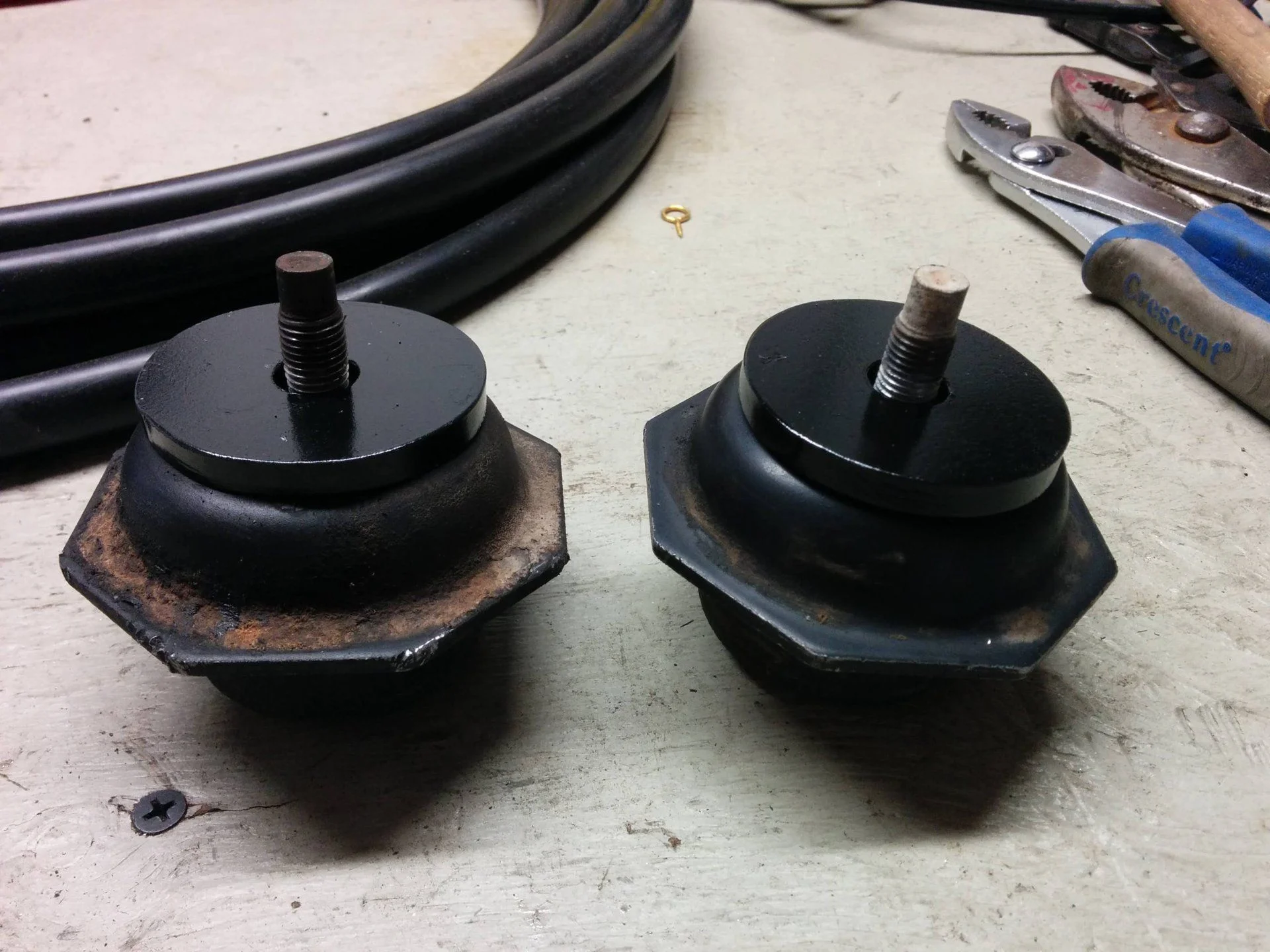

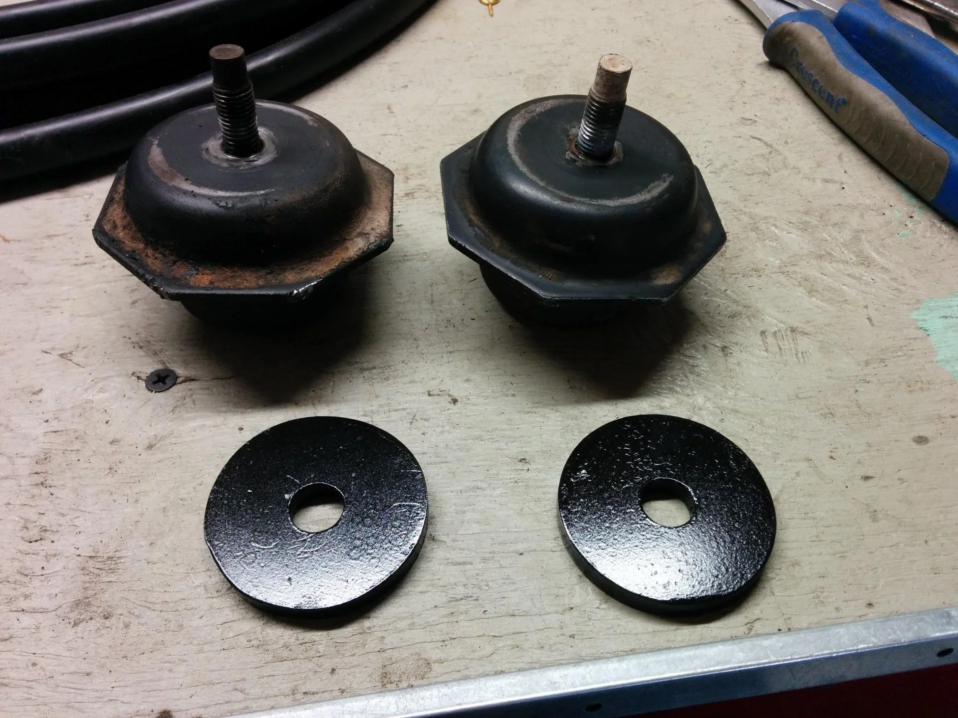

finished bump stop spacers v 1.0.
These are 0.25" x 2" with 0.5" hole (maybe 5/16 would be more perfect ;)
ZlcNI_Te0TRzk7qf_0v2qEJTorYnn88aC36mi_tnE2xyBcMHP-8HcLImBYPL9h1Ud-B6pdokDUxX6fVN4oLPdPAtWrhht0n71VhYyD_jRafSjsOuFwTZgnBKPCFLc7gA2ztJPuzP4sE_y7o8Q1nN210aqL2ZuMBHEuqiUnSl8gsVct2VCjlbWgPPsvaMK_L3LtDn4E1YnZdMWBMEsjLRcexxRiW1rESZPvkyUJDAqd7YbhYHwajxDXLhlAsy1bZkriHh4rsQF5-uRTPL3tcFM2Tam7i-ZtwABaeYsbi8mc5VZR8IeLaIQwHV9eR1Rt9OnxNum8MGKobQi7nhxlgQ4NymRCl1Xro0v2leS5_Pv1jBO6wMtbetF9e2v3klTXtM6EIWtMvdngGLU5yBrNfIDqK4C22HUbKGHL7dIY0Ygy0nT5lXNb98pOqR0v17cvQf2NbN6US7Iq6eim2Oh4KJ6cIO4ZLi2BV3Pstszi9s7QtUtC9u5sJb3w8WcVDQBkxMdLBiC355gpD78GMwe7TgRn_mgtmsNYt-wBD02Hzd8ykqxQ_dFpk0AItpddWJw9Fv0oZ_NL7_Cdd0oifLTfX0aNJStXtABS933NLPBrm9LF1oxEaPdDrZHQQLIEm3U1uy=w1186-h889-no
*EDIT*
I found a couple leveling kit install videos that show installing a bump stop spacer. This video (7:37 for bump stop spacer) is installing a 3-1 (3" front, 1" rear) kit on a '16 taco. They have to use a ratchet strap to get the front back together to get the ball joint back in the LCA. It's a 1.5" tall puck, thus a 3" lift. kinda big, but like I said previously, seems like tacos use these big spacers often, and some FJs too.
ANYWAY, point here is that some of these "kits" come with a bump stop spacer, so it is a thing some kits are trying to address....
They also install a diff drop, I think that's because the overall lift is > 2" (is that the magic number in Toyota land IFS for dealing with axle angles?).
They also have skid plate spacers which must accommodate the diff drop. I think all these spacers are because of the extreme lift gained...
I've seen comments (here in mud and elsewhere) suggesting the shock can accommodate 1-1.5" from it's inherent safety margins. lift I still hold that a bump stop spacer seems like a good idea and I may just stay with my 1/4" instead of going up to the 3.8" I was going to build for v 2.0 ;)
Still, these are the low co$t "mall crawler" "parking lot hero" means of lift and I still posit that the mild 3/4" puck affording 1.5" front lift is a viable means of gaining ground clearance on a stock rig that sees off-road use. I still recommend caution with hard or extreme compression and also suggest spacing the bump stop down as insurance.
until I pull the trigger on an air-bag delete and real lift with concurrent suspension travel gain, I'll continue my use and testing of the 3/4" front puck which retains stock variable shock dampening.
