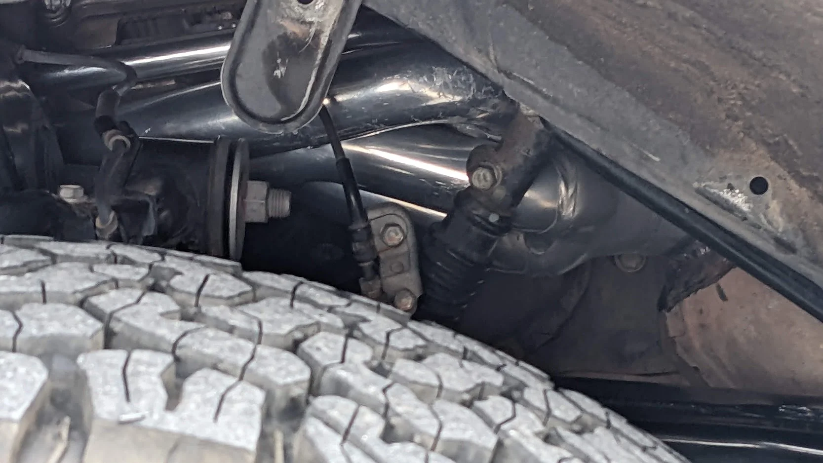

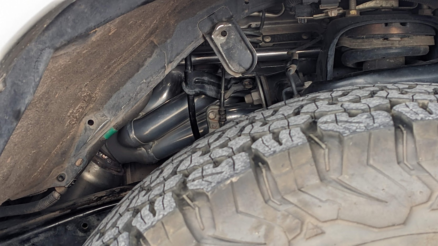

It's smooth, it's stock-quiet, not stinky, and I'd say it does pull a little harder in the 3200-4500rpm range. It's nice!
It is a LOT of work!
Maybe engine mounts would've solved the stress issue on the manifolds but for a better solution to the [choked] log manifold prone to eventual failure, THIS IS THE WAY.
The new engine and trans mounts we're a no brainer 'whole you're in there', considering age and mileage.
so yeah, definitely recommended for those facing the manifold issue and the variables align to make headers happen.

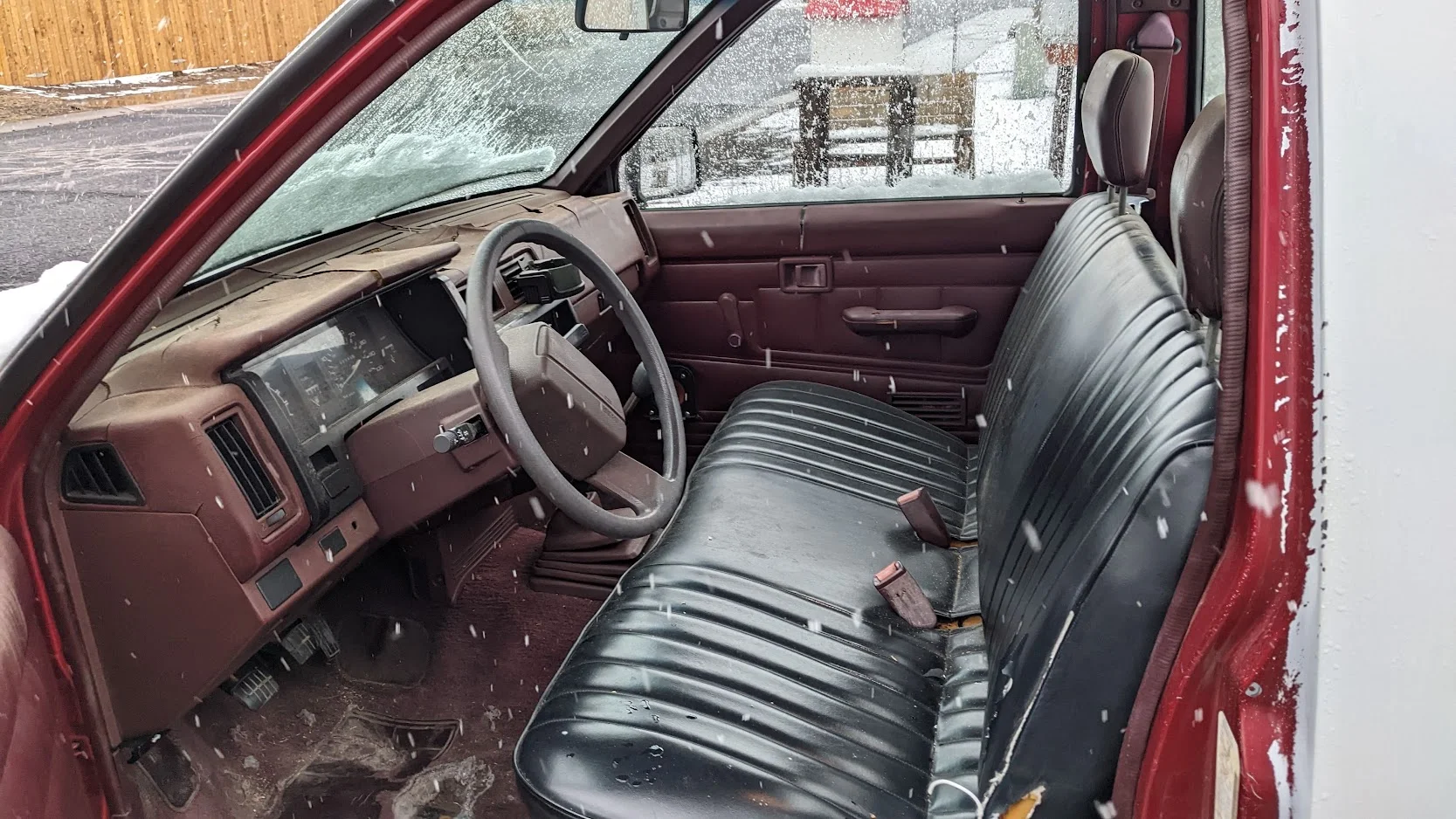

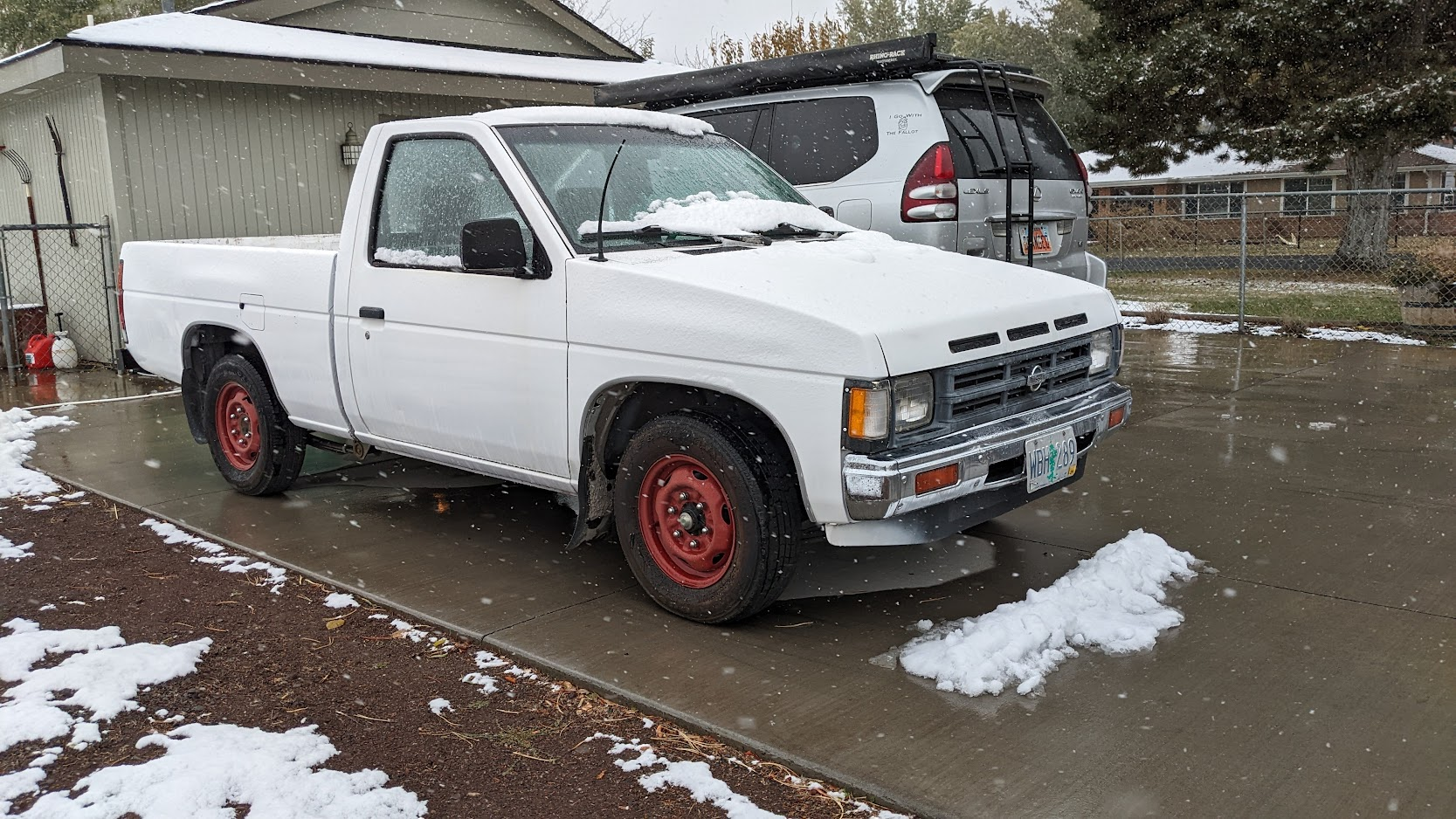

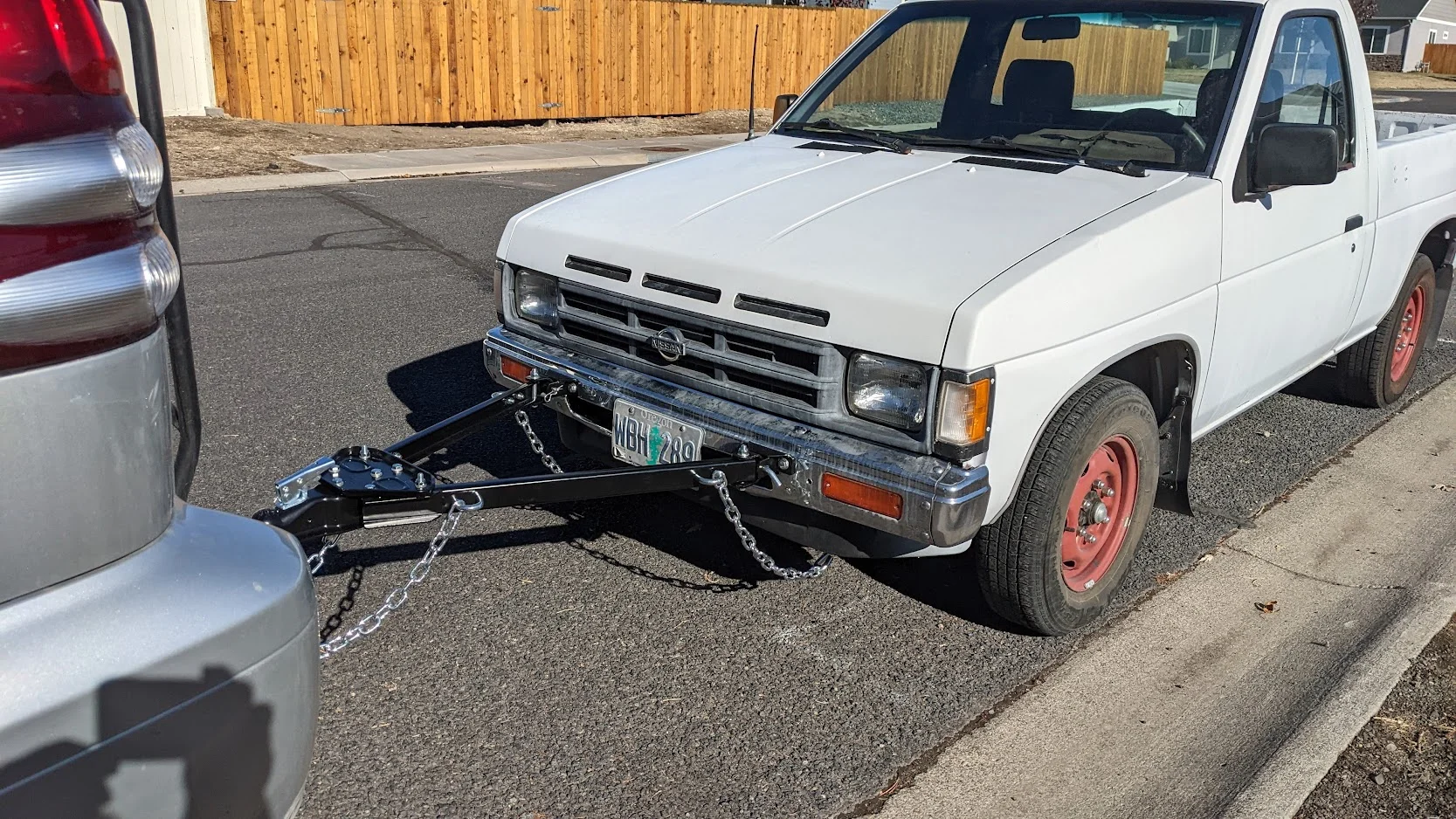

I retrieved my dad's 1990 Nissan hardbody (I've got kids that'll be driving soon 😬🤪), and for whatever insane reason they're not interested in the 'world famous Superu' *(which admittedly needs some review and probably every possible bushing replaced) 😜 in favor of wife's current '03 impreza OBS, so I FIGURE this p/u will be an amazing learner with little get-into-troubleness about it!! 🤭🤣🤣
Manual EVERYTHING! windows, locks, transmission, steering, brakes.
No speedo, no trip ODO, no factory rear bumper, no AC, no ABS, no airbags, no radio (he had a deck installed, but only the left speaker wired (lol), reupholstered in black vinyl to boot
HF towbar FTW!!
so the unexpected 1800-mile trip was productive and I have a rad commuter (need to bleed the brakes though, lol ;) and future learner for the kids.

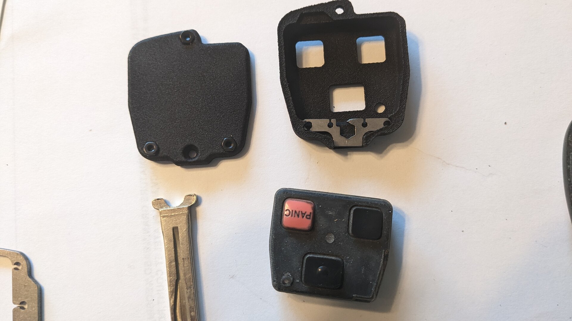

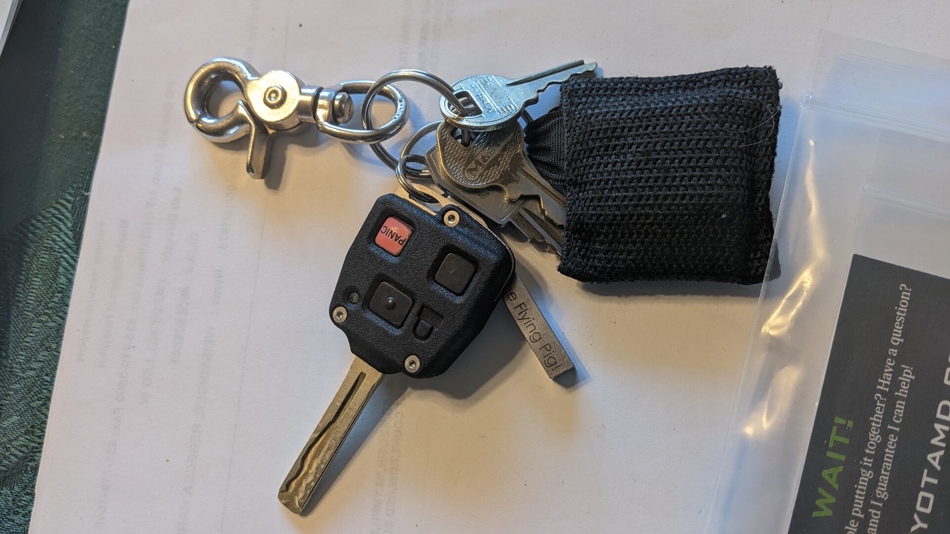

Super badass fob for key blade support!!
View attachment 3189077View attachment 3189078
HF towbar FTW!!

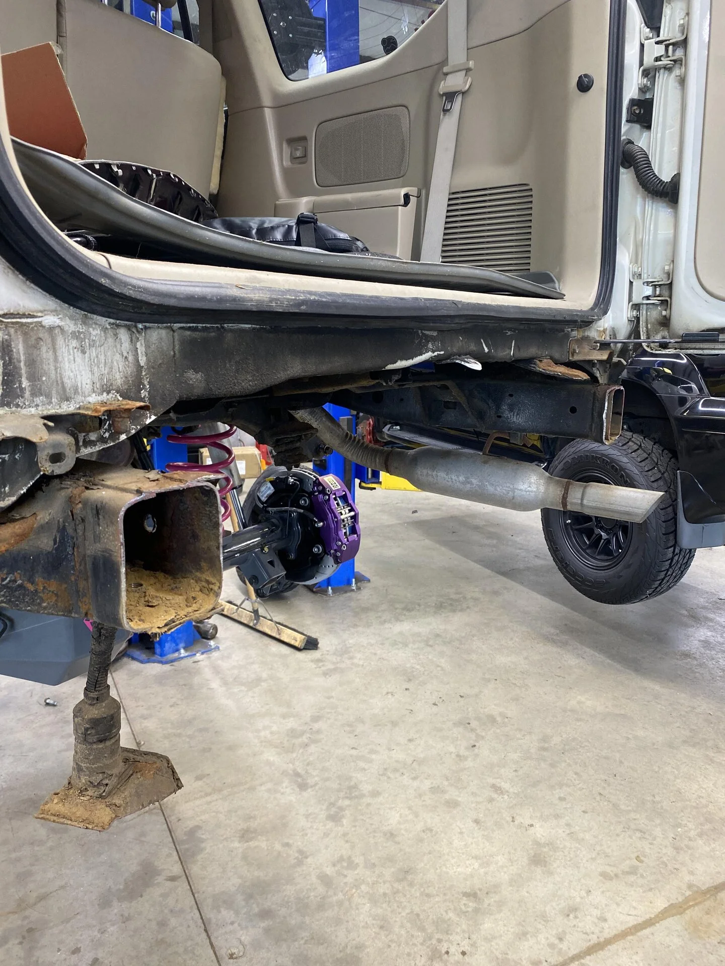

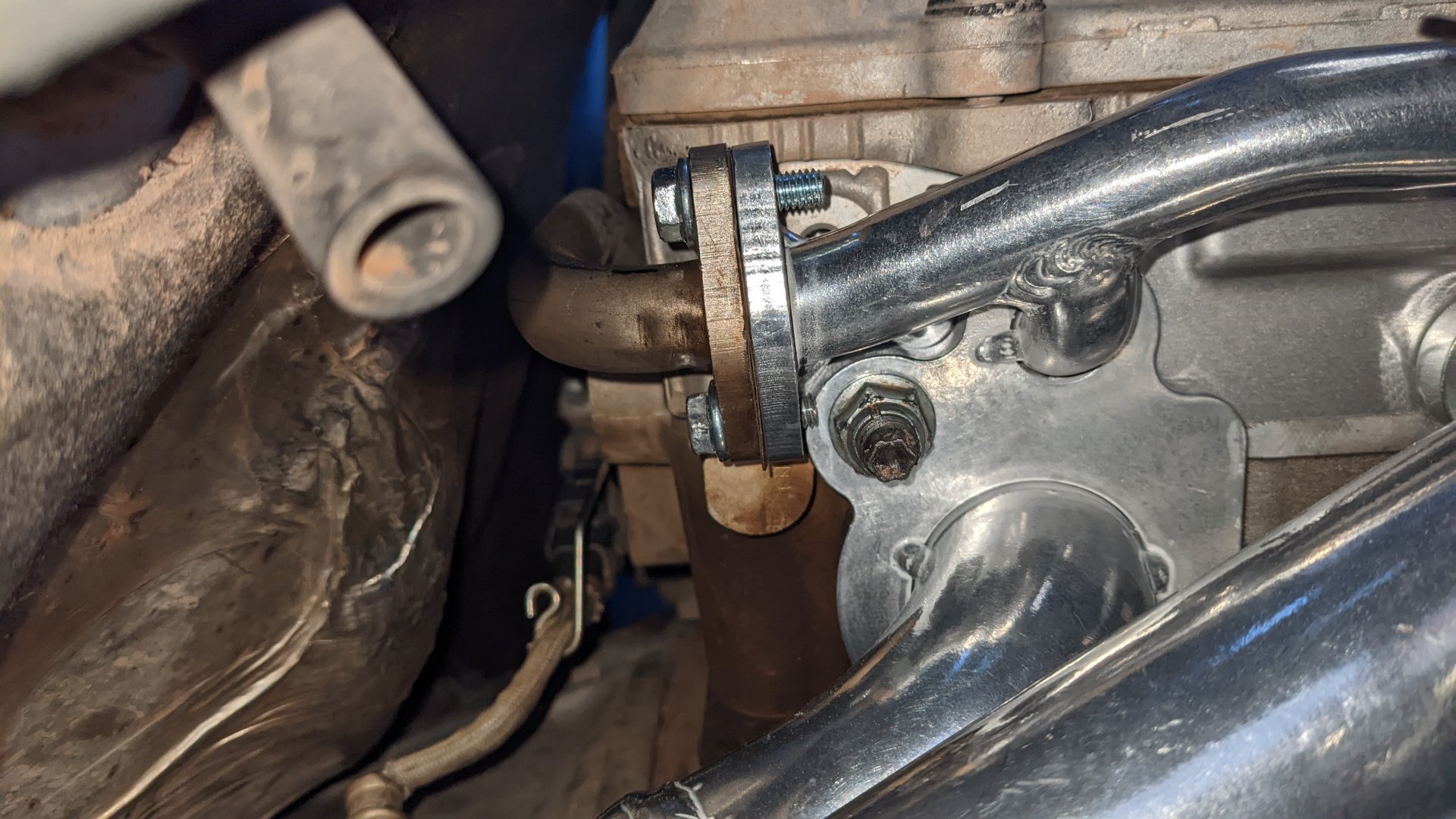

With all studs retained in place there's no wiggle room (specifically driver) to hang the headers on the studs. I pulled the motor mount bolts to free up a little room, but still not really enough on the Driver side as the header contacts the steering linkage and the rear top stud,
I could hang the passenger side on the studs okay, around the motor mount in place still, so I think that side will be straight forward, I just happen to have started everyting on the driver's side (glutton for punishment that I am. . . .)
I think needs to stay a stud b/c the tube in front of that fitting would be ultra hell for bolt fitment. Plus scratching the tubes with all the fiddling :(
This stud will be a bear. . . .

So, I'm thinking a mix of studs and bolts and opted for these.

I'm just catching up on your progress. I recently installed DT long tube headers on my '08. I pulled all the studs out, cleaned them up and reinstalled them after the header was in place using a "star" socket. I put the OEM nuts on and torqued to spec. It was a huge pain in the butt.
Keep reading, lol 🤣😖
the tube configuration is different from the short tube in the long tube, I spent an hour and a half on one bolt alone, driver side rear bottom. There was no way to get the header over the stud so that is replaced with a bolt. Props for getting them on and using the e-torx to put the steps back in!!. Nut access is wicked crazy on the short tubes, and the flex head 14 mil gearwrench was the key to most of them.
But they're all on now and "torqued".
She purrs, is quiet and has a bit More pep! The pull is strong!

Exhaust gas rails Were installed using bolts (M6 1.0x20) instead of the studs and nuts, and passenger lower bolt was cut down (maybe a 16mm would be good there) related to header stud nut interference.
Driver side's car-side flange seemed clocked a Little compared to header flange maybe tweaked when it was pried off the studs).
Hmm, I should put some keeper nuts on those bolts. 🤔

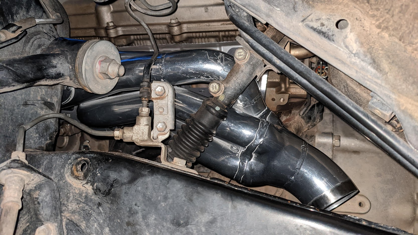

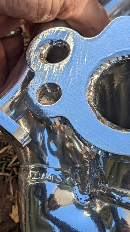

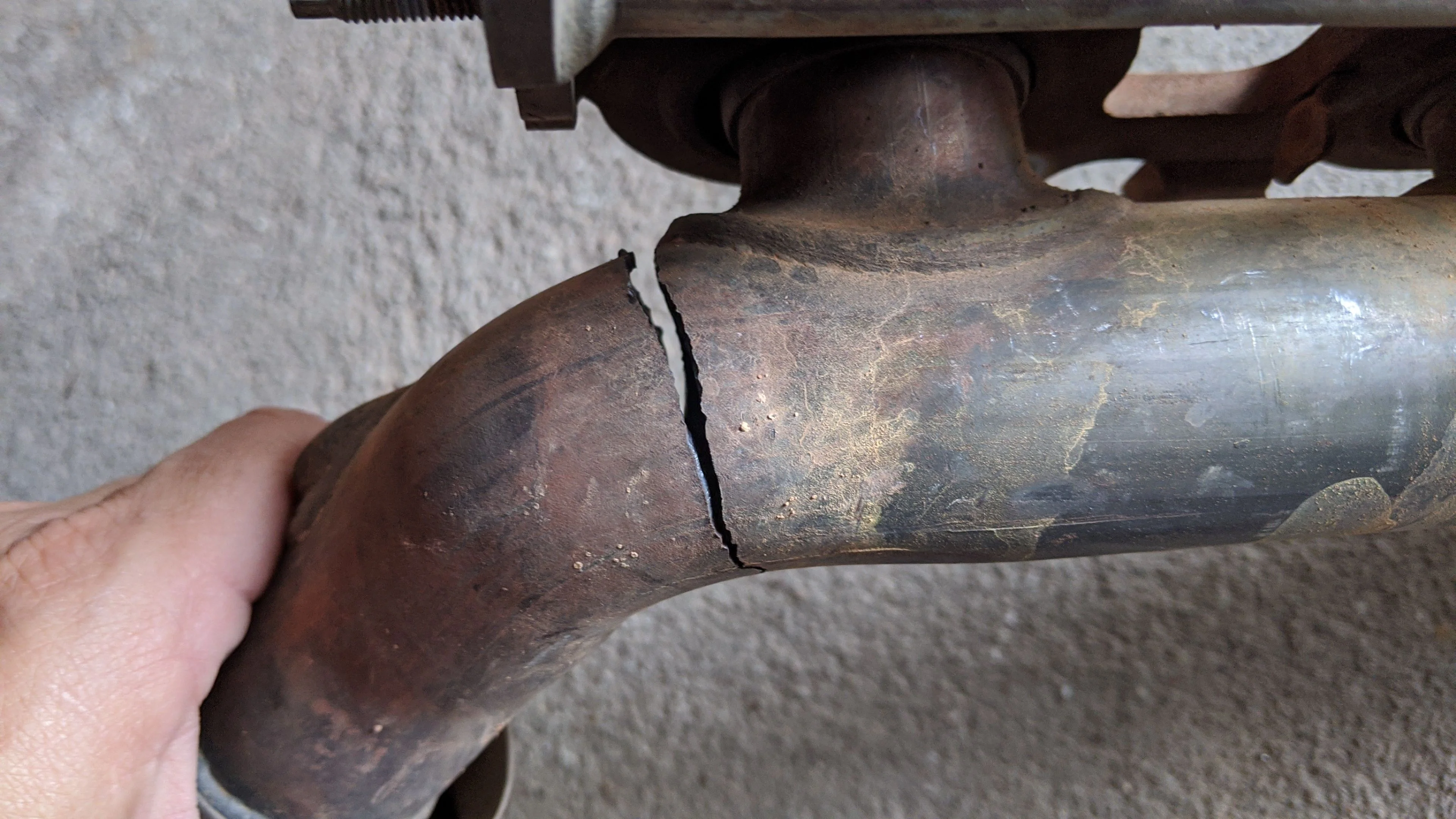

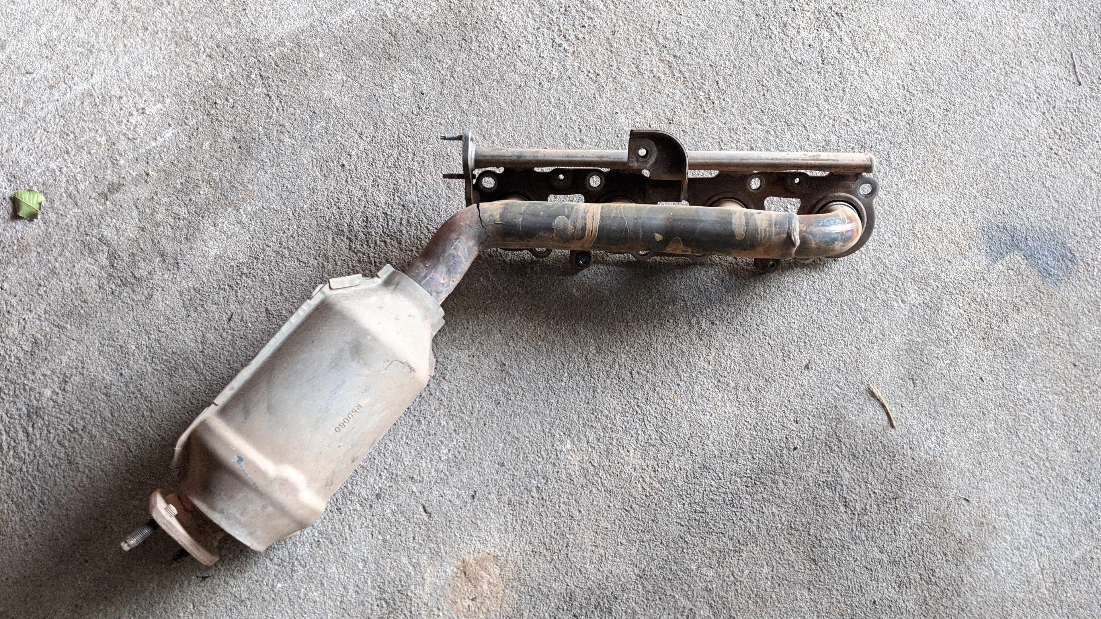

Exhaust mani repair completed!
SUPER quiet again! I hadn't realized the slow increase in tictictic, until it finally let loose!

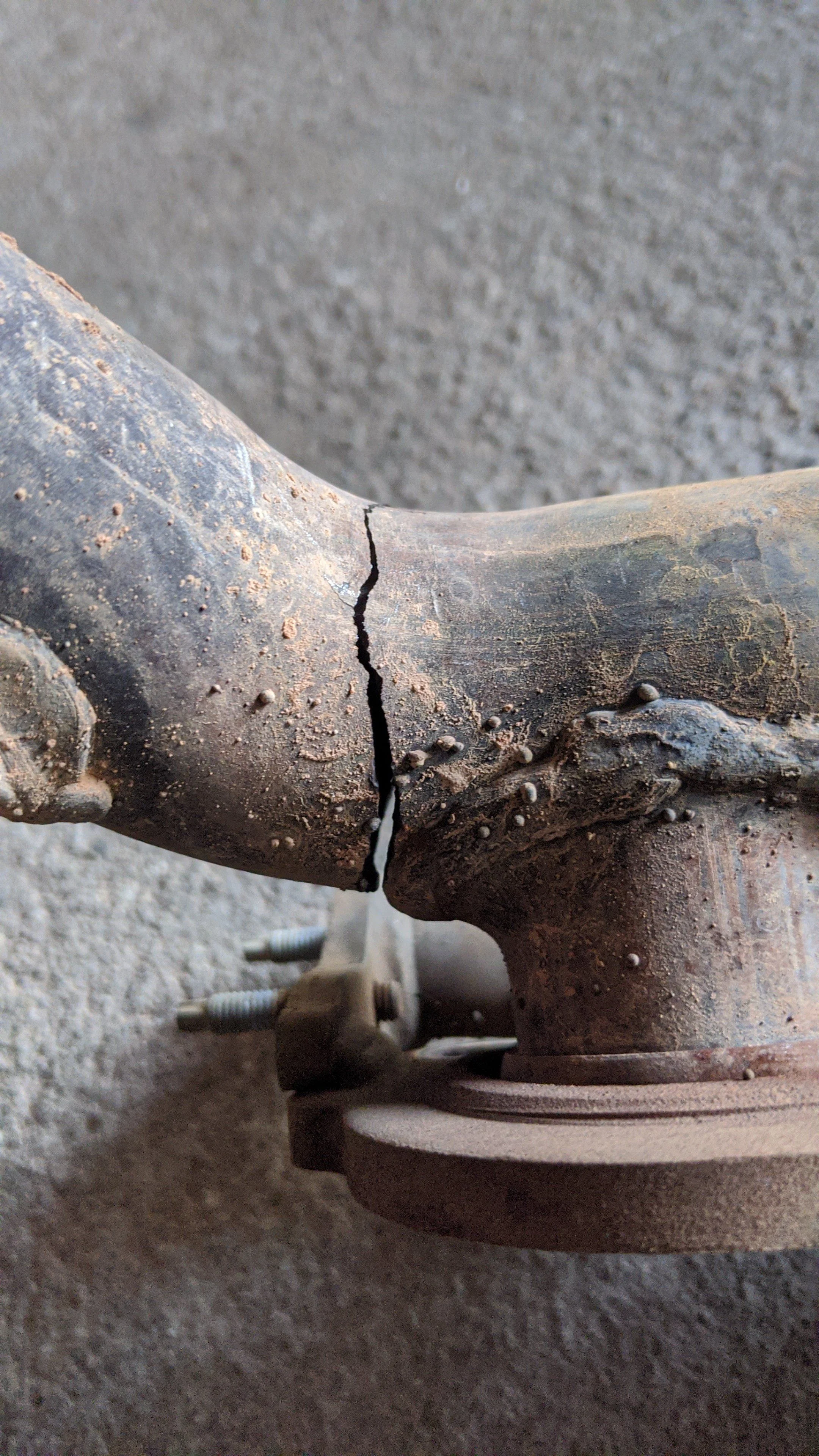

Hindsight, always 20/20: I had noticed my 07 was a little tickier than @Lifted's 05 (similar mileage) when we fiddled with his bumper last summer.... I recall thinking, WTF, why it is making that noise? his older 2UZ is quieter than mine!... 😝

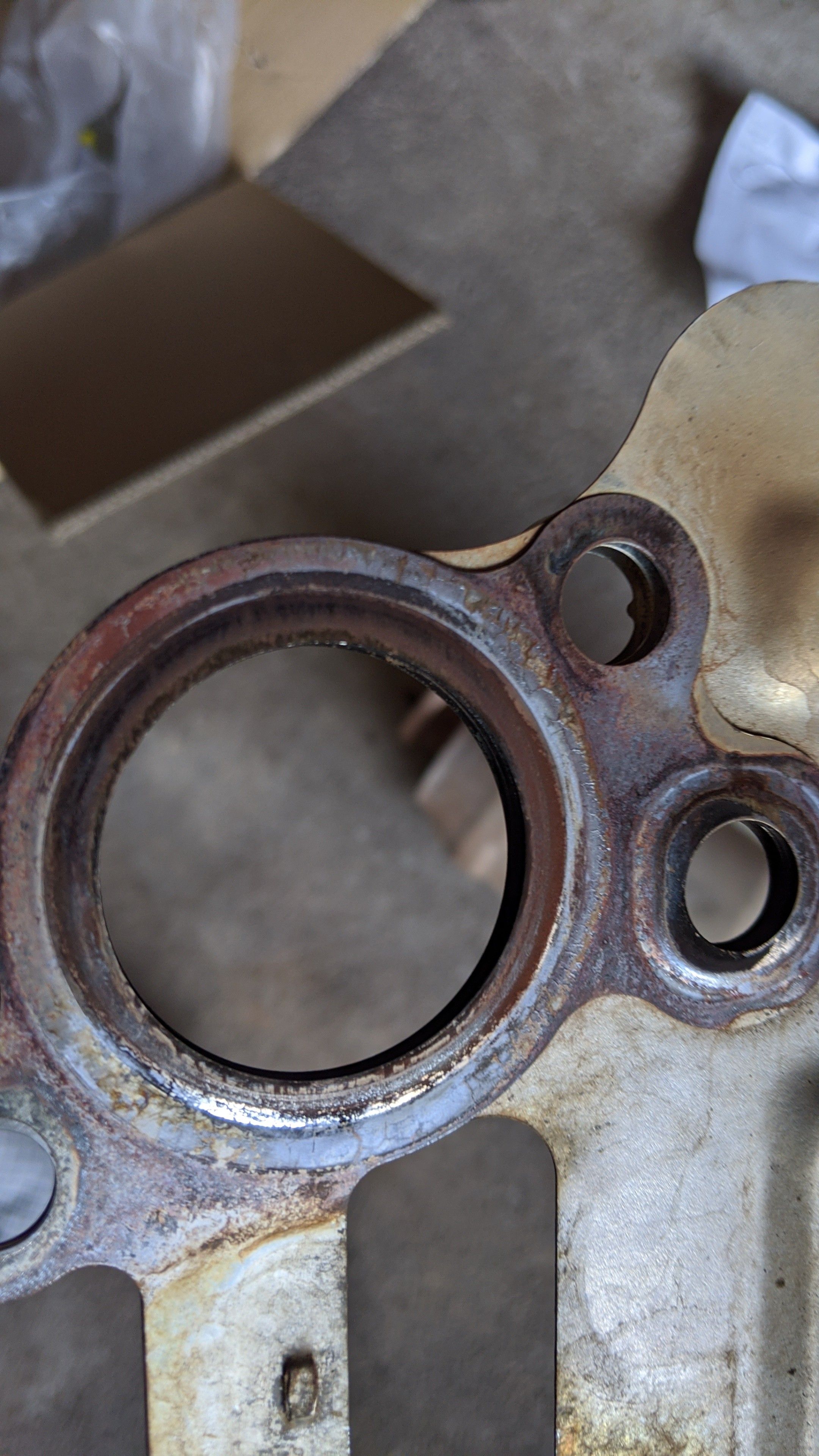

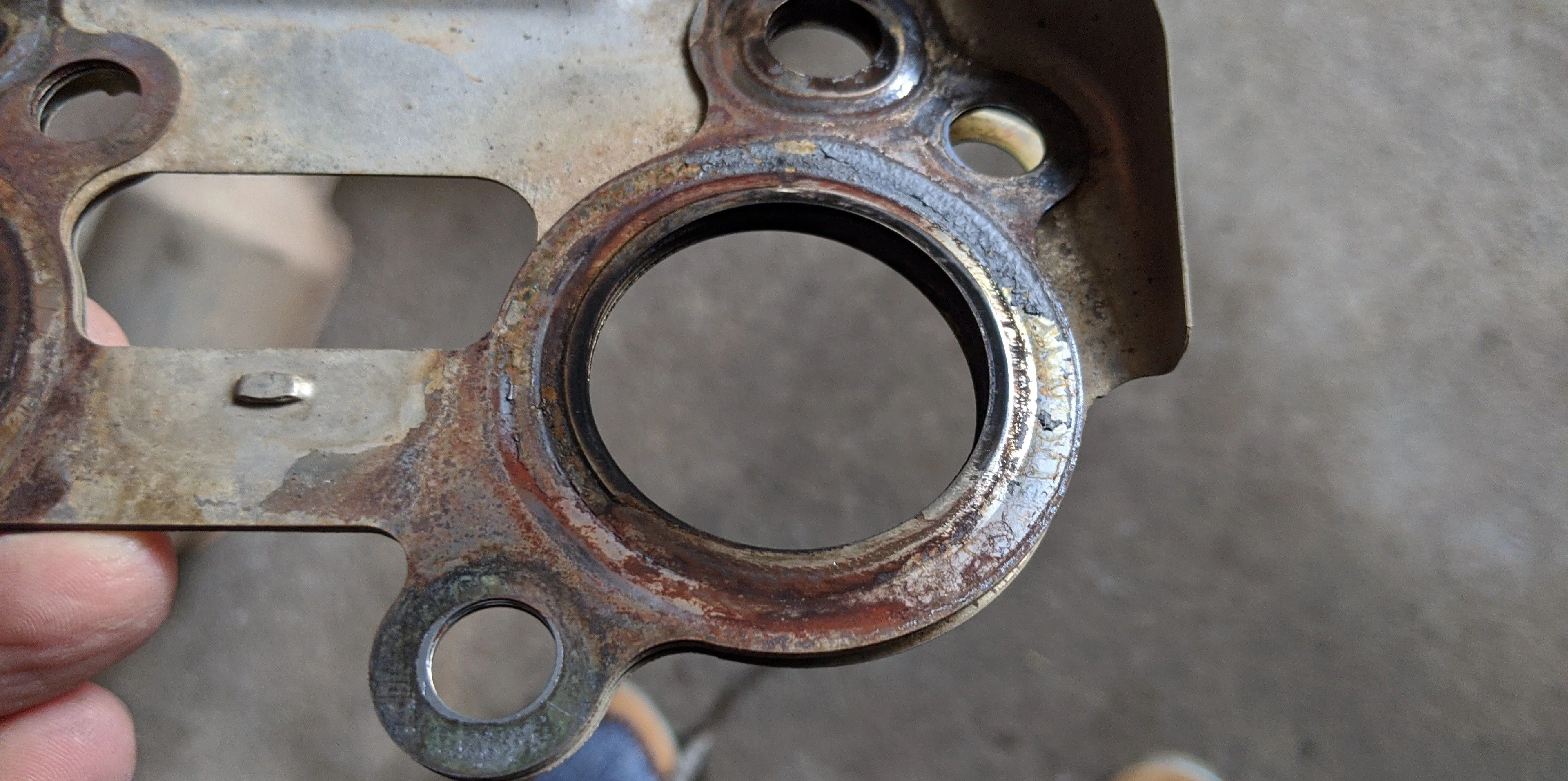

So my PAX exhaust manifold failed in the tube bend upstream of the cat, NOT at any weld. But the failure was a nearly circumferential crack. I was surprised to learn the manifold in this car is NOT cast but welded tube. interesting.
pix of gasket for kicks too... hmm.
I replaced the 8 studs too (as I expected), but sadly THOSE didn't get returned in the box with the other broken bits I asked for :(
At any rate, she purrrs again!!

Yeah, that was the stock exhaust manifold. I had a dealer replace it with another OEM part and THAT one cracked in the same place 14.months later.
There's another thread discussing another non OE manifold brand but it kinda turned into a DT discussion.
Stock OEM manifold replacement is okay, but $pendy AND YOU SHOULD CHECK OR REPLACE THE ENGINE ISOLATORS TOO. Mine seemed to be packed out and sagging the engine about a half inch which I suspect was a major contributor to Manifold failure(s).
I think the DT shorties did positively effect power, and there's NO doubt they help engine efficiency, BUT install is a real deal.

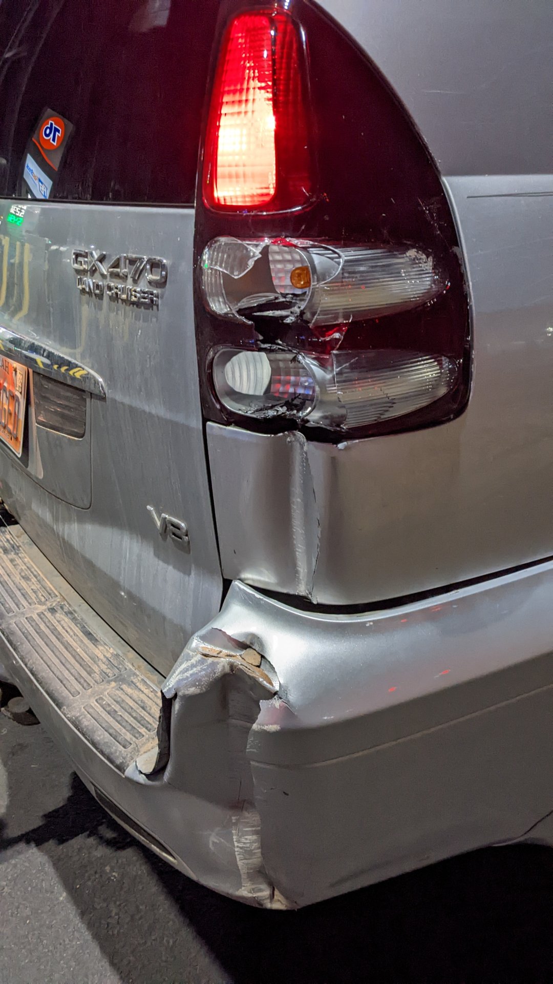

Insurance claim filed.
With longevity/customer loyalty, accident-free for over a decade, multi-discounts I've been assured my rates won't raise by filing a claim so the process has been started. I'll eBay another pair of Prado tails and am bumper shopping! I doubt the claim would cover a bumper but it'll provide a hefty subsidy!

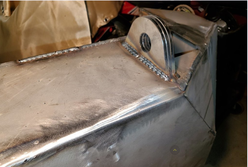

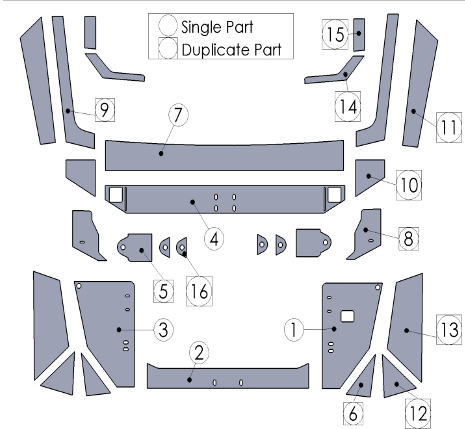

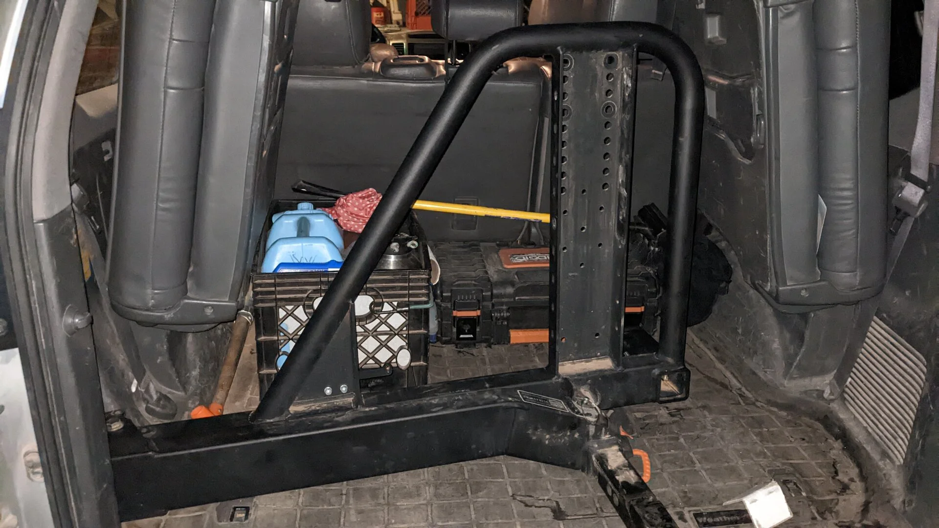

Seems like the 3/8" shackle point is two 3/16" layers stacked (pic above was from customer who ordered a 3rs plate?) and One (#5) penetrates the back faceplate (#4) then is sandwiched and Tee and edge welded to achieve thickness.
I'd consider copying #5 in 3/8" or 1/2" plate and opening the hole where it penetrates #4.... If that would work.
I can't quite tell if #5 bolts to the frame, don't have mine apart or the coastal kit in hand to asses.
So, at this point I'm in the analysis phase and haven't pulled the trigger....
I'd do the mods to mount a Yota pintle hitch to retain rated towing capabilities, rather than Coastal's add-on hitch, but I'm also concerned with how much of the spare would be visible when mounted in the stock location.

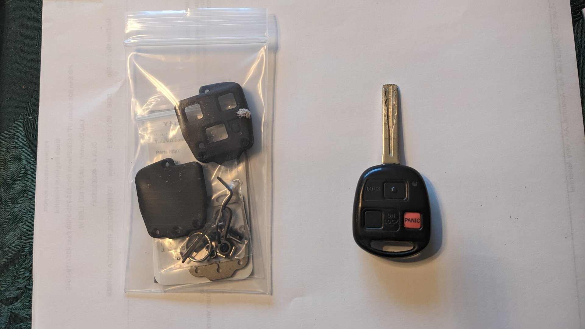

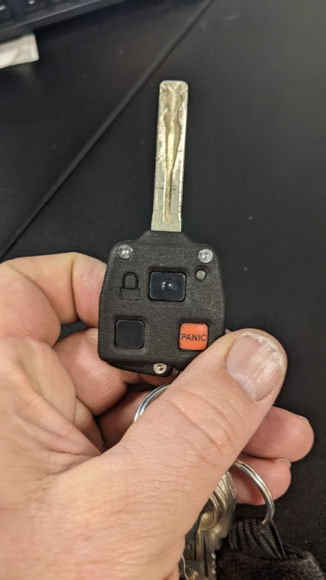

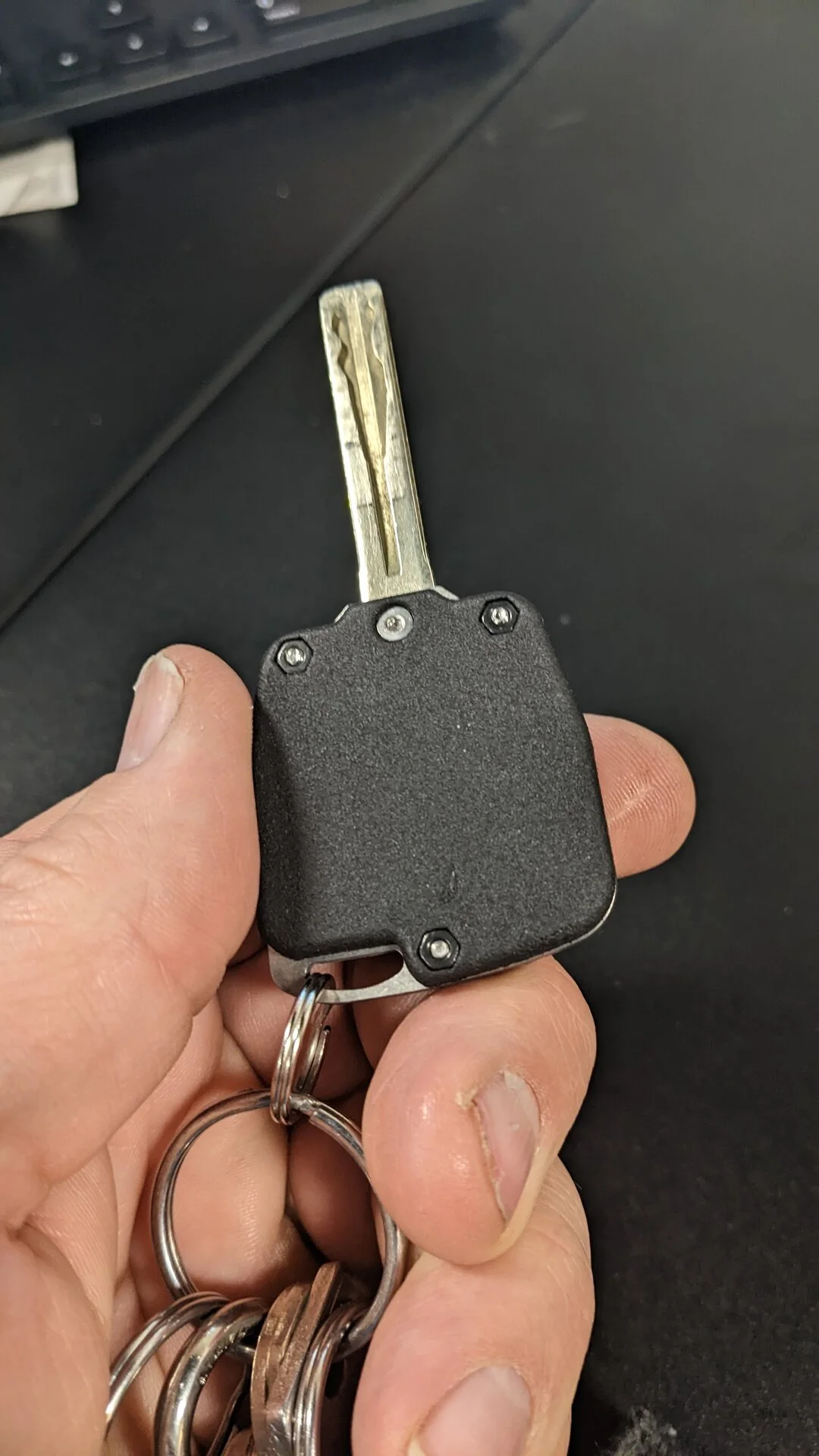

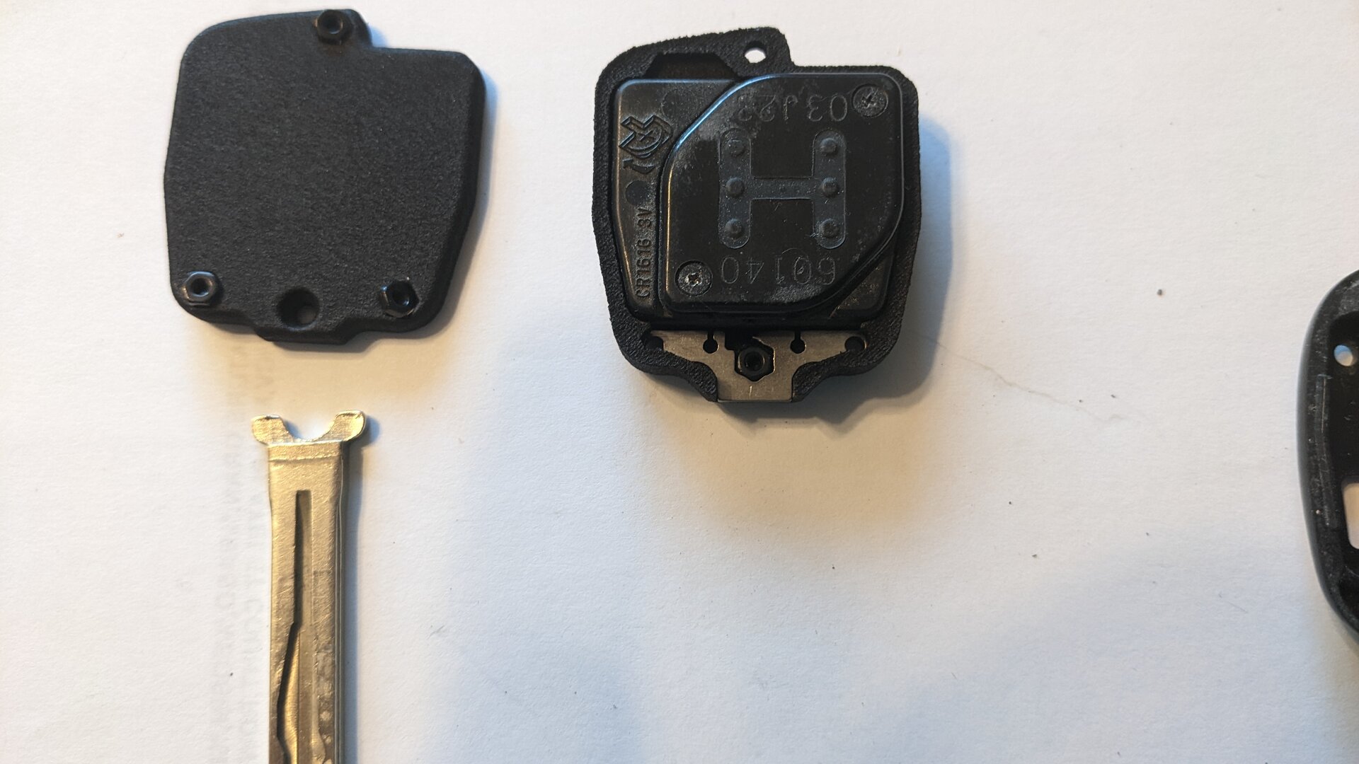

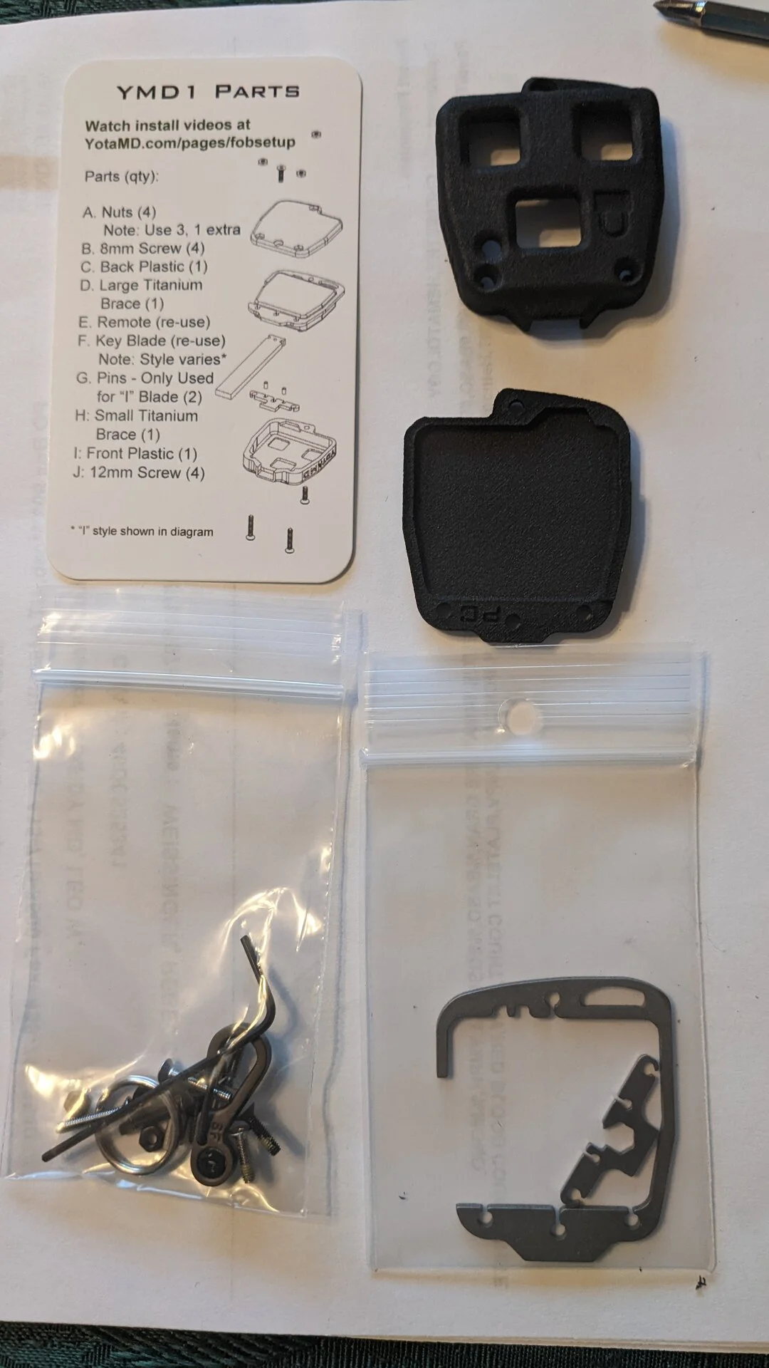

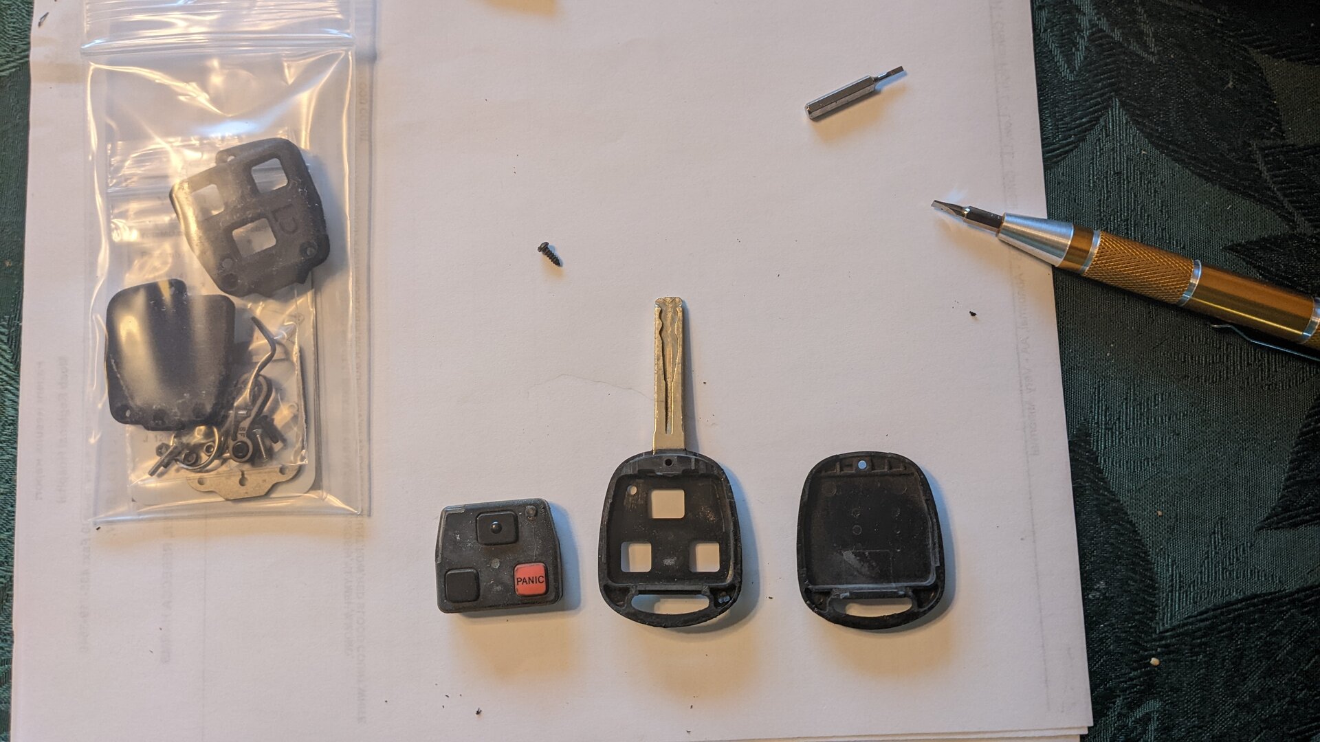

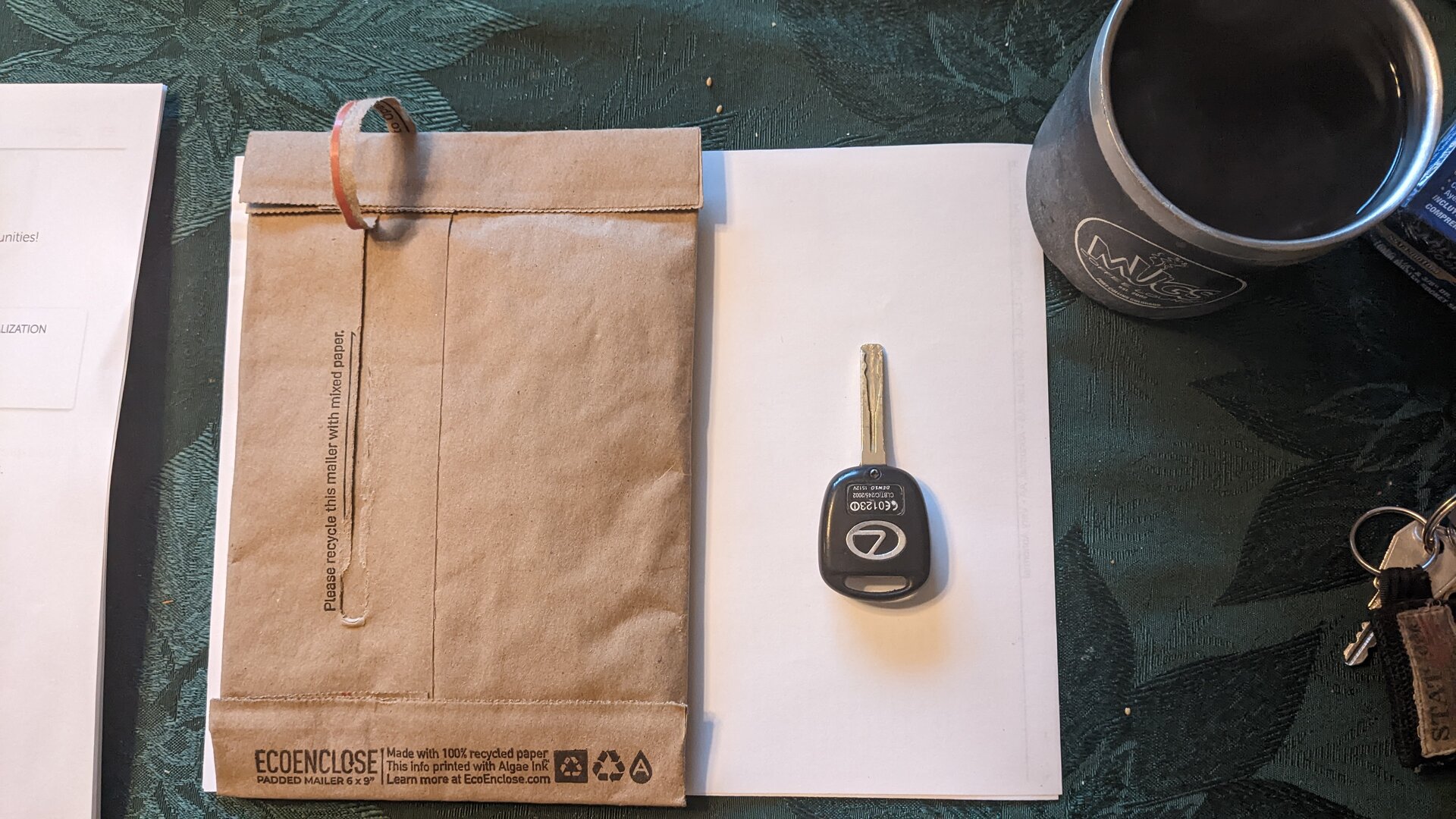

fun project, but the U-style blade fitment is NOT awesome.
skip to 3:45 for the U-style blade installation in the YotaMD titanium fob kit.
I'm doing their threaded hole blade replacement (T-blade) as well to get the BURLY AS ADVERTISED durability as demonstrated (@7:50) with the YotaMD titanium kit.
FTW!!!
d9dCHmTNju6_rpNwJVgmween6O9kpBYRcLbx_BQslEPSm7QAQeroVlvsCVQcTkVz1p4N2xKvrFwCJx6F3mTdX-r6RlnKuVnub-lO80pyJ9zC3GUjBRvBP6X2oN4yGk7dp1HvxfeUSPiDe3V8cH_Rbxghs8DqR87KezOQeJzZpQb7f1U9syjavljdOiR8jxtOrpEORuV0fGDuESSX3V--aOjmcSRCeh4toOZjipsWqeMISLovZadwXS-cTOIVpGMMpEFL860X-jafG3URV167WEVyPRsu-zmMyi80n0iGwhPIB05ARjJeExNCottWmtwNX7BSq4YuvOVx0NzeMHXWm-c4i7eVzLiFd6wzDDbgvAtNeknFZQdNqyqHkWu5VqVe-i0f1DyuRvTkC7H0pdfBK9JsZs0AGT_XZ-TGKKexHp45XFmthj1WrvjIblsNBsQsyOfSzxnEOfy2r2CC45dKmQDPsRbSWn32yCff5PiCx_Z-22YHCPspWJMiOj-Dp6JxrYjzdn26Y5_1S9Q6AEjltF1hR7DIfz0EO9WJniax4Di0OtUOFFoe7aIpLcIVD1d3txEddQL0nxJ9gSKVRmGv9hqG6cbQh-cgn4fT1fGz4-Q1xOJ5zENKhKrbVSIbU9vSeDw5S2C-9gK7dBZIxbZKtr9bqmbClkw_MZvA4eHaNPlwv3enrsS-cHp-rC6wppY1uxqSsQcY4-hXl8bLqSZhHWgS_9il9yUouROdCrep--i20LlU-ye2h1TuD8YQDUGDKeqfiiiEfA306VO7q1YLloDfgQ0DPPm-6qD5zoENH0vECbq1BoI775HdrosdAUG-ngXN8-pTHA_2UHI46Tz8kh9AxtsMwc0whp1zex1TlXWK1OudLRx20CShKkMFAkMIuLkFNAn1kPSU_12qrG-kxr2UZh-zRluroz_X1OD2rFW478pSdQ=w529-h938-no
I did the titanium kit and it is awesome.

Did you scope the high clearance Coasterl version? Some cutting and welding of rear member I believe, BUT wicked high clearance "in the end"! :grinpimp:
#5 does not bolt to the frame. I got the long arm so I have one swing out. Not sure if he is showing the beefed up hinge bracket he made for me to support the long arm. I didn’t like the ide of those latche hooks in middle of the bumper. I also reinforced the vertical parts with some extra steel I had laying around. I have a few pics in my build thread. I have towed a full 6x12’ uHaul trailer 1,000 plus miles no problem with coastal hitch.
Good beta!
Did you scope the high clearance Coasterl version? Some cutting and welding of rear member I believe, BUT wicked high clearance in the end!
Yes, that was why I put it in the running. The 4x4 labs has the same. We actually cut the back of her frame off to mount it. High and tight!!
