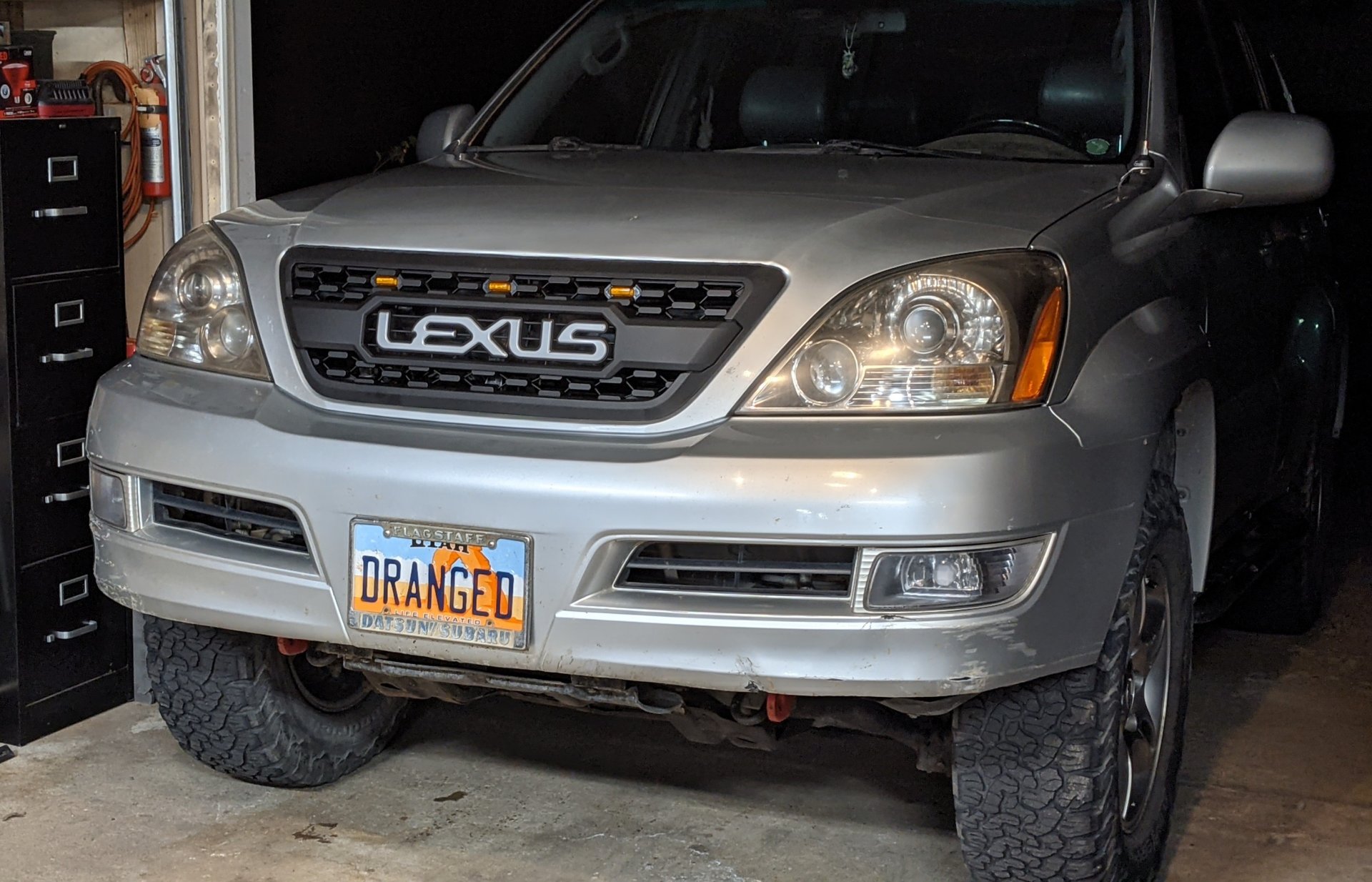

I'm not an automotive professional or electrician, just a decently competent DIYer. This is what I did to power my LED raptor lights. Of the many ways to power lights, this is the way I chose; Proceed with your mod as you see fit with caution, similarly or differently based on your information-gathering and investigations.
I think these raptor lights draw like 3 amps, so I chose an add-a-circuit to tap into the ignition circuit of the fuse panel. These devices retain the proper fuse to the original circuit (here 10amp) and I placed a 5 amp fuse to the added circuit (or did I use a 3 amp? 🤔) The lights power on and off with ignition.
I used a small fish tape to thread the wiring under the hood sound deadening insulation. Some care is taken as the tape is slender and will want to feed between the hood's sheet metal and the gaps in the support ribs, this makes it frustratingly impossible to pull the tape back through the small openings with the wiring, as such I pulled a couple clips and temporarily pried away the insulation to ensure the tape went between the insulation and the hood, not between the sheet metal and the bracing support structures of the hood.
I followed the path I used previously to add an under hood light, driver corner up to center of hood, grille-side. I used adhesive zip-zie anchors to tidy up the wiring of the 3 lights' harnesses/wires then pulled the open pos+neg ends back under the insulation.
I zip tied (with the adhesive holder) @ the hinge side and fed the wiring through a snipped nipple in a firewall grommet. The wiring shares the port with my UHF-VHF antenna wire.
There are good grounding places/bolts you could ground under the hood, like the bolts which anchor the engine covers (that's my neg ground switch for my LED Hawkeye underhood light). Mine's currently grounded @ the firewall in the cabin (subject to change through time).
The wires are fed thought the firewall grommet and powered by an add-a-circuit tapping power @ the ignition fuse in the fuse box. (Top left-most and 10 amp, in my '07).
Per add-a-circuit instructions for which fuse location is extant circuit and which is new circuit, it's fused appropriately with 10 amp for former and 5 amp for latter.

That grill looks good even on a beat up gx470!
