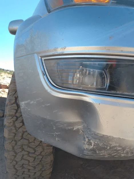

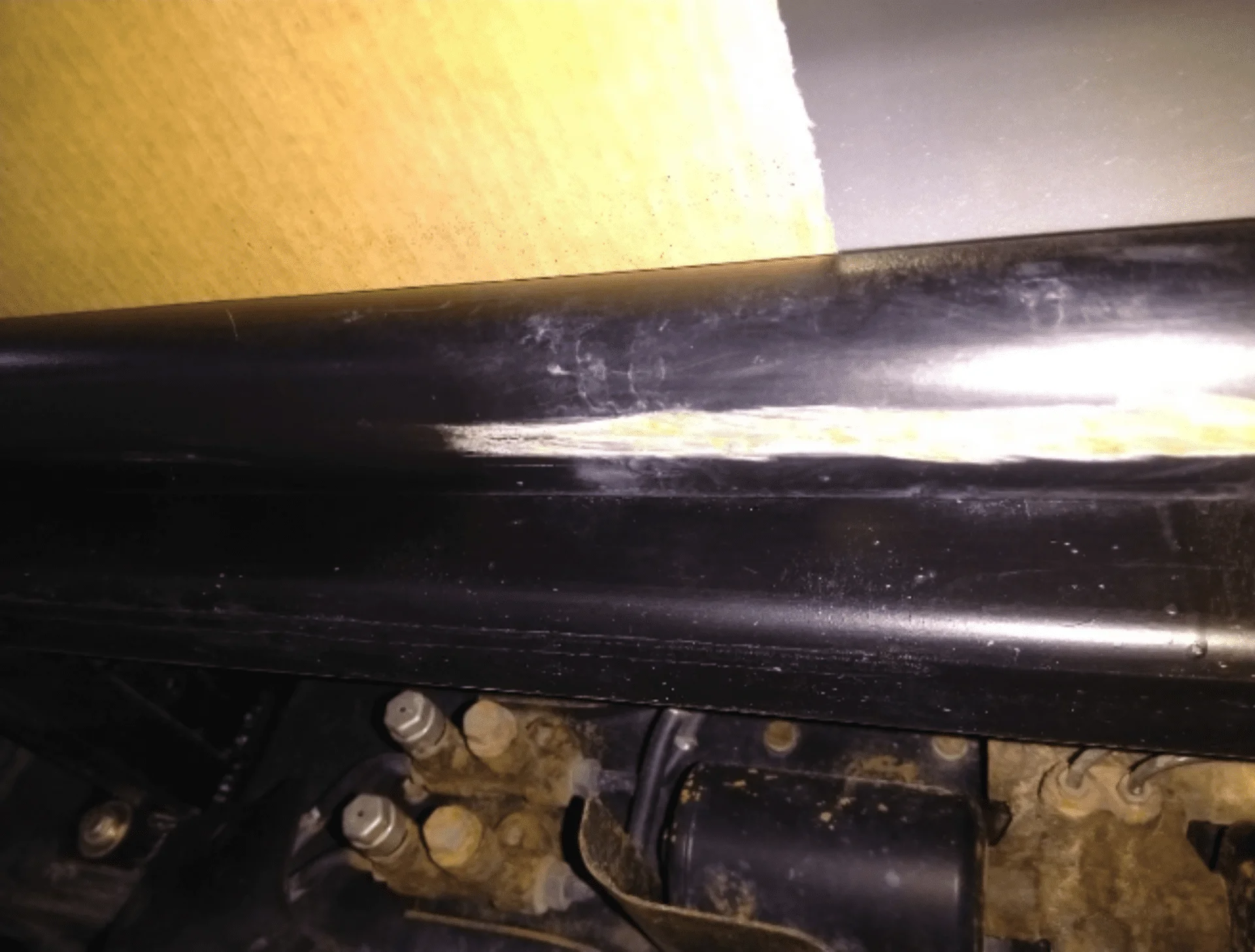

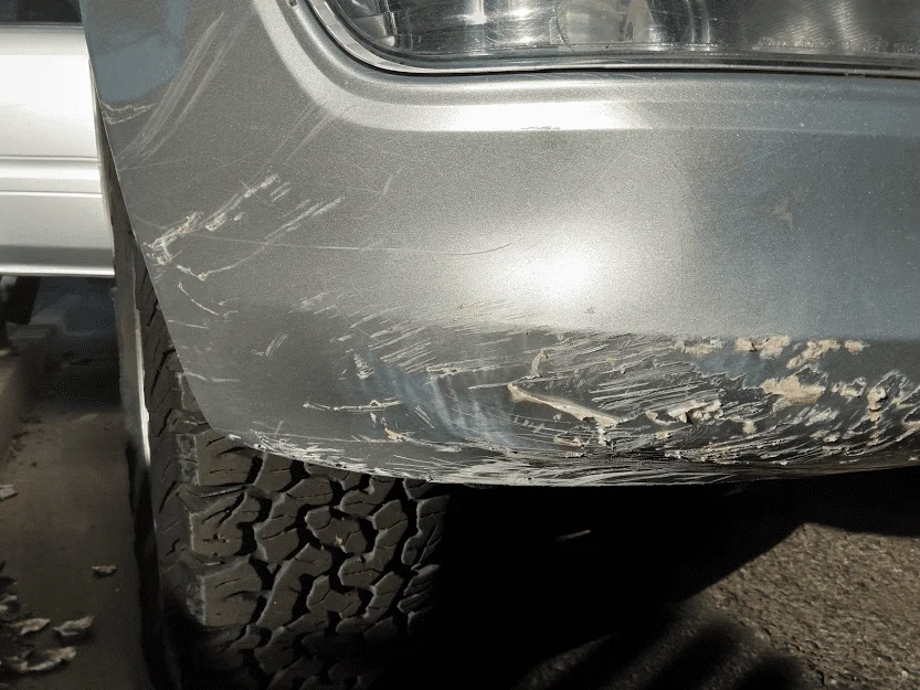

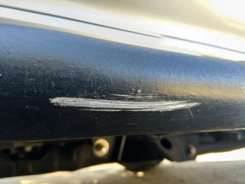

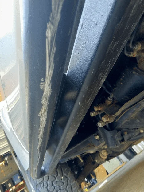

slider scrapes and dings:
Camry dent:
Which i fixed today 😝

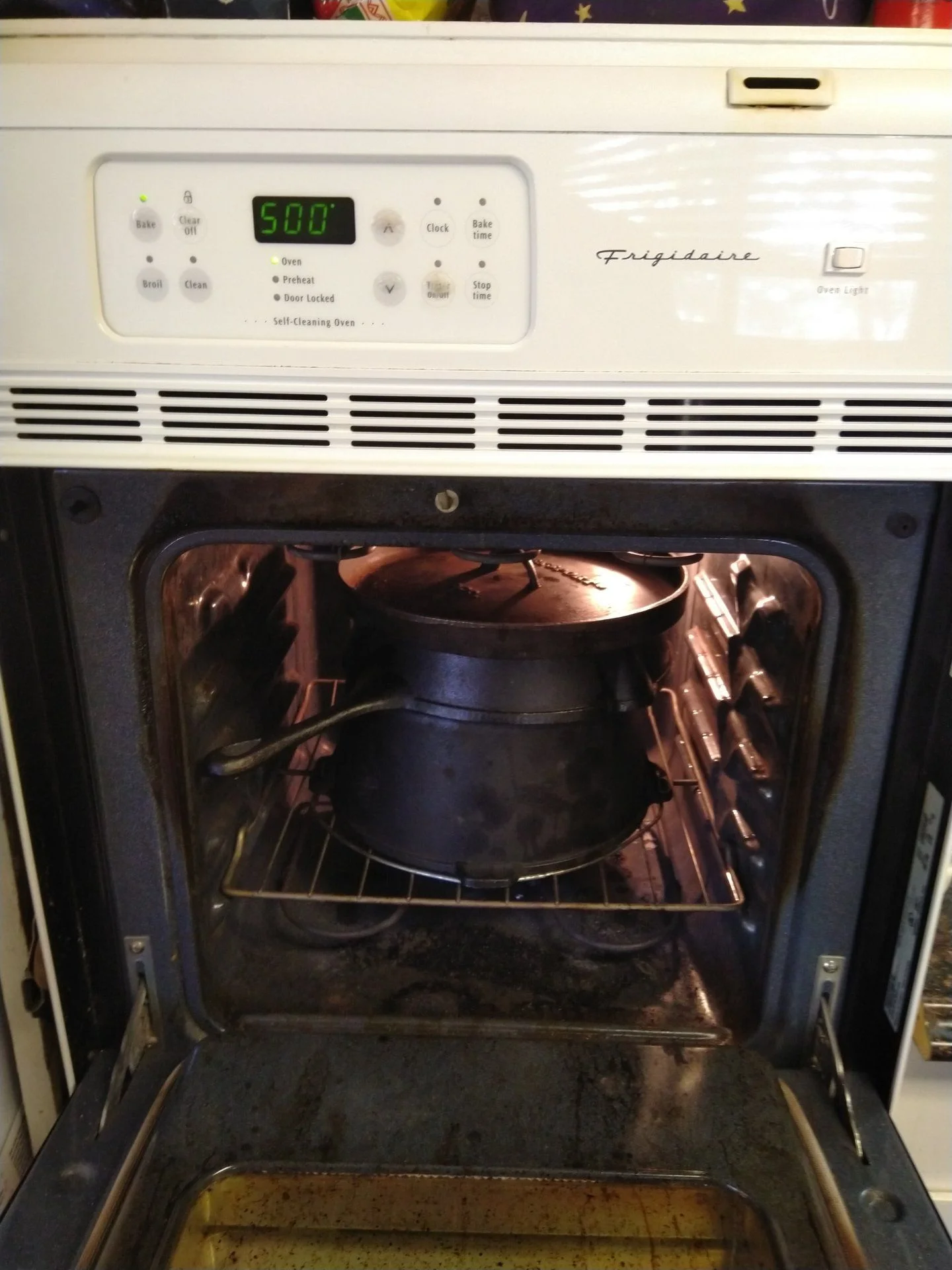

What's your process?
I clean mine with boiling water and a scrub brush. Then I dry it immediately and oil it with olive oil after each use.
I see your oven is at 500*. I've never done that.
You don't need boiling water and that will just remove /destroy the seasoning. Just wipe it out is all it needs between uses and maybe a light coat of oil. If stuff is stuck on brush it lightly with cold water and if properly seasoned that should be enough. Wipe dry and then some heat on the stove. Then just wipe it down lightly with with veg oil and heat on top of stove and let cool. You don't need to re-season between uses, once properly seasoned. I think olive oil has too low a smoking temp compared to others. Bacon grease also works well.

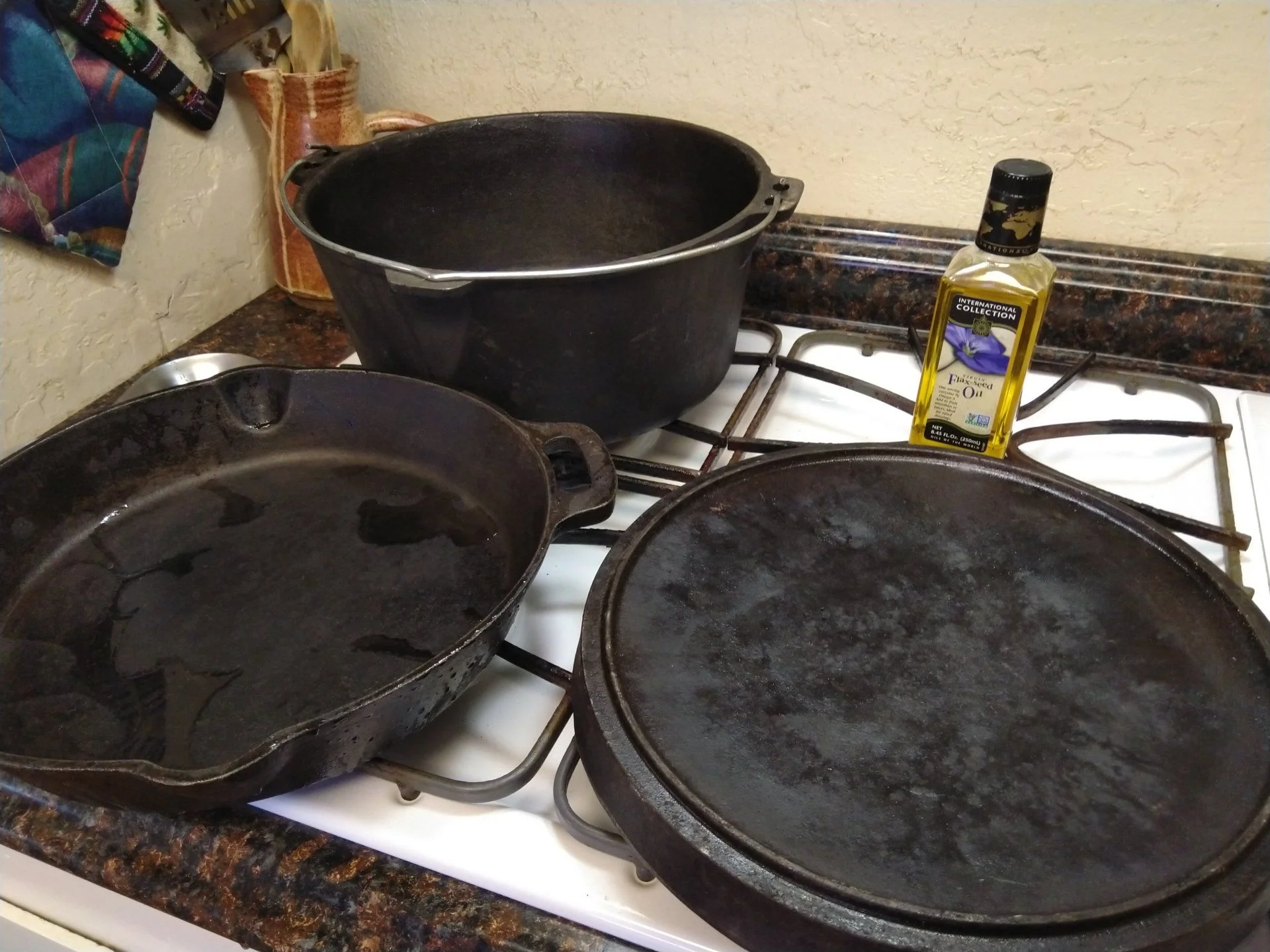

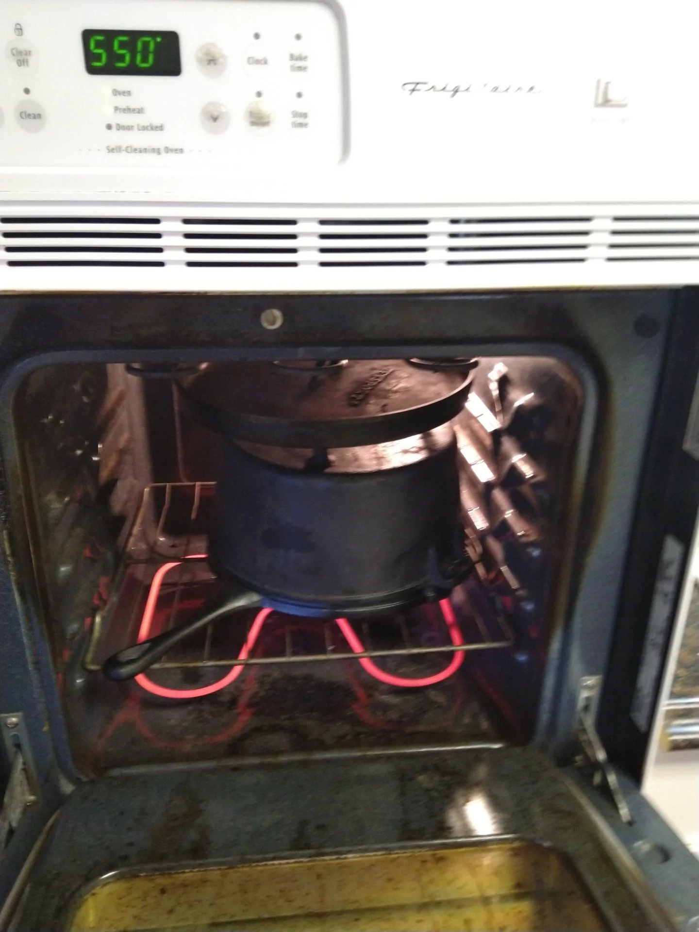

BTW, here's round 3 of flax oil and baking in the polymerization! 🤘
8qt Dutchie, lid, and 12" fry pan: each warmed over a burner, oiled with flaxseed oil and worked in as well as soaked up the sides of pan and Dutchie, then wiped down and put in cold oven, heated with oven to 550 and will bake for one hour, then let cool in over for at least 2 hours, but realistically they'll stay there for the rest of the day.

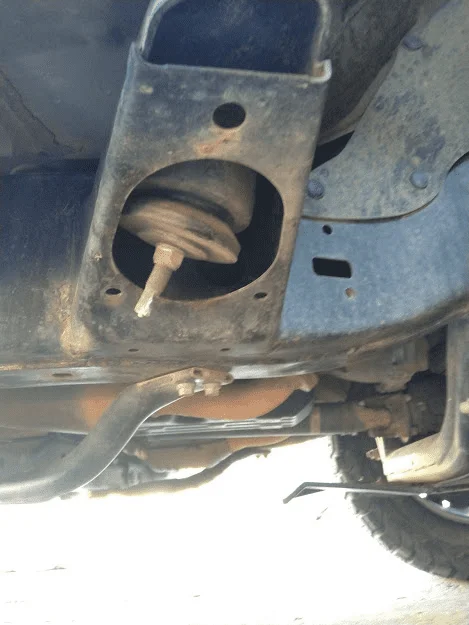

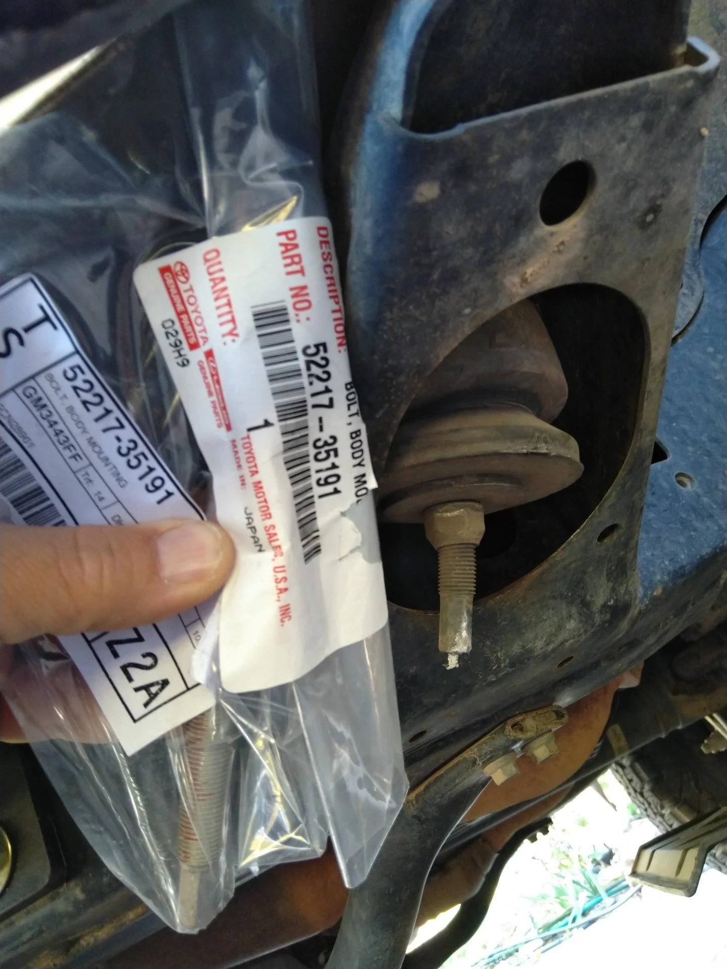

Just get a new body mount bolt
$16 🤙 BAM (now when. . . . 🤔)
It's in a really awkward spot to try to hammer it back easily.
I cut my bolts flush so they dont extend past the nut. If i have to take them off, I'll be replacing them with a grade 8 stud with allen recess. Similar to a wheel stud.
Another thought was to mark the length where the nut sits, remove the nut, cut the shank, then slot the shank end with a thin cut off wheel, taper, then reinstall the nut. You could install and remove the shank with a screw driver and the nut would sit flush with the mount.
The factory design is just begging for the treatment you gave it! They're like little anchors.

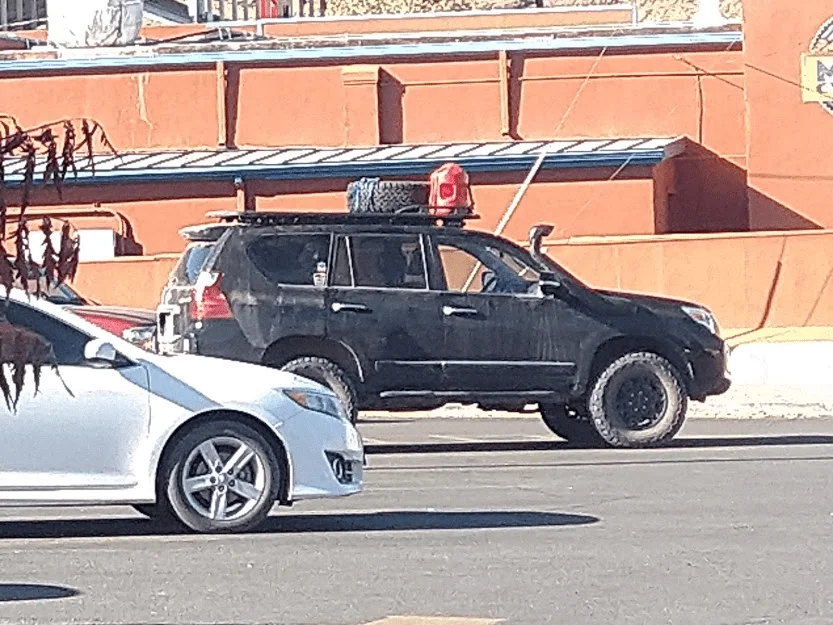

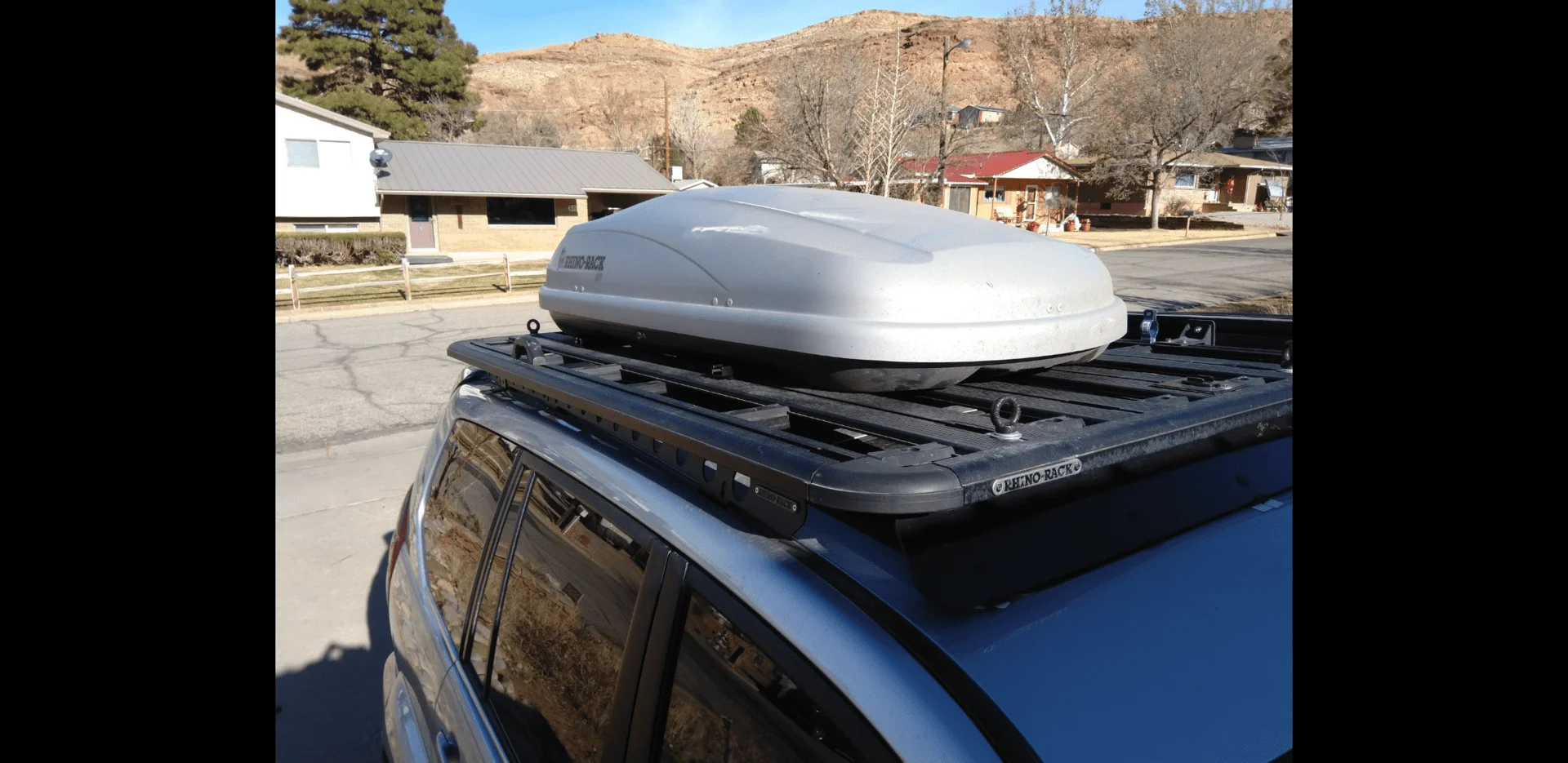

Rhino-rack pioneer platform length comparison.
this is a 76" pioneer platform (with optional front and side rail kit) on the Rhino-rack backbone (on a 460 I saw in town yesterday)

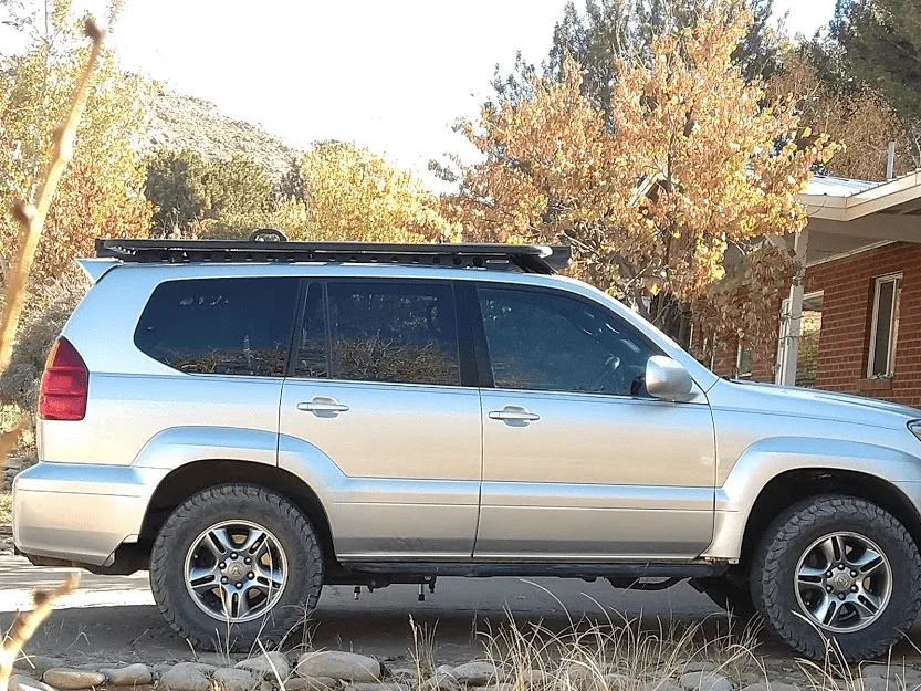

and here's the 86" pioneer platform (with a wind fairing) on the Rhino-rack backbone on a 470

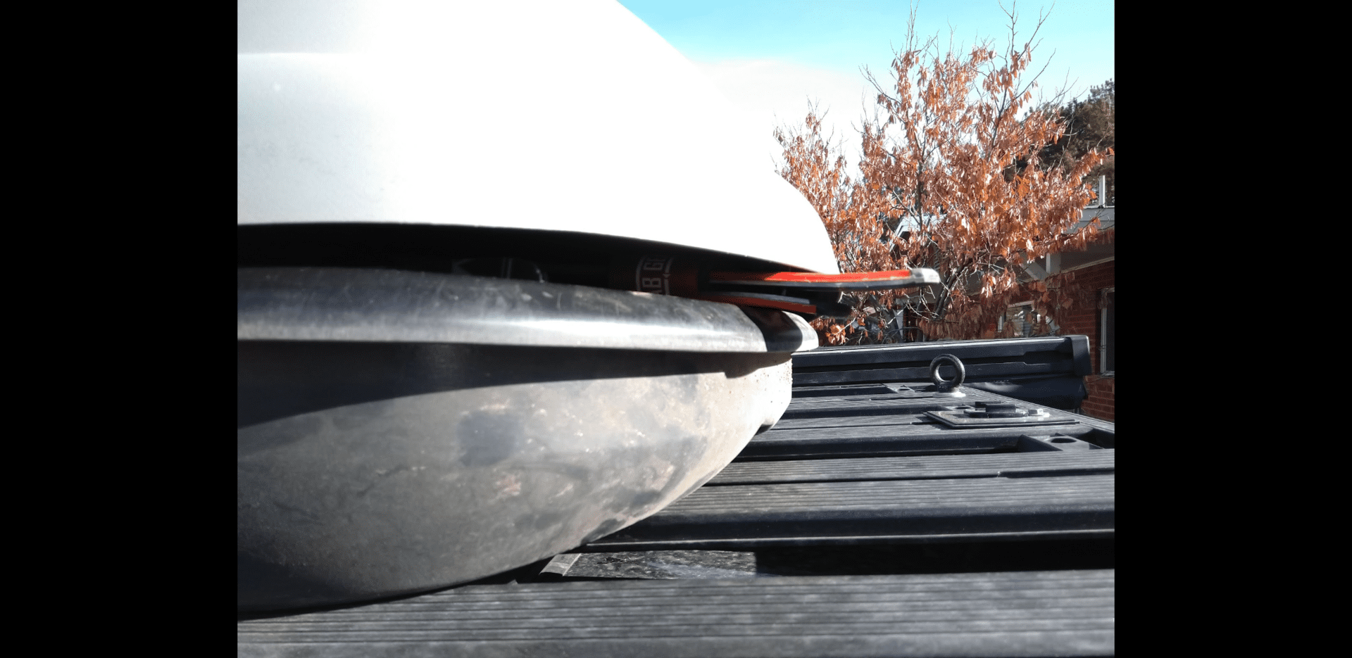

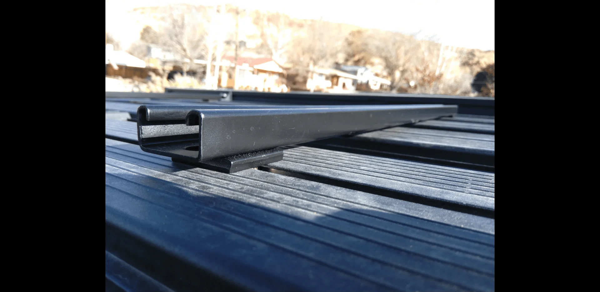

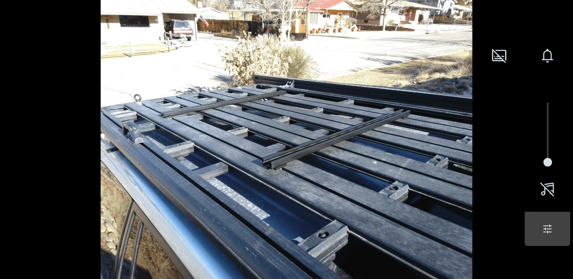

Fabbed crossbars for the Rhino-rack platform to mount the Rhino-rack roof box using 11/16" unistrut and it's hardware (1/4" washer plates and 3/8" camming nuts and bolts.
