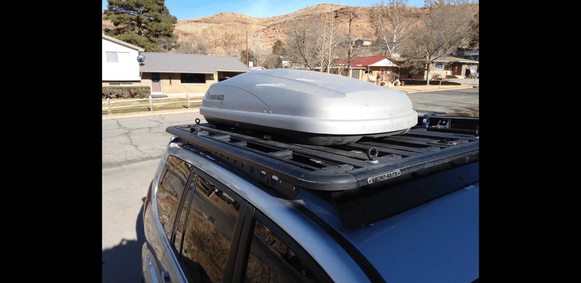

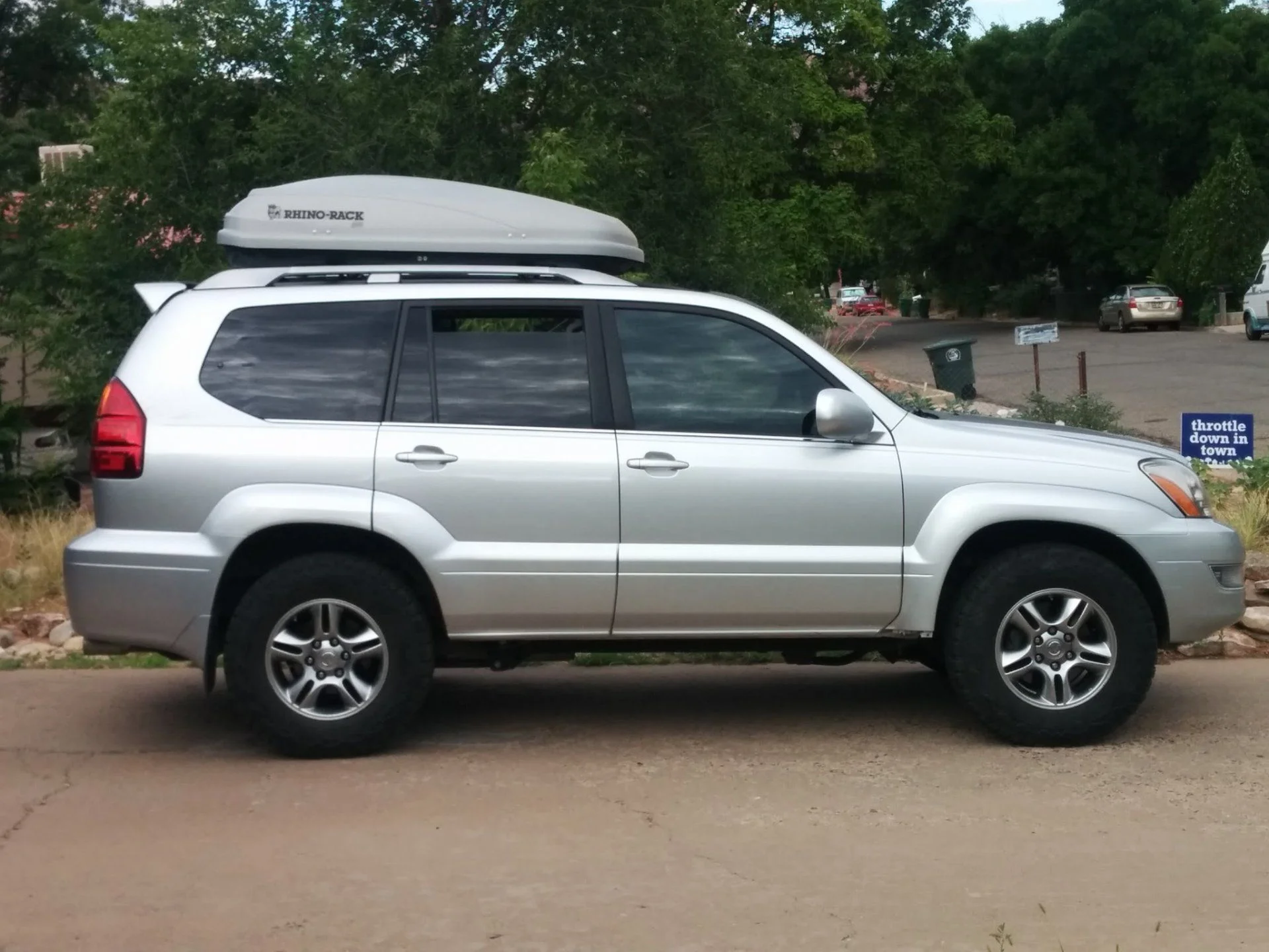

We had a roof box too.
here was our configuration.

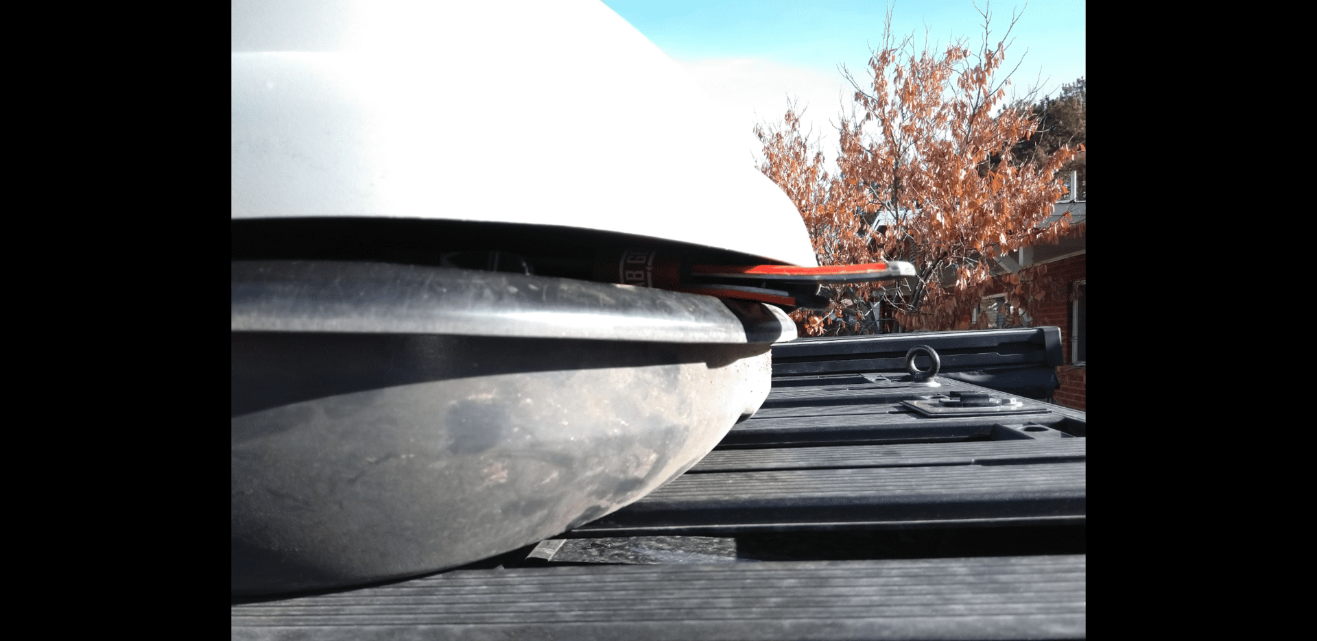

Quick question from a new 120 owner, how did you get your roof box so low in the rails? All the roof bars I'm seeing end up being higher than the rails and then the box even higher. I love how low profile you have yours.
@S4fetyTh1rd
That's the Rhino-rack masterfit roof box's design. I love it too! 👍
It has universal clamps that work on any crossbar. Mine is the 400liter and is 8 years old. In those pics it's just on the stock crossbars.

You can see how it recesses for the crossbars to fit low profile.
Thanks very much, I'll look out for one.
@S4fetyTh1rd
I think the low fit is mostly the low crossbars, most aftermarket crossbars ride atop The siderails not within then.

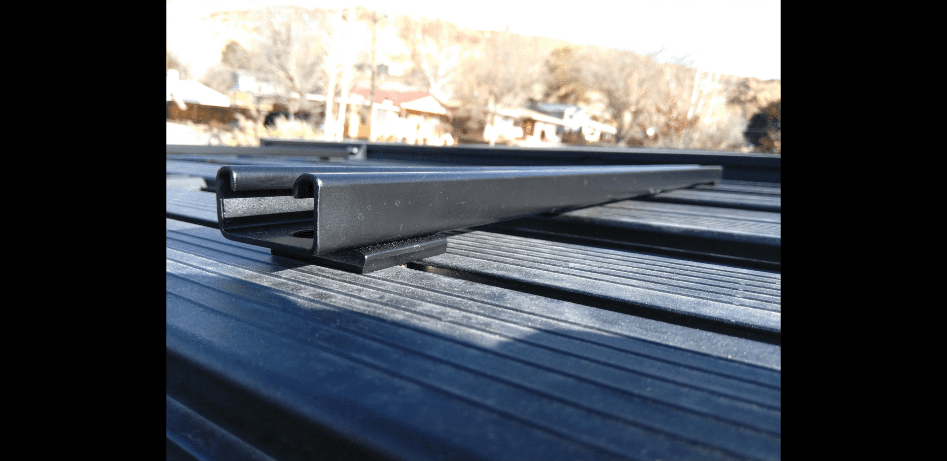

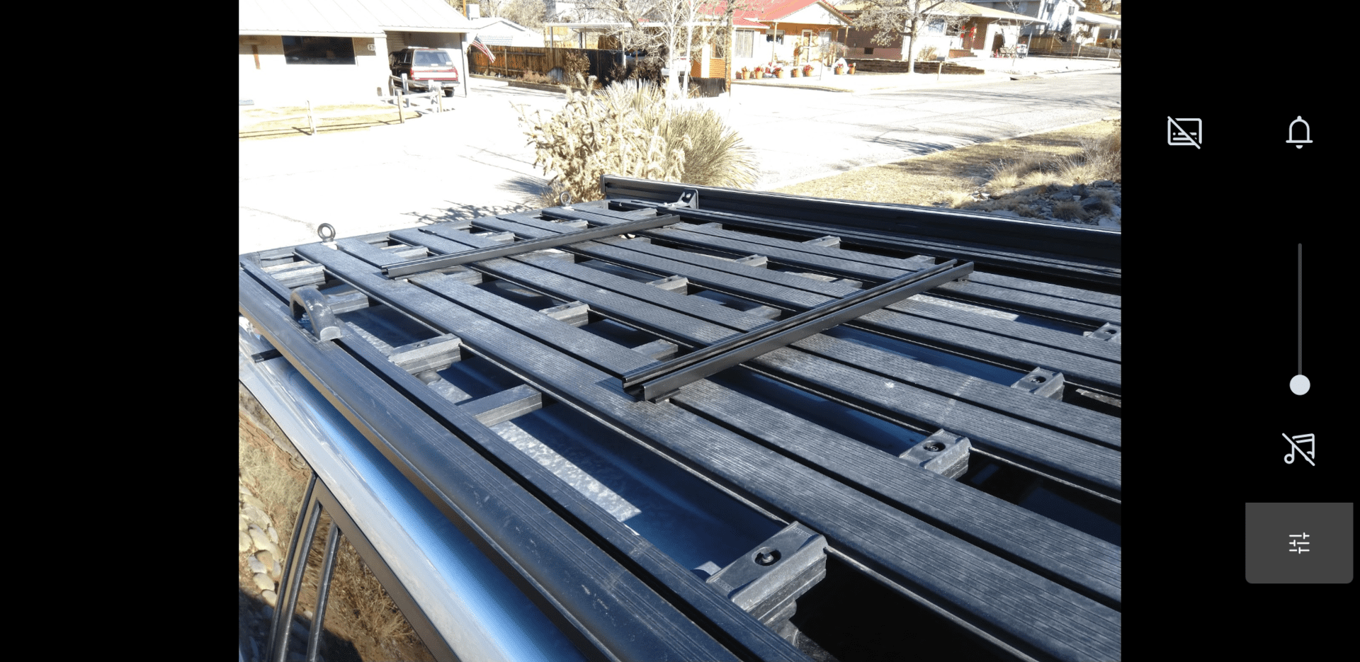

Very cool, I need to do this as I am currently looking for a cargo box also. Where did you source the unistrut and hardware?
Any Hardware store.. i have ace and true value,but Lowe's, home depot too have the stuff....

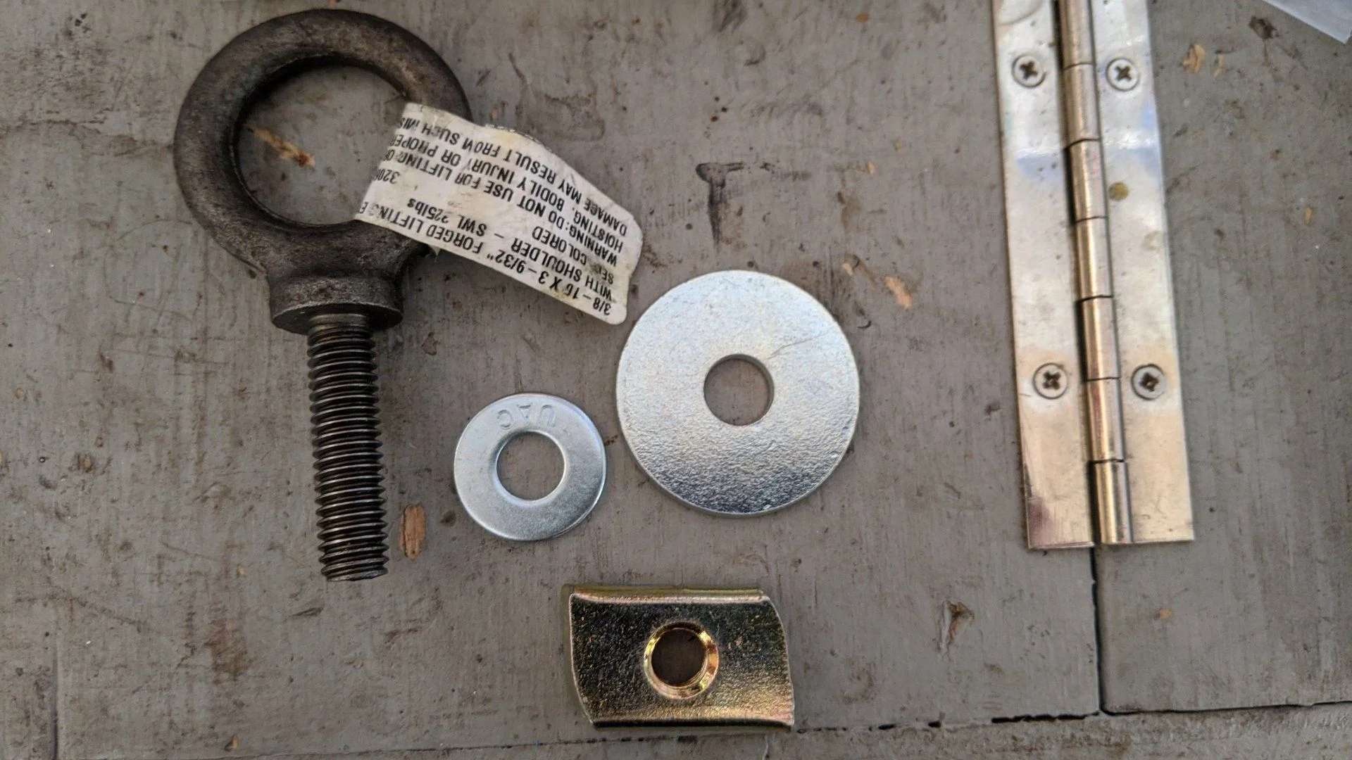

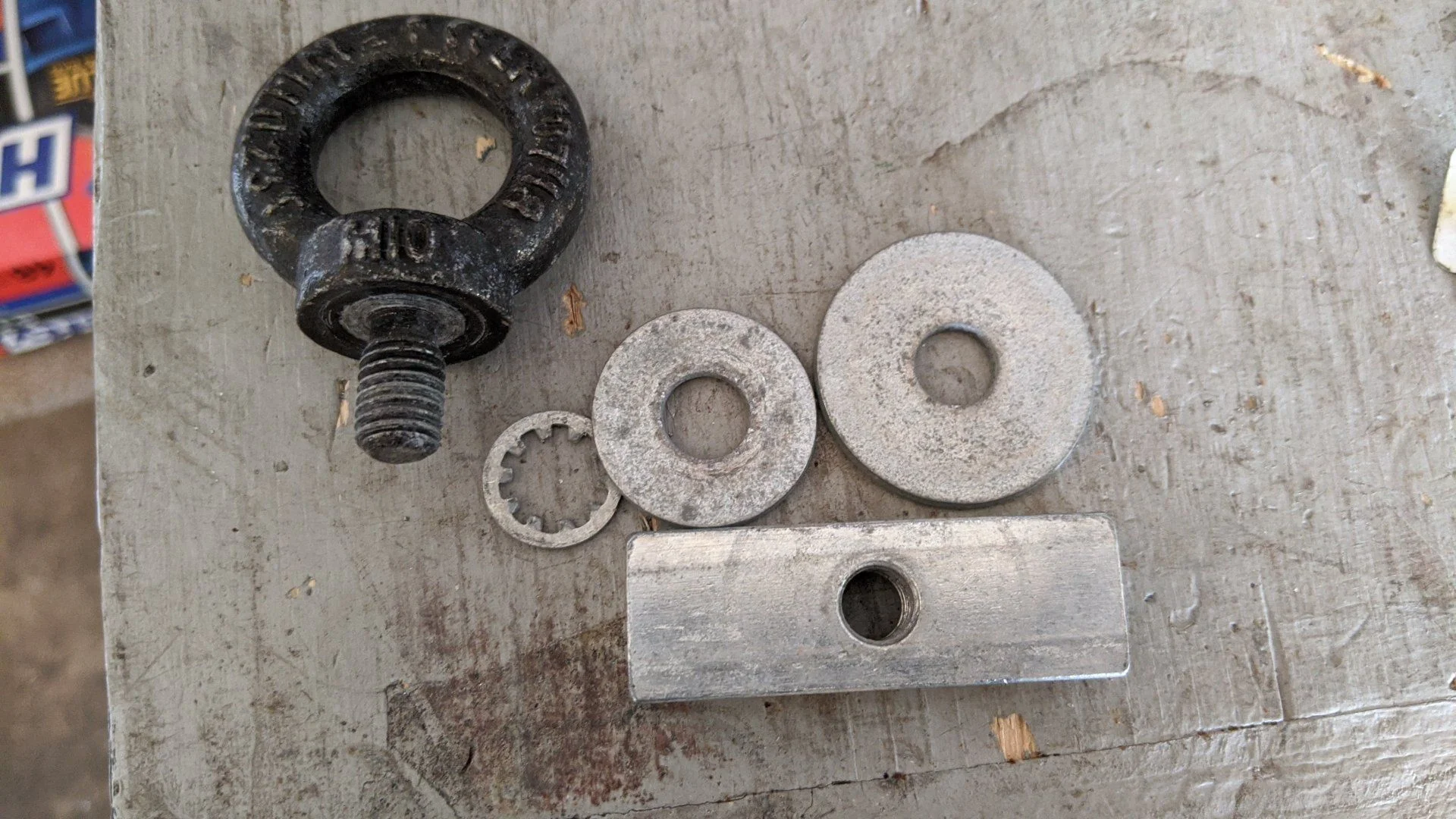

You'll like this too....i bought the RR forged eyebolt anchor kit for the pioneer platform, so I'd have 4, and a template to re-create from. Turns out, the slots are perfect for unistrut cam nuts (as you've seen for the crossbar i made). So i recreated a forged eye bolt kit with 3/8" forged eyes ($5 or so?), And unistrut nuts (5 pack for $6ish,) and fender washers... 🤘👍
Rhino kit
DIY bits
The 14 ga is the lower profile channel (what i used) is 13/16", vs 1 5/5" for standard/common unistrut (or superstrut, same-same)
Big box sells in 10' sticks, 4', and even 2' i think.
They have galvinized stuff too, which would weather way better. . . .
Rhino kitView attachment 2300105
DIY bitsView attachment 2300103
Awesome stuff! 🤘🏼Very good idea. When I lived in Aurora, I stopped by the Rhino Rack warehouse and bought two of their eyebolts and use those quite often, very good idea on creating your own. I’m going to take a look at building what you did to take a roof box, I am currently shopping for one now. What you you think of the rail kits for the platform? There’s a couple of 4runners in town running the rails all the way around and it looks good. I’ve often thought about getting the front and half side rails
When I was contemplating the pioneer platform, I was very interested in the elevated platform, the tradie platform with the rails on the sides. But after many a measurement, I think it was too tall to fit in my garage. I do like the rail kits for the front and sides, they're not as tall as the elevated's side rails, plus it makes for easy tie-downs versus eye bolts or hooking under the crossbars. Speaking of unistrut hardware, I used the regular unistrut cam nut and 3/8 bolts to fit the two cross bars that hold the tray together to the side rails. If you look underneath the way it's put together only the three cross rails that mount to your towers actually bolt the unistrut to the side rails of the platform. Added a couple more and tied the other two crossbars into the platform itself so all 5 c-channel bars fir to the platform perimeter. The 11/16 unistrut, being standard measurement, is a little bit shallow whereas the channel holding the platform together is metric, but channel width is standard and why unistrut nuts work. 👍 but their metric ones are a scosh deeper

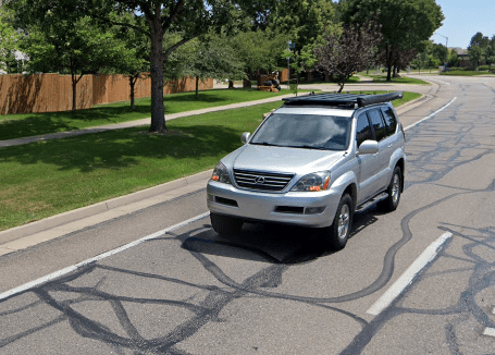

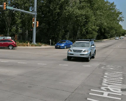

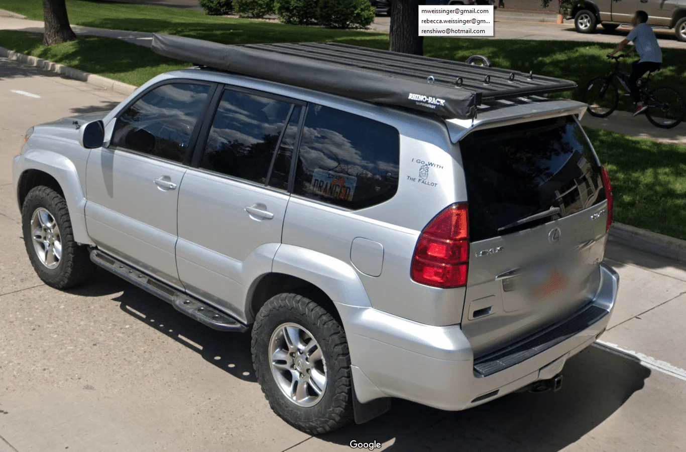

callback from last summer's vacation in Fort Collins when I spotted a Google street view car.
HA! this angle. 🙃
roof rack like 2 mo old and sliders (finally prepped and installed) on 3 weeks at this point.

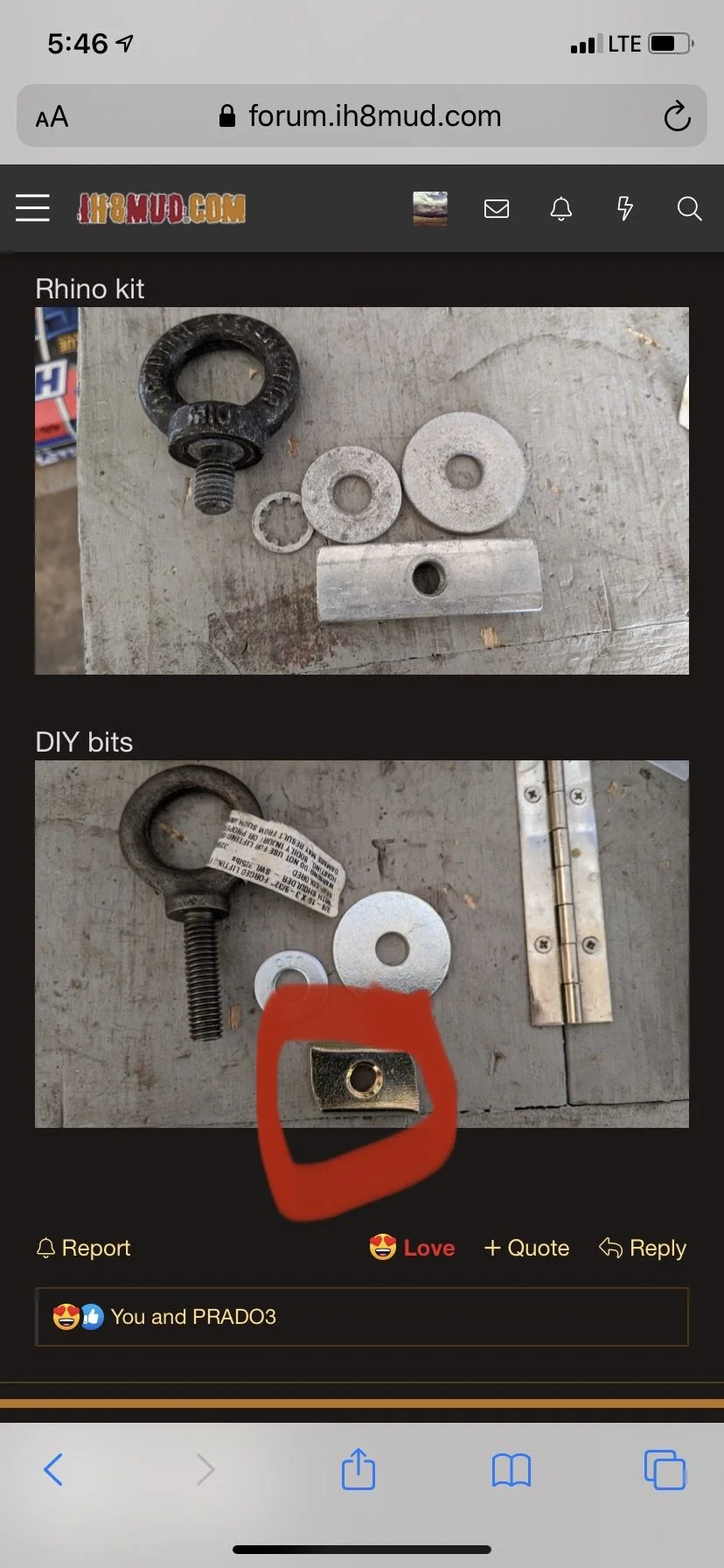

Tell me more about this piece
