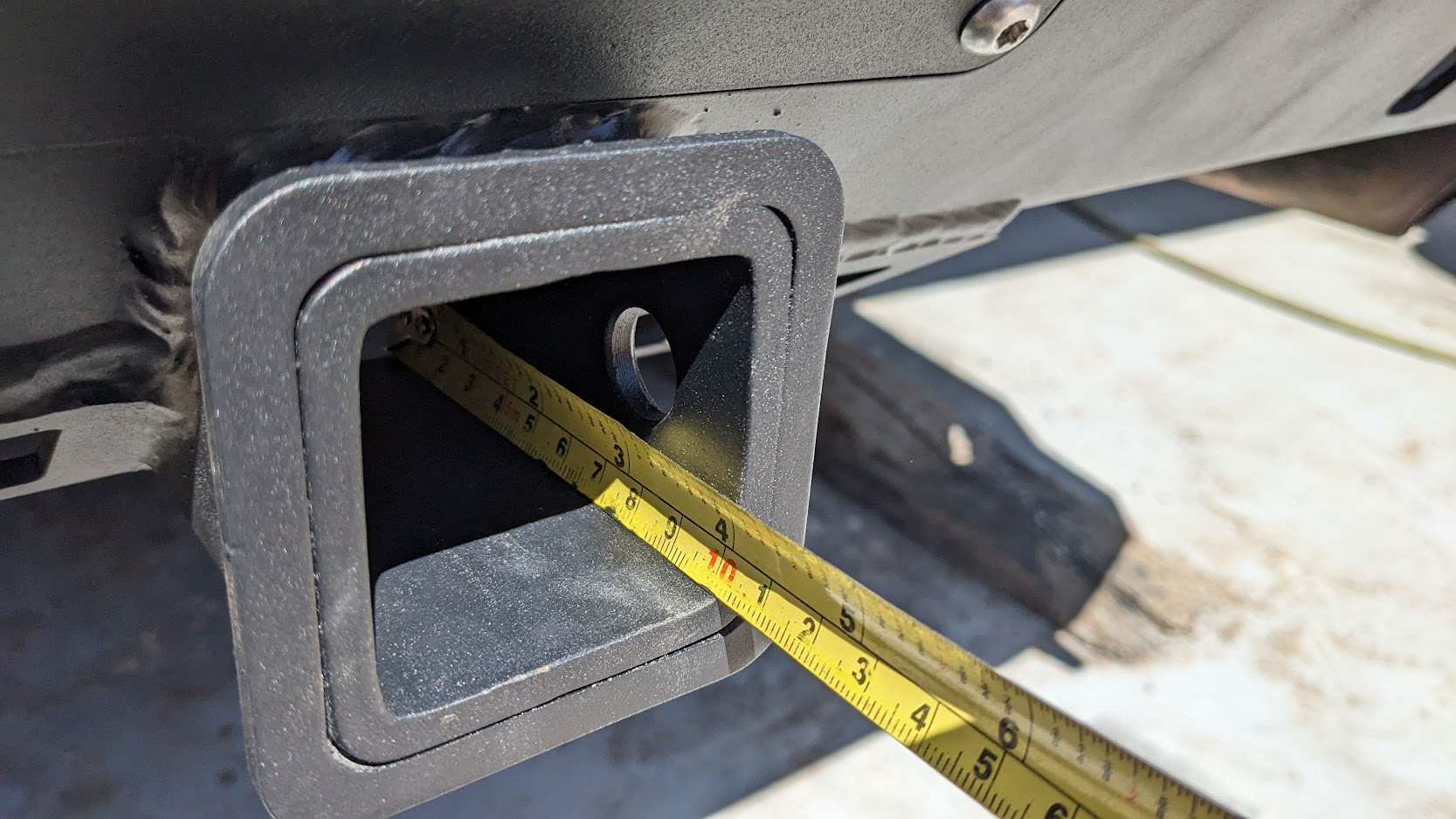

How deep is the victory receiver, from center of pin hole to back of insert? I think stock was right @ 4". The bike hitch I'm going to get needs minimum 3 3/8" . . .

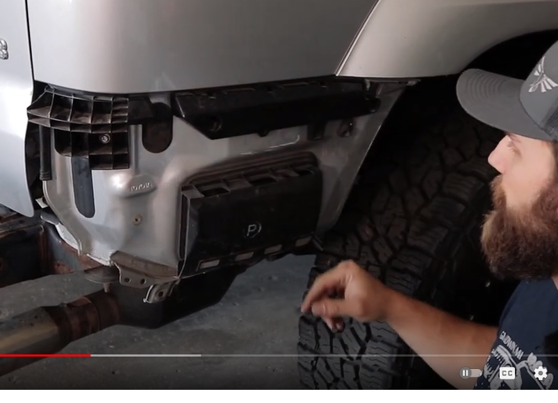

Also... Did you need to remove the vent dust covers (like metal tech install video suggests... The Victory install video didn't mention that in detail...

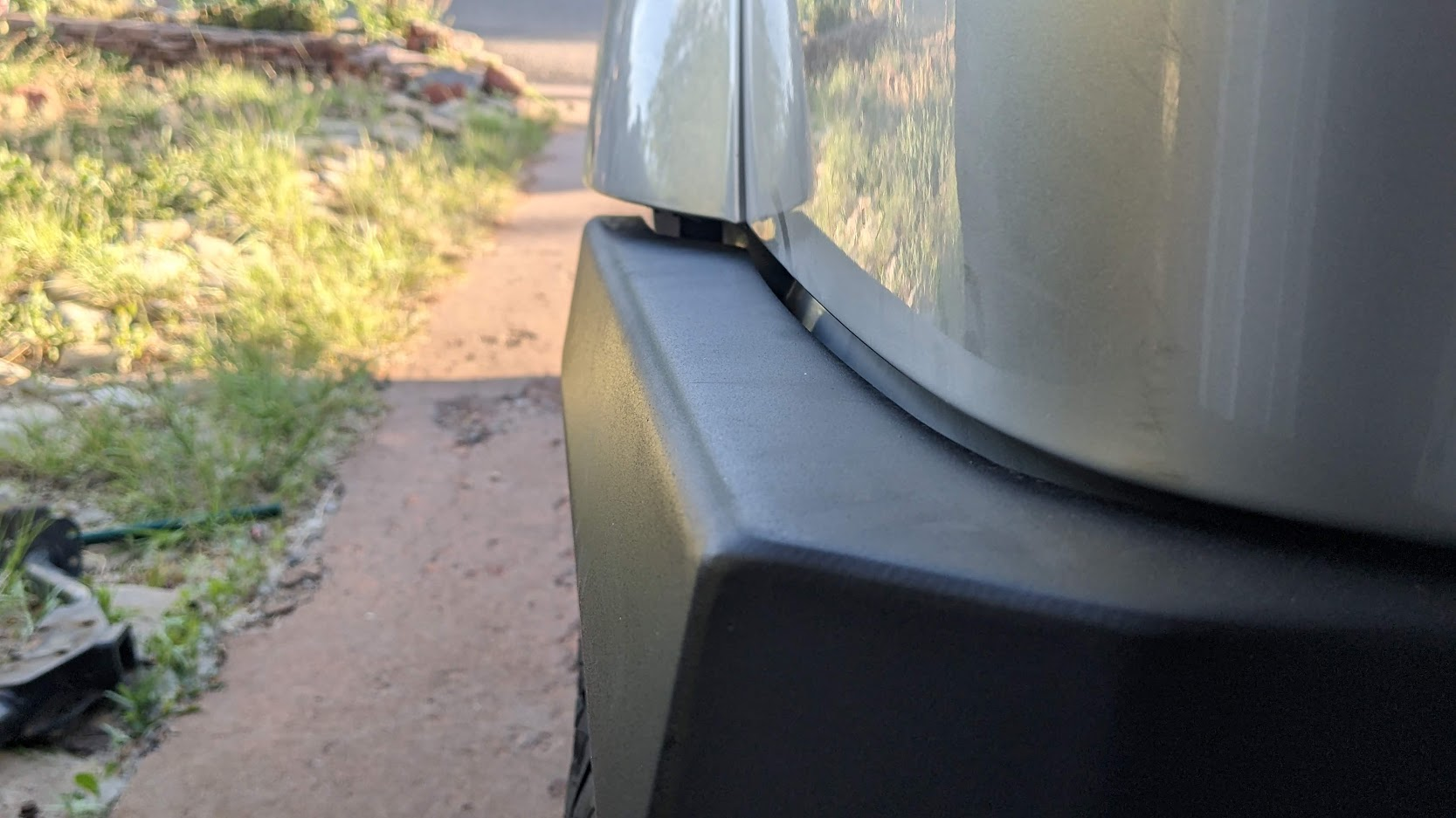

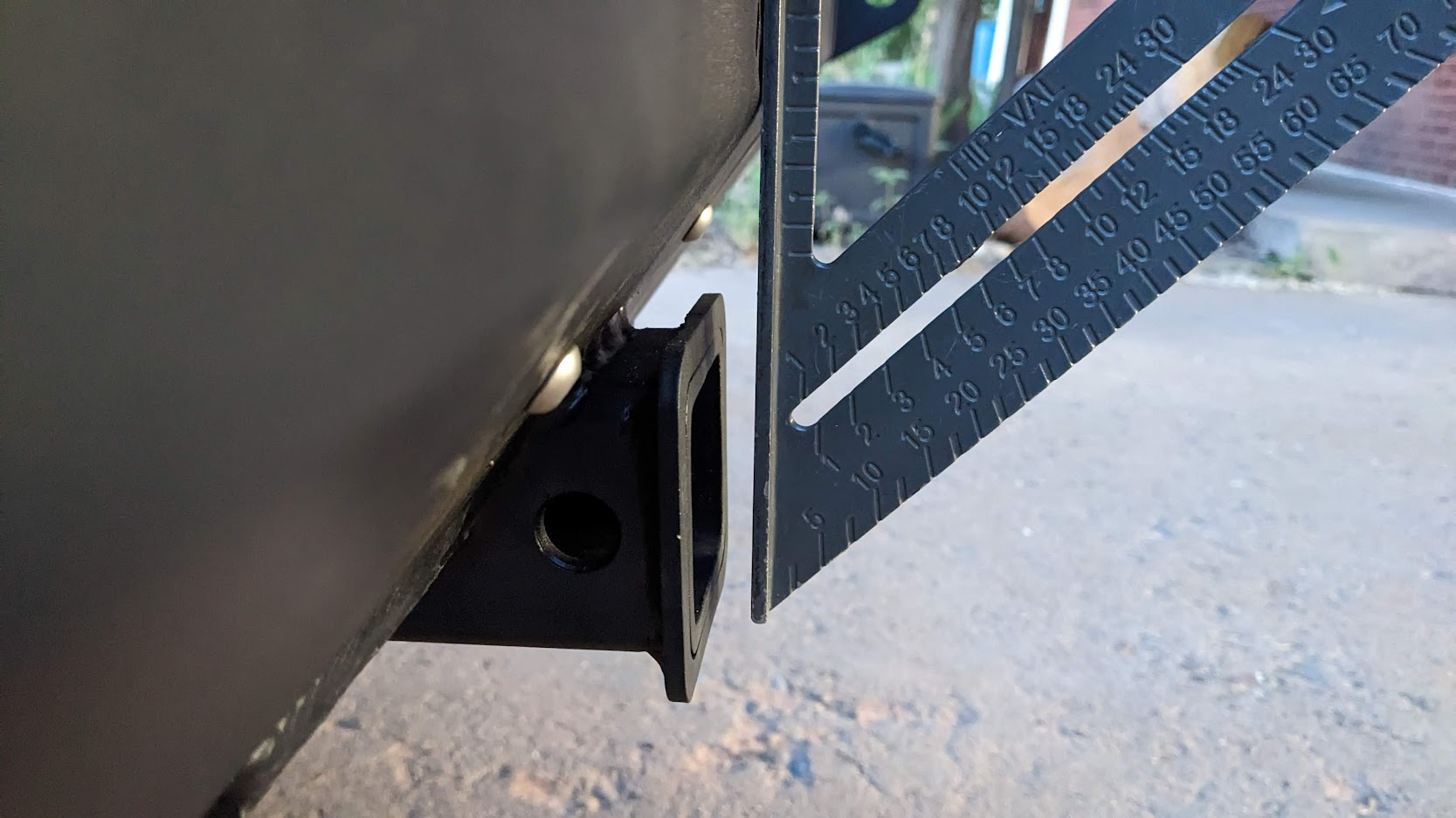

update:

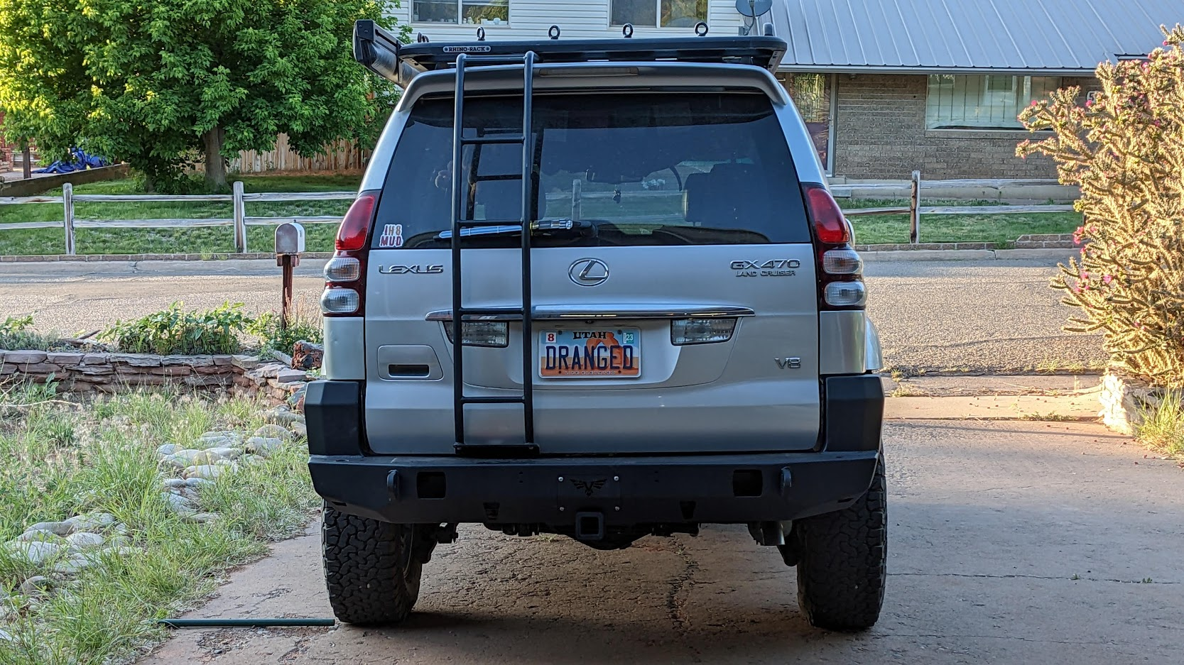

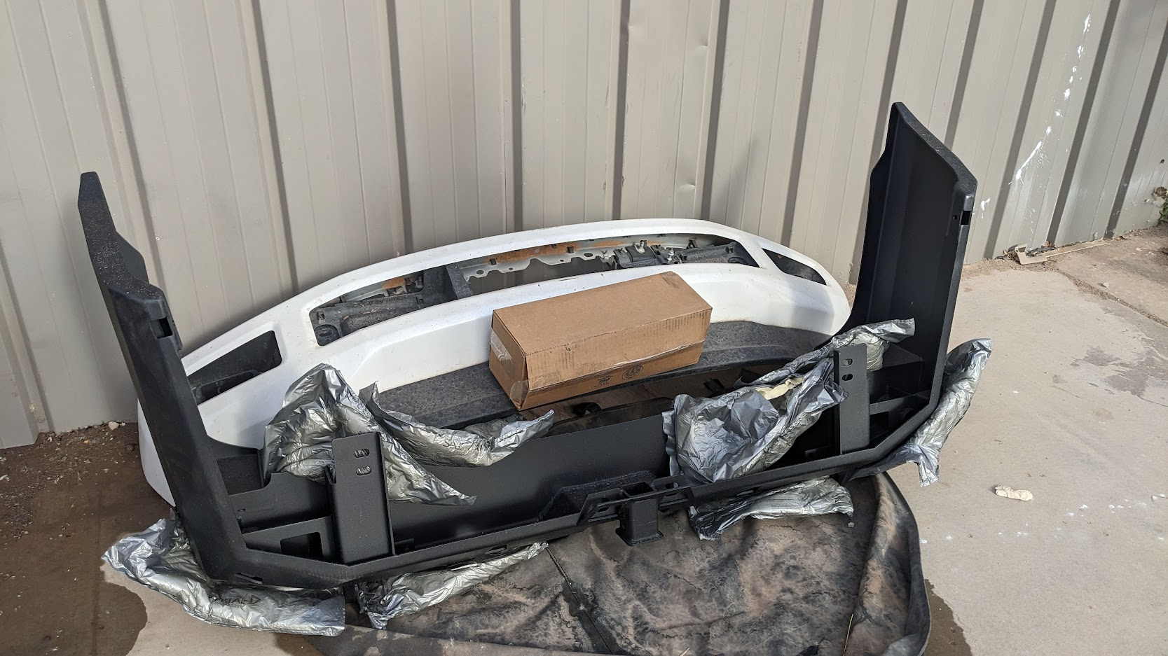

Victory bumper installed by local body shop...that installs LOTS of aftermarket bumpers on LOTS of rigs. He said this one was particularly unique and challenging, most others just bolt right up.
I don't know if there were instructions or tips and tricks included, as the item came delivered wrapped but not on a palate (all mounting hardware and spacers were present). Don't know if it was on a pallet and the freight co. removed it for space-saving in the truck or if it was never on a board.
I think the Finish is great, welds look good (Jimmy said they look better than some he sees), and it's overall a good design.

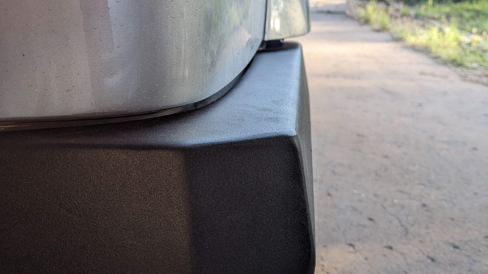

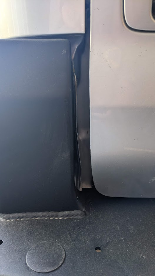

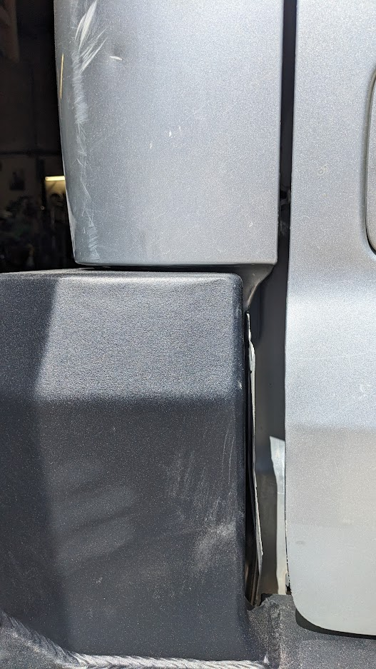

Fit is a little less than ideal.
Caveat: I'm not an engineer or manufacturing designer or steelworker, but an end-user and auto-enthusiast consumer with an eye for detail and posit that form should follow function.
I understand these are probably build from a jig spec'd from a small selection if not just one or two GXs, and that assembly line manufacturing imparts some variability in product. I think this Victory Bumper is well thought out and could use a little refinement to afford a tighter fit in a couple dimensions and think it would benefit from more attachment points and maybe a couple select gussets for further structure w/o compromising additional weight.

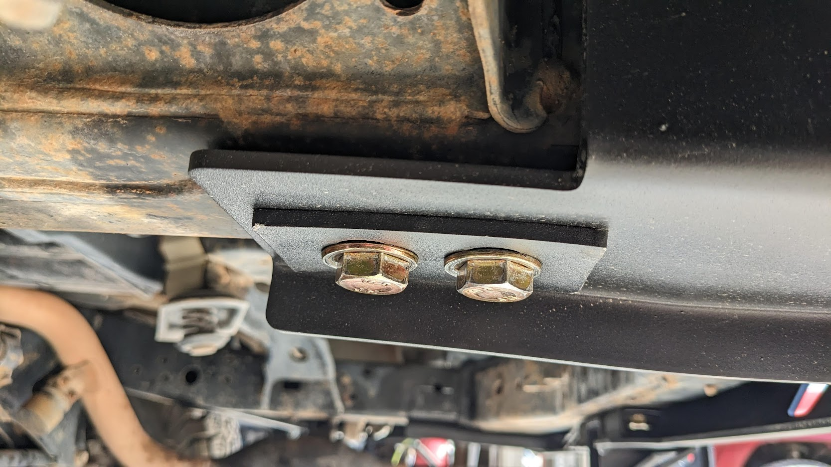

Jimmy fought it on install. At first, with the spacer plate against the frame it had like an inch or more gap in front and like a half in towards the rear of the quarter panel, then they put the bumper tot he frame and spacers below to shorten that then it sat questionably close to allow body flex when off road.
He messed with it more and got a 1/4" thick washer between the bottom mounting holed and the frame, to get a little more even line and more space at the rear,
but it's a bit off horizontally matching the body lines, but probably not to other people, my friends assure me... ATD is my curse (attention to detail), or is it OCD? 🤭
Installer said it's maxed down in the mounting holes (ovals to allow left-right fitment), and to me it's just a scosh off to the driver.

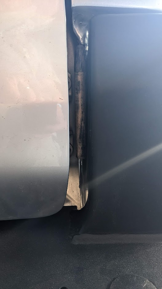

And speaking to the fit part, the opening for the door could be brought in 1/4" to 1/2" inch on each side. This may better cover the body pinch seams and just make it a little tighter to the door lines.
So...I may try to see if I can mess with fitment some (or maybe not ;)... Try slipping the spacer plates between the bumper and the frame to nudge it down a little in the rear, but then the 4 mounting holes may not align with the threaded hole in the frame. There are braces which bolt to the frame rail and support the forward sides by the wheel wells, but I think those will limit left-right movement, they determine placement of the forward sides of the bumper and would be the pivot point for any potential downward adjustment in the rear. I think that's limited by the rear mounting holes in the frame, but the bumper's holes could be wobbled I suppose, but then that would effect the underside mounting firmness to the frame...

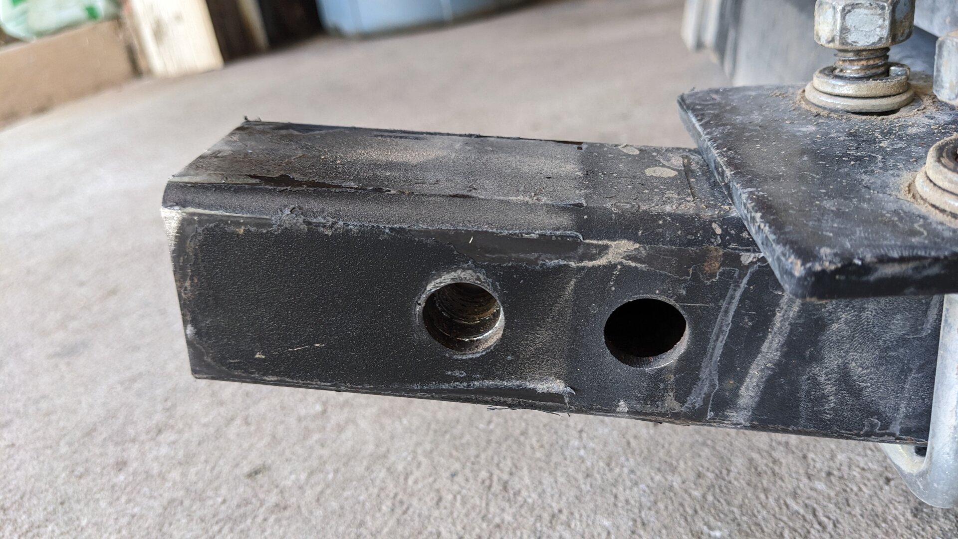

The hitch design looks strong (I wouldn't say to the same rating as a factory frame-mounted hitch, and arguably not even a factory frame rail-mounted pintle hitch) but it's awfully shallow! It's too shallow for my bike rack (requires 3 3/8" depth from center of pin hole), but with the barn door I kind of need a swing-out anyway.
I also question the style over function design of the hitch reinforcement. it's a vertical plate rather than a flat plate of steel wrapping the edge of the receiver opening. With flat plate, it would slide better on departure angle, I fear with this vertical design, it'll catch and bend. Plus this vertical design effects the use of standard anti-rattle devices...
I'm considering welding on another 3/4" to 1" of tube to the insert it deeper, and I don't think that would appreciably effect departure angle...plus I could wrap that lip with flat plate like standard hitches.

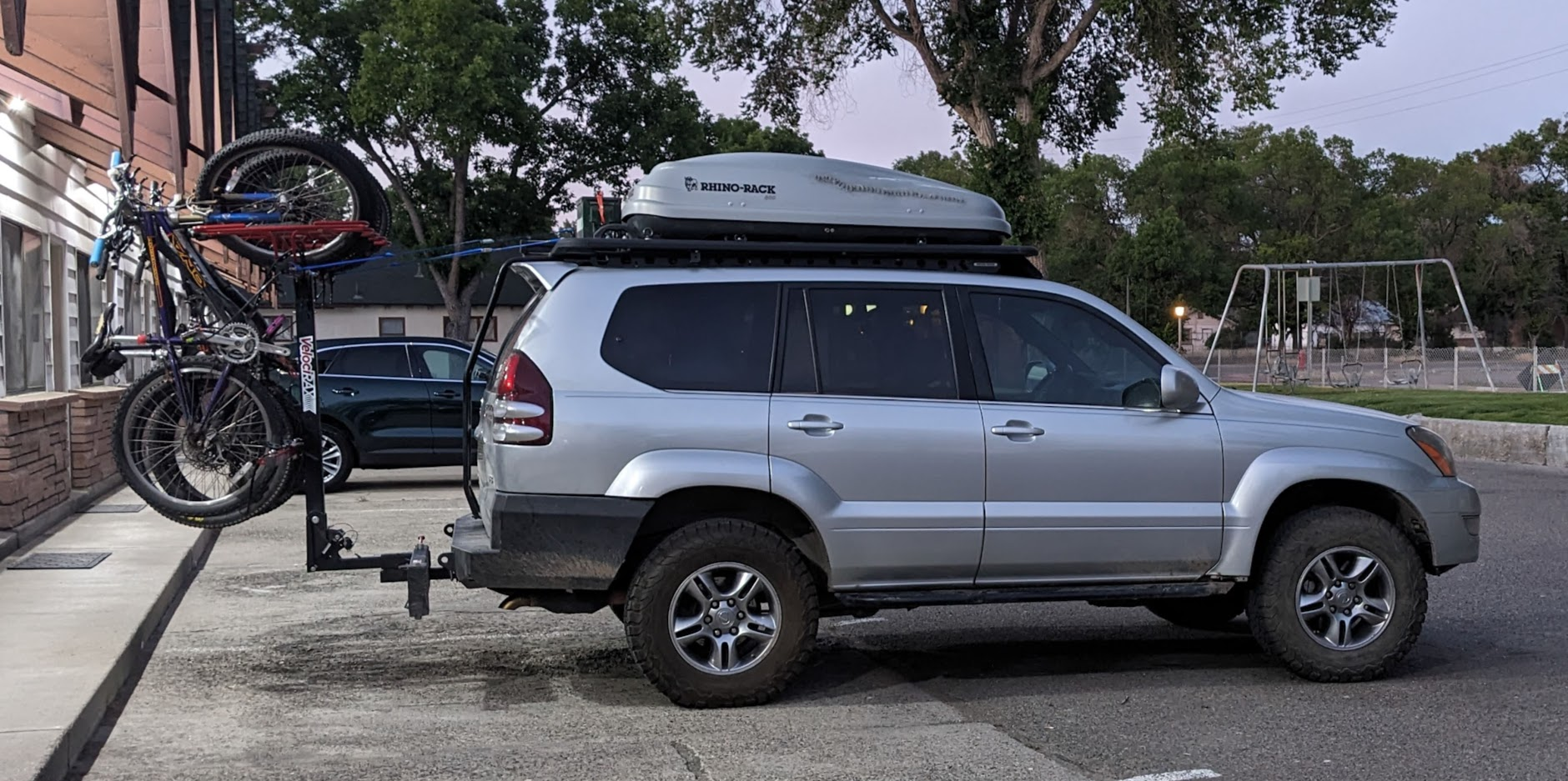

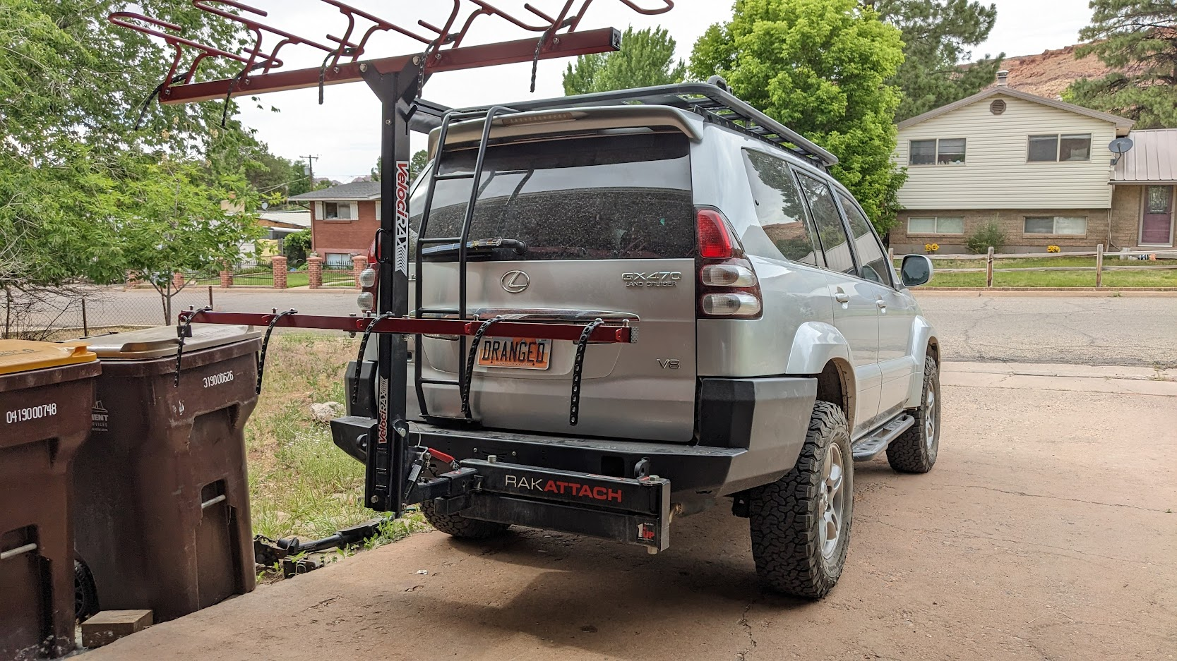

The shallow receiver supported a 250# worth of bike rack shenanigans (Rak Attach swing-out 55#, Velocirax rack 100#, and 4 bikes circa 100+#) well enough on a 2000+ mile road trip but there is slight up-down movement in the swing-out and there's some twisting movement because of the weight of the rack (plus bikes).

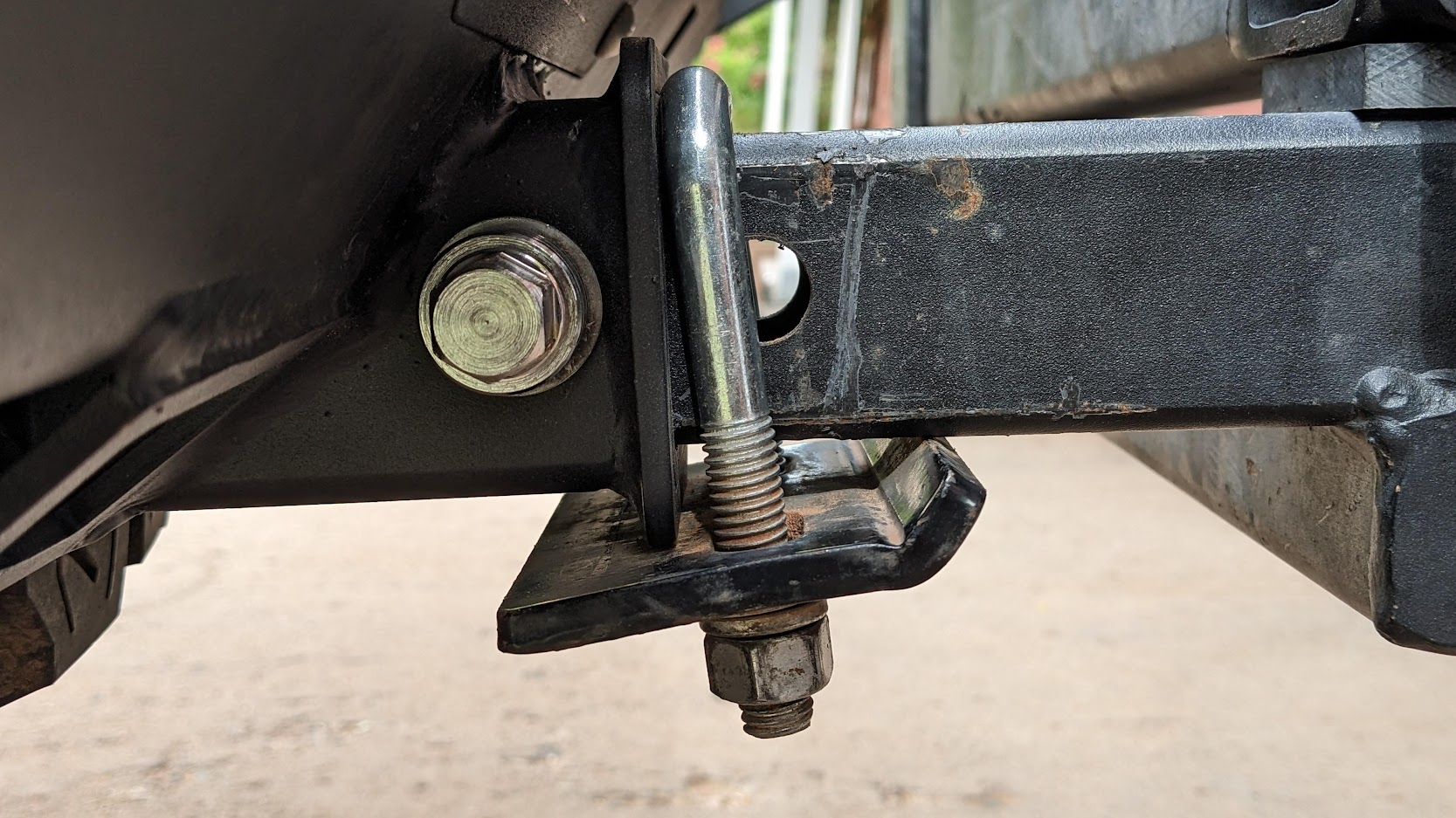

I modded the Rak Attach to have a threaded clamping pin, but the shallow receiver allows for some up-down slop in the insert even with my clamping receiver pin mod, so movement gets amplified by the swingout, bike rack's mass and weight of bikes on local trails.

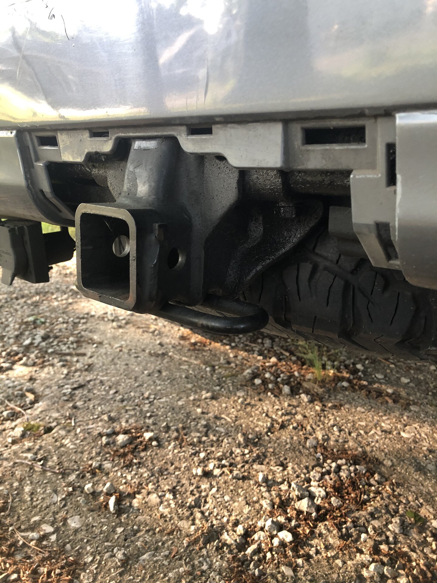

My dealer-installed receiver hitch is 5.5 deep and 4" from center of pin to stab depth.
View attachment 3379210View attachment 3379211

I measured my factory hitch today and it was 4.25” deep so pretty close to the Victory. I have a hitch rack that I have a similar issue with, but also have a spare tire under there so there is not much room for extra depth.

1up 1st gen Rak Attach modded with tightening receiver pin.
Victory receiver abrasion after 2 WK road Trip and 55# Rak Attach, 100# VelociraX 5x, and 100+#s of mt bikes.
