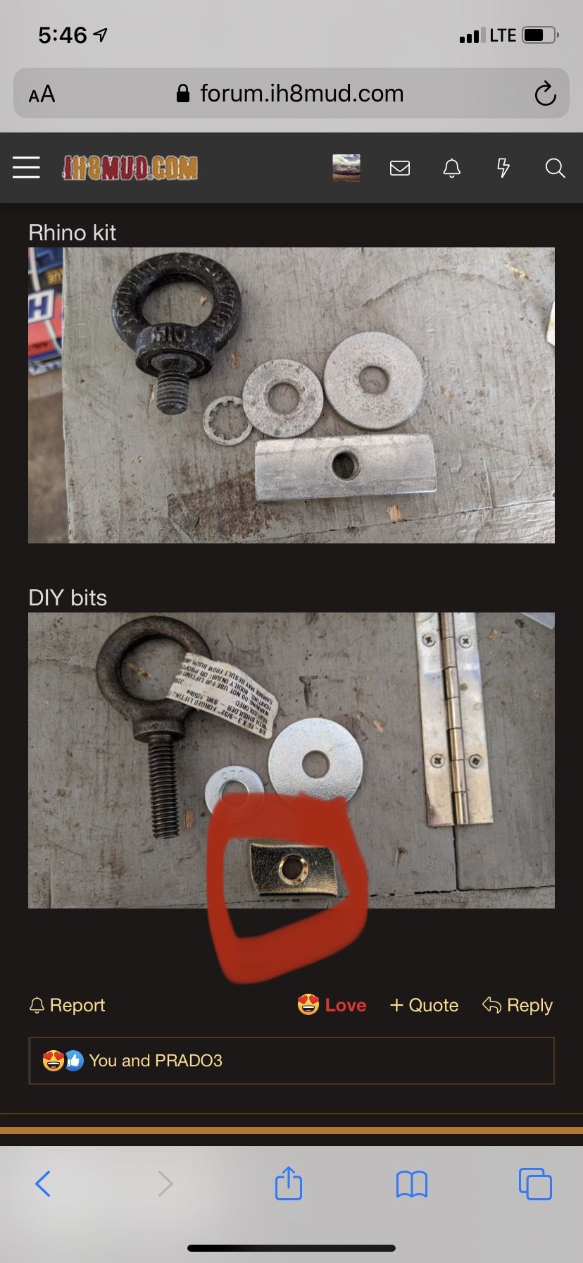

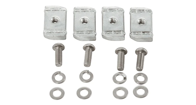

This is a 3/8" unistrut/superstrut conical nut. It's standard vs metric, but Rhino-Rack uses basically identical hardware in their products (albeit metric...M8x1.25), e.g. here's their Rotopax "fit kit" but the same oblong camming nut is used to construct the Pioneer platform, see 1:04 (among other things).

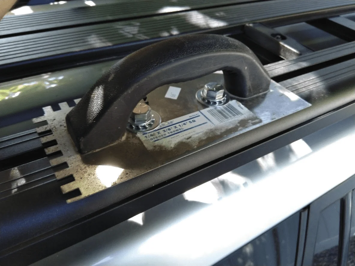

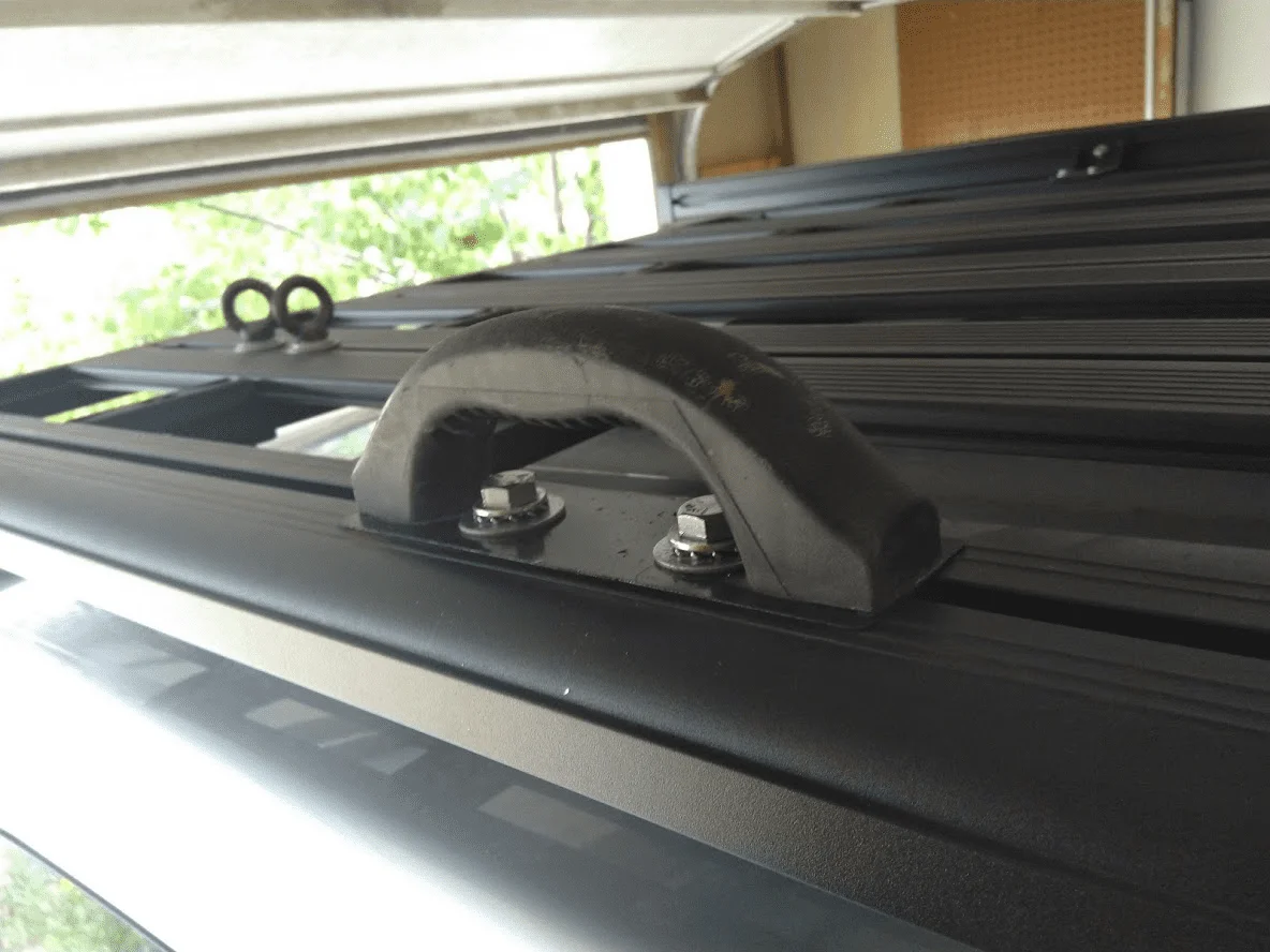

In late summer 2019, I recreated the Rhino-Rack "grab handle" on the cheap using a thrift store stucco trowel and some hardware store hardware (3/8" bolts, fender washers, lock washers, and unistrut/superstrut 3/8" conical nut.

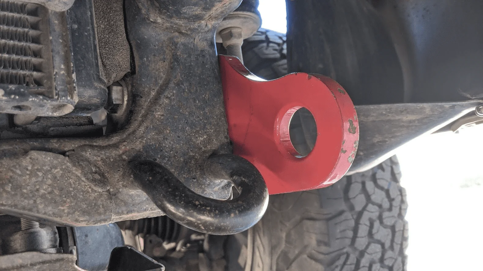

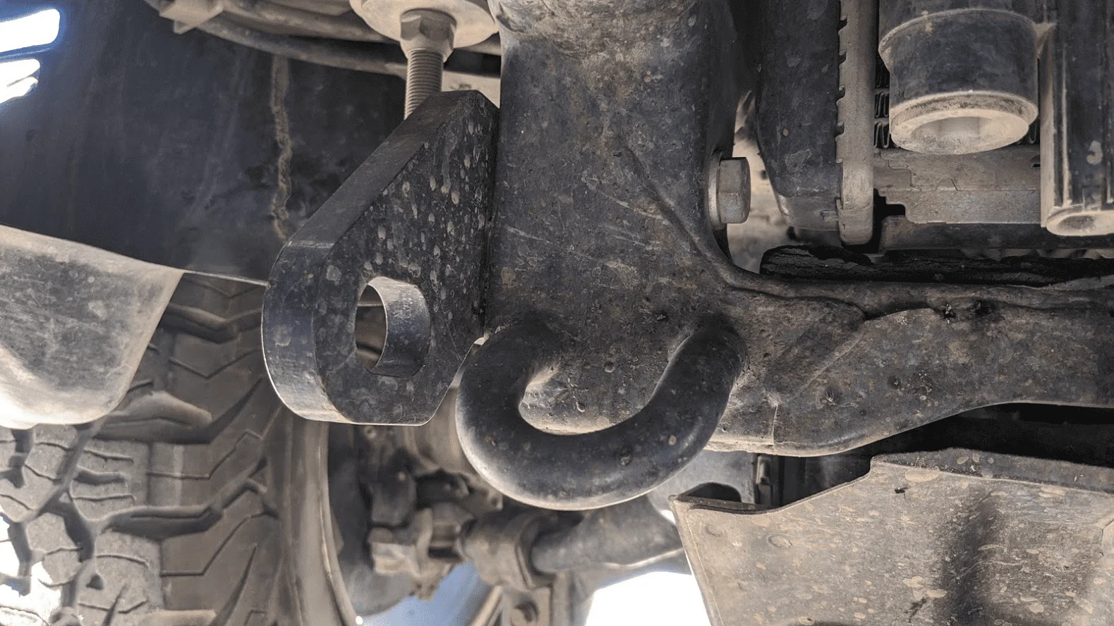

Previously I'd impulsed the Treaty oaks recovery points, but did not understand the differences between pre '06 and post '06 front tie-down point differences. TO indicates mods may be required to fit their recovery points on post '06 GX 470s. The mod they refer to is cutting off the tie down loops as their orientation does not allow a hard shackle to fit into the TO holes, but on pre '06 they do...

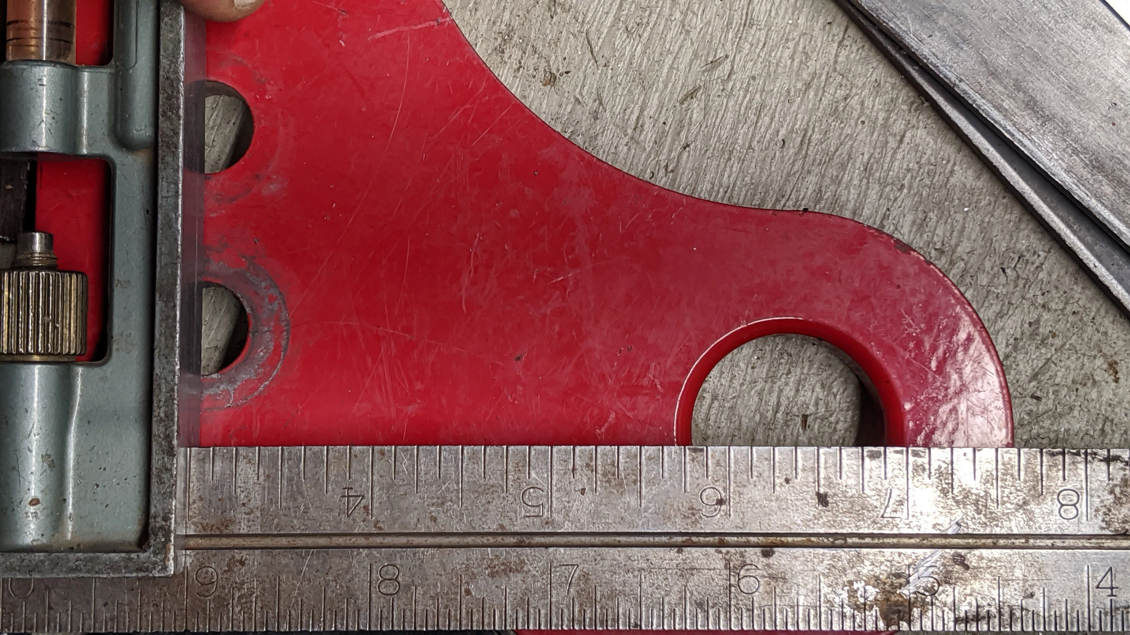

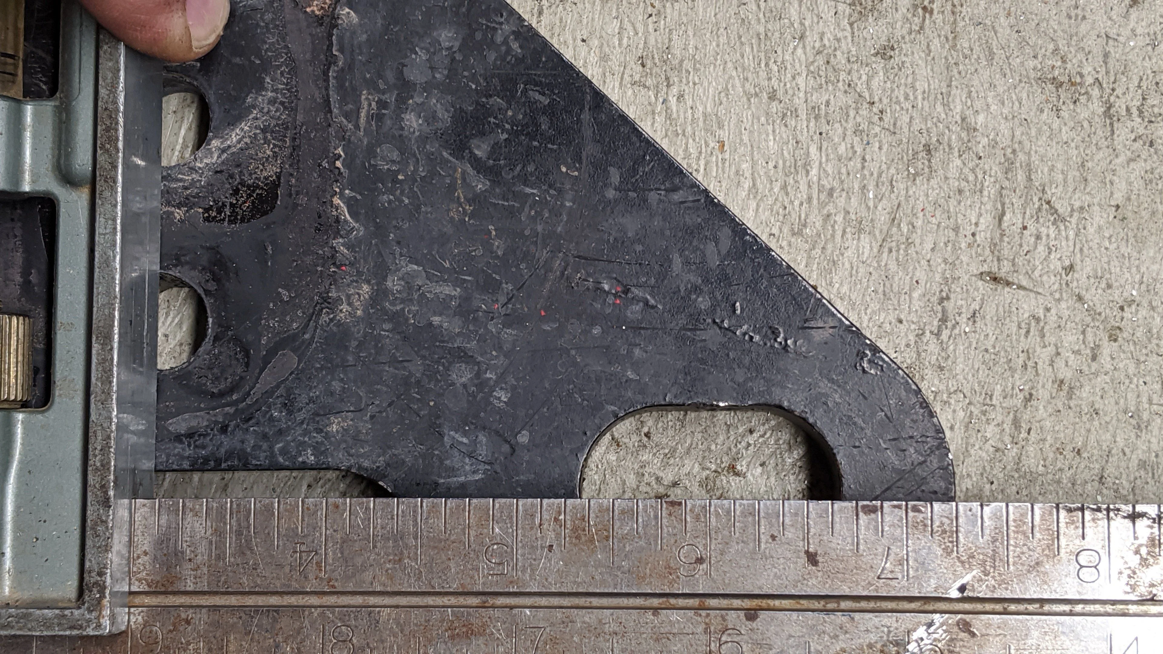

Anyhoo, I impulsed some take-off Trail Taylor recovery points. The differences are small, but the geometry allows a hard shackle with the stock tie-down in place, plus they holes have been radiused such that they'd be soft shackle friendly too.
Treaty Oak:
Trail Taylor:

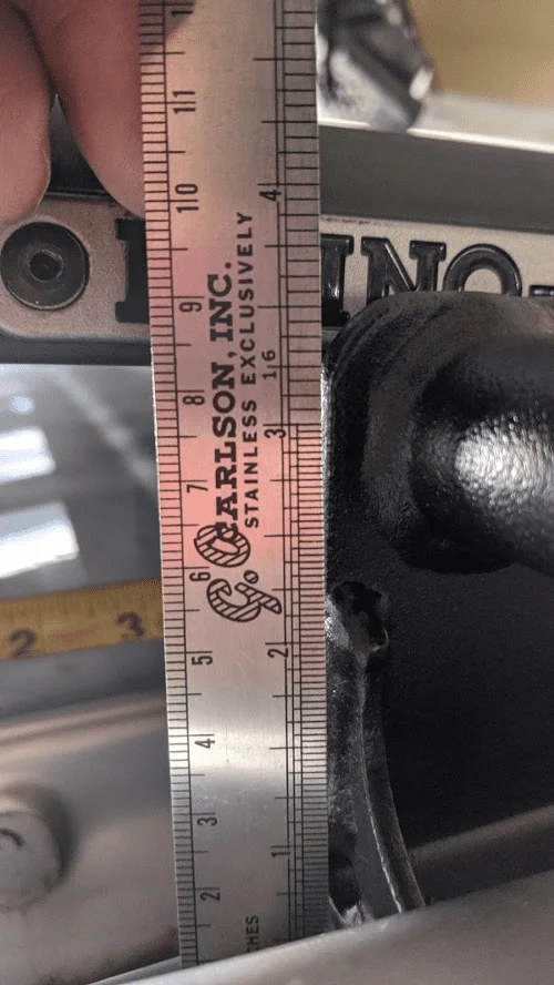

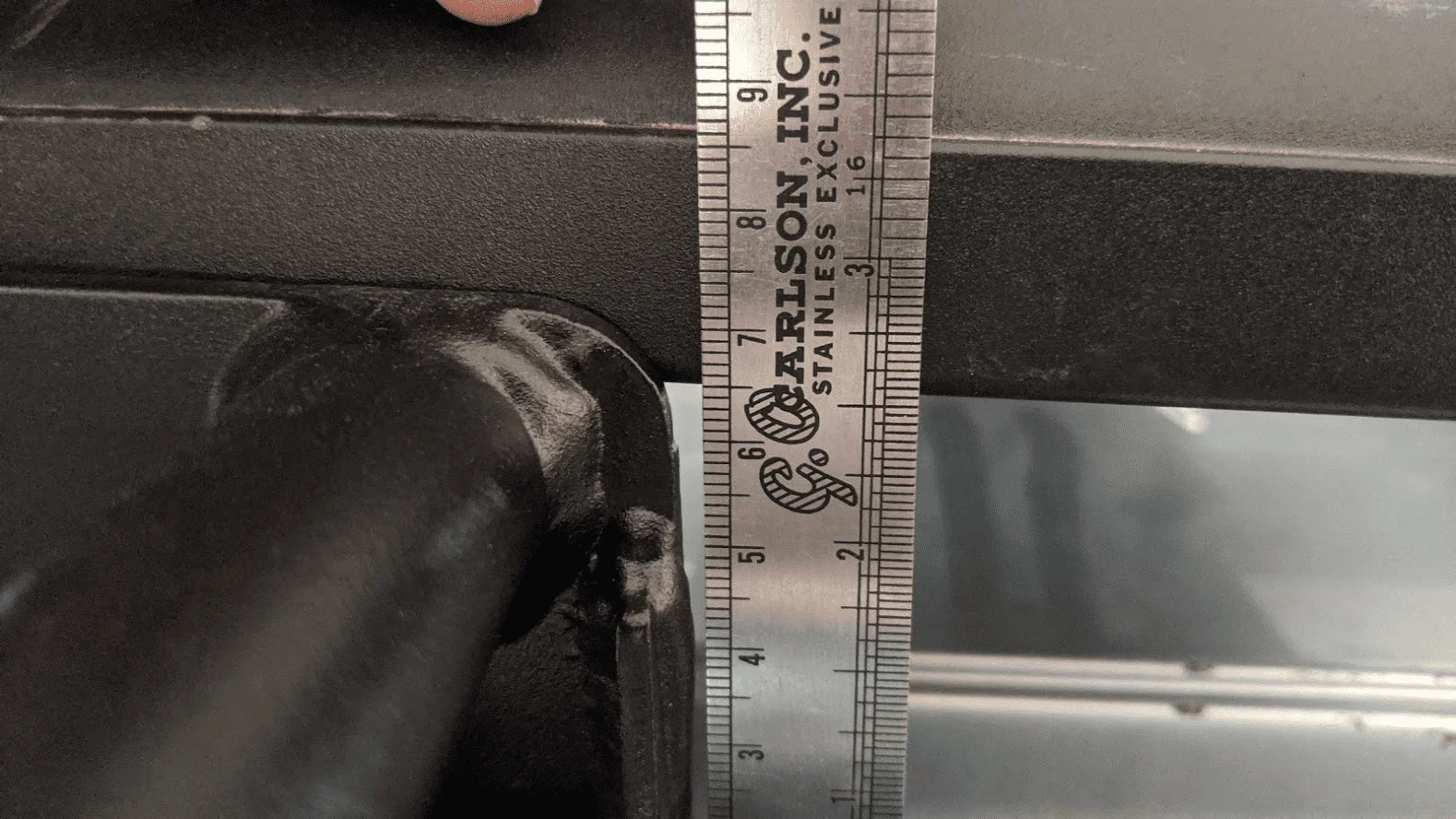

Some measurements and comparison...

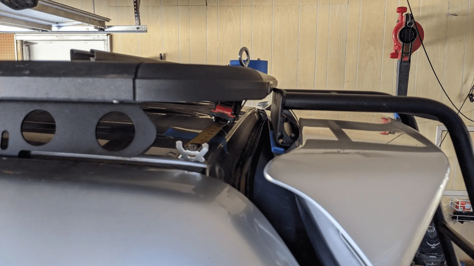

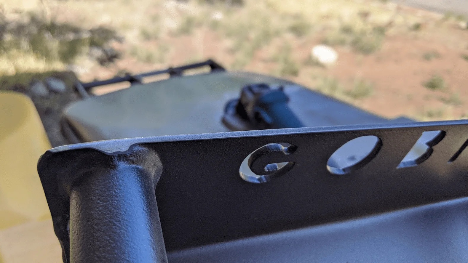

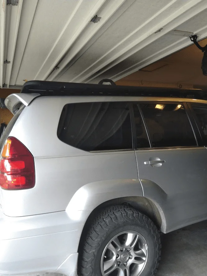

Another spring 2020 impulse purchase landed on my doorstep... Gobi Ladder
I've been eyeing the Gobi for a bit (especially since mounting and using the Pioneer Platform a bit) but mostly shirking it's utility over co$t, then a local buddy put one on his Pro 4X X-terra (which he's been slowly, mildly, but functionally building up).

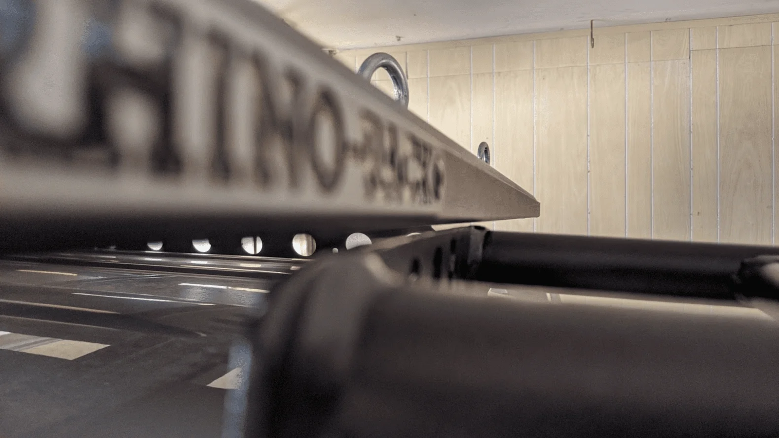

In the interim I'd been taking measurements and pinging GX folks with the Gobi for measurements to see if it'd fit under the Pioneer Platform, fitted with the Backbone mounting system. The backbone affords a sleek and low profile mounting system for the paltform...

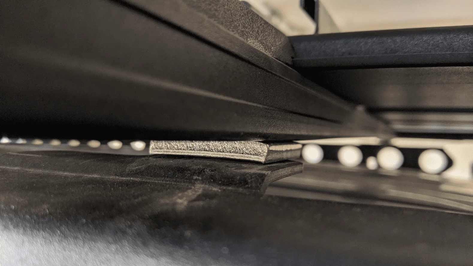

as it turned out, upon unboxing and quick hanging/fitting, the Gobi was like 5/16" TOO TALL (not mounted/fitted, just hung on the door)!!!
GGAAAHHHH!!! :oops: :bang: 😩😤
BUT ....
Not to be flustercated, having time and patience, I turned to my 'ol friend Unistrut/Superstrut! :) I spaced the pioneer platform up 1/4" with 6 unistrut block washers (and eventually used 25 mm M8x1.25 bolts) and shaved a little metal off the top of the Gobi, then mounted it per instructions and it all tidied up nicely.
which bought me the precious micromillimeter-level tolerances... (i did go back and shave off a bit more material a week later, but it's clean and doesn't tough the platform now...

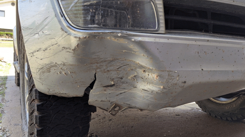

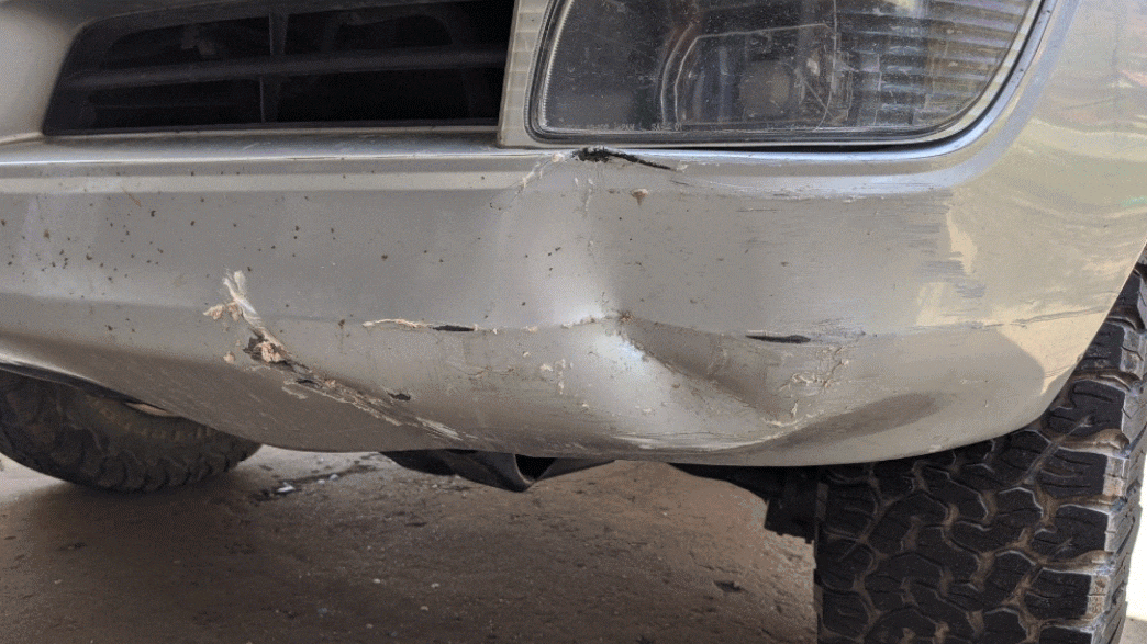

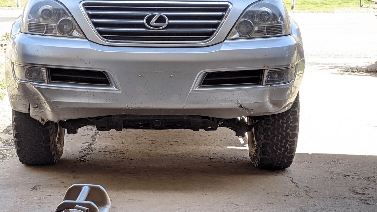

So, sadly I ran out of approach angle and track width, but excelled in wheel base and courage awarding myself sum moar camry dents...
So out came the boiling water buffer!!
followed by the heat gun and a scotch bright. . .

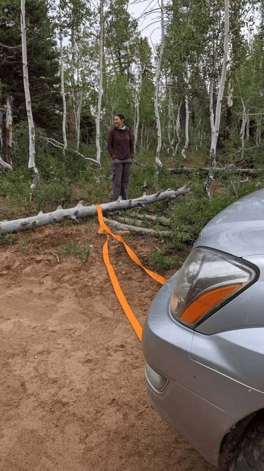

Coming down a trail there was a downed tree so I was psyched to pull out the recovery kit, cut, drag and move it.
Simple pleasures but using the stuff we carry helps justify some of their existences ;)

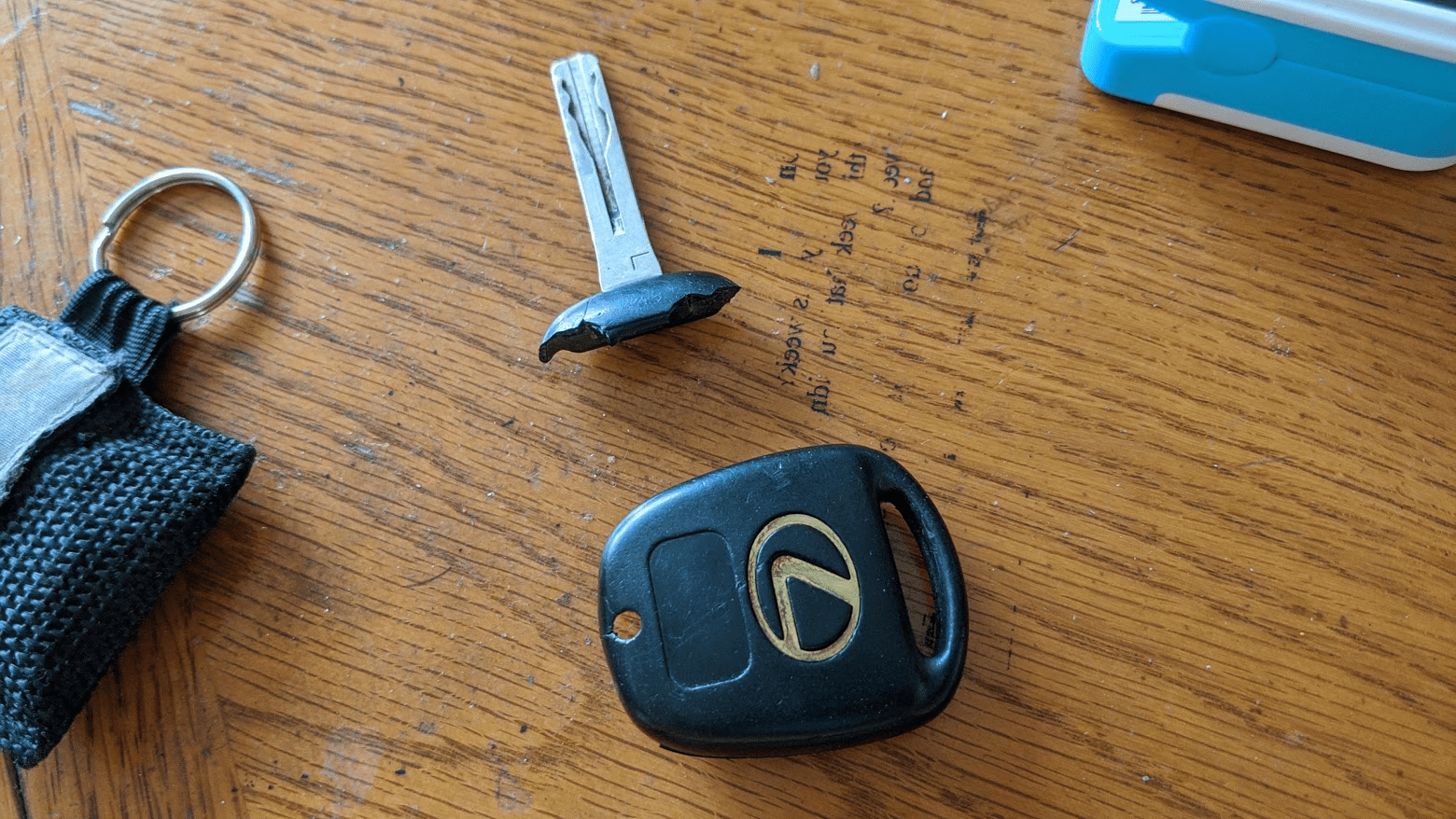

now this process.

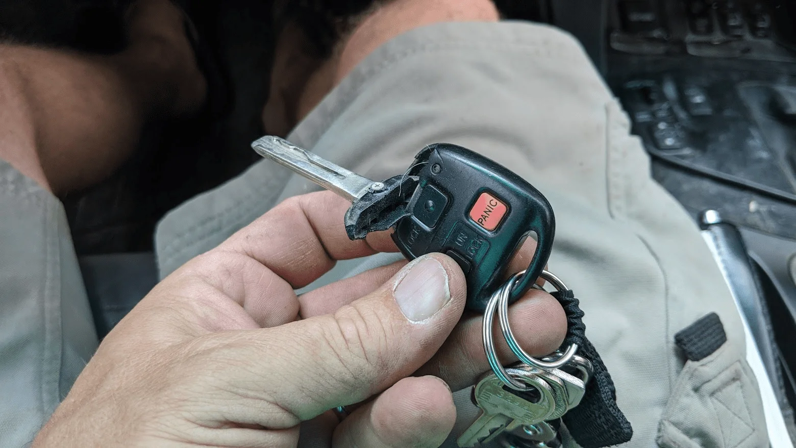

fob still locks and unlocks and key starts engine. So I'll try a case, cut the blade, and swap the guts ...
I got a new case from the link below. The FJ fobs are compatible with the GX fobs. You shouldn’t need a new key/blade. Just remove it from what’s left of the housing and put it in a new case.
wait... a case of fobs? 😝 🤓
J/K. That's good to know that FJ fobs are compliant with the Lex fob guts and blade is transferable ... plus those look rad! 👍
