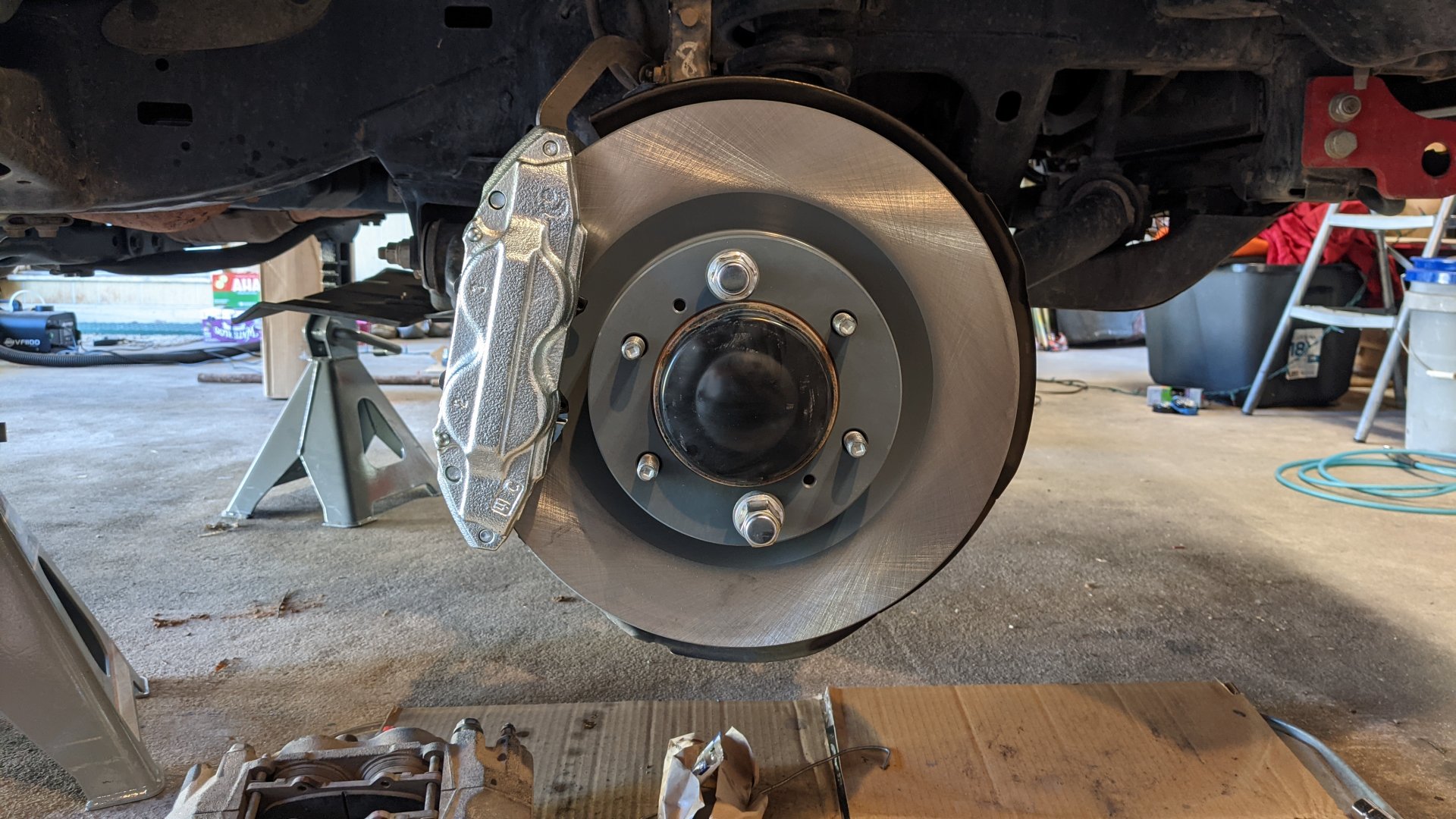

Installed the 0.75" Bora wheel spacers with the big brake job.
Stock 470 rims have decent indents between the lug holes. Some have had issues with stock studs and wheel spacers.
On mine, the stock studs in the rear protruded about 8mm past the Spacer's rim surface, and 3mm in front 😲
But they nested nicely in the indents. 🤘😈🤘
Still gotta bleed the system.

I doubt I'll be able to tell. In concept they're the same with a wider rotor b/c more space between inner and outer plates. I don't really see any hydraulic difference, just the caliper is a little wider to accommodate the wider rotor. I think the Piston movement from rest to rotor is going to be the same as a stock 470.
My chronic buyer's remorse set in pretty heavily when I first read your response, considering I could have done this brake job for a factor le$$ - ergo just pads. As it turns I'd bought a bunch of takeoffs from a dude in Colorado like 6 months ago, and I'd forgotten that that pile-o-parts included front brake pads until a buddy shuttled the bits to me recently. 😂
But seeing as I'd already $pent it I'm going with it, besides I don't feel like I've done a good mod on the 470 in a bit, save bumper trimming. My pads all around were pretty well worn, I don't have any calipers to check rotors' remaining life/thickness. I might-should replace the rear rotors now anyway cuz that would be like all fresh all the time, but they seem fine. 🤷
I'll roll with it but if I notice anything clearly obvious I'll certainly make note here... 👍
My kid helped bleed this evening so I think I'm all set on this upgrade. 🤙
