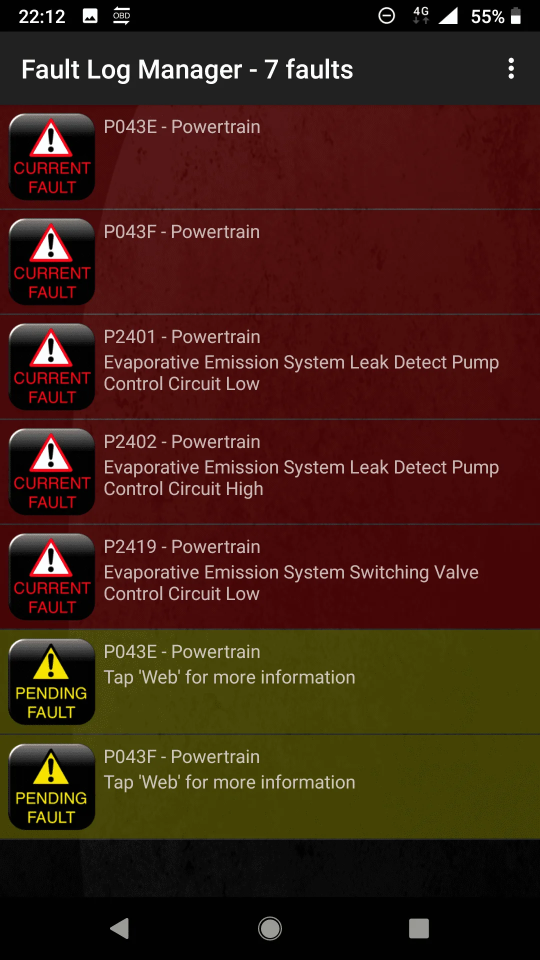

Yota gas cap didn't solve the previous codes, I had a NAPA one for a while, but finally got the Yota one...
Google-fu suggests canister... 👍
To that'll be the next step....
Only four things that cause this (in order of ease): gas cap, vent plugged, charcoal canister, purge valve.
I think I looked into replacing the canister a while ago... Sort of a job, but comparably relatively easy.
Thanks @Vlad , this is a perfect"order of events" checklist.

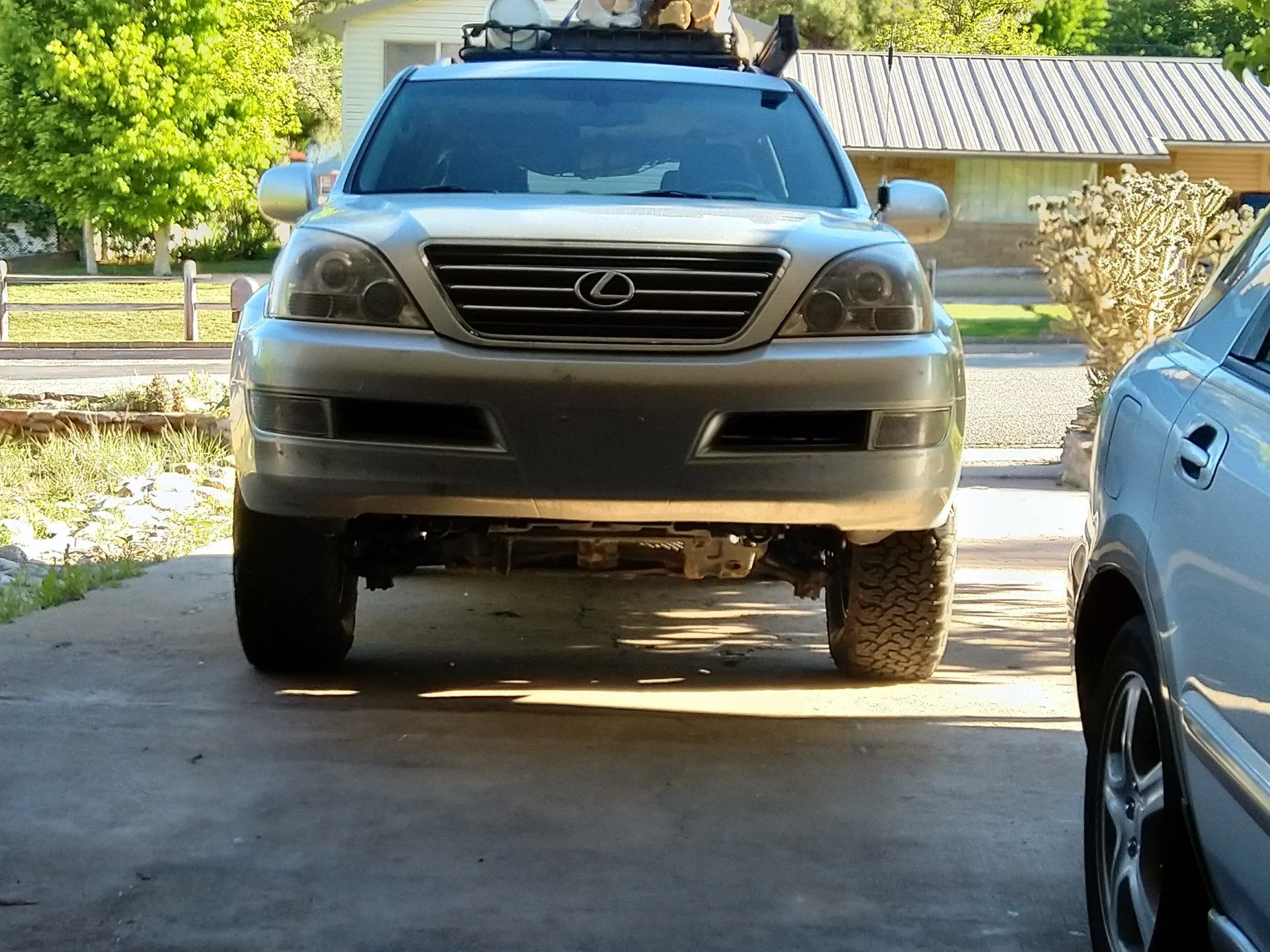

I think its a combo of KDSS lean and my driveway. It's always looked wonky on that side of the driveway. Now that I've pulled in forward its not nearly as bad....
Only an inch different in height hub-fender, and its pretty loaded, so lots of confounds.
Yes, in fact i have those bits packed in a rocket box on the roof. 🤘👍
I wish all repairs were as easy as changing the rear airbags. And that fist photo looks like a severe lean. As a band aid until you replace bags, if that is even the problem, if you trick the rear air to over inflat just a little, the bags seem to seal/close onto the crack keeping the leak shut and no air loss when in "N"
i'm not sure it is bags, might be severe KDSS lean. The compressor isn't running all the tie to keep auto-level if from a leak and I haven't even bled the KDSS hydraulics yet...
Airbags work well, keep level wen loaded and inflate to HI for crawling well...
soo.... investigation is just needed.

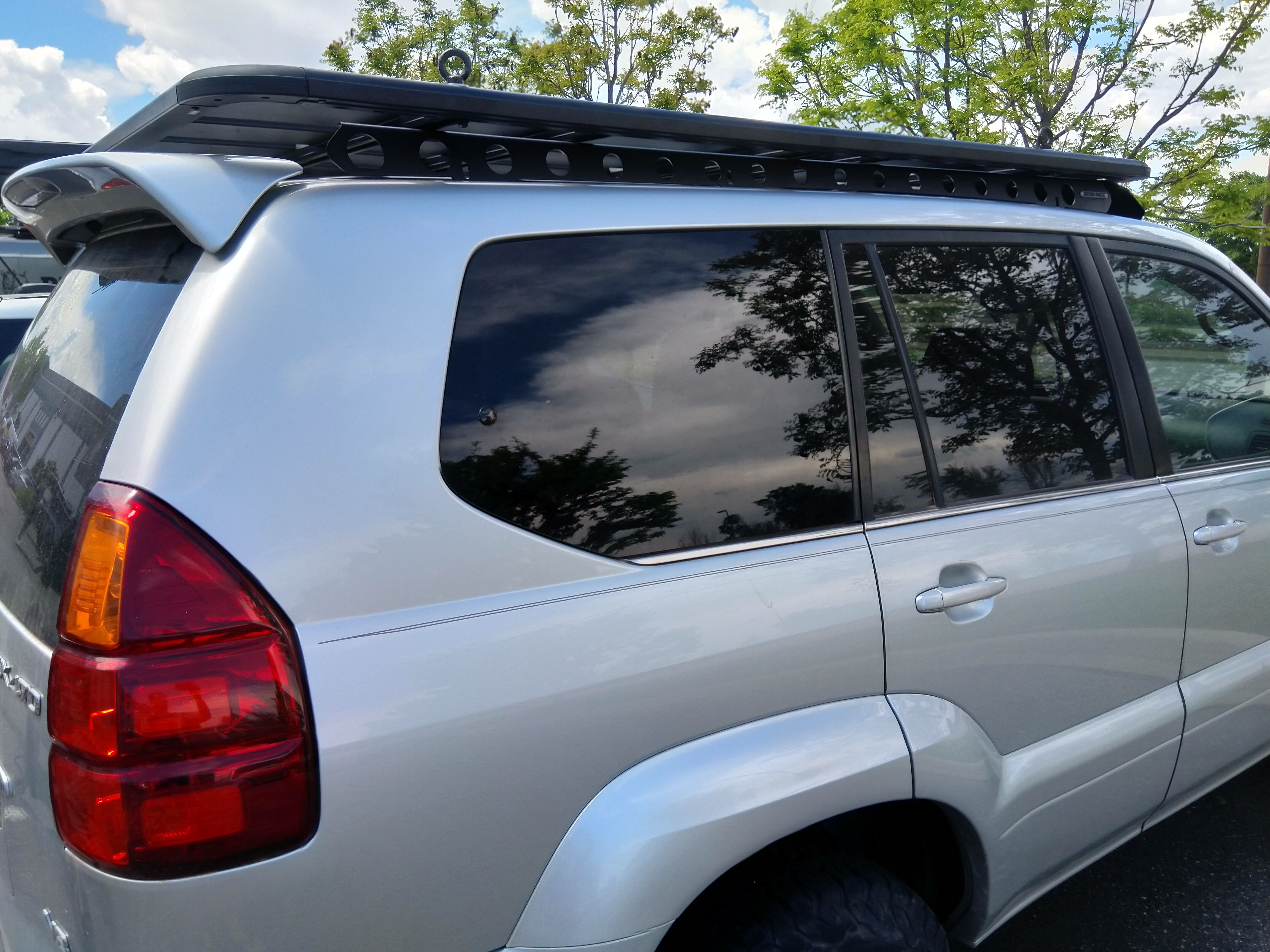

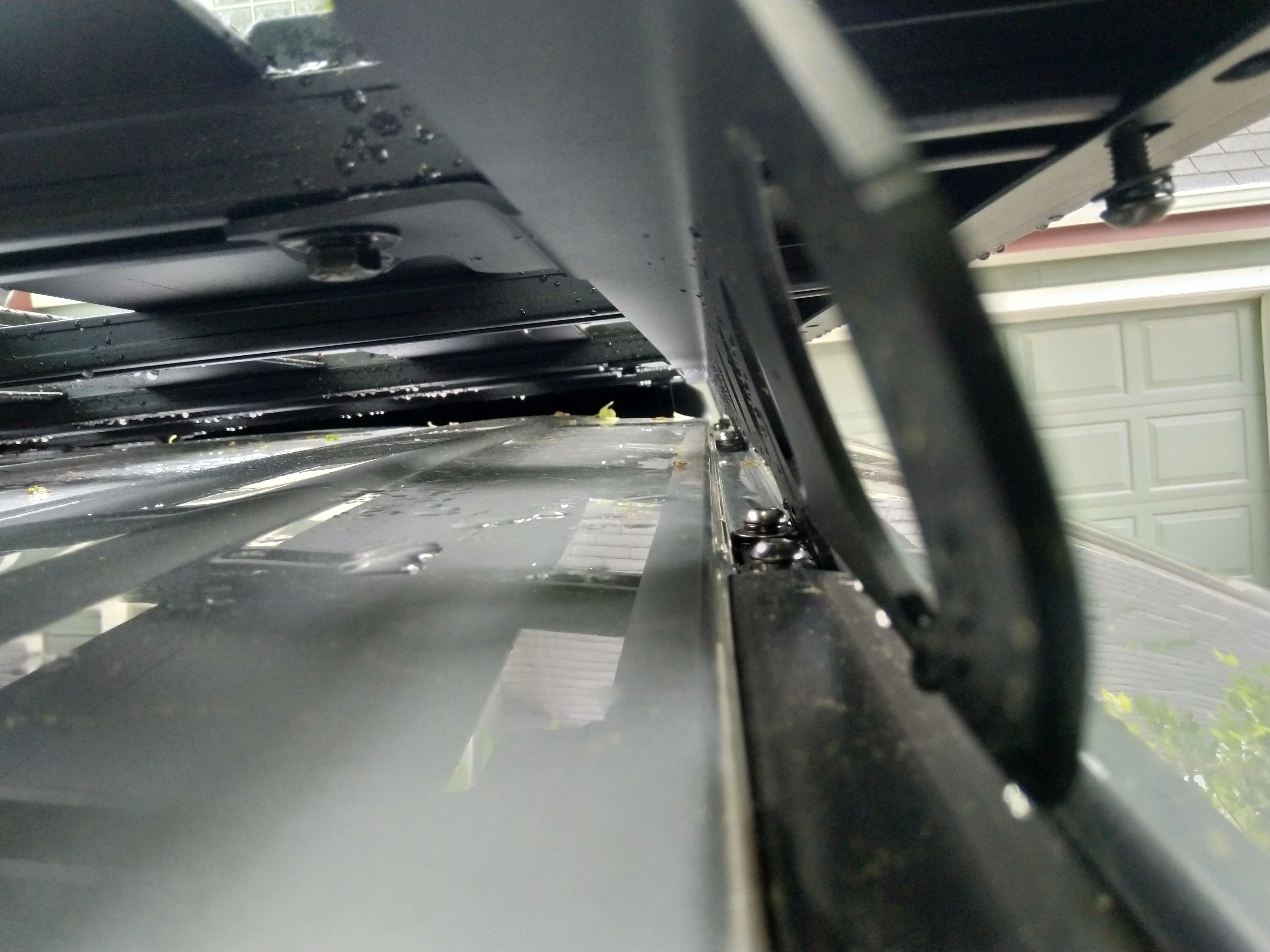

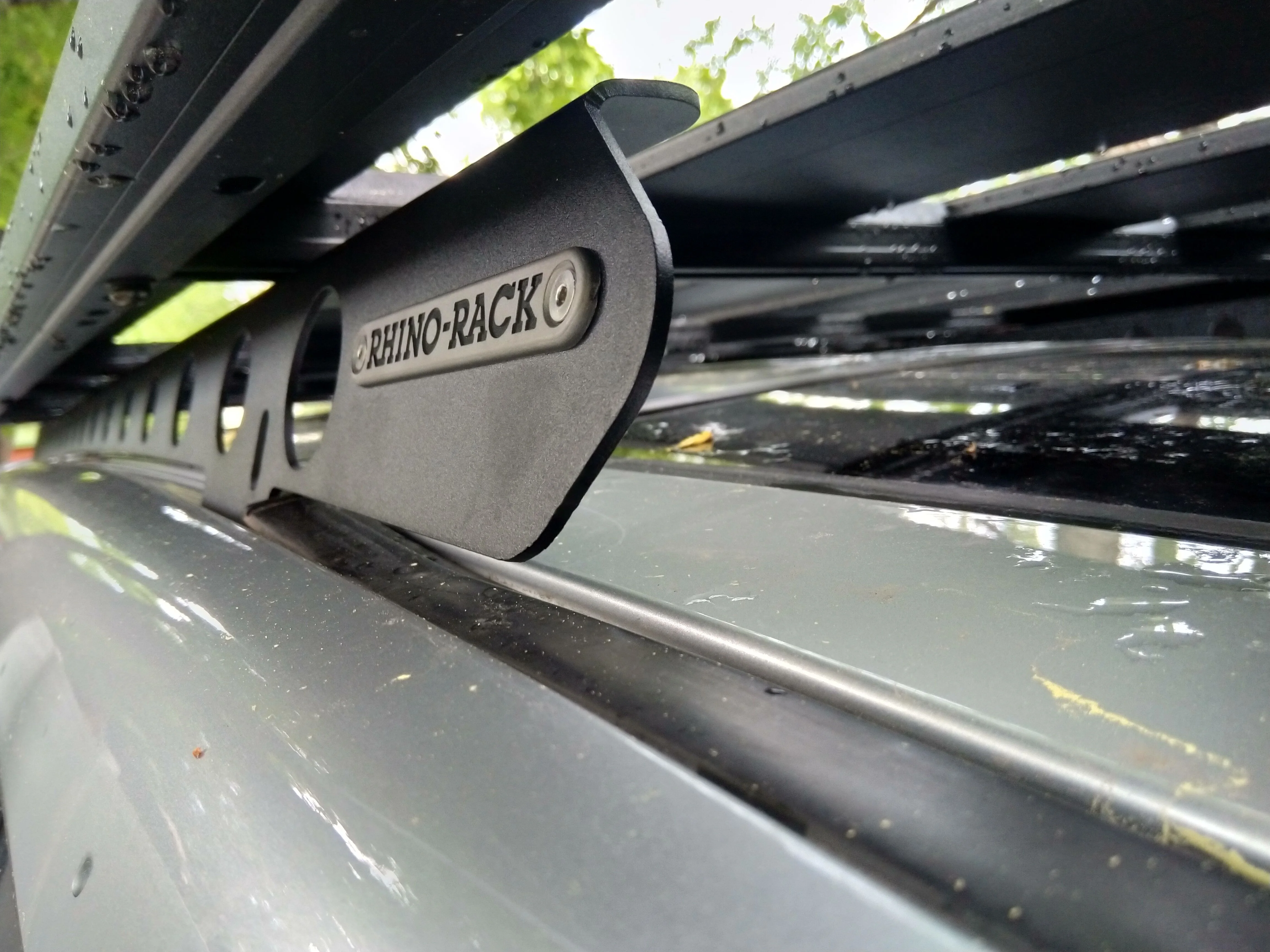

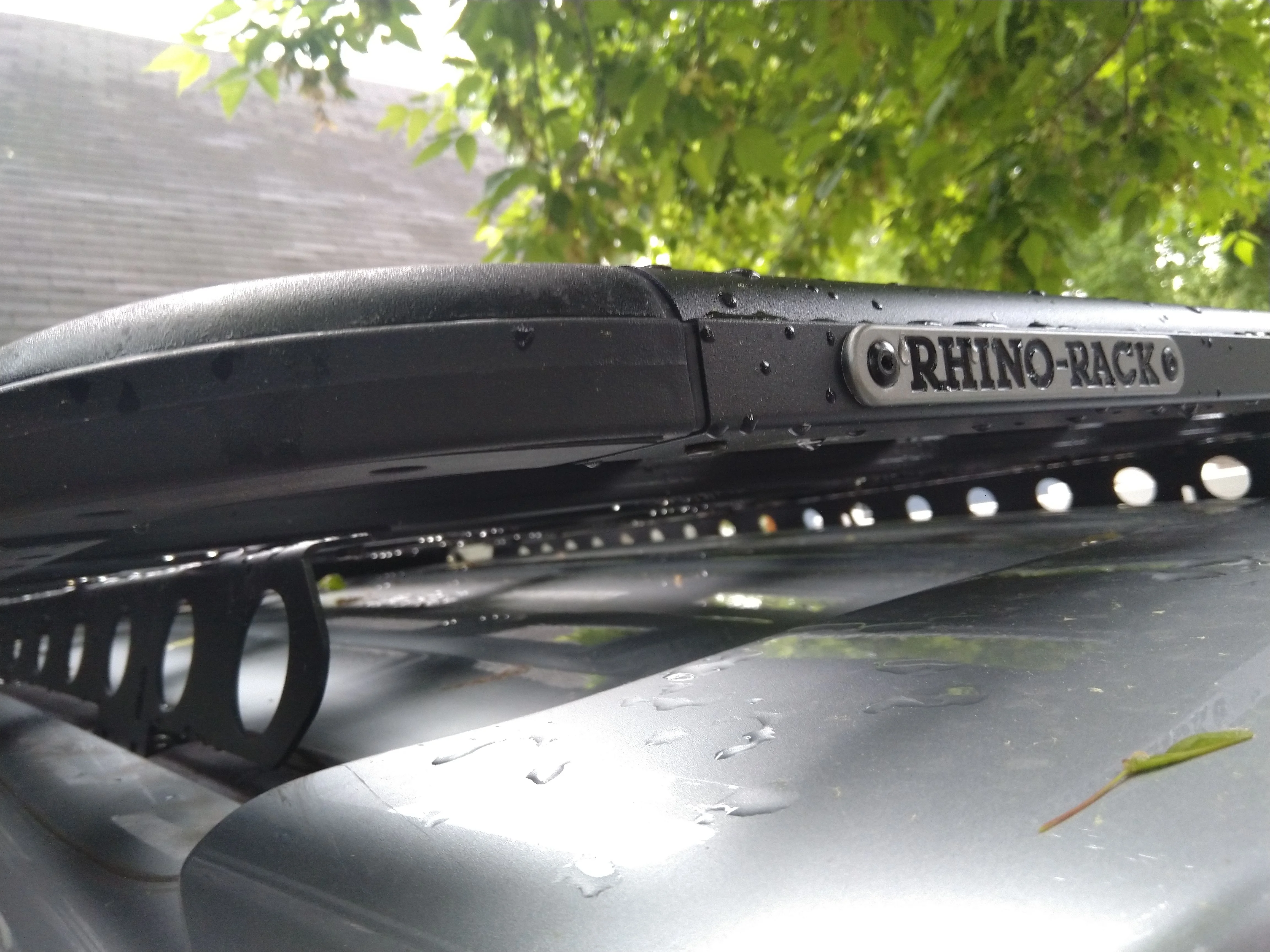

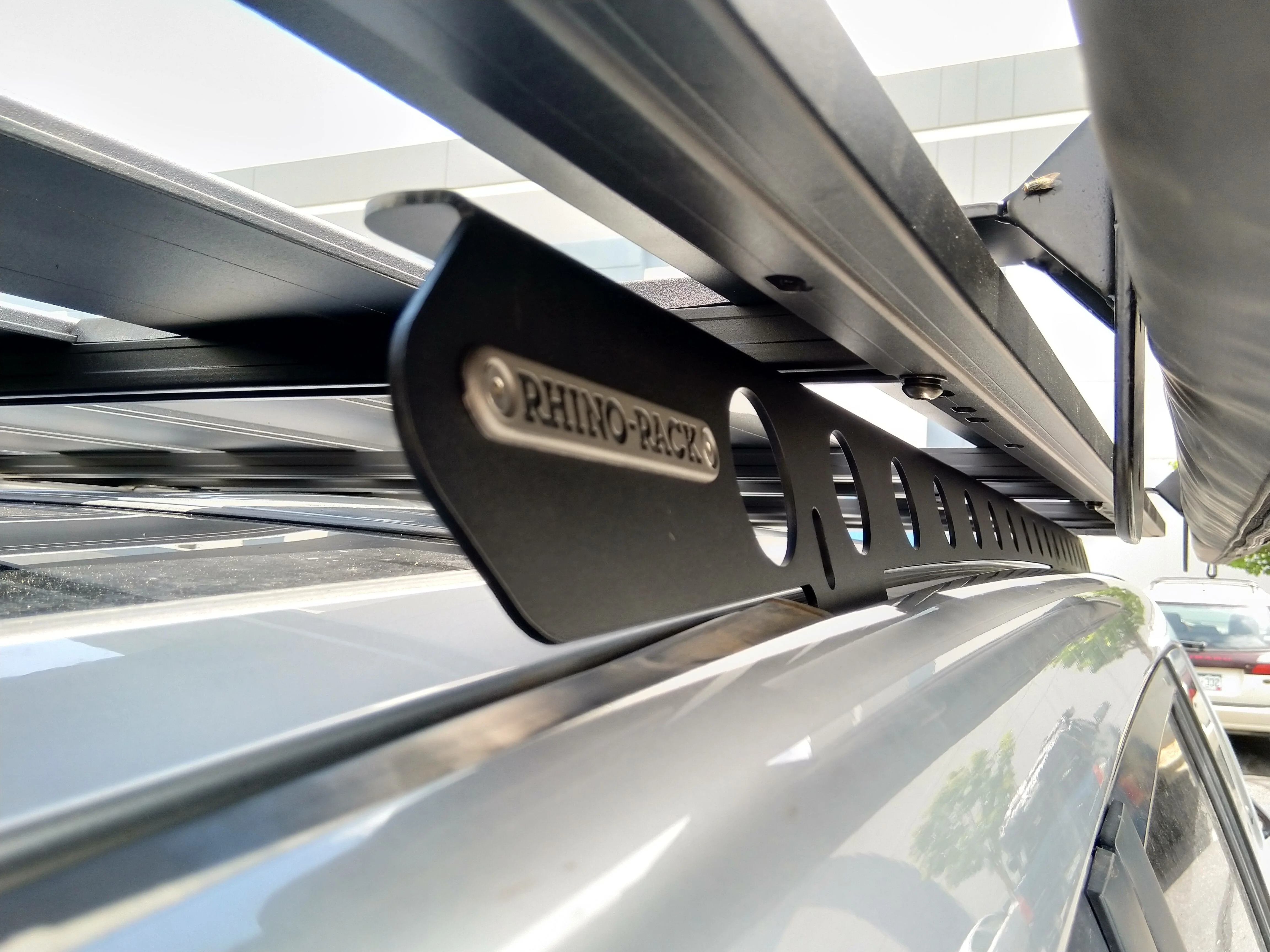

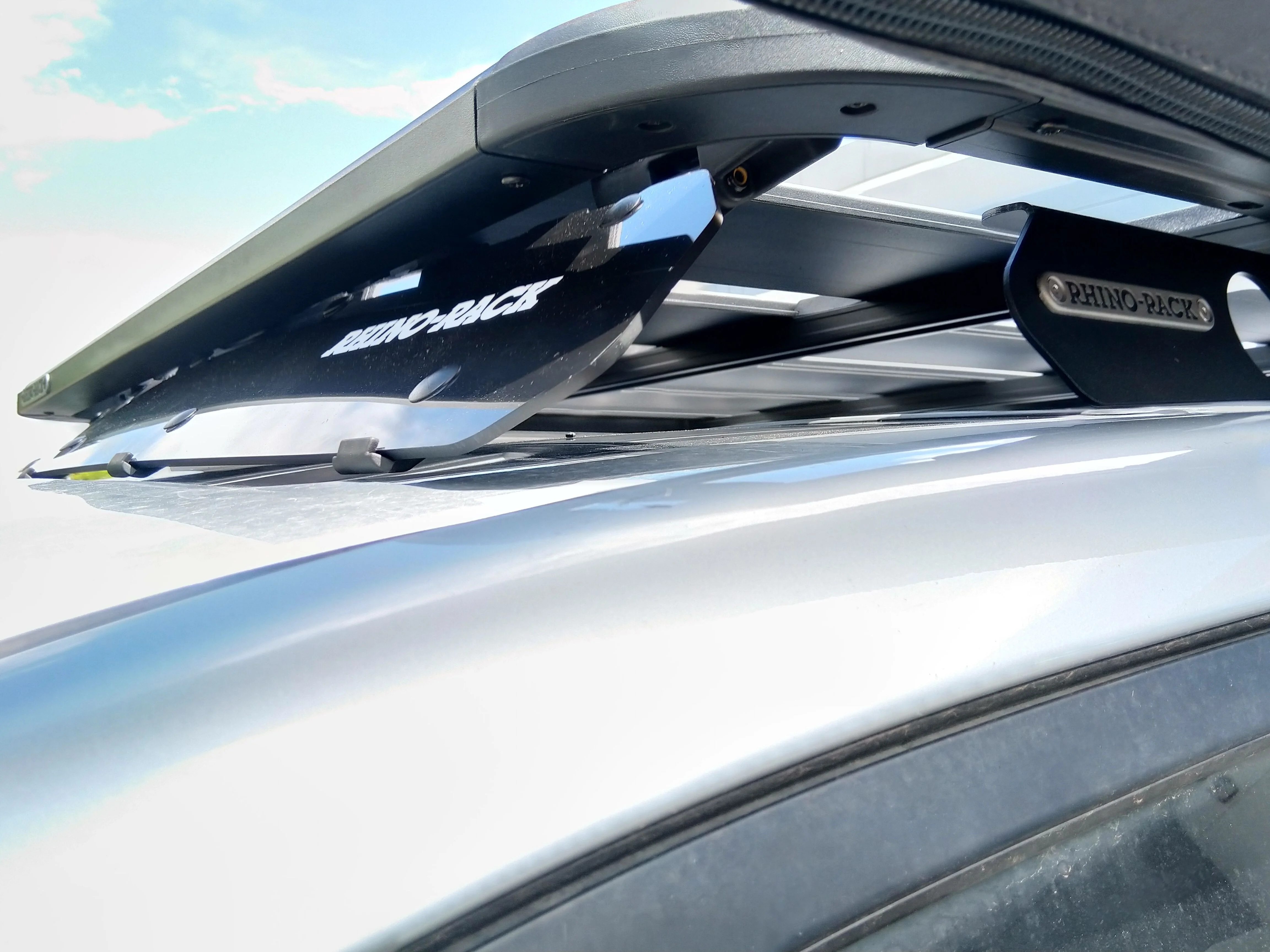

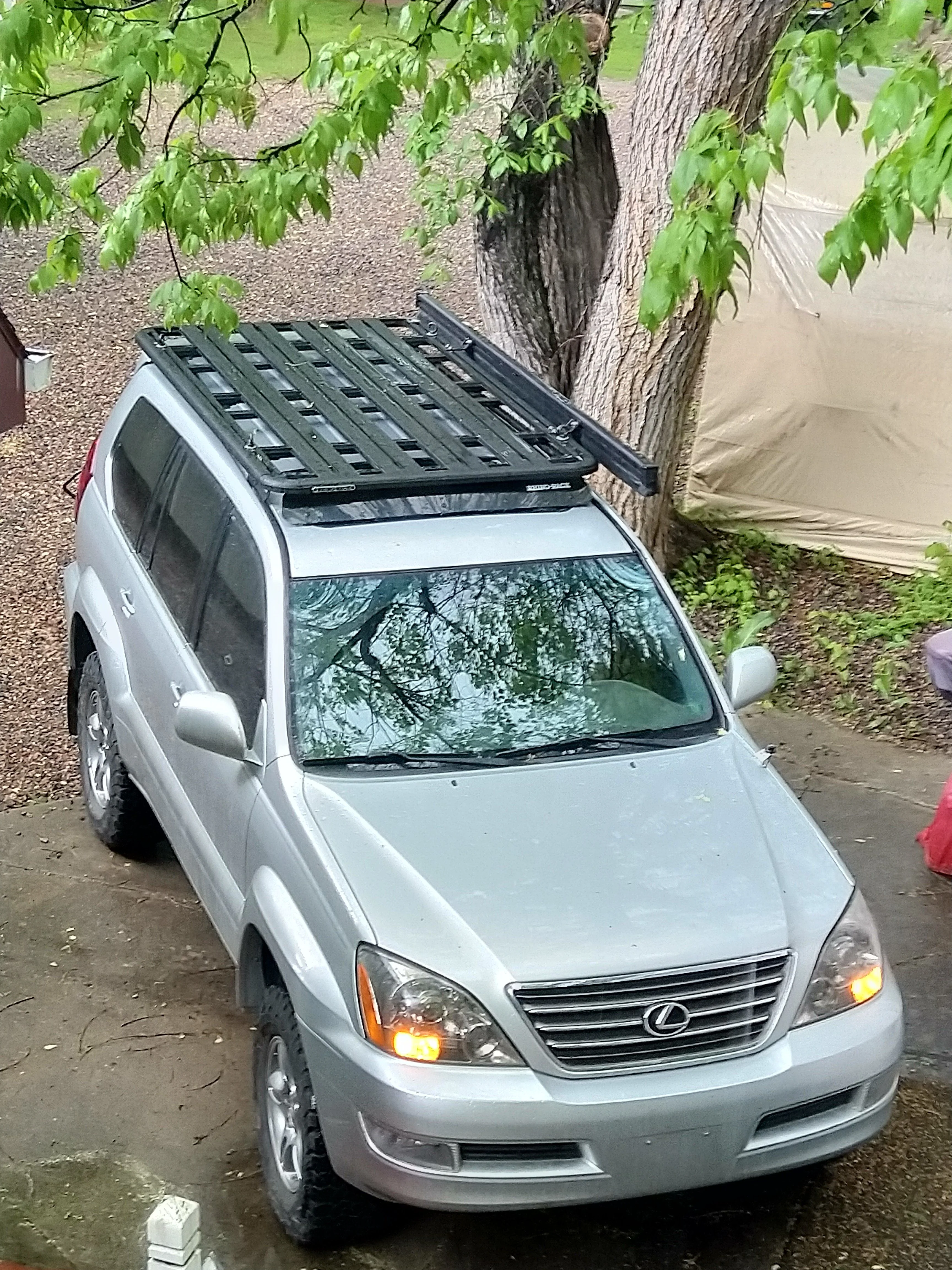

So, after months of work, scheduling, discussion, and back-and-forth texting and phone calls It's real, it's a thing, it bolts right on and it IS available!!!
The Rhino-Rack Prado 120 backbone (RTPB2) exists, IS stateside and can be had. Rhino-rack dealers can get it from the warehouse and RR-USA is finalizing the details for publishing it on their website. Your local Rhino-rack dealer like mom-&-pop dealers (not the megga shop or online retails mind you), can get the product for you through the warehouse.
Rhino-Rack Lexus GX470 backbone
