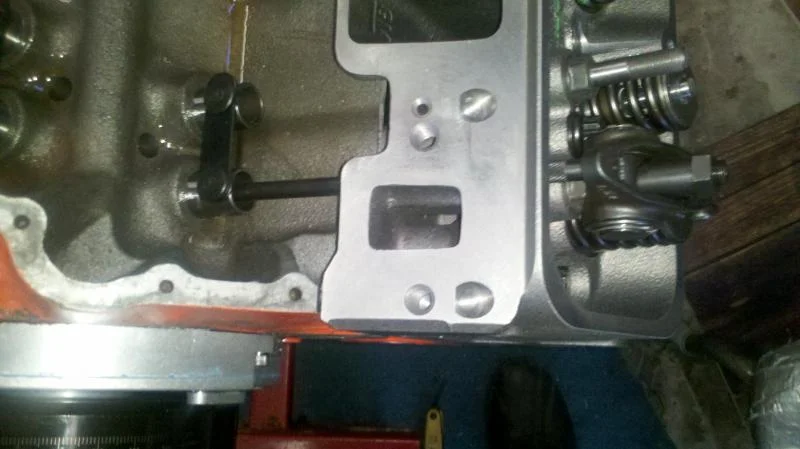

I used the Comp Cams adjustable pushrod checker, 7702 link at http://www.jegs.com/i/COMP+Cams/249/7702-1/10002/-1
which starts off at 6.800 inches and can reach to 7.800 inches fully extended.
I started at 6.900 (which is two full turn outward - each turn is .050 inches). And reinserted the rod, put the ink of the pen on the end of the value stem, and put the rocker on. Proceeded to turn the motor so the valve opened 8 times.
I did this 5 more times (two more turns each time) until the ink marks on the valve stem were centered as per the video. This happened at 12 turns outward or 0.600 inches.
5 * 8 * 2 = sore arm.
So my pushrods should be 6.800 inches plus 12 turns each at .050 inches or .600 inches, totally 6.800 + 0.600 = 7.400 inches for the push rods on my rig.
http://www.jegs.com/i/COMP+Cams/249/7955-16/10002/-1 for price of $125 via jegs for 7.400 length rods.
Anybody have comments on a beefer rod? .104 diameter vers the .080 above?
http://www.jegs.com/i/COMP+Cams/249/8406-16/10002/-1 for $180. Says ideal for serious street performance/race operations.
I always like "STRONGER" when I do things, especially for 4x4 work.
Thoughts from anyone? Are my steps somewhat correct here?

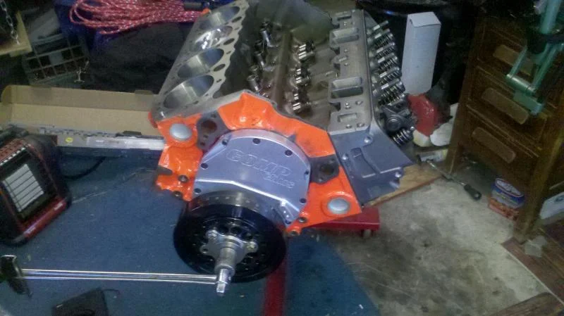

Here are a couple of pics of the head and the pushrod length checker installed.
All the lifters in their places.
NOTICE: The Buddy Heater to the left of the engine. Nice and warm after heating the man-cave for 2 hours.
REQUEST: What color should I paint my heads? I was thinking SHINY BLACK. I don't want them Orange, some contrast (within reason - not quite Trollhole's tuty-fruiti look). Will paint the water pump as well, maybe WHITE or something else.............mmmm

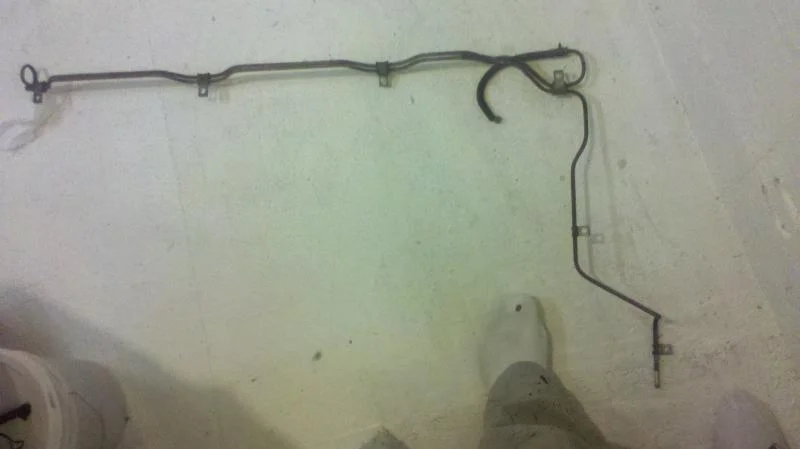

As for the fuel line/tube of which I spoke earlier, I just took it off (and it is rusty) and its picture is below. It is connected between the vapor draw line (the rubber line) that goes to the canister near the engine and the vapor separator in the rear (near my foot, which is in the pic for scale). The long piece goes from the PS to the DS and then back again, and the short parts goes up to the separator.
Again, very rusty. I will see if it will clean up without damage. If so, I will paint it and reinstall. Maybe paint it yellow, since it lives where the sun don't shine.

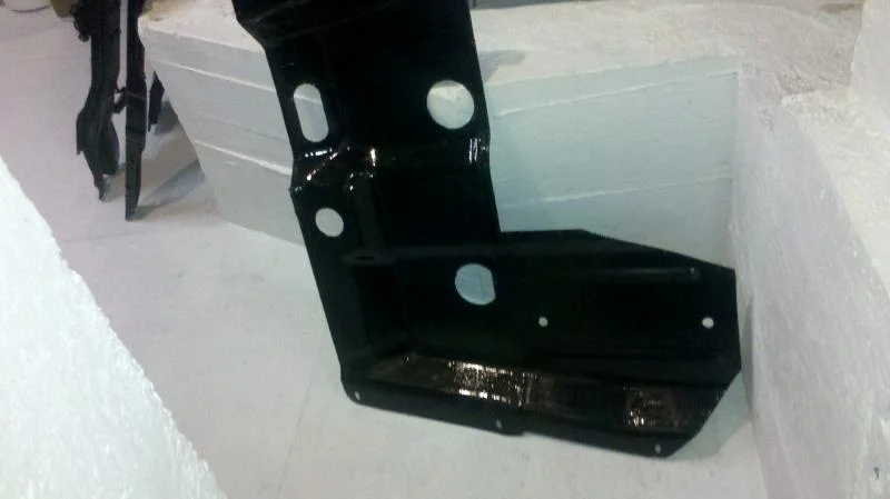

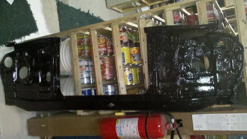

Pics of the skid plate, the tranny mount, spare tire holder and the radiator cross member, and the front wheel wells (not the best picture).
Last pic is the radiator support bulkhead finished.
Look much better than before (the blaster cleaned them up)
painted job was brushed on, but that is okay, as these are under the truck for the most part.

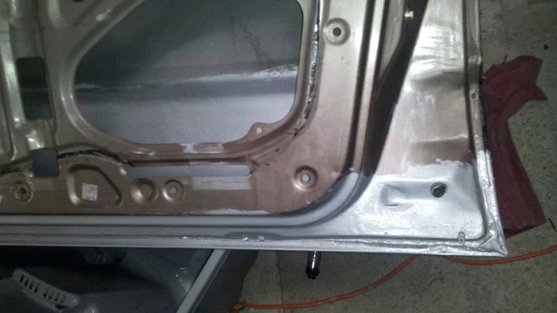

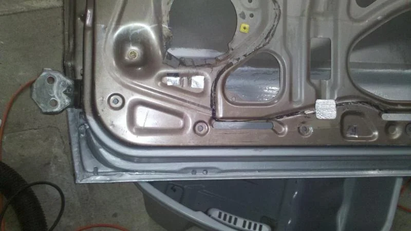

Bottom of door sealed up
Pics of the PS front door with black paint on the lower part to seal it all up.
Will finish a straight line for the black later when doing final.
Other doors will be similar and won't need to demo those as this will suffice.
Pic 1 and 2, across the bottom
pic 3 small look inside the door, looking down
bad light, it looks better in reality.

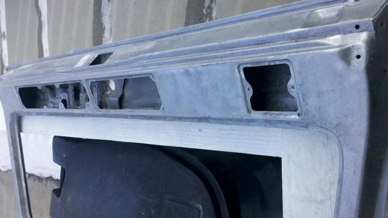

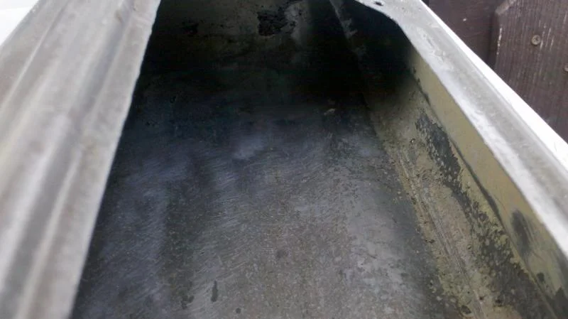

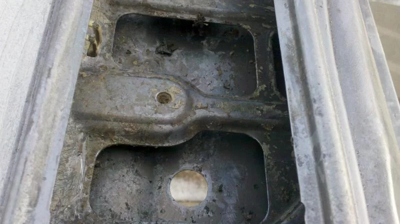

I had stripped my tail hatch some time ago, and am now preparing it (and the tailgate) for applying Monstaliner.
The problem I ran into is how to clean out INSIDE the hatch, with all its small corners, metal braces AND areas not available for access.
I believe on the top cross brace and the verticals I will use the Eastwood Internal Frame Coating. Possibly the corners of the hatch as well
Another item is what to use on the outer seals all the way around the hatch?
I can use seam sealer or a couple of coats of the Rust Bullet paint on seams.
Oh the questions for a painting noobie
UPDATE: Hatch is much better now inside, spent some time cleaning the inside up with brushes and brake cleaner.

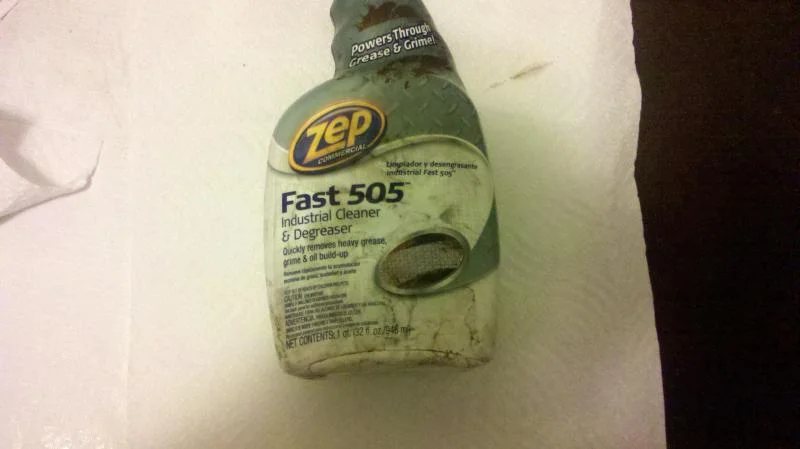

Some Cleanser!
Zep Fast 505 Industrial Clenser and Degreaser, buy at Home Depot in the cleaning material area. I have used it under the hood and on the firewall, and other small locations, but today some big time washing.
Spent 2 hours cleaning under the body from the axle back to the rear door. Gas tank is off, so I used Zep instead of grinding and a stiff bristle brush. Spray on, brush around, repeat
It wasn't until I used a garden sprayer with hot water to rinse it off, that I could see just how clean it was. A couple of areas needed another application but then the dirt and the grease just washed away. Granted in the back it was not as greasy as above the Tranny and TC. I also still have about a 2 foot section from the rear u=joint forward that needs cleaning (and it is very hard to get the wire brush in there), but I am almost done on cleaning the underbody.
Forgot to take my phone, so pics will come later. It cleaned up real good.

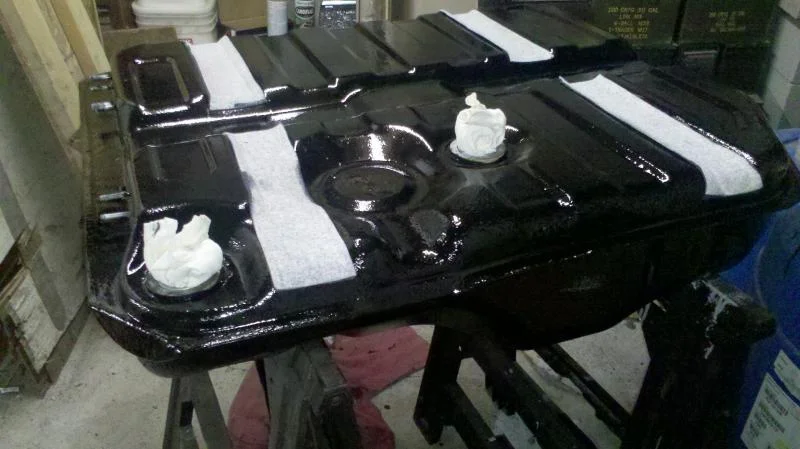

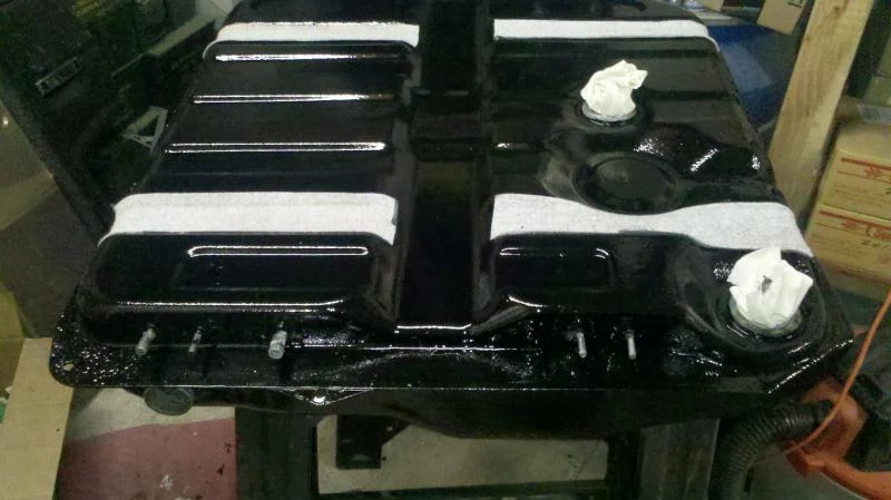

Also took the gas tank to the car wash, used Zep 505 on it and really cleaned off the dirt. Letting it dry now and will put some metal blaster on couple of rusty spots, then paint it with a coat of Rust Bullet Shell Black, to top coat it for good measure.

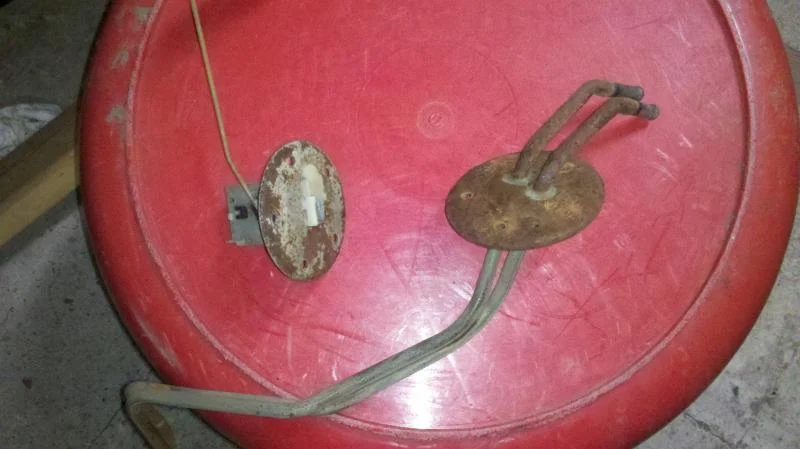

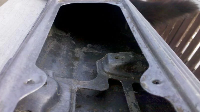

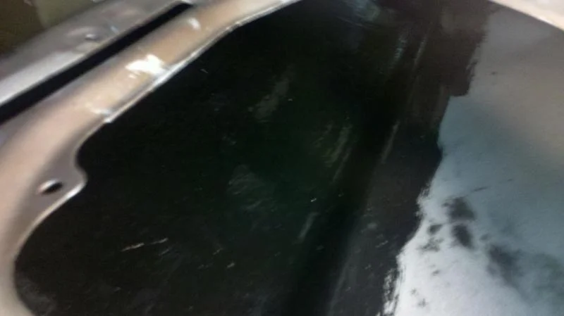

pics of painted gas tank

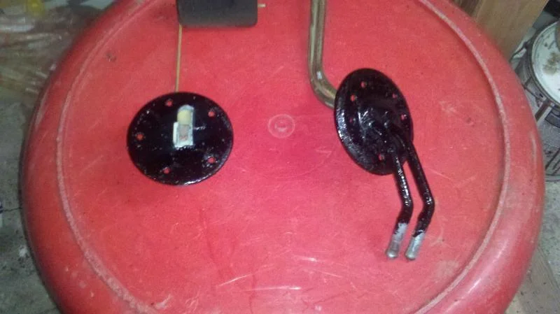

pics of the top of the level sensor and fuel pickup: Tank is the OEM replacement, but this two plates have to be original.
I will clean them up and paint them. New screws are coming, along with new gaskets
both now painted - should last longer now

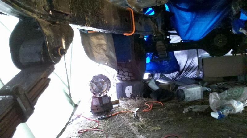

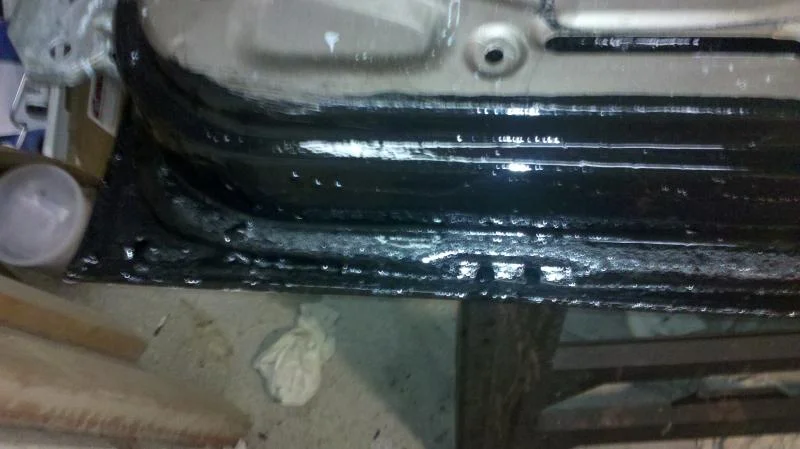

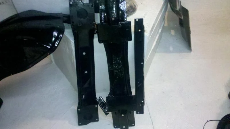

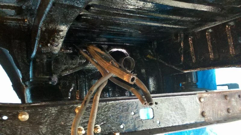

spent several hours under the parachute painting the underbody beneath the cargo area - above the gas tank.
first coat of Rust Bullet base with one more coat to go, then will be covered with the Shell Black.
20 degrees outside, but the propane heater has it in the 60s in there and the respirator made breathing just fine.
It is really starting to look nice under the rig: derusted, cleaned and painted.
Will replace all those rubber hoses prior to installing the tank.
Thought to cover the rear light wires in the back with the convoluted wire sleeve material. It is currently taped,
but more covering would be good.
Also enhanced the ground point back there by cleaning the threads, the bolt, the eye hook and the metal contact shoulder.
I will also fix a 2nd cheap ground point (seen in the 2nd pic) for the trailer connection which is just a screw tying a U hook into the floor of the cargo area (WTF?) by moving it to the central factory one in the rear.
Question: After setting the ground point properly and cleanly, would putting a glob of silicone over the ground point be okay,
in order to protect it from getting all rusty again? If not, any other ideas of protection? (I WANT a great ground point back there
for lights, trailer and HAM radio.

I added to what I did above, namely improving the ground point. My question is: Would silicone glob over the ground point work to protect it? I want that ground point to live long and prosper amidst all the crud that gets thrown under there.
dougbert
Doug, if you want to keep the ground point good, why not run the wire through a hole with a grommet and ground it inside the cabin? I think silicone might end up coming off after a while, hot - cold cycles flexing the steel.
I've used copper based anti-seize on grounding bolts and other electrical connectors at times. Eventually it goes away, but as an example the cb antenna boss on the top of my Mini's front bumper has had an anti-seized bolt screwed down tight in it for ~2 years. Two weekends ago I finally had cause to put an antenna in it and the anti-seize was still there.
If you're going to smear something over the top I would use dielectric grease. It is silicone based and impervious to water. It is a non-conductor (obviously) so its use is mostly to keep oxidizing agents at bay, not to promote conductivity.
I guess that you could use both if you're careful.

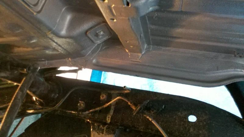

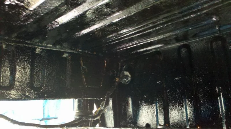

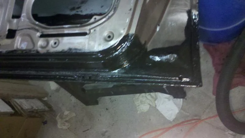

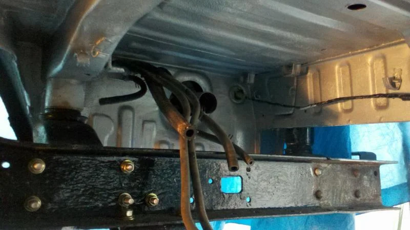

Pics of under cargo area painted with the last coat of Shell Black

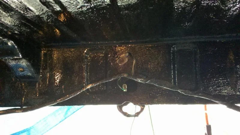

Pic 1 of EVAP hose area
Pic 2 of OEM ground point
Pic 3 of DS Rear quarter
Pic 4 of next section to paint
Pic 5 of propane header near DS front tire and last area to paint under DS seats
frame is just dirty from the underbody cleaning and will be washed off
