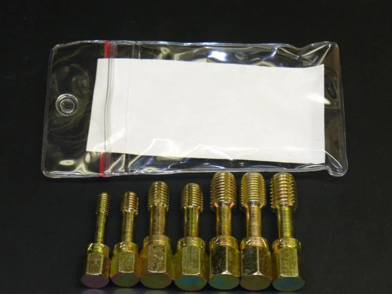

With all the painting I have been careful to NOT fill thread nut holes with paint, but some paint still get into the threads. That and the fact of rust in the threads, I purchased some Metric thread CHASERS (not cutters) and have used them to clean up any threads I need to use in re-assembly of parts.
http://www.amazon.com/gp/product/B000AEX8DW/?tag=ihco-20
is where I ordered the set.
They work great and the 6 sided heads fit my metric sockets just fine. The threads come out very crisp and cleaned up.
I had broken one of the rear gas tank rear bolts. After drilling it out, I used the appropriate chaser and the threads are great

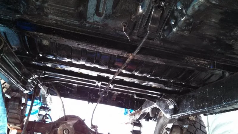

Finished painting Rust Bullet as an undercoat on the entire underbody today. Was 55 degrees, and the snow was melting and pooling under my rig, but was able to stay above the water.
Anyway, that task is complete.

That Rust Bullet Blackshell gasses off a lot. Hard to tell from your pictures, you have any issues with bubbles using it?
Cheers
the pictures are not great, but I think the site reduces the image sizes, since the pics look better on the computer than after I up load them. Still old under coating I painted over, so the surface is rough in places.
yeah in some areas there are some bubbles, but not concerned too much with appearance under the rig. Though I don't know what it means for its durability.
My front wheel wells did well when I did them last sept.
Honestly, I don't think the bubbles are a good thing. I feel it will chip a lot easier in the areas with bubbles, even micro ones. It may even peel or lift off there in time. I have had issues with that myself.

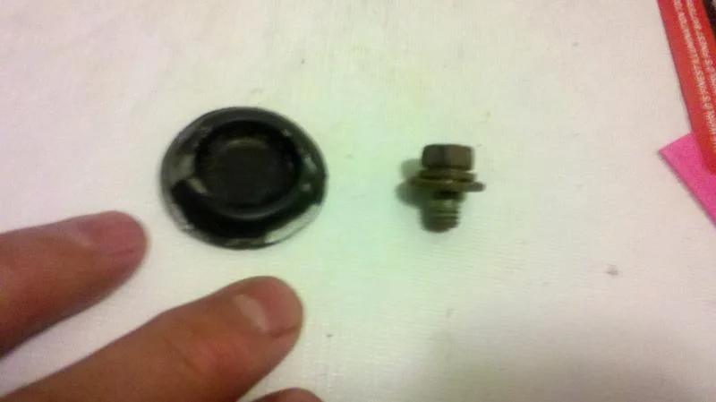

The pic is a 30mm floor pan rubber plug/grommet from under the 60. There are several of them down there and since most are pretty bad, I want to replace them BUT I have been searching all day and cannot find 30mm such plugs.
Does anyone know of a source for these? Oreillys and Autozone don't have them.
I used a micrometer to measure the inner ring to come up with 30mm.
A toyota part number would be great, but I have no idea how to look that up.
any assistance would be appreciated
thx
dougbert
Doughbert,
Toyota does not make those body plugs anymore. My local dealer told me that they couldn't get them. I've been searching for an appropriate replacement since we did my body swap.
Doughbert,
thanks for that info, which is what I expected BUT I might have found a source from a NISSAN aftermarket vendor
https://www.zcarsource.com/floor-pan-grommet-30mm-240z-260z-280z-70-78-new_8_56672_63823.html
indicates a plug that fits in a 30mm hole, I ordered 12 with a total of $25 (including SH) and will report back after I get them.

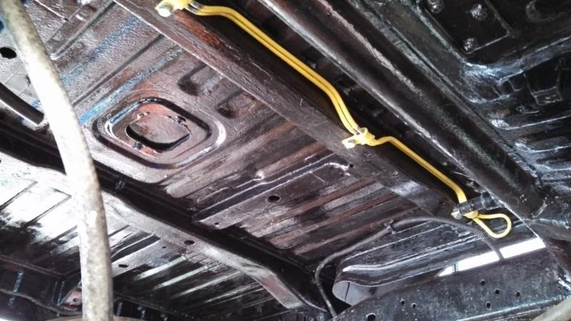

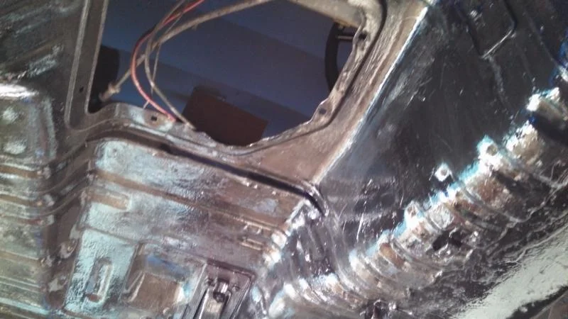

new camera is working, lets see if I can post pics of the underbody
pic 3 and 4 is looking back to under cargo area, where gas tank will go.
Yellow line is the EVAP loop tube - like I said, needed some color where the Sun
doesn't shine.
pic 5 is looking up into cabin thru shifter hole
Got that EVAP line in, and new EVAP hoses installed along with new fill tube hose.
Thus starts the reassembly process - FINALLY
dougbert

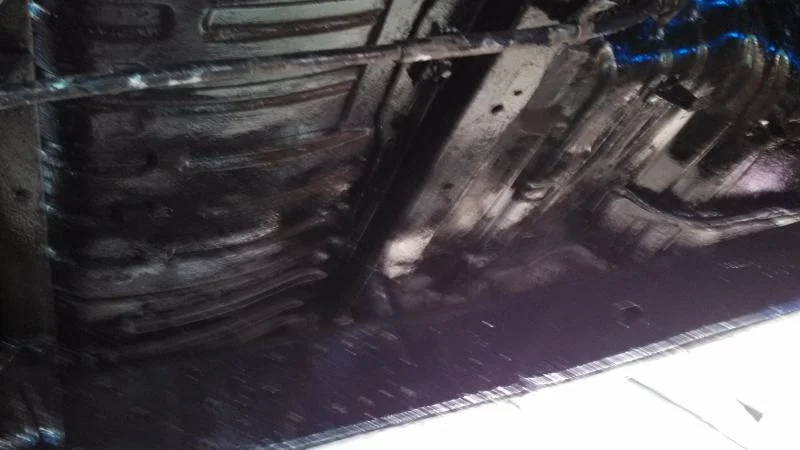

ok, last 2 pics
That looks awesome man, good work :D
thanks
let's hope it holds up well. At least is will be better than what was there.

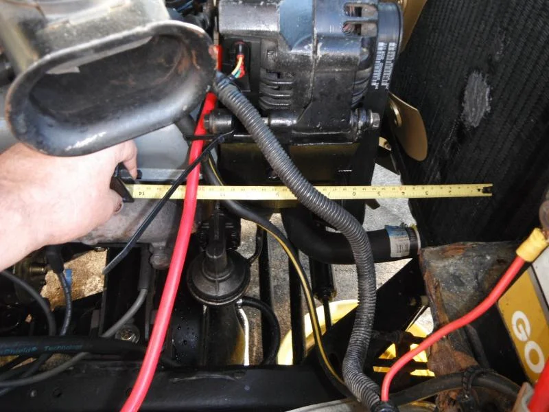

Okay just ordered 2nd Vortec head from Jegs and when that gets here the engine gets assembled - seriously. I have the major parts for the engine (not clutch parts yet) but I can put the motor together.
One item that is at a decision point is whether to go mechanical (many advise that) or go electric fan.
I am concerned about the distance between the Long Water pump I have and the radiator and if the Chev fan and clutch will fit.
below is a pic from JohninFla on his rig with the Ranger on this space. He has a serpentine belt system while I will be classic V belt system.
On my post #1 are links to the two options and also below:
FAN OPTIONS
Mechanical - BUT I don't know if there will be room after Ranger is installed
$113: fan clutch http://nostalgicac.com/gm-fan-clutch.html
$90: Seven bladed fan #790-2030 http://nostalgicac.com/gm-fan-blade-18-inch-steel.html
Electric
$114: Electric fan controller http://www.dakotadigital.com/index.c...rod/prd852.htm See Better price on EBAY
$101: Contour FAN http://www.amazon.com/Dorman-620-104.../dp/B000C17G9K
(FAN Install threads: https://forum.ih8mud.com/showpost.php...&postcount=103
https://forum.ih8mud.com/showpost.php...postcount=1426
https://forum.ih8mud.com/showpost.php...9&postcount=65)
$17: Pelican case for FAN Controller http://www.amazon.com/Pelican-1060-M.../dp/B001OF5TII
In the pic is the distance from the fuel pump (as a point of reference) to the radiator, John measures 11". I need to determine what space I will have. Will probably wait for final until AFTER engine is in the rig, but I am thinking about it now.
