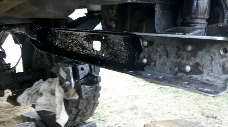

Spent some time this morning dodging snow flakes and working on the PS frame rail.
1st took off the gas tank evap line
2nd took off the gas line and the return line as a set.
Tried to clean off as much dirt and grease as possible, still more to remove. Original color of the lines is a green - didn't know that
then pulled the bolts for the rear brake line, but did not disconnect.
Found that I could pull it away far enough to get room to clean under it.
Then ground half the frame on the inside and then wire brushed it, followed by some Metal Blaster. Hope to start painting tomorrow
morning.
Pic below of the front inside of the rail, ground down to metal
Finished painting the PS frame rail, now to reinstall the fuel lines, etc.

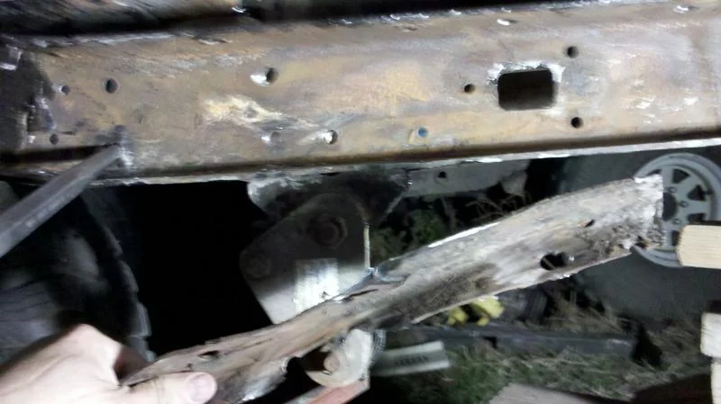

pulled the PS rear inner C channel - man, that is A LOT of work to do so.
air-hammer
drill (admittedly need new, sharper drills)
big hammer
chisel
and time
lots of rust
NEXT: DS rail

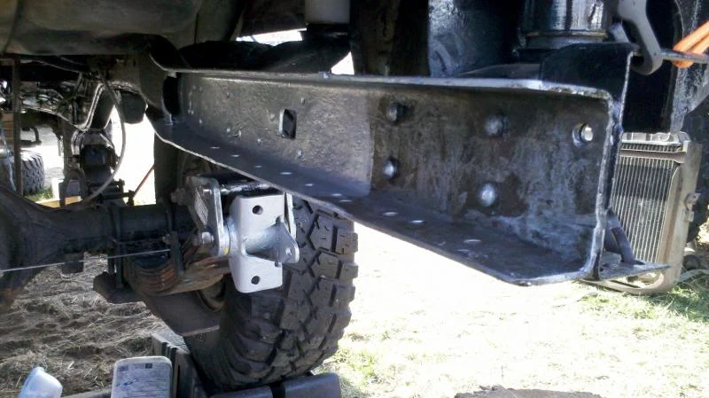

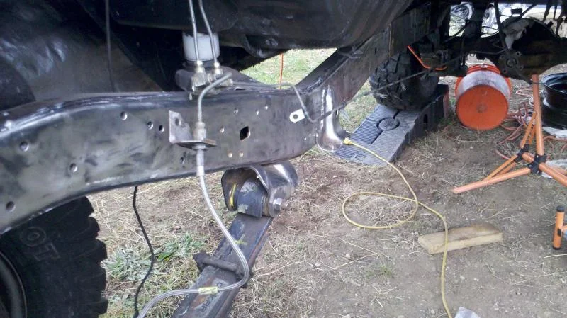

well spent 3 hrs this morning getting pins out of the shackle/frame bracket, cleaning out the rust and the like and finally painting most of the PS rear rail.
Note the shackle just hanging in mid-air - didn't know it would stay that way. Anyway, 1st coat of RustBullet applied on surface and into cracks. 2nd coat tonight, and black tomorrow. Then will then bolt the body mount and the shackle back to the frame rail with grade 8 bolts. Later we will weld the nuts to the frame, and then 'box' the C channel with a reverse C channel and weld those together. That will allow for bolt removal from fixed nuts inside the box.
Once I bolt down the #5 body mount, I will remove the #6 body mount, de-rust it and paint the tail part of the rail as well. Then move to the DS and repeat the whole operatoin once more. But the frame will be clean of rust (on the outside at least)
I have spent several posts on this because it was (and will be for the DS) difficult.
As pointed out above, I found that a couple of titanium drill bits really cut nice holes quickly, and with that hole help collapse the pins more easily. A good punch and good hammer work it well.
I found the bottom of the C channel to have "much" rust pits along it length. Hopefully, this work I am doing will increase the life of the frame.
Also began the re-install of the fuel lines. After cleanup, I found them to be painted a green color, so I re-applied some more green to the lines. You can see them in the first pic, on the left along the rail

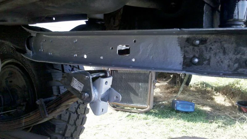

Final black coat on the rail
big difference from its original state of rust

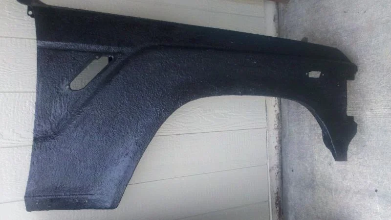

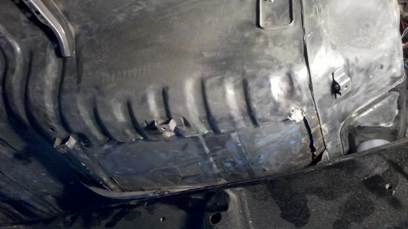

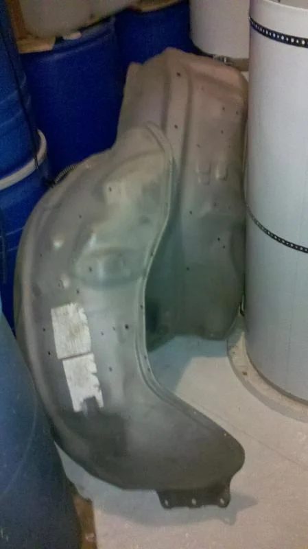

I had some warm sunny weather a week or so ago, so I cleaned up my two front fenders and the front cross sheet below the radiator area.
My truck came with Herculiner on the lower half of the truck so I have just continued with adding touch up to the places it falls off (Herculiner is notorious for such "fall off").
Since the fenders are off for the engine rebuild and body restore, I cleaned them up (ZEP cleanser) and wire brushed up the rusty parts of the fenders (not very bad) and painted the inside of the fender with ZERO Rust then with some Rustolem Rust Gloss paint.
I painted the outside of the fender (over the Herculiner) with Rust Bullet Black shell.
I did mask off grounding points.
The fenders look so much better than before, with the scratches, faded paint and minor rust and just plain dirty.
Decided to do black engine compartment: the firewall (still need to clean and paint), wheel housings (waiting for sand blast), front radiator mount
plate (also waiting for sand blasting) and then these fenders.
Glossy black on the inside
Pic 1, driver's side
Pic 2, passenger side

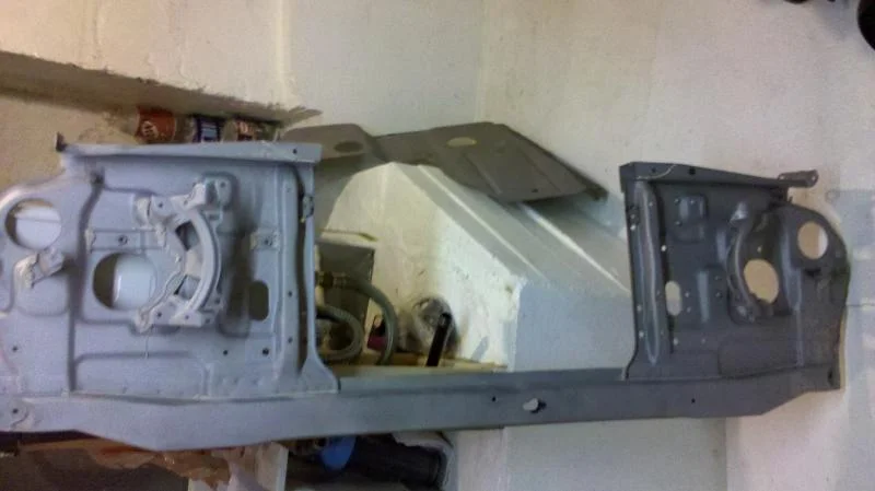

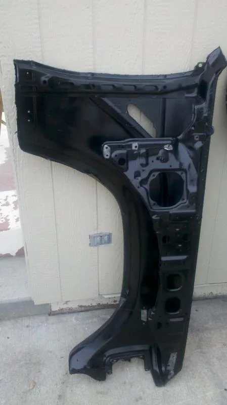

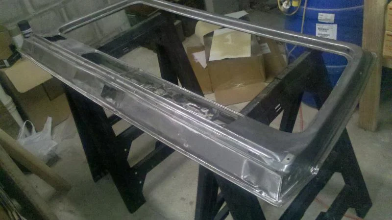

First item is the hatchback pictured below, stripped and ready for priming. Got this from a mudder in Kentucky

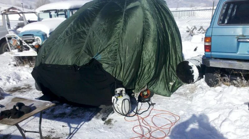

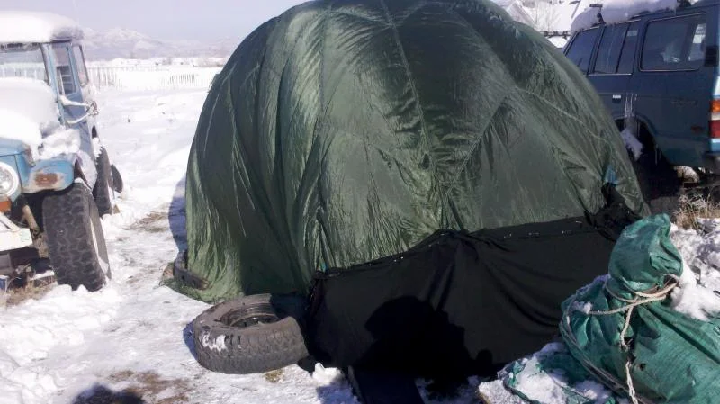

As displayed in the pics in this thread, my rig is OUTSIDE in a field at Jake's (uglyoinker) place and this past week received 8 inches of snow with the cold as well (-5).
Following Tom's advice (alaska60) of getting a parachute and draping it over the rig and heating it with a propane forced air fan, I went ahead and did it.
I got a 24' chute, but wish I had gotten the 33' or so, because I had to connect some polyester material to it with safety pins, in order to bridge the big gap on the front.
Tom's rig was a FJ-40 and mine is a longer FJ-60 and mine is on 6 inches of ramp lift under the tires.
So I fired it up this morning and the chute bellowed out fine and in 15 minutes raised the temps. Therefore, this saturday I can spend a few hours underneath the rig, cleaning the bottom of the body in prep for painting it - and it will be warm enough to do so. Both cleaning AND painting.
and yes I will have a CO monitor in there as well
Pic 1 - you can see the propane heater behind the DS front tire. Also the black ployester sheet clipped to the chute in the front.
Pic 2 - PS side view. See the "puffy" chute?
it really works!
dougbert

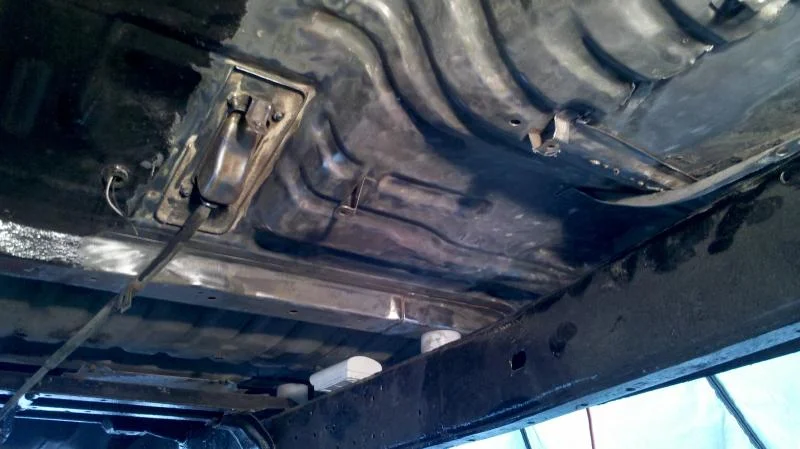

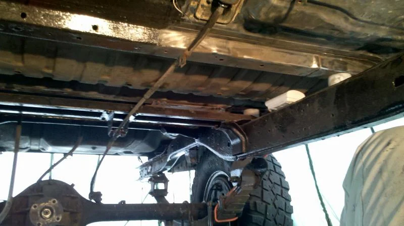

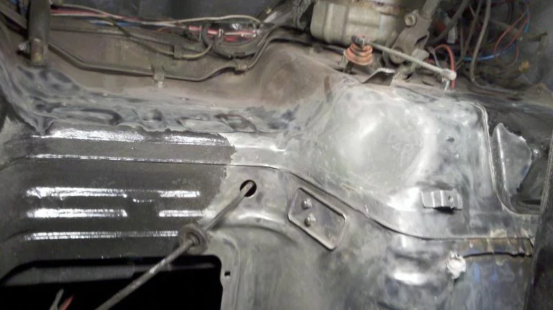

pic 1: looking up from the ground up to the DS foot well. Painted floor on the left, cleaned on the right. Firewall on top (you can see the brake booster from the bottom on the upper right) - yet to be cleaned. I will probably just cleanse the rest of the firewall later with PEP 205 and not brush it off. Then paint it.
pic 2: foot well of DS. A couple of years ago, I had a body shop fix the "holely" floor since it was very rusted due to raingutter leaking. You can see the cut out section. I want to seal that up better and then do the Rust Bullet cover.
pics 3 & 4: shots of the DS under body working my way toward the rear.
Pic 4 shows the dirt/grease yet to be done. Never have done such body work before. Yet another skill set being developed in an old guy.
definitely can see the difference between painted areas, cleaned areas and ares YET to be cleaned. I think it is looking better

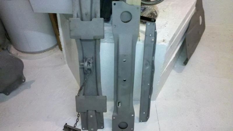

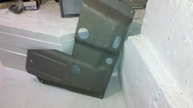

Below are pics of my early Christmas presents to myself - the sand blaster finished with my job:
2 Front wheel wells. I think I will use Zero Rust as a DTM primer and then the Rust Bullet Shell Black for a top coat or two. Notice the "engine plumbing charts" still on the fender. I need to wire brush those off, as that Engine is long gone.
Front end Left and Right Radiator Holders still connected to the bottom radiator holder, again Zero Rust as primer and Rust bullet Shell Black for top coat
Bottom Skid plate - Will use All Rust bullet on this one
Last Pic: Spare tire holder and chain (left in pic), with the Tranny Mount (center), both will have All Rust Bullet applied, and then the Center/Top Radiator support (right) with Zero Rust and Rust Bullet Black shell.
So they ALL will be shiny black when done. The whole engine area will be black, as well as the underbody.
