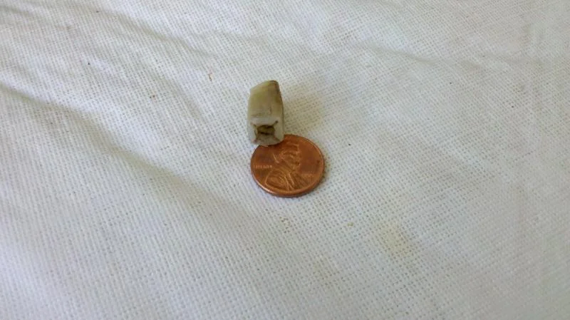

I have been painting under the body, as per above, and found I need to replace the bolt anchors around the shifting hole in the tranny hump. They are very brittle and some missing. These go in the small holes in post #138, last picture
Pics below of this square anchor, which I believe is 4 or 6 mm bolt receiver.
Anyone have a source for this, or the proper name and/or part number, etc?
I have search here and on the web, but I think I am using the wrong name for it

FOUND SOMETHING that might work for the shifter hump rubber hold down:
I think I found the proper name of the anchor should be 'grommets' and found some at clipsandfasteners
http://www.clipsandfasteners.com/Se...ota+#6+screw+gromet+9mm&Search.x=0&Search.y=0
they are called Screw Grommets
I measured mine to be 9.2 mm square.
A M6 bolt was too big
Don't know the length, will measure some still in the truck with some micro-calipers and get the bolt/screw size.

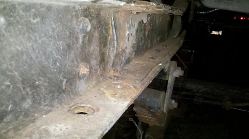

Now have access to the very ugly C channels - filled with rust and BULGING between the C channels - argh! :bang:
more grinding, drilling, tapping and use of harsh words
Steps I found to work:
grind off the bottom part of the pin/rivots
drill hole into center of the remaining pin
start with small drill, work through 4 or so drills, increasing the size.
drill about 1/2 up the pin
big hammer and a flat punch,
bang it several times,
as needed use a screwdriver to push the outer pin flanges into the center.
If not moving, drill the hole some more and bang it again and again,
pin pops out, move on to the next one

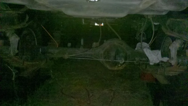

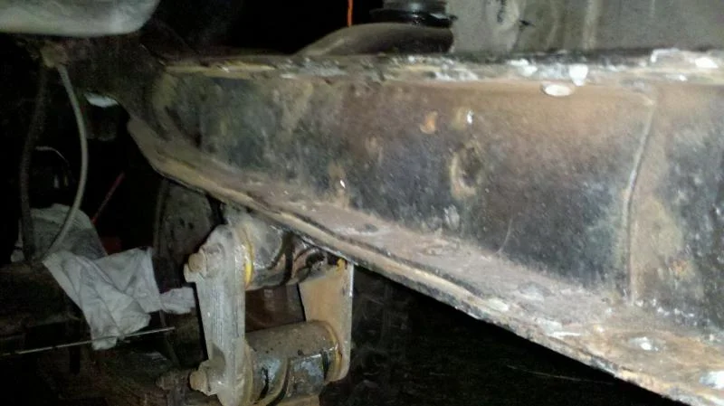

Pic 1 of DS C Channel, lots of rust growth between the channels
Pic 2 of PS C Channel ditto
Pic 3 of rust ugly rear diff that needs some good buffing
