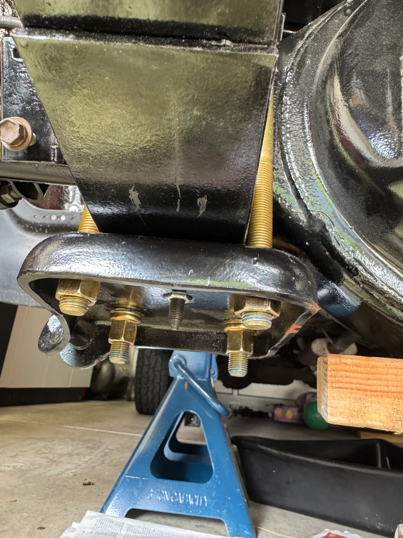

Some RTH needed. How critical is the exposed thread length at the front u-bolts? The service manual says to tighten to 90 ft lbs, ensuring the exposed length of the u-bolts is consistent. I understand mine will likely be longer at the back as I have caster shims installed, but they’re longer at back vs the front by more than the shim thickness. Is there some rocket science here, or is it snug to 90lbs and call it a day?
At least it looks like my exposed threads are even left to right.

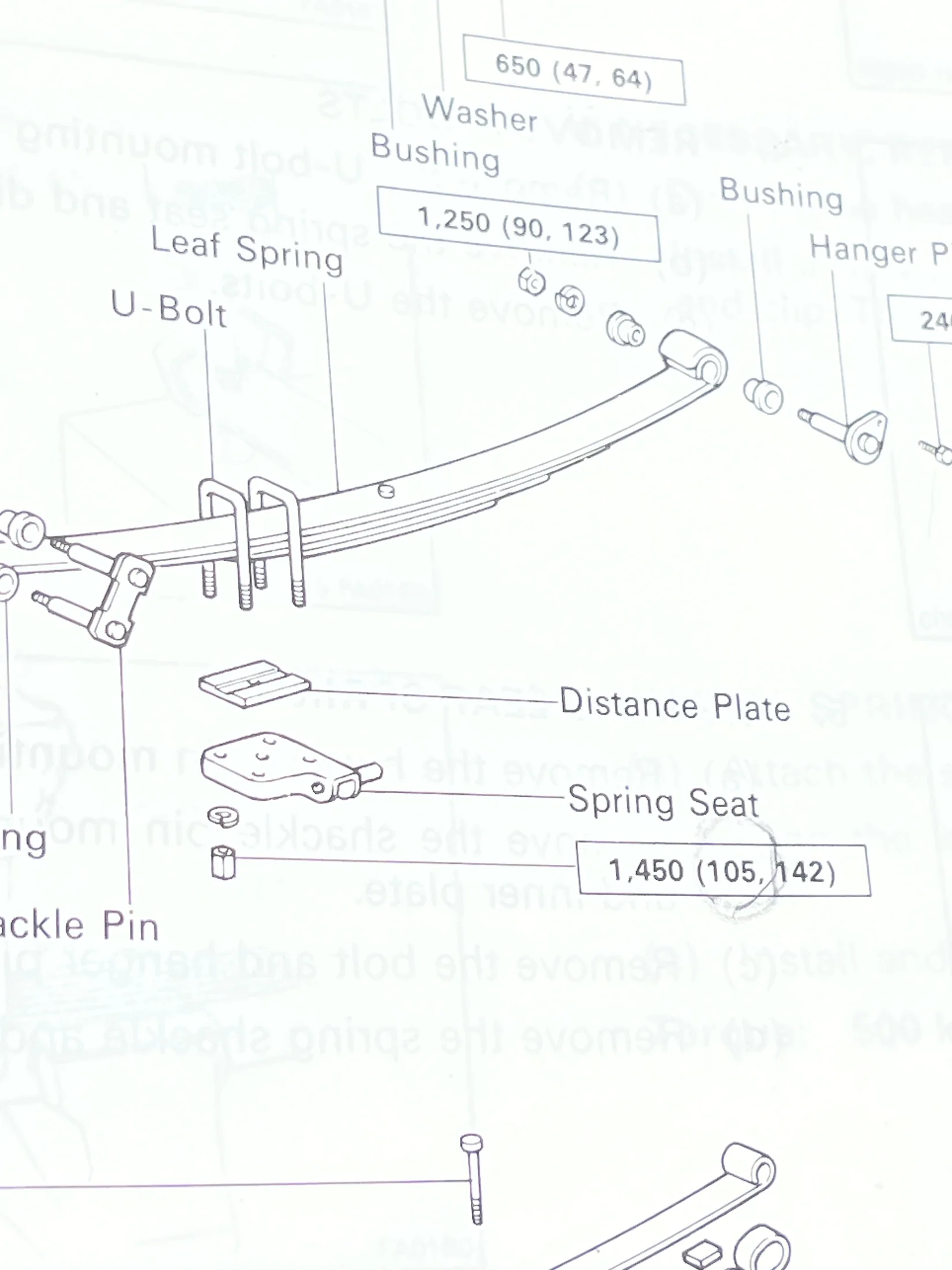

90ft lbs is only relevant for the original leaf spring pack and original u bolts. That torque ensures the nut will bottom out due to no more threads on the u bolt - and click off the wrench.
Trying to torque the u bolt nuts on any other thickness of spring pack or different u bolts to 90 ft lbs will spell disaster — way too high of torque setting. You’ll never get there.
Here’s what happens when you keep on trying to torque at 90 ft lbs with aftermarket u bolts.

I'll third the 4Plus u-bolt flip kit torque here. Running 90ft-lb with no problem getting there or maintaining that level. For stock the torque spec has several factors, including the metal channel that holds the rubber isolator. Once you go to aftermarket spring packs and remove the isolator stuff, all of the factors that went into informing that torque value choice are out the window.
I’m perplexed. The spec for the 62 is 105 and I didn’t have any issue getting that with the Dobinsons u bolts or the 4+ flip kit. Dobinsons said “use the factory torque”, so I did.
From what I can gather, it works with the 4+ flip kit, but not the factory spring seats. I definitely felt like things were not going well when I was tightening my u-bolts. I hope I didn't go too tight, but since nothing is bent and I never got to 90 lbs I'm thinking things are okay.
