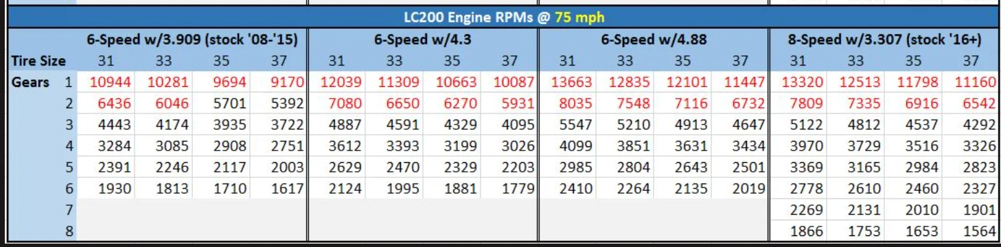

Freeway MPG efficiency with trailer in tow - this is an interesting area as it wasn't necessarily an improvement. Previously, with 3.9s and 33s, for my rig and its weight and aero, the preferred cruise gear was 4th, putting me at ~2500 rpm at ~65mph. Note with 33 tires, 4th works out to be about an ideal 4.5 gear. This worked great with enough margin to lockup the torque converter, and still handle slight grades and wind. With the re-gear at 65mph, it puts things a bit too high and too low. 4th is now too high at 3k rpm with more gearing (windage losses) than I need to cruise. 5th is barely workable and will just lockup the torque converter on flats, with RPM a bit low at ~2150 rpm. So while pulling on hills improved, cruise is now a bit more inefficient with ~.5mpg loss.
To help others analyze how this plays out. Those of us with 6-speeds don't have as fine selection with the in-between gears so it's a big rpm jump between usable gears. A .5MPG decrease is what I saw re-gearing with 33s. Reason is I find that the optimal towing RPM to be about 2600 for my aero profile and load at 65mph. For those that tow a lot, this may be how to assess where you want to be, at least for hauling MPG.
As from my earlier post, I got the best MPG with
- (1) stock gearing with 33s. This 2673 RPM @65 was great as it kept the torque converter locked, while having torque reserves for some minor wind and hills, and kept excess RPM down.
- (2) My experience going to 4.3s with 33s was as I quoted above. Excess RPM @2941 for the same 65mph, meaning windage losses while keeping excess power reserve in gear. Losing about .5MPG vs (1).
- (3) Now that I have 35s with 4.3s, I have 100 more RPM to turn bigger tires, but relatively the same as (1), so I'm probably spitting distance in MPG minus minor losses hauling around the bigger 35s.
So a way to look at this for heavy towing usage is to find combos that put you around 2600rpm @65mph as a first approximation. Again, I'm stock aero, 1" lift, 35x12.5s. If you have bumpers, add ~100rpm to your target rpm. Roof rack, add another ~100rpm. That sort of thing. Try the different gears in your towing setup now to come up with a sense of where you think the car wants to be in RPM when laden, to cross check the optimal gearing (for efficiency).
@linuxgod the orange is where you'll roughly land with your 4.88 setup. If you towed in 4th gear prior with stock gearing and 34s, that was probably around 2600rpm as a reference. It'll be interesting if you can grab 5th with the new setup. Though I know you also tend to keep a higher speed so 5th gearing may work out per the 75MPH table below and you have a chance at sitting pretty.

Yeah I used to run about 3000 RPMs in 4th at 75mph. Stock gearing would've been about 3300. On 34s it'll be about 3700 which is probably too high, so I will try 5th and see how the transmission temps and gas mileage goes. As @grinchy points out, 37s are the right size for towing with 4.88s with the 6 speed, but I can't imagine trying to fit them :-)

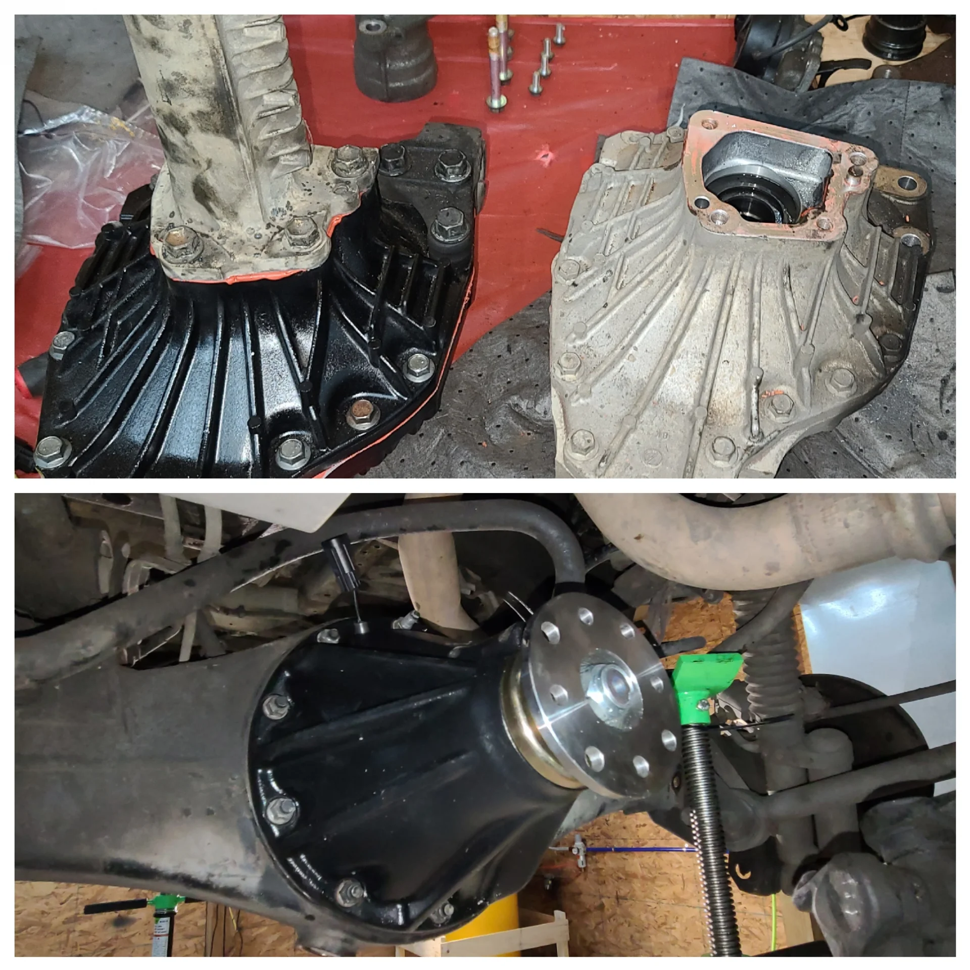

Just wanted to chime in here. I swapped a 4.30 gear set with harrops into my 16'. It feels incredible. I recommend anyone who has a 16 and up with 33s or larger to try the 4.30s. Its like the truck has 100 more horse power.
02' LX470 4.30 rear
4.30 Tundra front

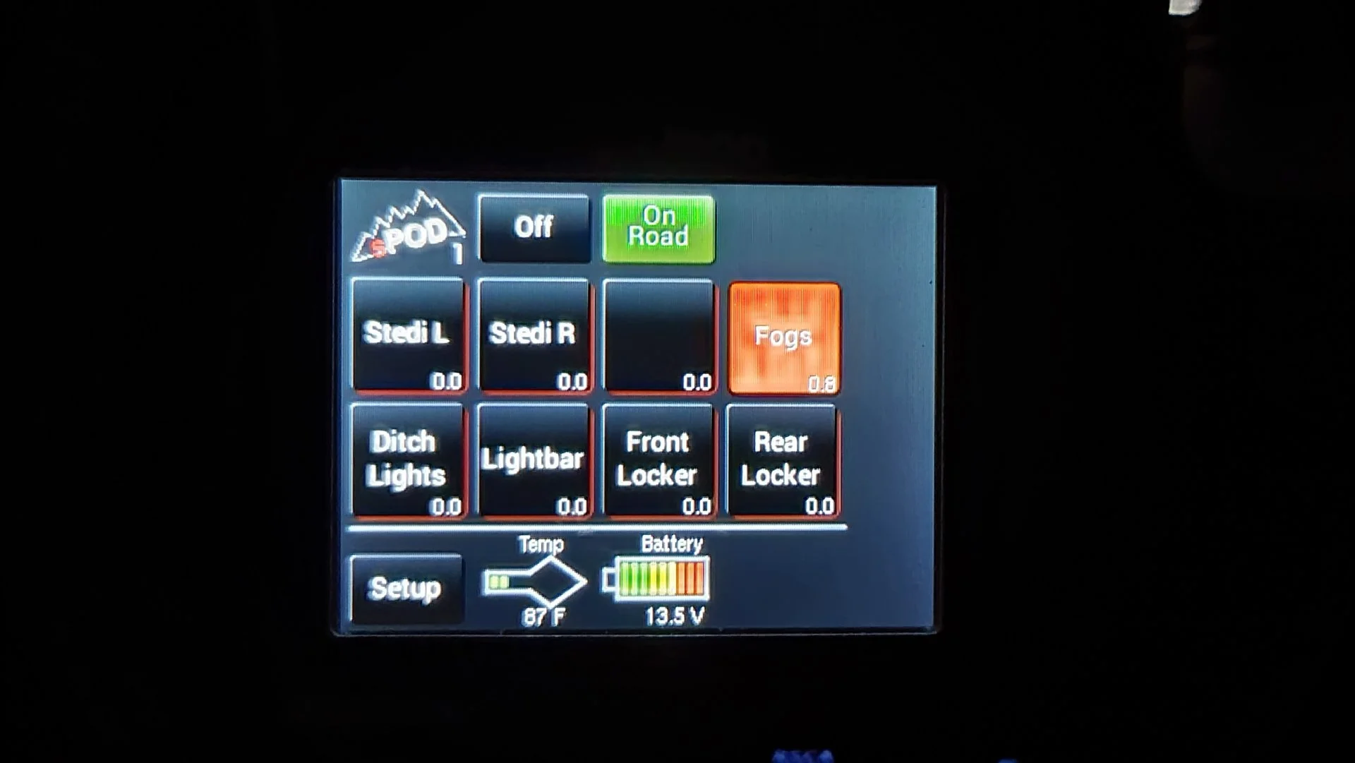

Im powering the lockers through my bantam X.

Sorry for the dumb question, but if someone was okay with keeping open diffs, they could just install the tundra 4.30 front and 100 series 4.30 third and be good? So no special tools required? I'd like to move up to 35s on my LX and would like to re-gear as cost efficiently as possible and might even consider a lunchbox locker.
Ayup!
That's exactly what I did. If you can find a 99 third member, there are some woth a factory locker. The electronic actuator wouldn't clear the cruiser sway bar, but it may clear the lexus, since you don't have KDSS.
