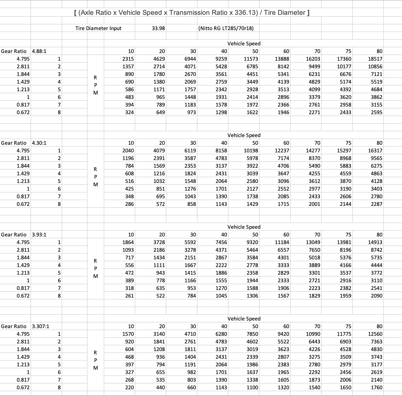

If anyone is curious about the gearing range and RPM range for the 8-speed, I've got a sheet I'd be more than happy to share. Just adjust tire diameter, and it will show RPM based on gearing and vehicle speed.

No worries. If you send me the gear ratios for your transmission options, I can build it out pretty quick.
So… @TeCKis300 … what would that chart of RPM’s look like with 4.88’s and 40’s 🤔

Looks like maybe 1853rpm at 75mph on 40’s with my questionable math skills. Sounds perfectly doable.

Expanded this table to cover 40s. Hopefully I didn't fat finger anything. 4.88s will still easily cover 40s with better than stock gearing.
I seem to be missing my RPM table. Hand jamming, as we know 4.88s with 40s in 6th gear is still 102.1% better gearing than stock. Stock rpm @ 75mph is 1930RPM.
102.1% * 1930RPM = ~1970 RPM @75MPH
You'll be sitting pretty with as light as your setup is.
