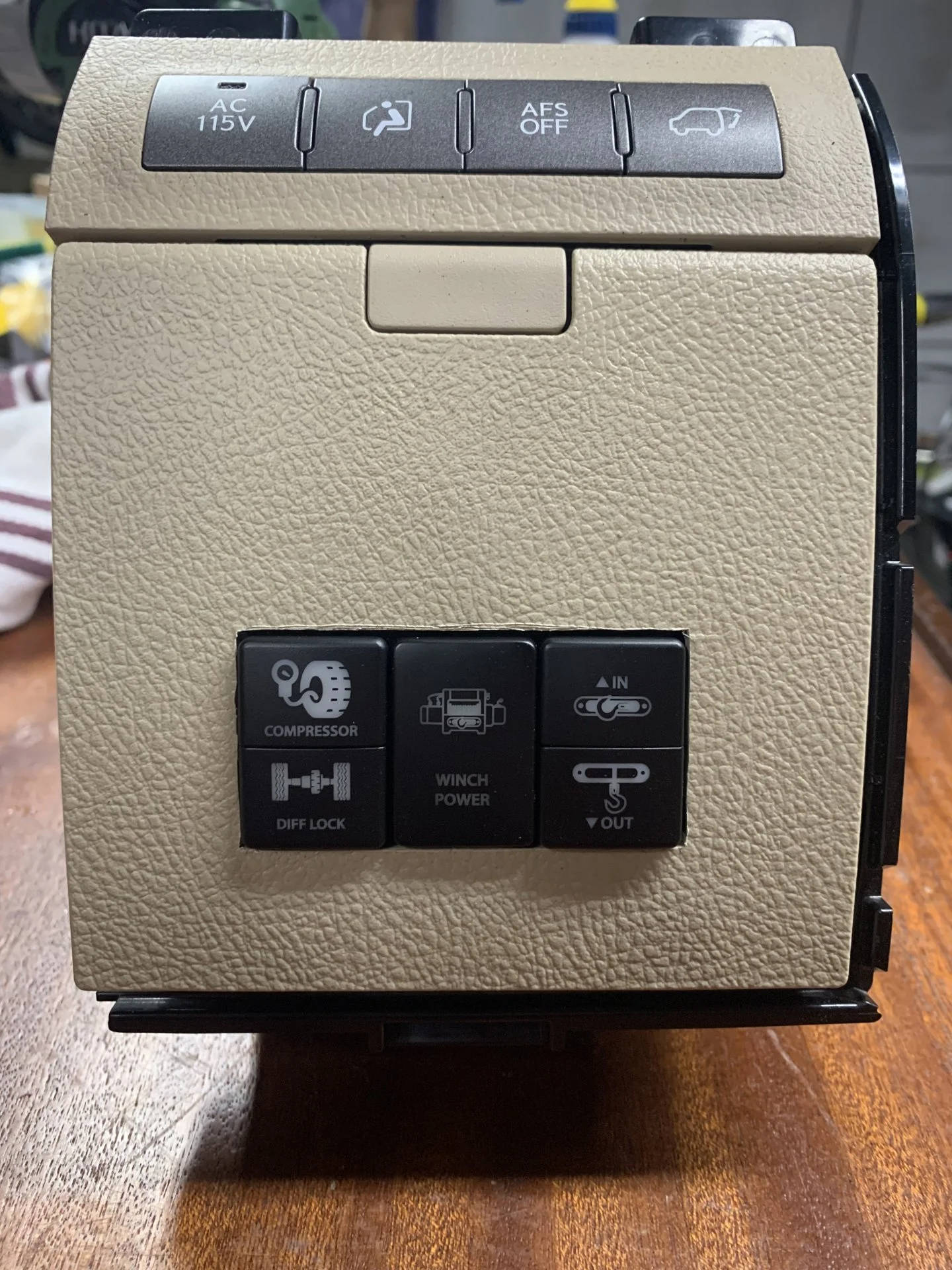

Got my 4.30s in and the locker wired up. What is the preferred method to confirm that the locker is locked?
Burnout on dry pavement?
Just kidding of course 😝
I considered putting an led somewhere when I was switching it via Bluetooth. The aftermarket radar detector PO put on my truck has blue led installed facing up below the tach and Speedo to flash the radar detector codes and alerts. It’s surprisingly well done and would be easy to replicate for this use.
Eventually I just got a light up switch and installed that.
Other than a potential light on a switch confirming power to the locker... which doesn't guarantee the locker has physically engaged yet.
The only real way to know it is engaged is to do some turns. Should notice distinct complaint from the tires that they are scrubbing with no differential action.
This was what I thought I’d need to do but was curious if anyone had a better way. I ended up using the Eaton switch and it’s lighting up when engaged but otherwise no indication that it’s locked. Guess I’m off to do some donuts
