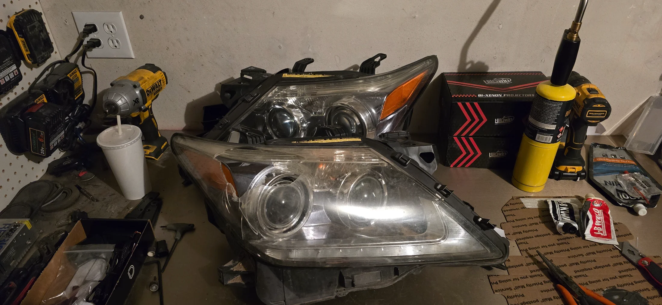

You can replace the outer lenses with aftermarkets. They will not be as good as oem but for the price, it's a great DIY option. I would recommend having PPF applied for the UV protection aspect once new lens is on. It's not a super easy process for the average Joe, but any DIYer should be able to hike up their big boy pants and pit the headlight in the oven to get it opened up and a new lens installed. I've done hundreds of headlights over the last 9 years. This setup is getting new lenses while they're open for customization.
I had not considered just replacing the outer lens. So the oven must loosen the adhesive to remove the broken lens,, do the aftermarket lenses come with adhesive. I'm starting to think about going this route vs full replacement. Many thanks for sharing..
No they do not come with new sealant. No need to remove the old stuff, just smooth it out when hot and add a new bead on top. My preferred sealant is diode dynamics butyl rubber.
