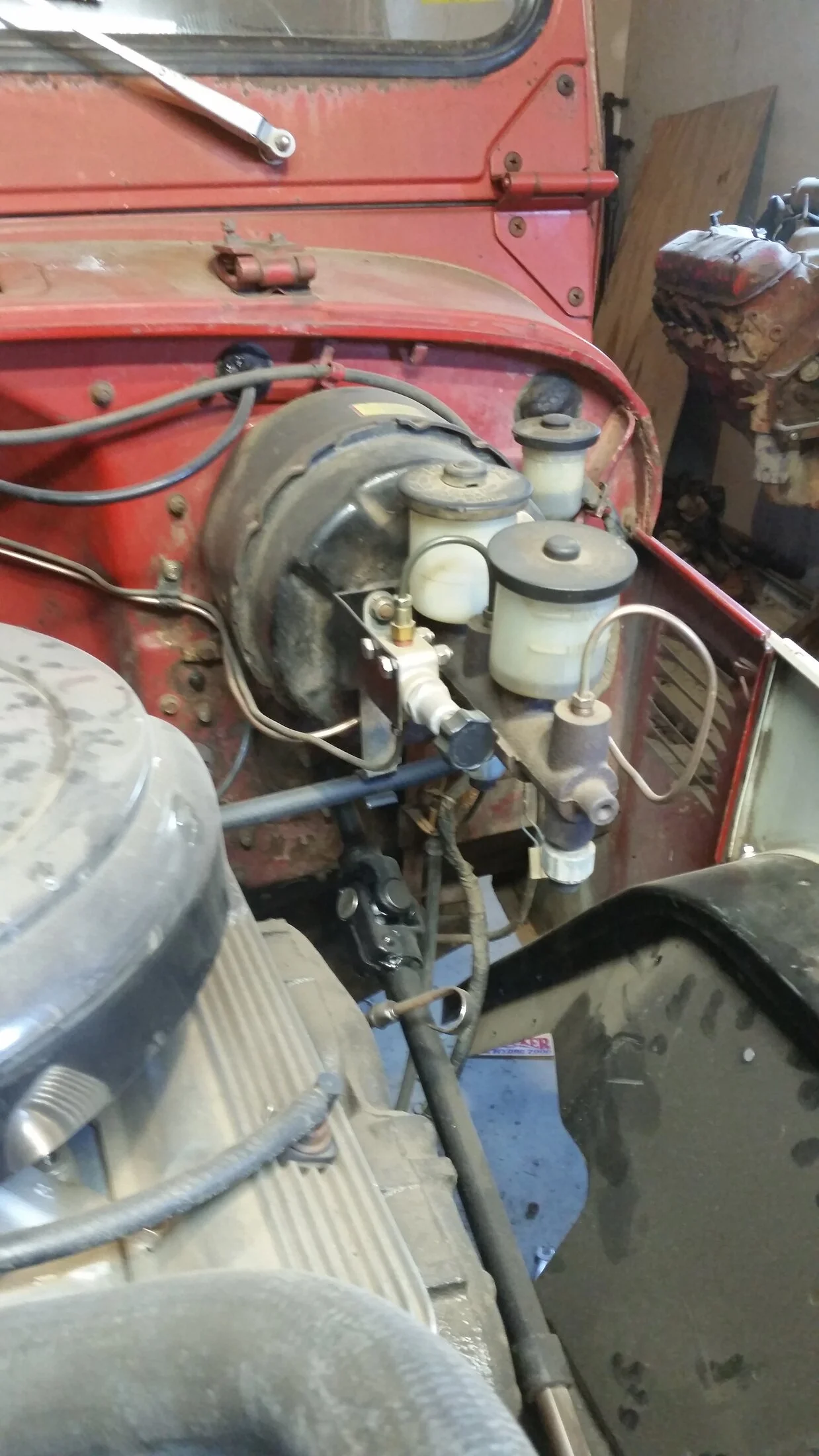

I run an aftermarket adjustable on both my 40's. I set it and forget it. Without it the rear brakes are overpowering, and will lock up easily.
Here you go. It's a 75 with frt disc too

On my 1st 40 decades ago, I think I used the wilwood valve and it worked great. On the red 40 in the pic, I used the summit version and cranked it all the way and it isn't as effective. I also need to rebuild my master and bleed the brakes better that might be contributing to the bias. I should know the results of master in a week or two. My 1st 40 the braking is even which I prefer. I don't want my frts to lock up 1st.
