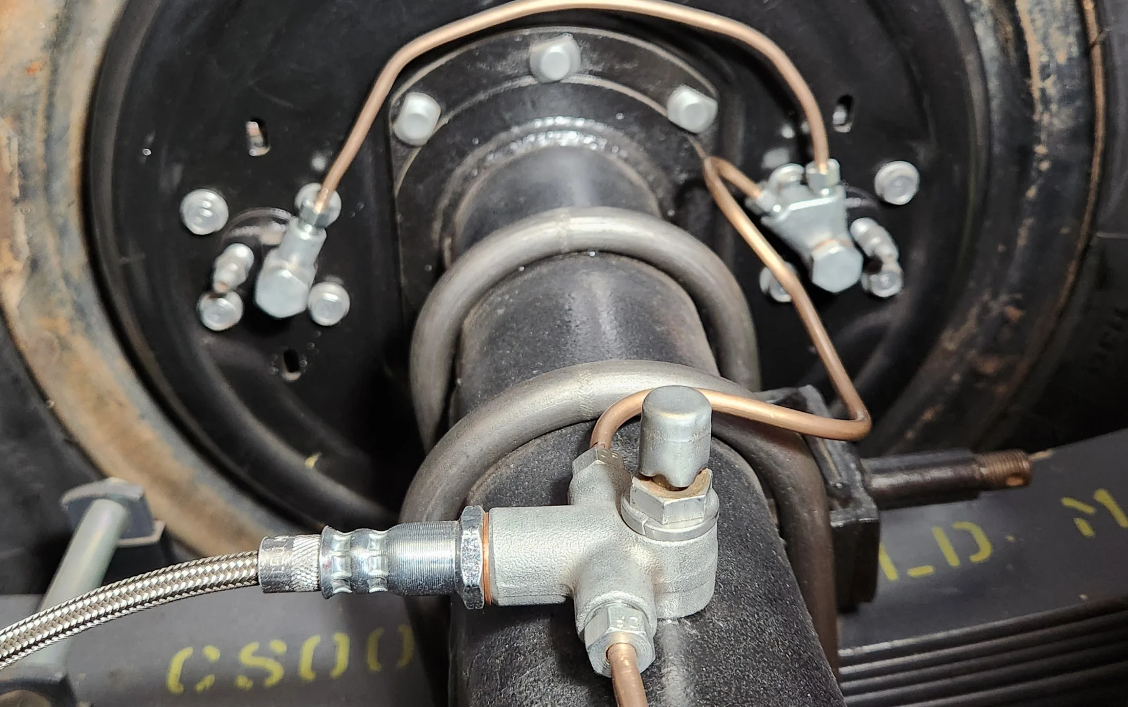

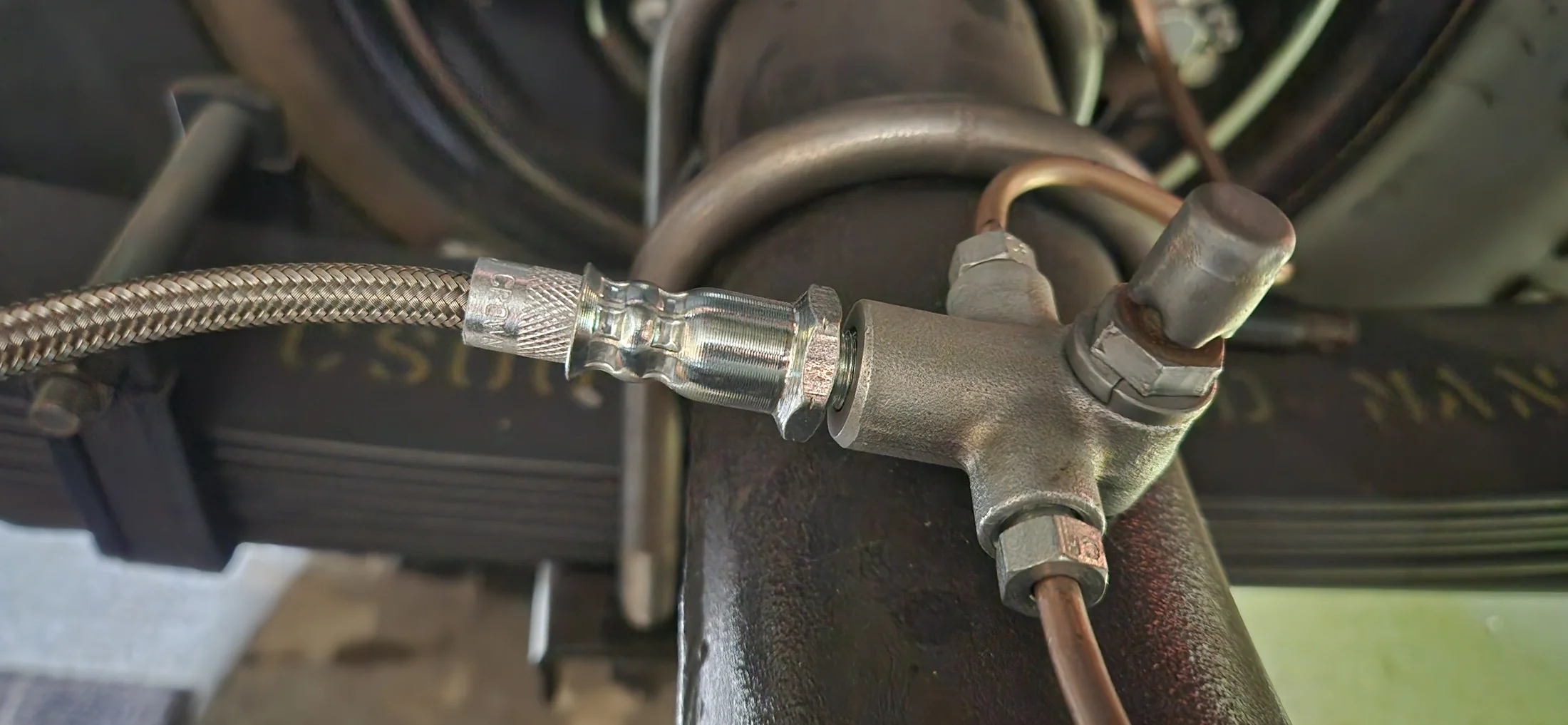

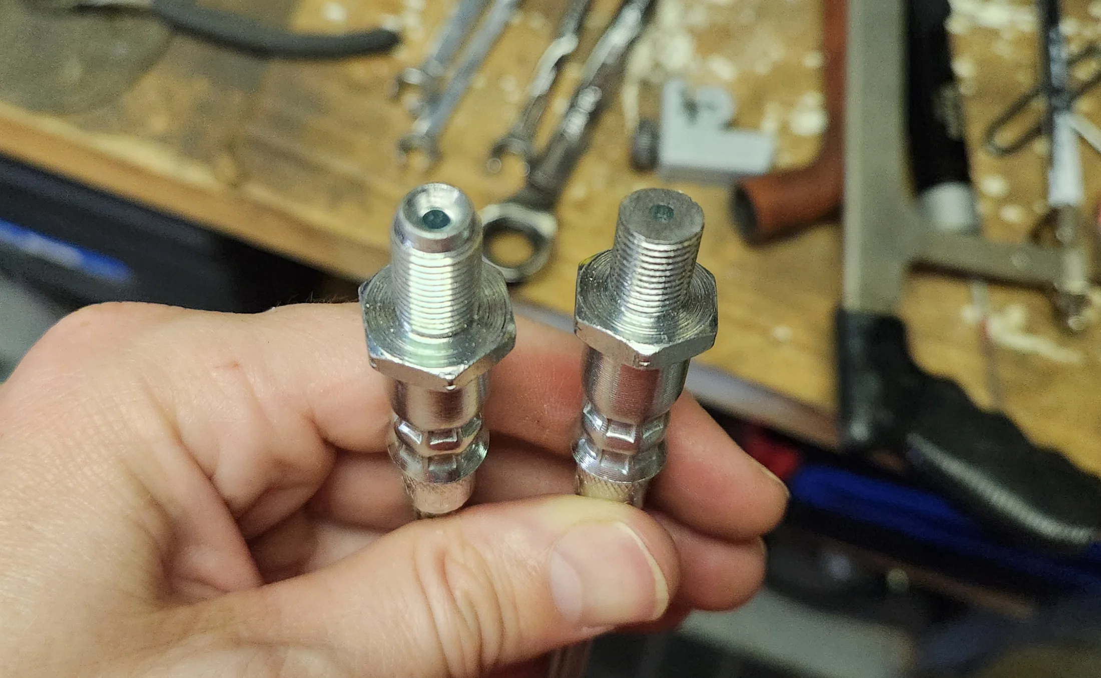

I picked up a set of hoses to fit these 10mm fittings but the male threaded ends bottom out before the shoulder makes contact with the T unions. Curious if anyone has an idea to salvage this before I order something else. It looks to me like these just won't work. The copper washer is not on in the photo, but even with it installed there is a gap. I thought about installing a spacer and second copper washer, but that just adds a place where a leak could occur. Trustworthy brakes seem pretty high on the importance list.:)
yep, you probably got a hose intended for an inverted flare seal instead of a copper washer.

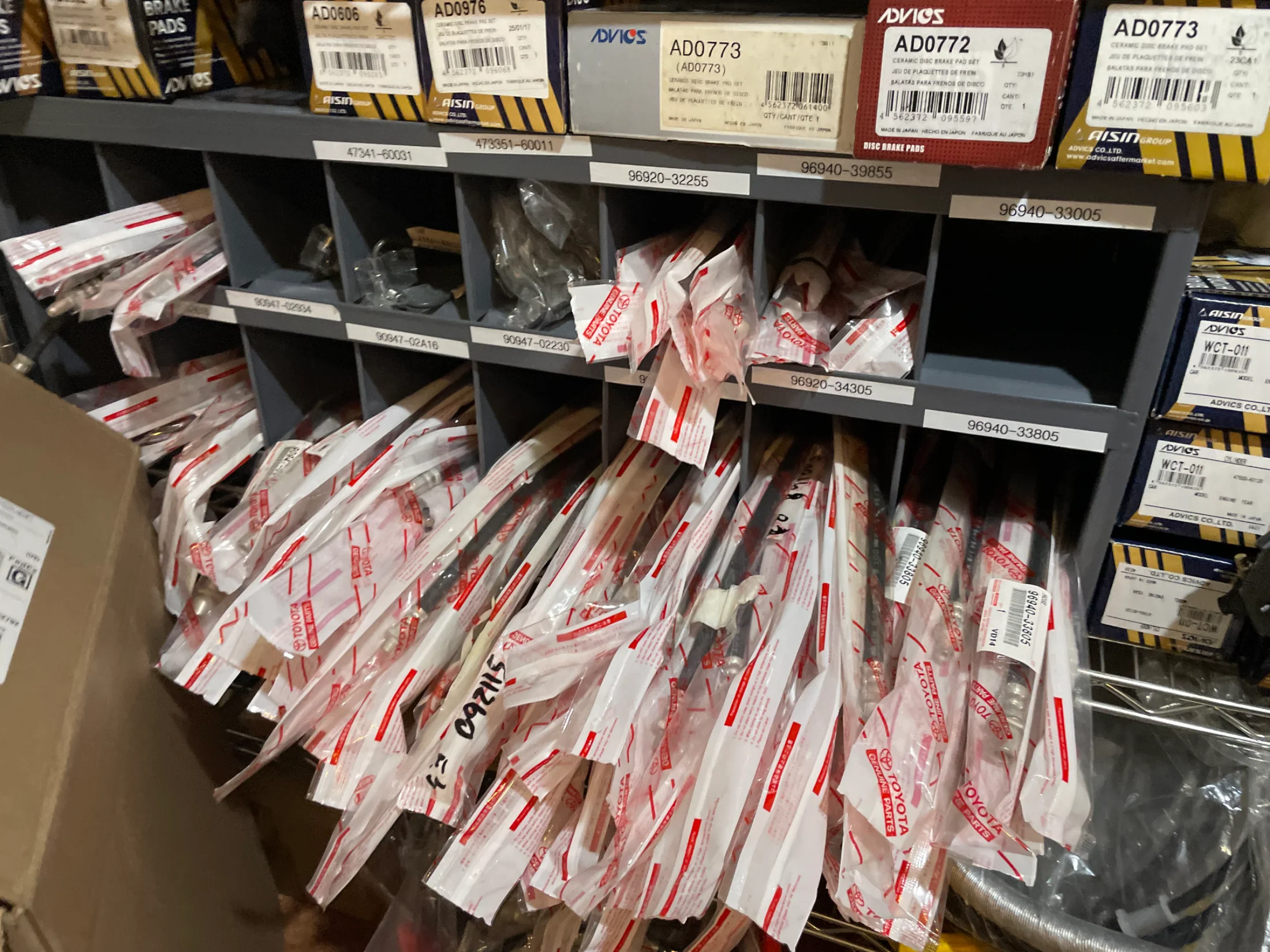

I have plenty of new OEM hoses in stock at very reasonable pricing if you want to replace it with the right stuff.

Pretty sure these are intended for a flare seal since they have a flared end. Is there a land cruiser that uses this setup? These were sold as FJ40 hoses.

You can most likely file the end of that hose to remove the flare and the use a copper washer.
I just cut the unthreaded part off the end and use a new crush washer.
I just had some made locally and I was told to cut the ends to the proper length.
I had this same thought but didn't want to test it on $100 worth of lines and ruin them. A hack saw and file would make quick work of this.
