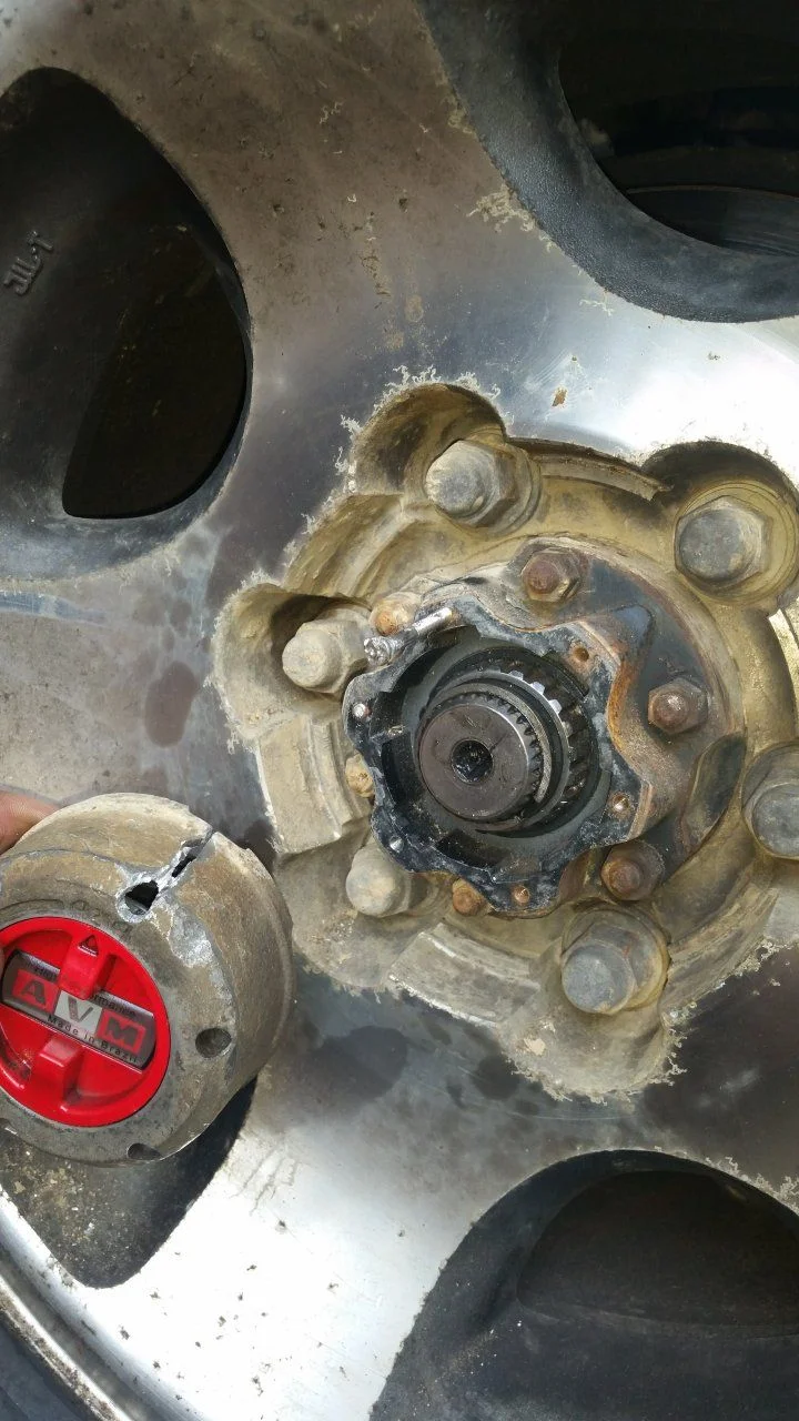

This afternoon I got busy swapping in a chromoly birf, but I ran into a little trouble removing the AVM locking hub. Two of the six little torq screws had seized and rounded out on me...one even managed to snap my torq fitting.
I decided to cut the Hub off...piece of junk. Finished the job and temporarily put my old drive flange on.

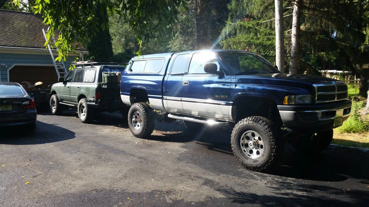

Now that my Ram is completely back on the road, and I have a 2nd 80 to drive...I can finally pull the 1FZ-FE out.
These are my other two rides

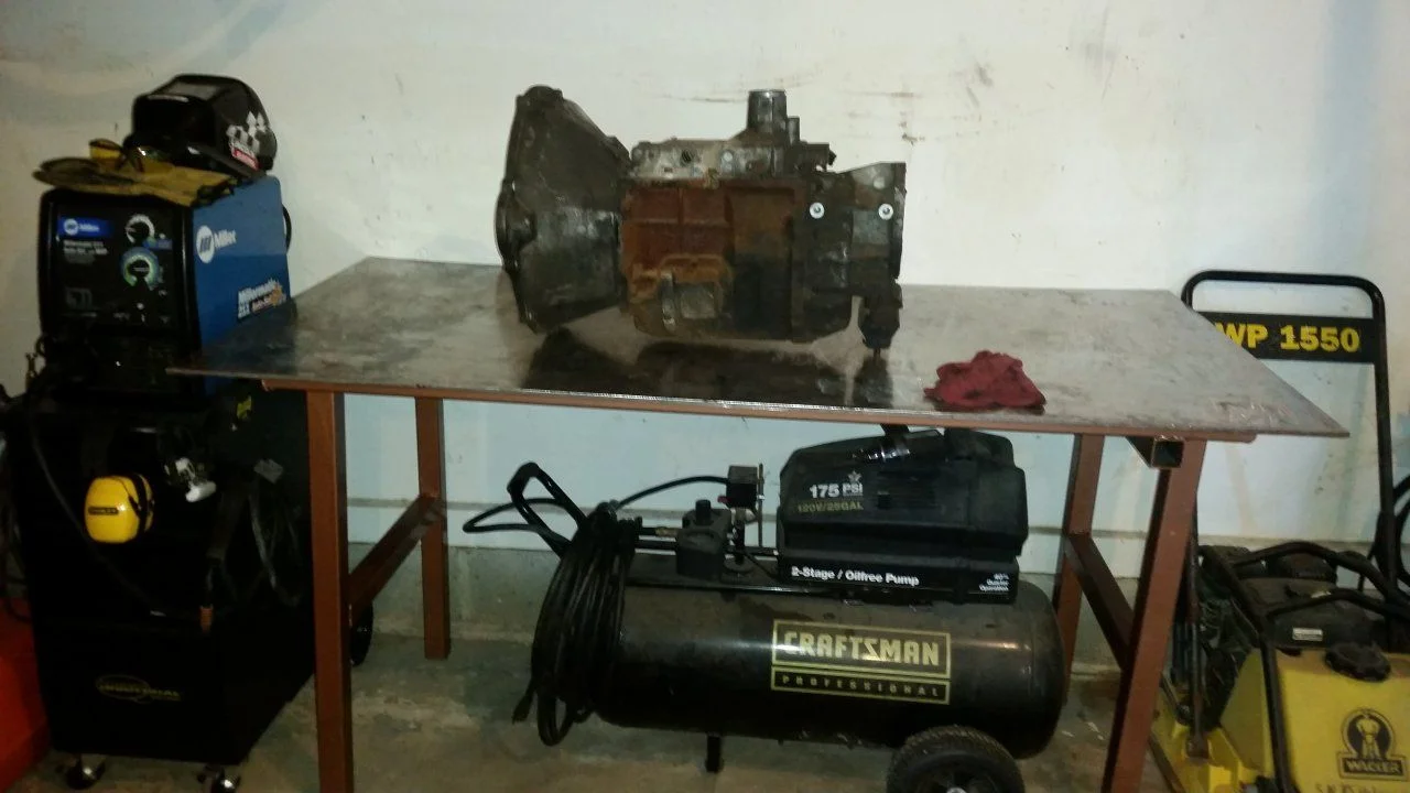

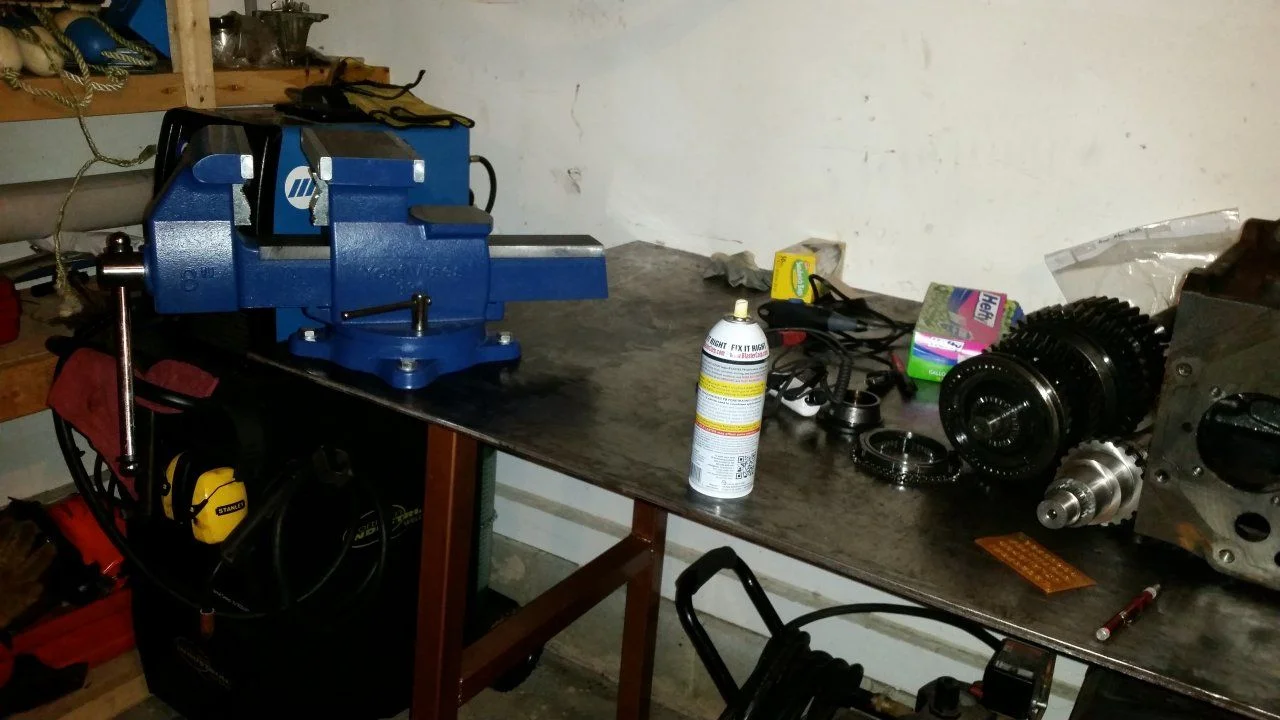

I was in need of a good solid work bench in my garage, so I knocked up a 6.5'X3.5' bench with a 3/8" thick plate top. That sicker is stupidly heavy.

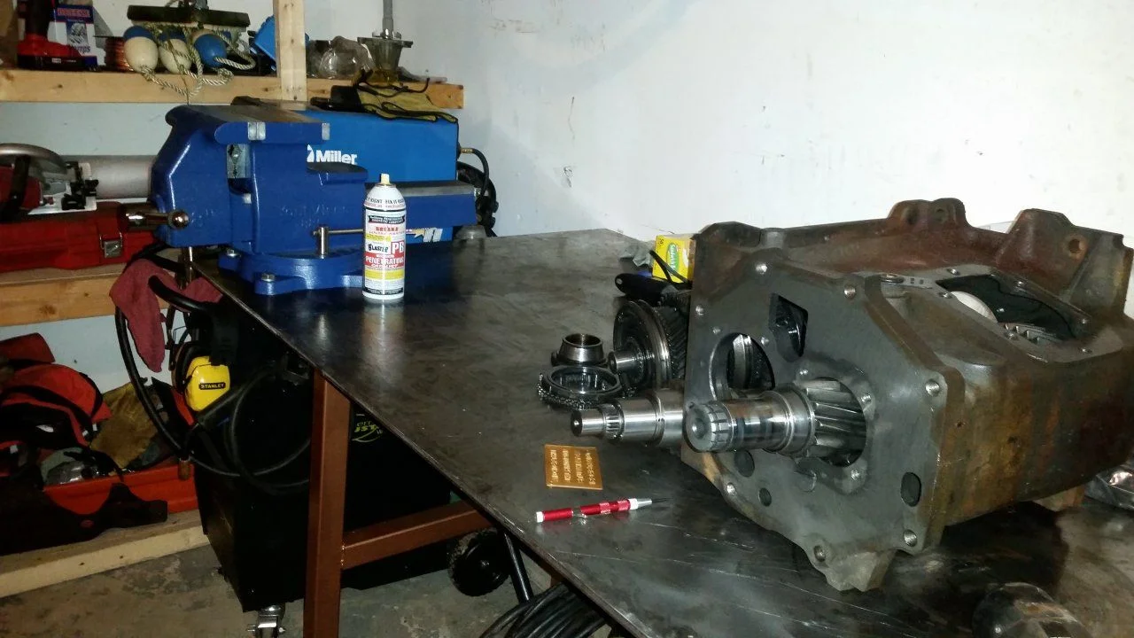

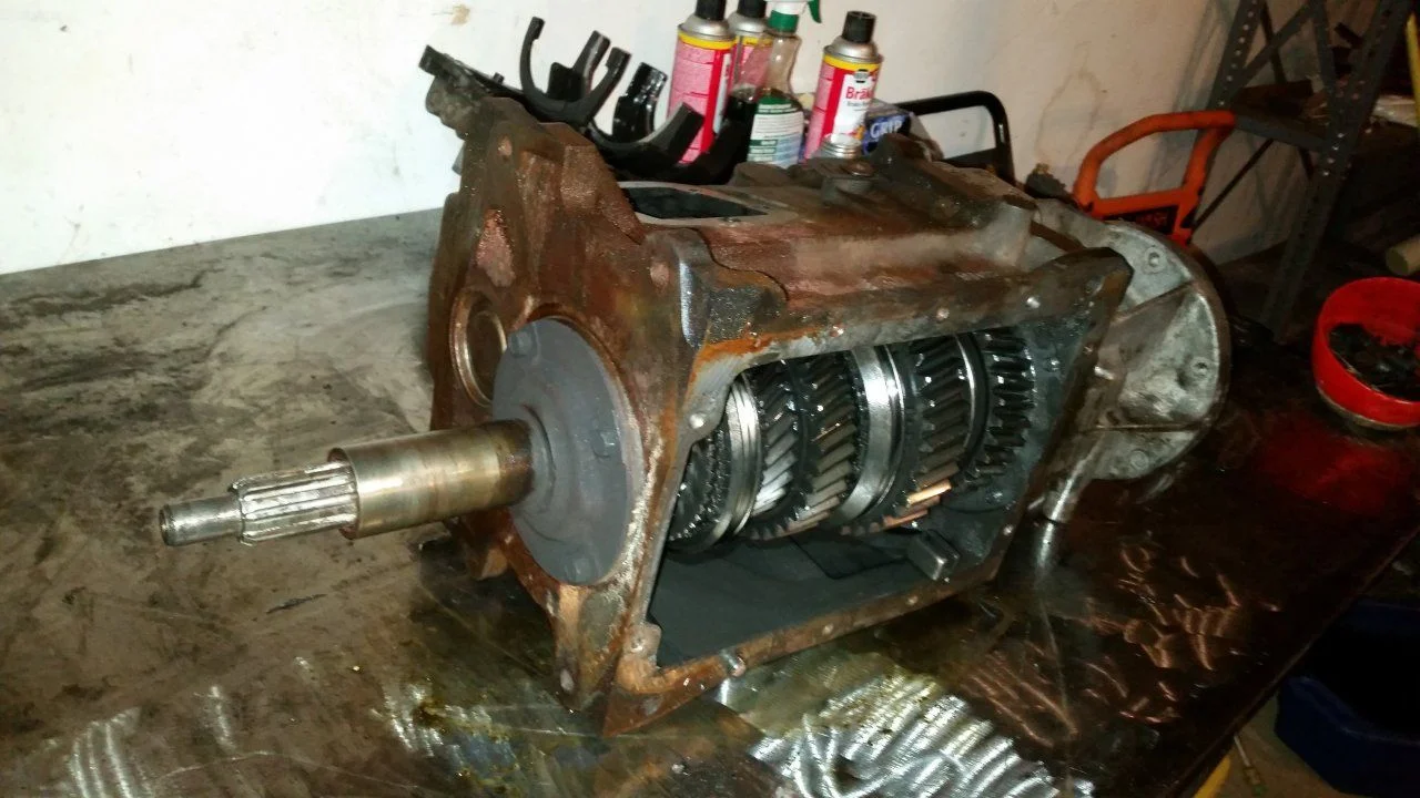

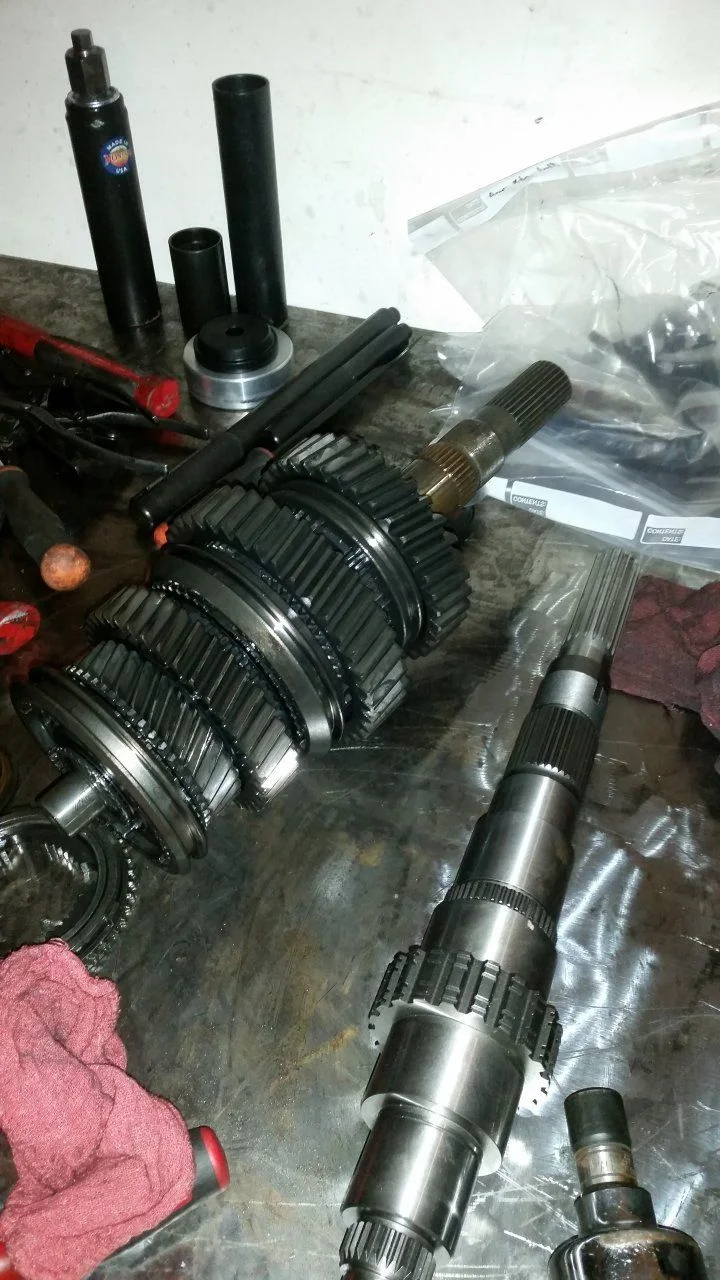

I then got busy tearing the NV4500 down. The reason for yhe tear down is replace the main shaft with the custom splined and cut main shaft that will adapt to the HF2AV. I am also upgrading the input shaft and retainer to a 1 3/8" Southbend input, replacing 5th gear and all synchro, bearing and seals.

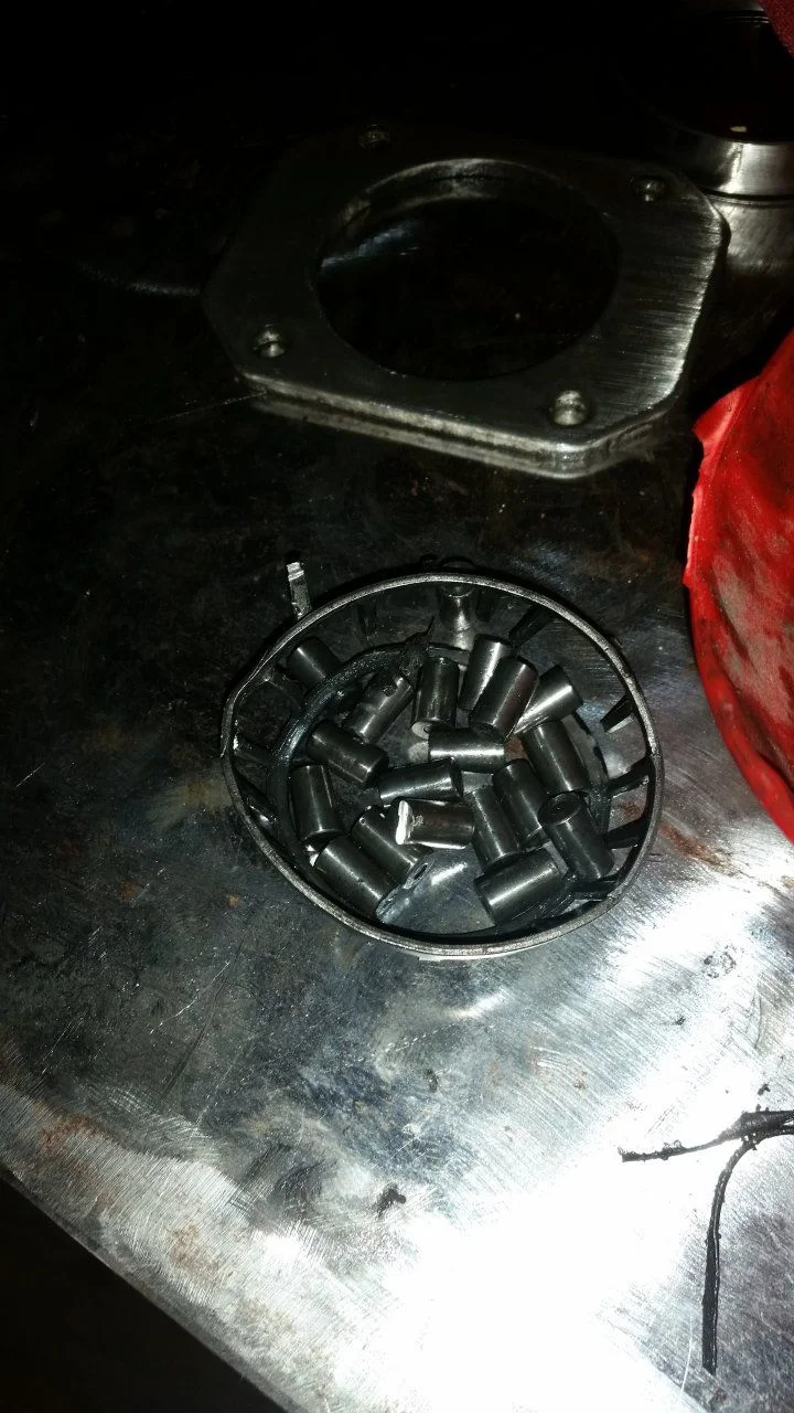

In order to get the mainshaft out, I had to cut the bearing race on the rear mainshaft bearing. This is a typical issue with the dodge NV4500's

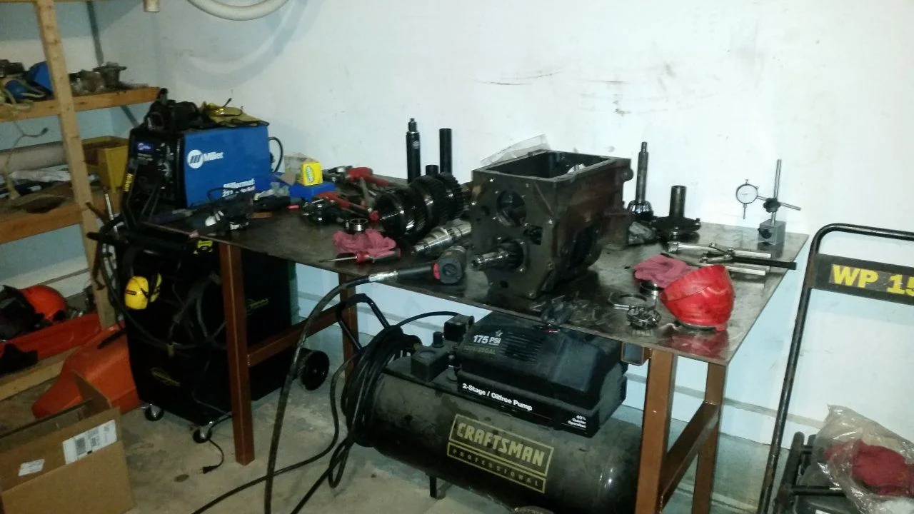

Main shaft out and next to the new main shaft.

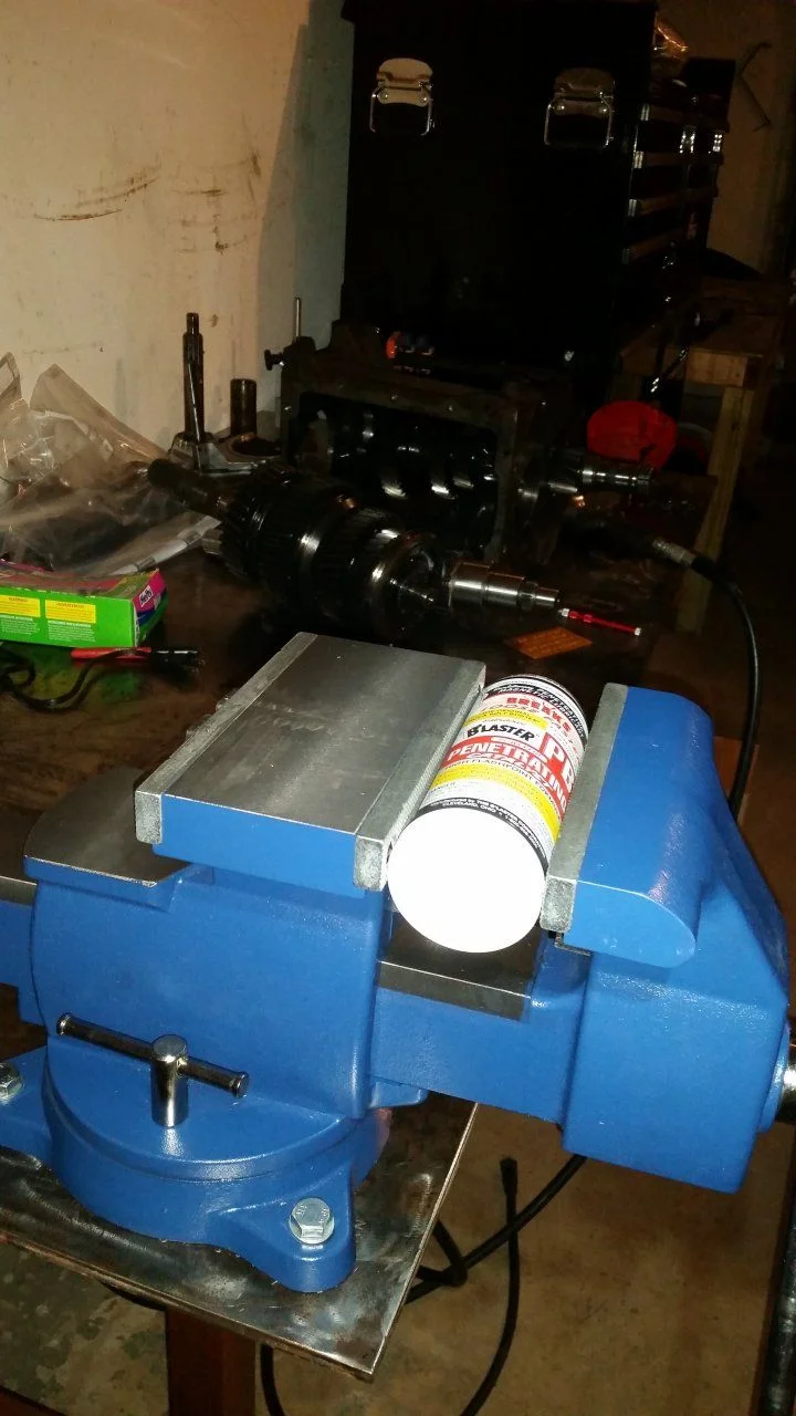

This is about when I realized I was going to need a good vice...time to go shopping
So after a little retail therapy, I had this back breaking 70+lbs monster at my door. It is a Yost 880-DI 8" made in the USA ductile iron vice...should last me a lifetime.
