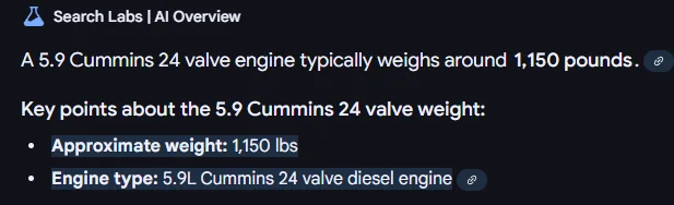

No turbo or flywheel in this pic, other than that just a few aluminum parts missing, but ain't no way all of that adds up to 300 lbs.
On the 94, only had to add a .75" spacer to the Icon springs up front to bring it back level.
from what I can guess, 1150 lbs is for a complete engine, fully dressed with all the accessories. Source and Source
I was trying to compare fully dressed weights.
I looked up the 5.9L 03-07 block weight and it isn't as heavy as I thought at 271 lbs. Source
For comparison, my L96 6.0L block weighs 216 lbs and 1FZ-FE block weighs about ~175 lbs.
