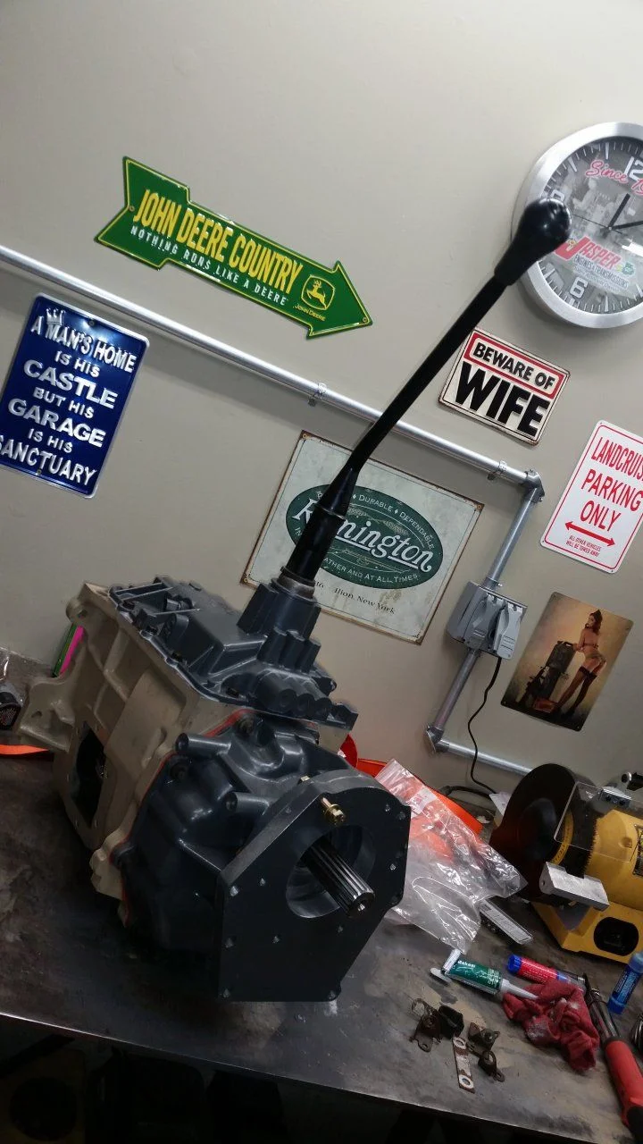

Today I spent a little time out there before I got too cold, and finished up installing 5th gear, 5th/reverse synchro assembly and the rear extension housing. Almost finished rebuilding this NV4500!

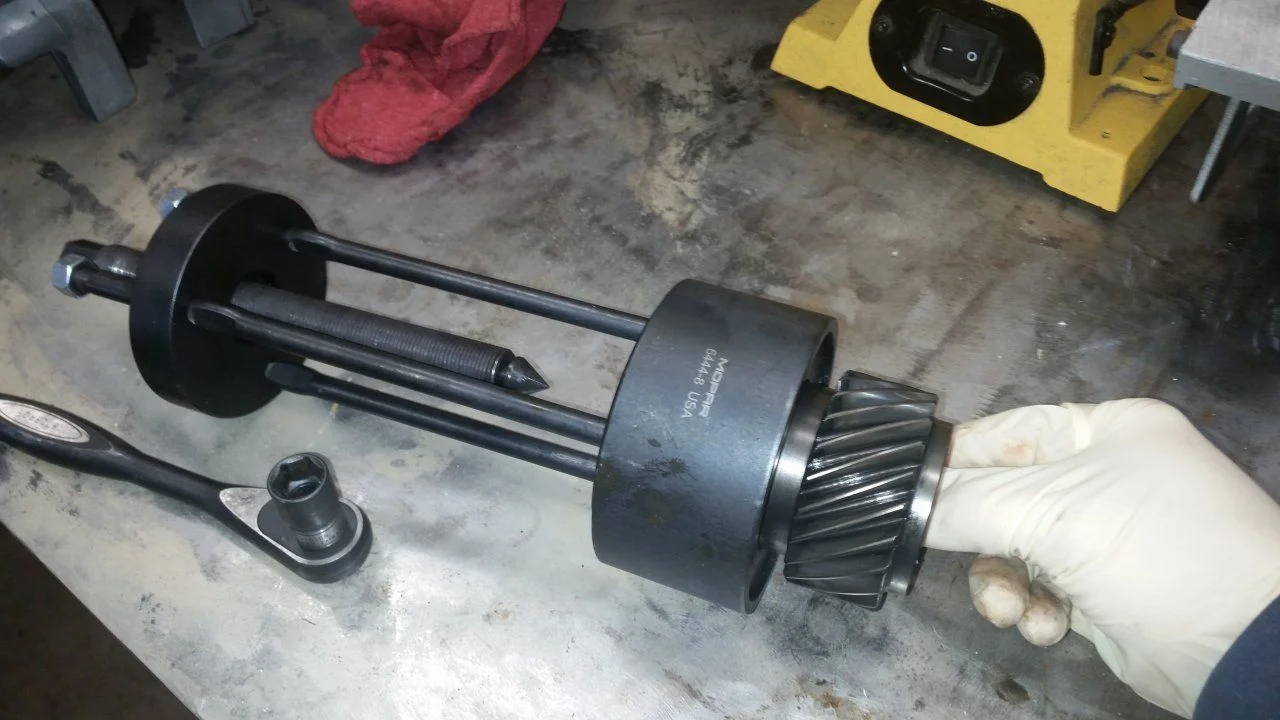

Looks good, what puller did you use for the 5th gear?
I have a set of mopar specialty pullers that are made by snapon, for rebuilding NV4500's but 5th gear didn't need to be pulled, it slipped right off. That is pretty common behaviour for 5th on these trans. I did need a variety of pullers, bearing splitters, punches and HD snapring pliers throughout the rebuild though.
Mind is being a motherfxxxer, I've already broke a puller in it. Glad to hear yours was easier.

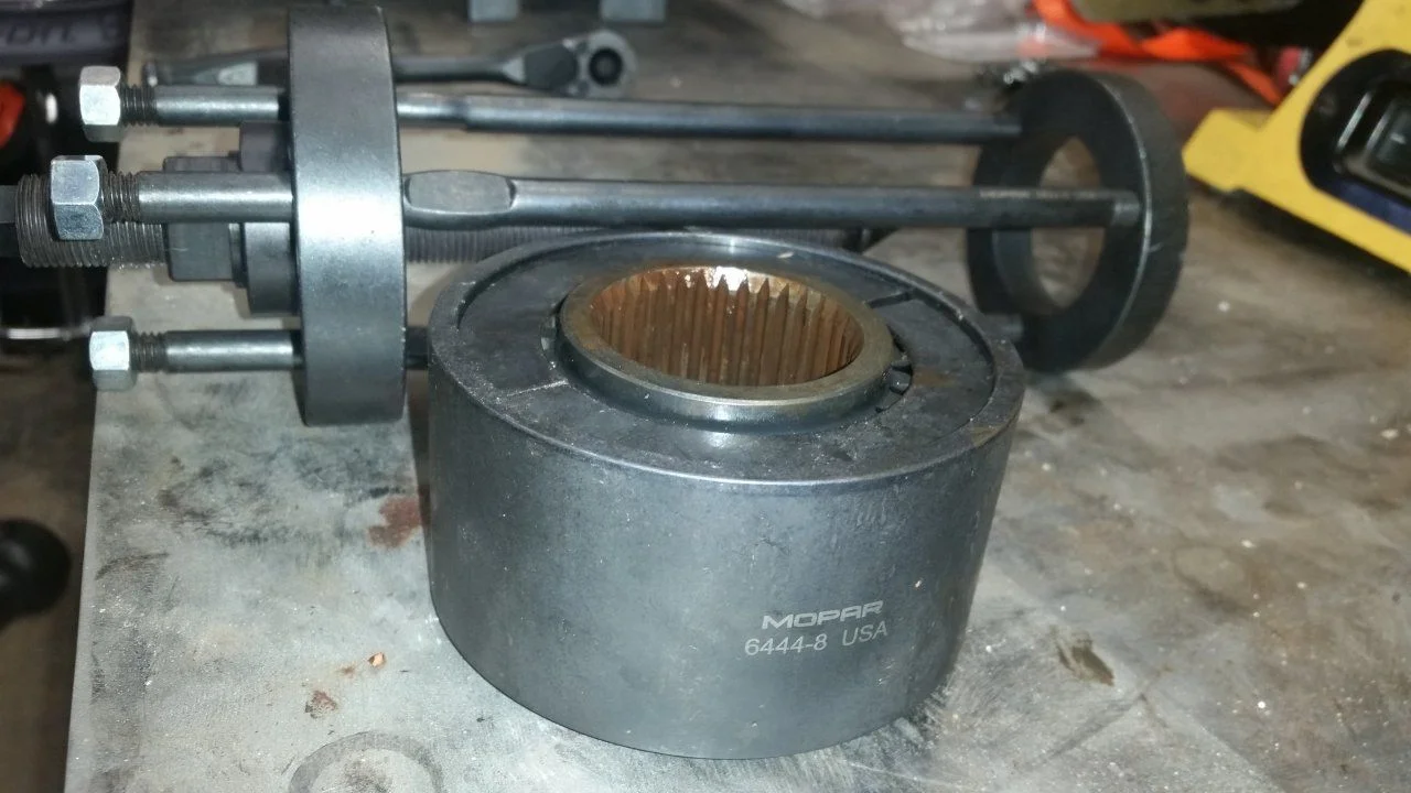

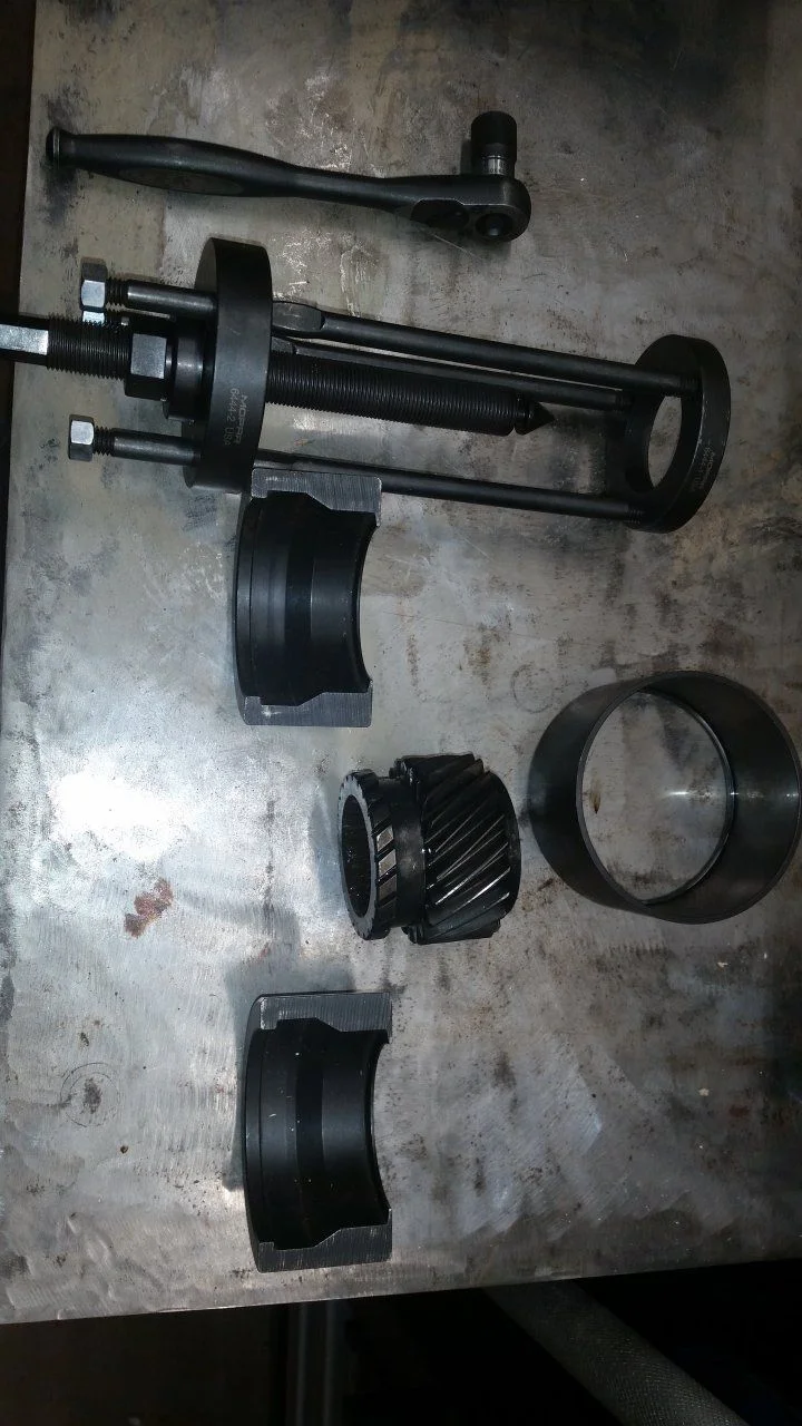

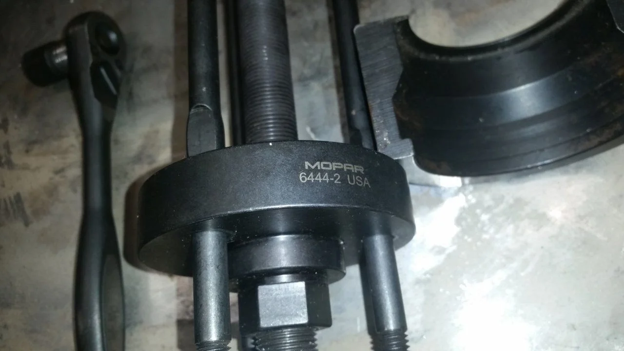

Yeah if yours is pressed on, you won't have much luck with a 2 or 3 jaw puller. This is the setup I have and would have used if needed.
These tools are miller specialty made by snap-on.
Puller: 6444
Collar for 5th Gear: 6449
There are 6 different size collars in the set, i used most of them during the rebuild, but you only need 6449 if you are only doing the 5th gear.

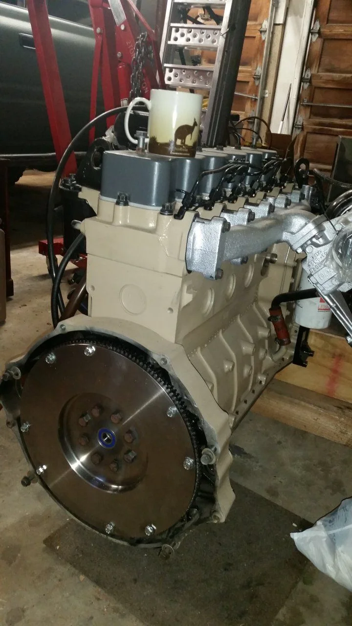

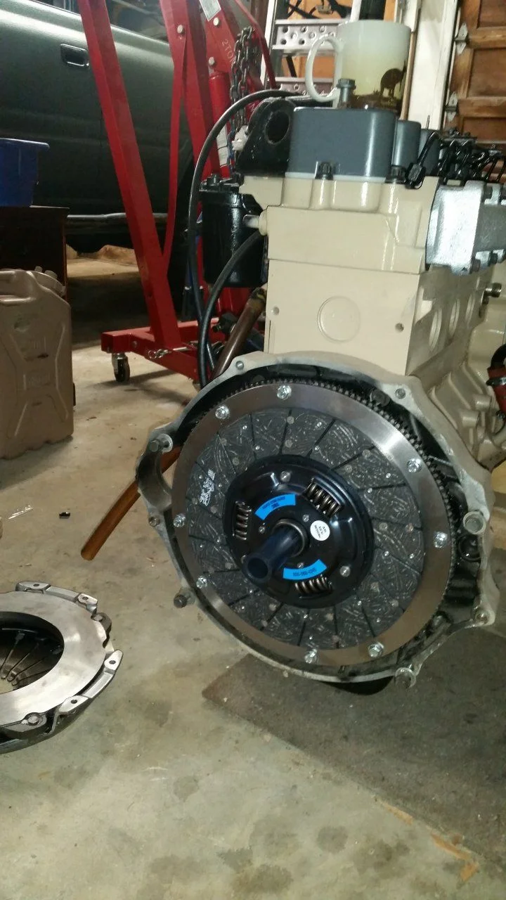

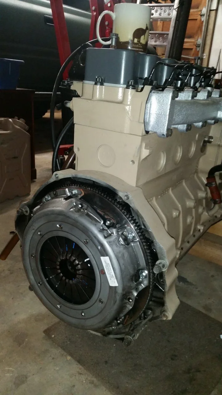

I also bolted up my southbend 13" flywheel and clutch. Torqued the flywheel to 95 ft/lbs and pressure plate to 20 ft/lbs per SBC specs.

The machine work is really good, the fit is perfect. Only thing left to do is fill the trans up with gear oil and bolt on the PTO cover and belhousing.
