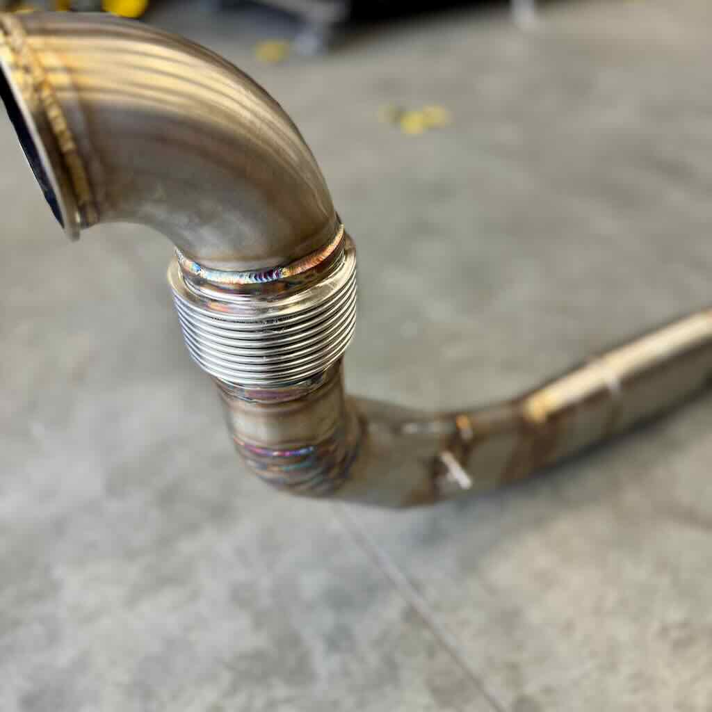

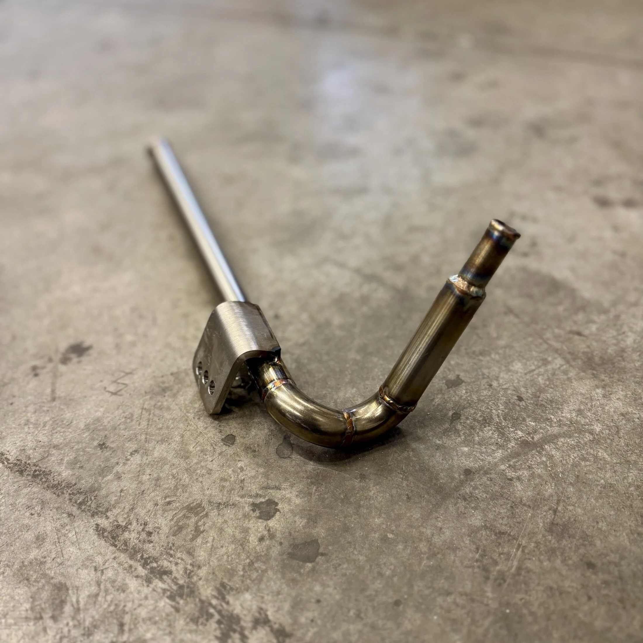

One of the “little” parts that just got finalized is stainless heater tube 1 going from front of block to heater core.

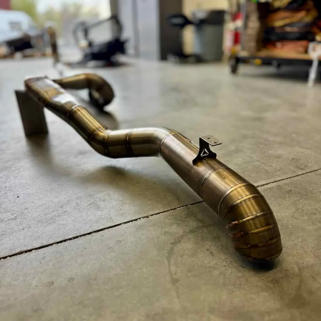

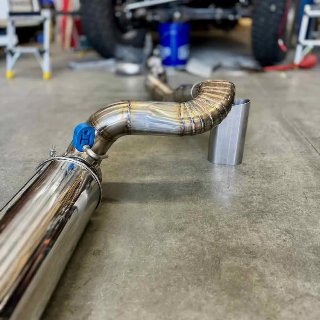

Full 4” exhaust from turbo to tail finalized (with no body lift). There is plenty of room for optimization of the path, which will lead to fewer parts. It currently sits at 58 individual pieces of stainless, would like to cut that by half.
The muffler has v-bands on both sides so can easily try different configurations. Have a smaller muffler on the bench to try, as well as a straight pipe.

Can the oval pipe be mandrel bent?
I'm thinking no, but curious.
Exhaust looks sweet, just curious about your process. That's a lot of cutting and welding.
Do you have capability to laser cut pie cuts? Like, is this automated/CNC, or someone standing at a machine making cuts?

Unfortunately, those aren’t available in 4”. maybe someday the oval mandrel will be more prevalent, but until then it’s 6s as to standing at the bandsaw cutting vs ordering precut pies. It’s actually really not that much more work (opinion) to get the first one done with pie cuts. It’s when you move to production where it really slows things down. The idea here is to jig this exhaust up and reduce the part count significantly.
I figured pie cuts is probably the way to go for prototyping or one off, vs production.
I've built a few DIY exhausts and headers with mandrel bends and pipe. Appreciate your pics and comments 👍
