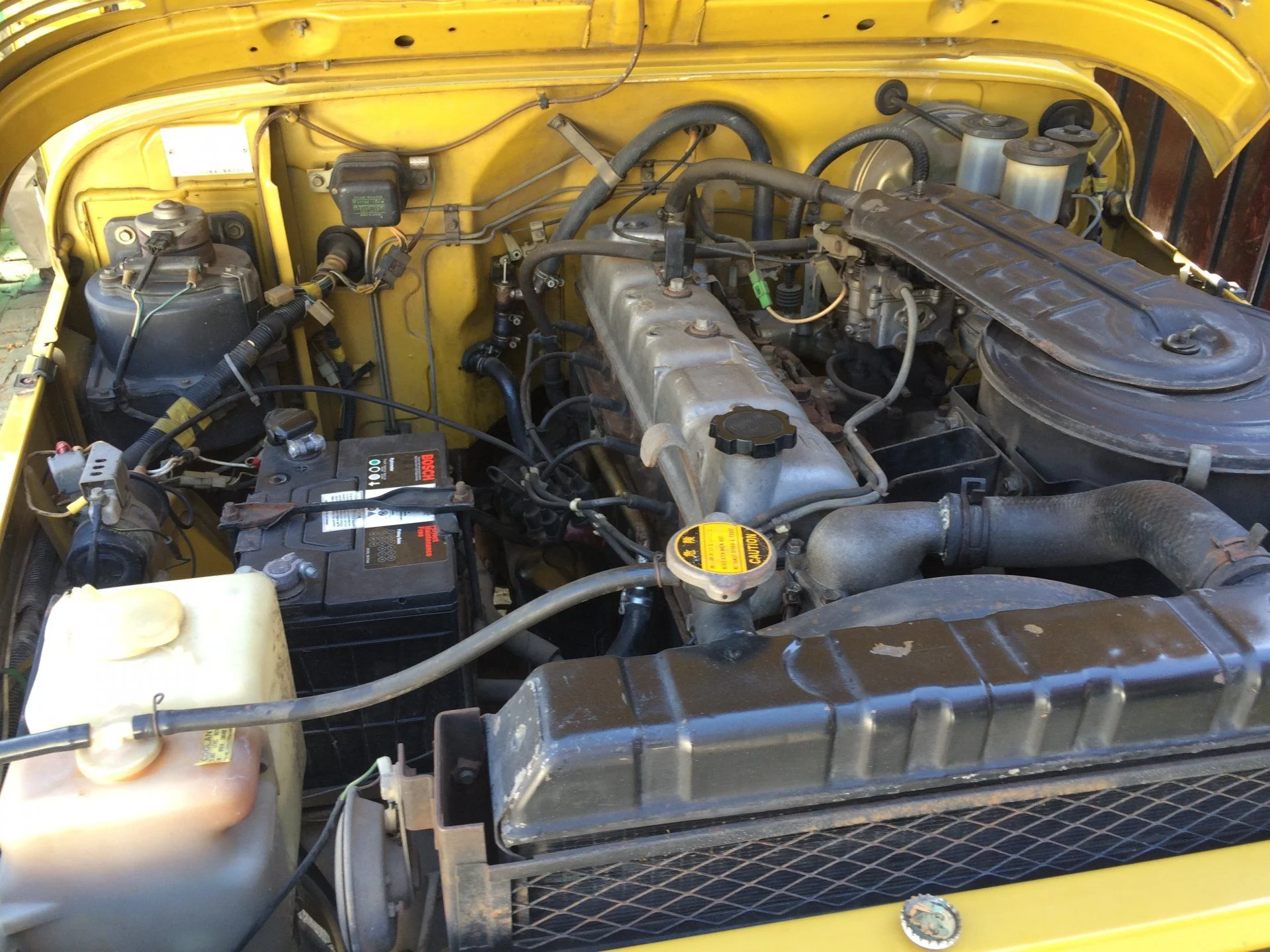

This is my first post. I bought my 81 FJ40 in Chile _ immaculate, no rust, 80k miles etc _ when I was living there. Bought a tune up kit from Cool Cruisers of Texas as well as radiator hoses etc. My mechanic said some of parts _ spark plug wires, distributor cap etc just don't fit. This is my first FJ40. Called up Cool Cruisers and clerk explained that the difference may be where mine was manufactured. I knew there were some difference _ I have the split bench seat in front, a different dash etc _ but didn't realize there would be differences in distributor caps, spark plug wires etc. Does this make sense? Are there other differences in parts that I should be aware of? Picture of engine and car included. Looking for some help. Thanks!

A lot of emissions related differences. My 81 fj45 from Chile had an oil bath air filter. Looks like you have split rims as well. Also there was no choke.

Your 40 probably uses points compared to a full electronic set up like in the same year US Cruiser. It may have an octane adjuster on the dizzy, like early US spec cruiser
Yes, that is another difference on mine.
My '80 FJ40 originally came from Ecuador. It came from the factory with emissions, heater delete, power steering, and front disc brakes. It has since been desmogged. It may have come with points ignition but I'm not sure. Also, I think most outside continental US cruisers had 16" split rim wheels.
