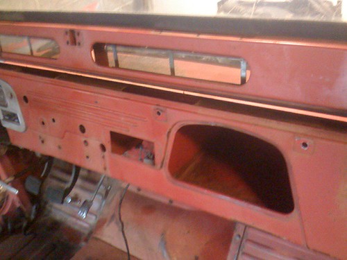

I noticed that on your rig you havea hole for an ash tray but no lighter. So I looked closer at mine and the hole for the lighter is definately PO or at least an enlargement of an OE hole. So my question is, Did the early cruisers have a cig. lighter as an option? or were they absent from this era.
Rod
Thanks:)
As far as i know mine never had a cig lighter.
Mine does not have a hole for one at least :)
The 65 might have had one...
Can some one verify?
I def need to find a 1964 under the dash shots to see what holes i need to weld up as the PO had installed an aftermarket heater...
:D

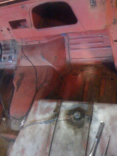

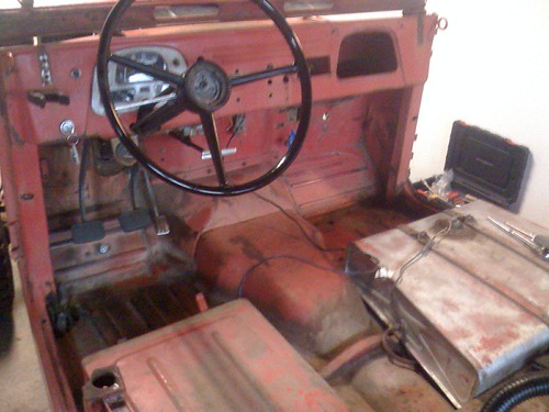

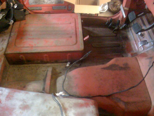

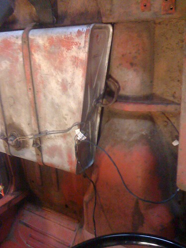

gas tank questions :D
Any removal advice?
This will be my first time removing an gas tank....
I think I am going to have it relined internally as well.
Second part of the question...
Did the 1964 fj40 have a pewter colored tank stock? or body color?
Thanks guys :)
X2 two on body color. By 68 they were black but I know 65 and older have always been body color on anything I've owned.
If it were me while it still in the vehicle I would loosen all the connections before I removed the two clamps holding it in place. I would also loosen the drain nut on the bottom. Even if you don't use it to drain the tank you will probably remove it sometime while it out. It's is the easiest way to drain the tank and get it completely empty.
Great thanks guys :)
