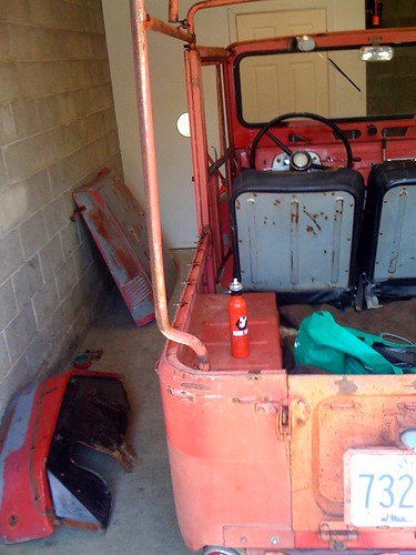

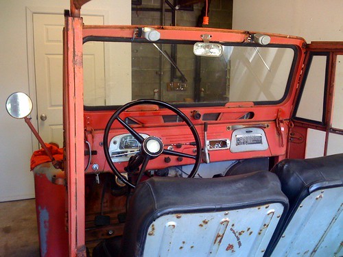

This is the before for the sake of clarity

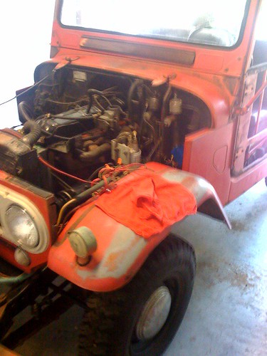

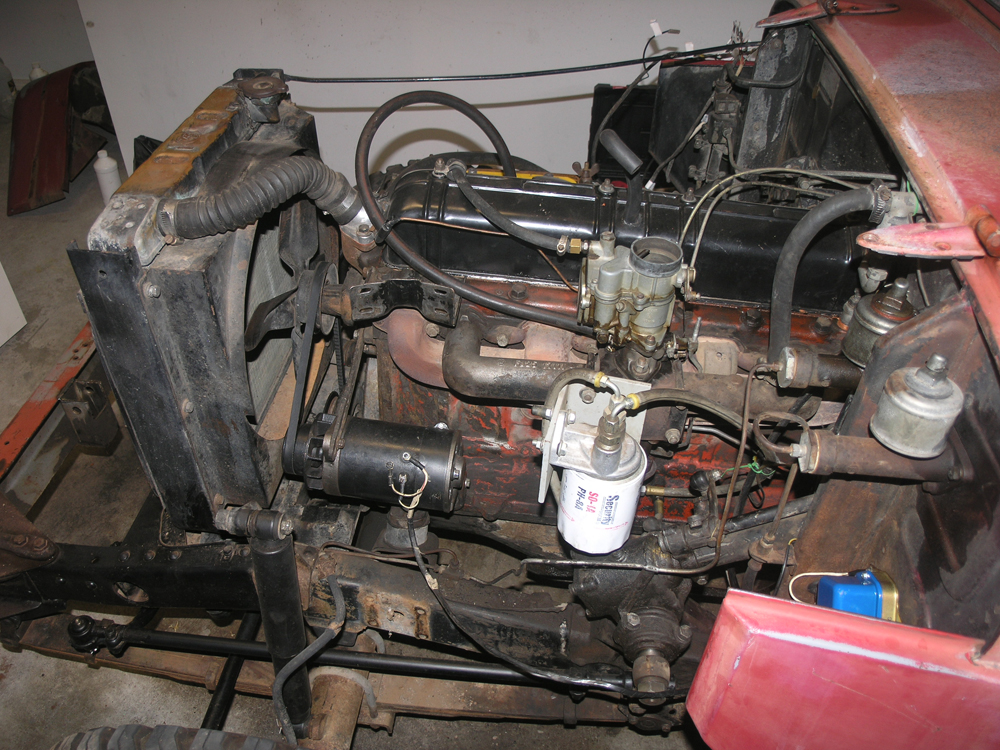

So I started taking it apart today :D

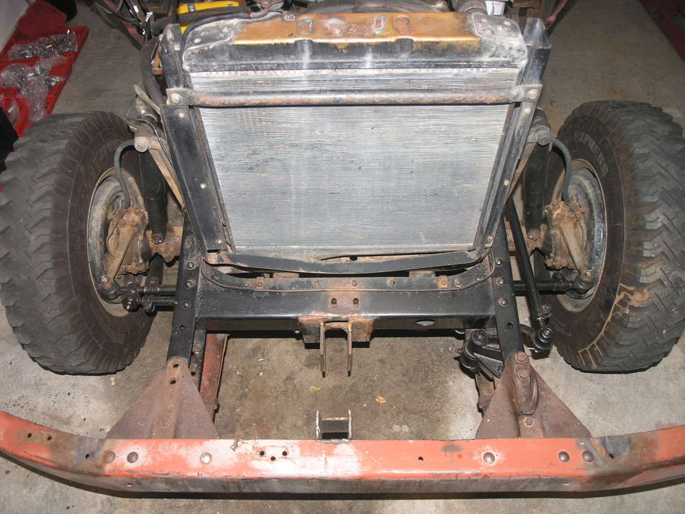

Here is the beginning of the tear down... bad cell photos, small shop :D

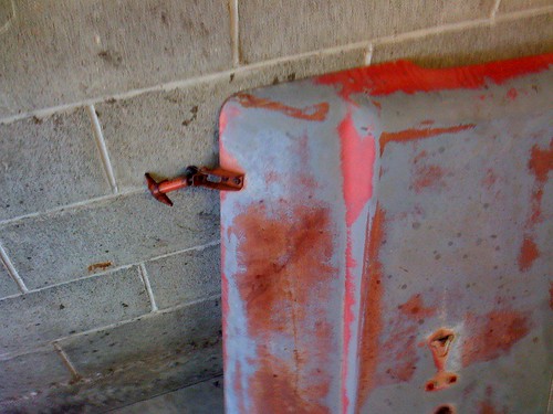

These hood latch bolts would not give, hopefully the mousemilk will free them up

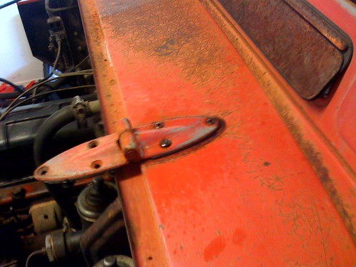

That is one cool cruiser! The scenery sux, but the rig seems to be fairly rustless and complete....right down to the hubcaps and (must be) drive flanges!!!1 COOOOOL!
The Sidewinder winch is over the top.
Keep us posted with lots of pictures! I have a 65 FST and I'm in the middle of patching a million holes drilled in the body over the years. My biggest problem is that the PO did a very good job of making both sides match perfectly and it's been a very long time since I owned a 40 so I don't remember what is OE and what is PO. I have already got a little help from some of your photos.
Also I need a couple of hood hinges like the ones in you photos. Anybody got some to sell?

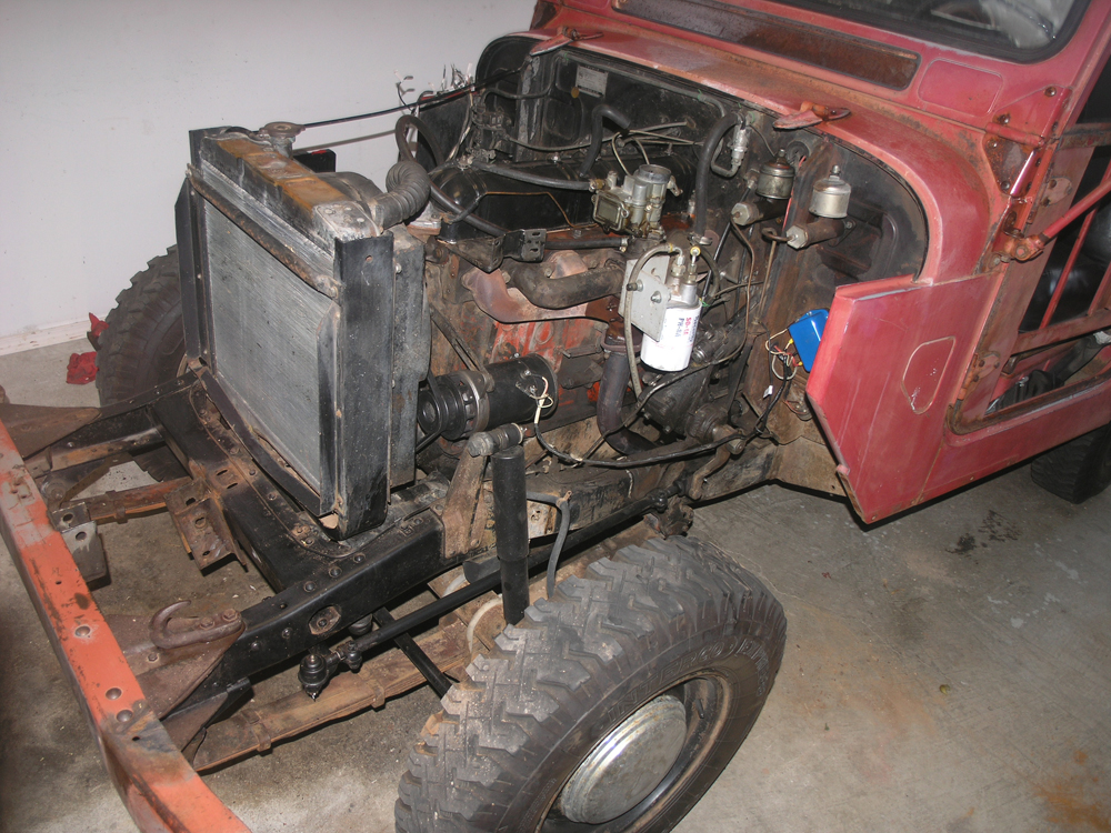

Yeah i have been soaking things in mousemilk and being as patient as i can be :D
Everything seems to be coming apart ok.
With exception of course to a few philips screw heads that i make have to either drill out or find a better solution ( heads of the point are soft, and will most likely strip out under torque )

If you're patient, you should be able to get all the phillips out if they haven't been buggered yet. Soak them with penetrating oil from the backside, you can get to almost all of the backsides. Get a good fitting screwdriver and just hit them with a hammer occasionally when soaking, don't try to get them out, just give them a good wack to break the bond............repeat. ;)
Added your thread to the project sticky at the top. :)

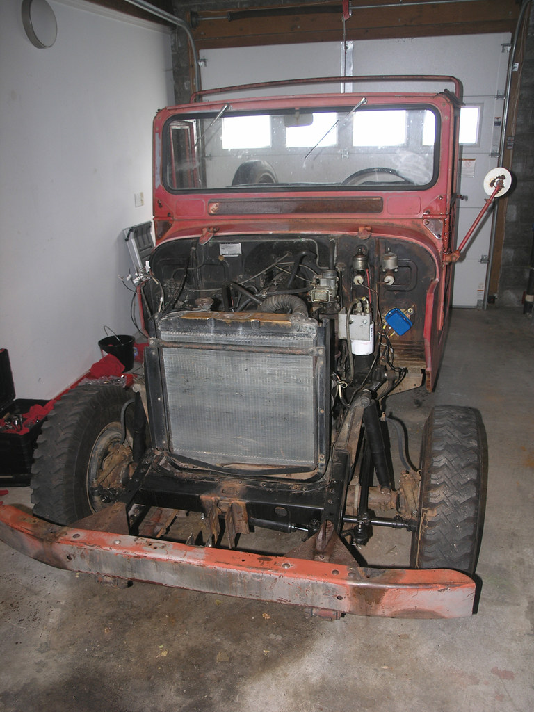

Trying to do this the right way.
I am sure I will have tons of questions the more I dive in.
I have been labeling the wiring harness bits for reassembly as well.
Being sure to under line the number sixes and nine's as i go ;)
It is a small shop space, but I am trying to keep things very tidy and orderly :)
