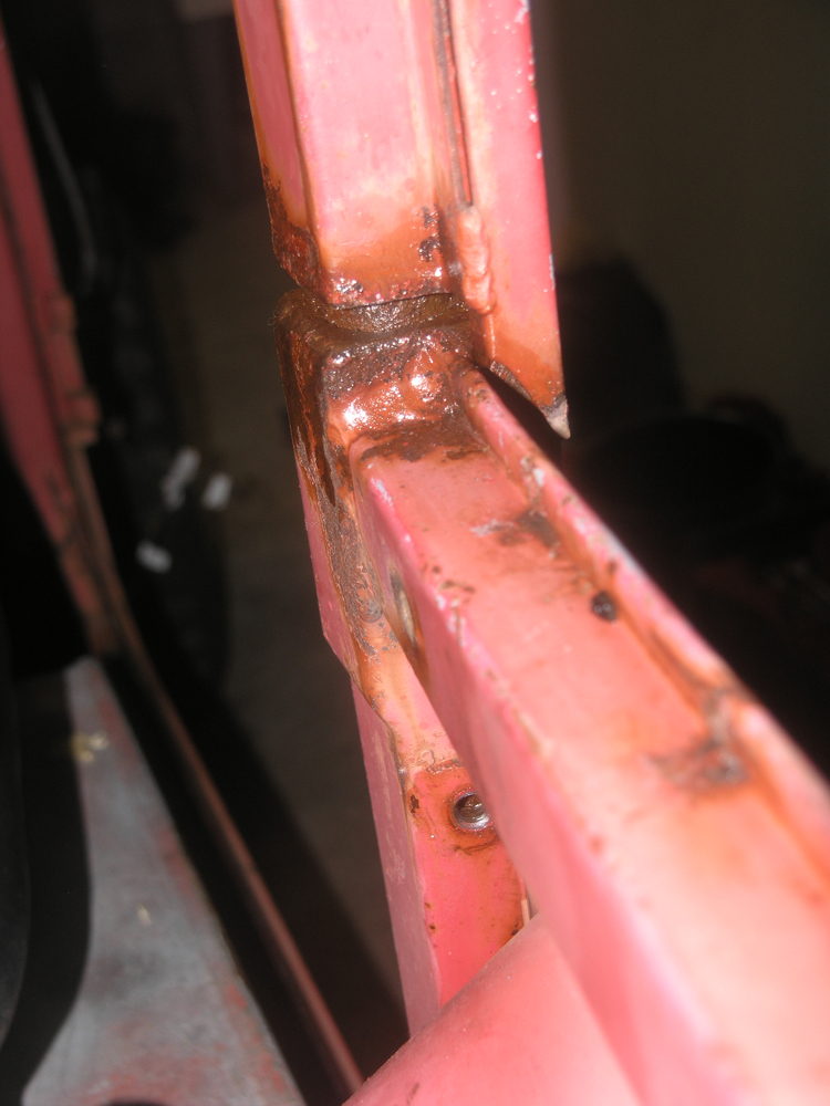

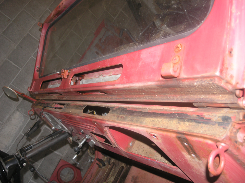

Looks like the windscreen had not been lowered in 30 + years hehe.
The hinge was way stiff.
The seal was in great condition however ( not shown )

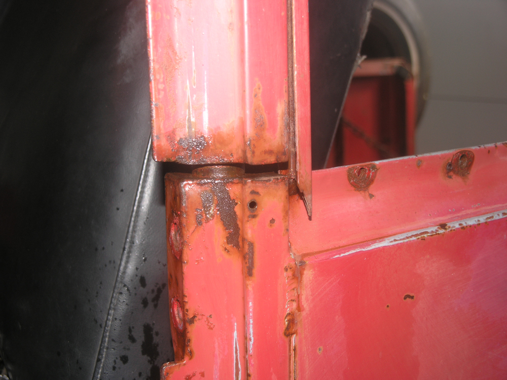

Patience payed off, the bolts came out.

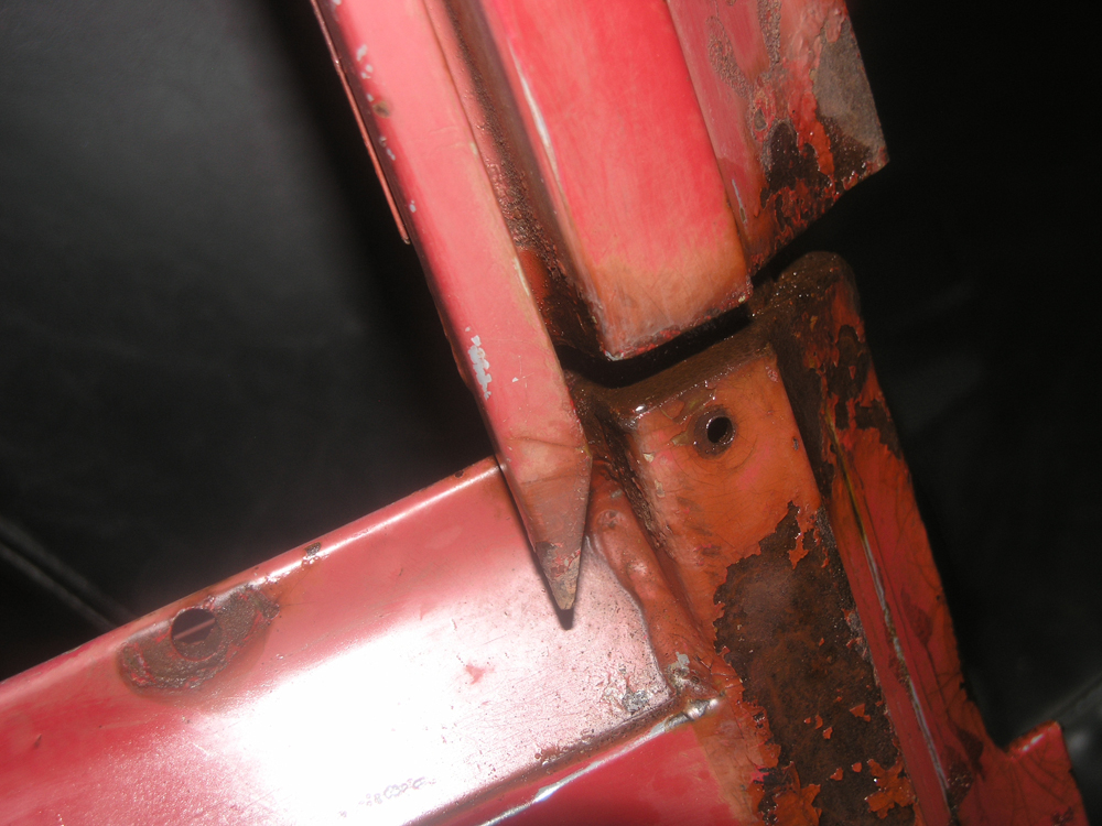

Soaked the connection again, so it will be easier to remove tomorrow

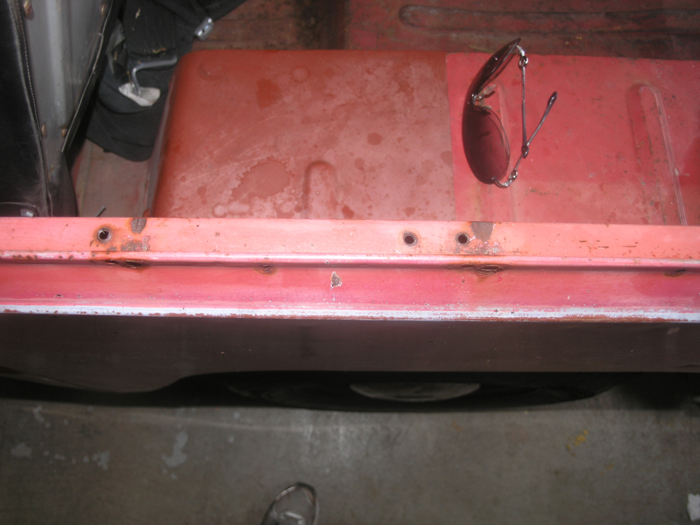

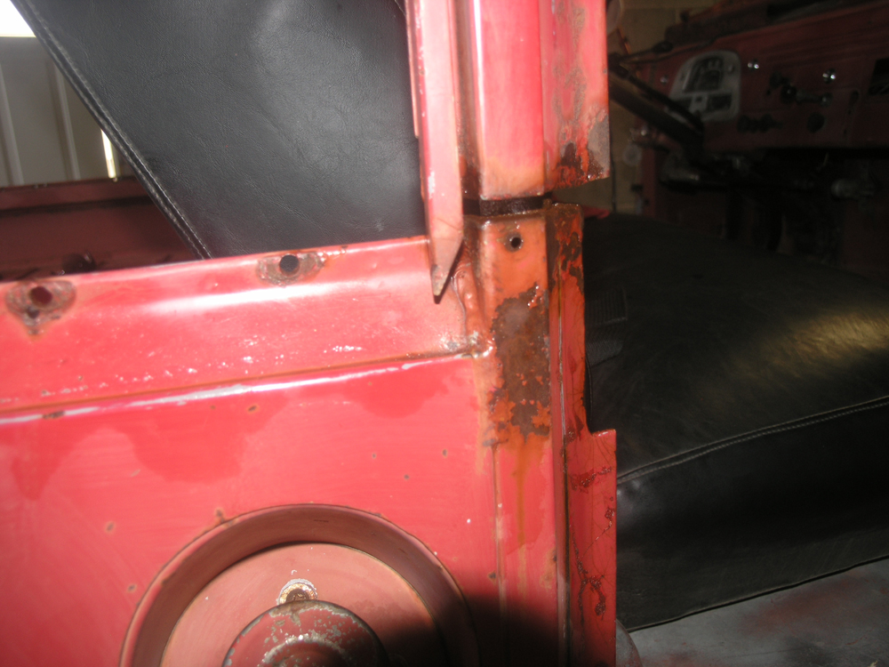

Is there a reason to have all these holes?
I need to make a list of stuff that should be patched up during the body work phase...
