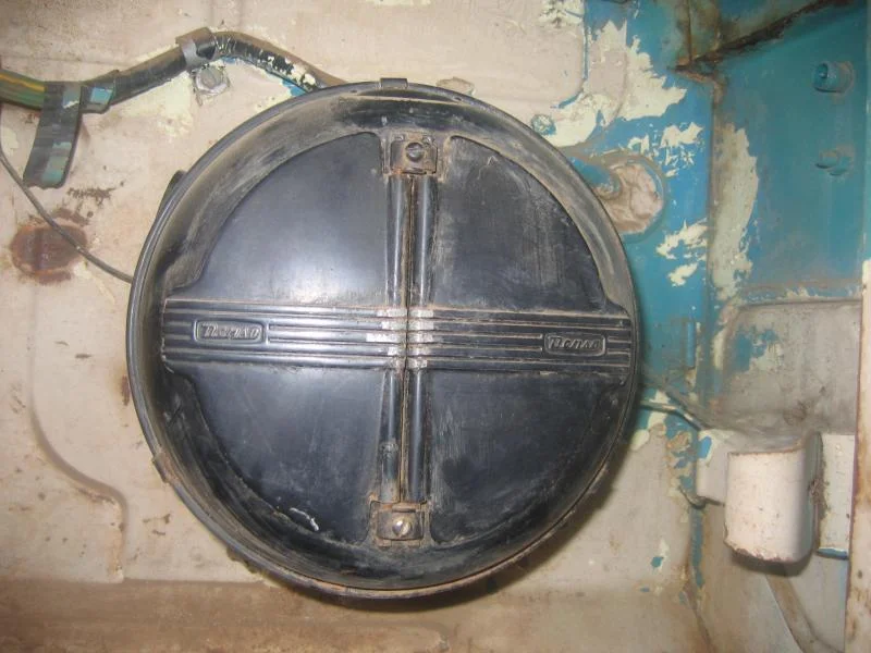

for what? Stock was no heater. IMHO you could clean that one up and either put it in the middle and move the fuse block or put it on the passenger side. even though originally that style had a fresh air vent you could use it as is. None of the dealer installed heaters had fresh air either.
But the aftermarket heaters had a built in blower. The factory heaters had the blower on the otherside of the firewall with a duct to connect the two. Unless you want to cut up the firewall you need to go aftermarket or find the early Nippon Denso.:cheers:
I have defrost vents!
But no heater
This is another reason I think Toyota had some aftermarket heater kit available for the early FJ40s. Remember in the late fifties early sixties Toyota use the Land Cruiser to get a foot hold in the American Market. Sales were measured in hundreds not hundreds of thousands like today. I think Toyota saw a real need to have a heater available in the North American market and made it happen with a aftermarket kit. Somewhere during 1962 Toyota started installing defrost vents but the heater wasn't a factory option until the 1965 model. These defrost vents seem to be something that was quickly installed into the 40s to meet a demand. They weren't really thought out that well. Can't fold the windshield down without removing them.
I would really hope maybe we can get Shane to reproduce the Johnston label for this heater. I know I have at least three maybe four.
So true, the defrost vents are a complete afterthought hehe.
After i removed them what you told me when i first started posting on mud became more apparent :D
No way to drop the windscreen without removing those vents. ;)

Here are some of Living In The Past's heaters.
One is from a 62 soft top tub. The other is from a 65 45LPB. Both are from the mid CA area. The third is a Denso heater that was in one of his FJ25s. Don't know the story on it. Not sure where it was installed. Attached Images
