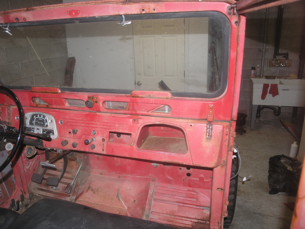

ok some more dismantling today:
Still trying to figure out if there is a secret to pulling the steering wheel off.
Everything seems to be disconnected, but it seems pretty solidly in place...
Do i just need to tap it out with a hammer? A special tool?
Most of the passenger side stuff removed, but man those defrost vent nuts are seized up!, sprayed and let them soak again :)
Removed the non stock heater :)
Looks like they cut a nasty hole in the firewall to get it to fit, will need to welf that up :) If any one has a factory heater for sale let me know :)

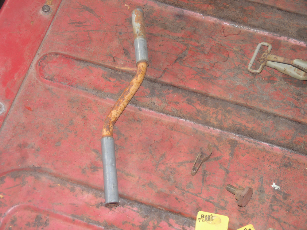

any one know what this is?
Crank handle?
Crank handle?
get a steering wheel puller at the local auto parts store.
I don't recognize the handle thingie but the clip if for the door safety strap and the large nut screws in the door straps on the a pillar.

I was not sure what that bolt was but i knew it was important :)
I use a cheap puller I bought at Harbor Freight. Comes with both SAE and metric bolts. The other thing you csn try is put the nut back on until it's flush with the end of the thread. Then while someone pulls up hit the end of shaft. Sometimes the stock will break it loose. If you have a good steering wheel you don't want to mess anything trying to pull it.:cheers:
