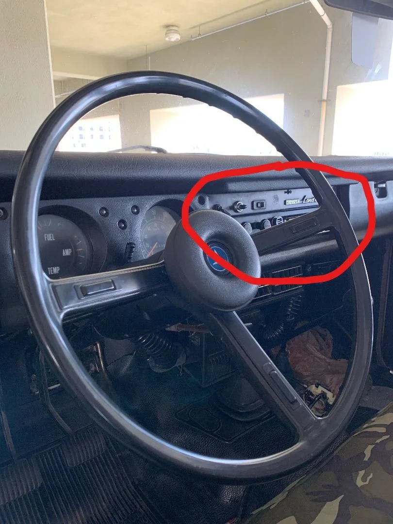

This is the best photo that I have with me. When I look at the parts diagrams though it looks like 6 screws and it's out. Again, I don't think I have pulled mine so maybe there is more to it.
So isn’t there a small set screw in each knob that you back off, then remove knob, then remove the front hex nut and pull switch out though the back? Been awhile since I’ve worked on any of this. So then.... remove screws from that section of backing plate and pull forward. Will probably be met with resistance from heater selection cables.

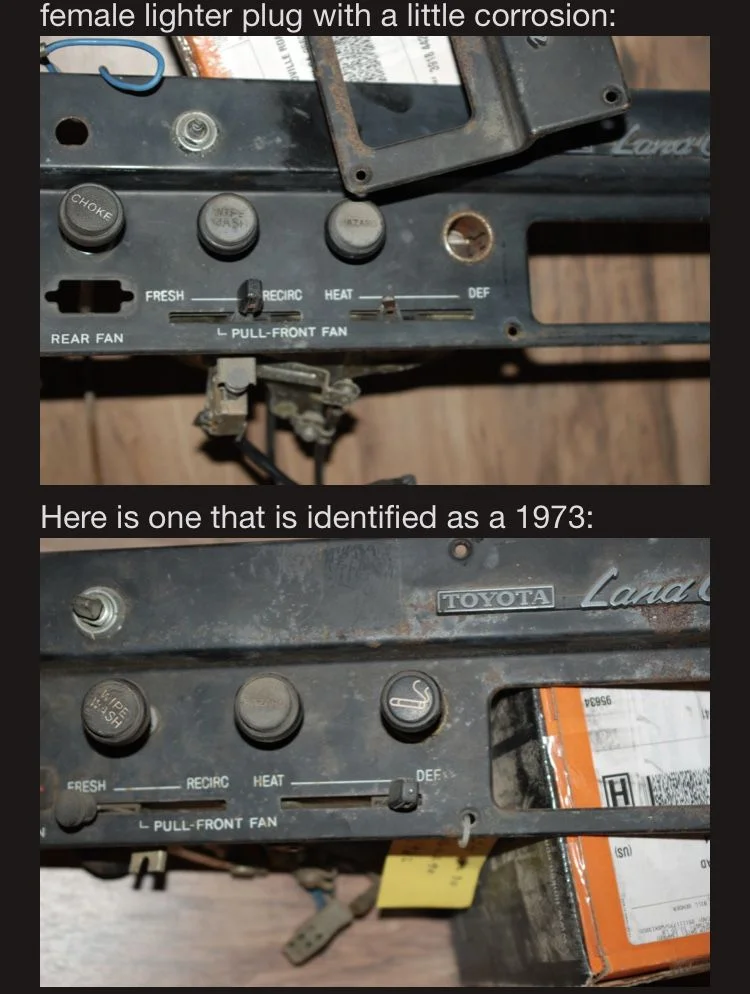

What year Pig? '77? If yes, we should have similar center panels.
It sounds like you want to remove the center panel portion of the dash.
On my '74, I can tell you what I remember...
IIRC, you need to pull the instrument cluster to remove the center panel.
Also IIRC, you need to sag the steering column to pull the instrument cluster.
So once you drop the steering column, pull the instrument cluster, then you remove the center panel.
What do you need to check on these switches? Are they being bitches? Operating intermittently? From what I have read, the ground to the center panel sucks. Run a ground cable to the center panel to make things better.
